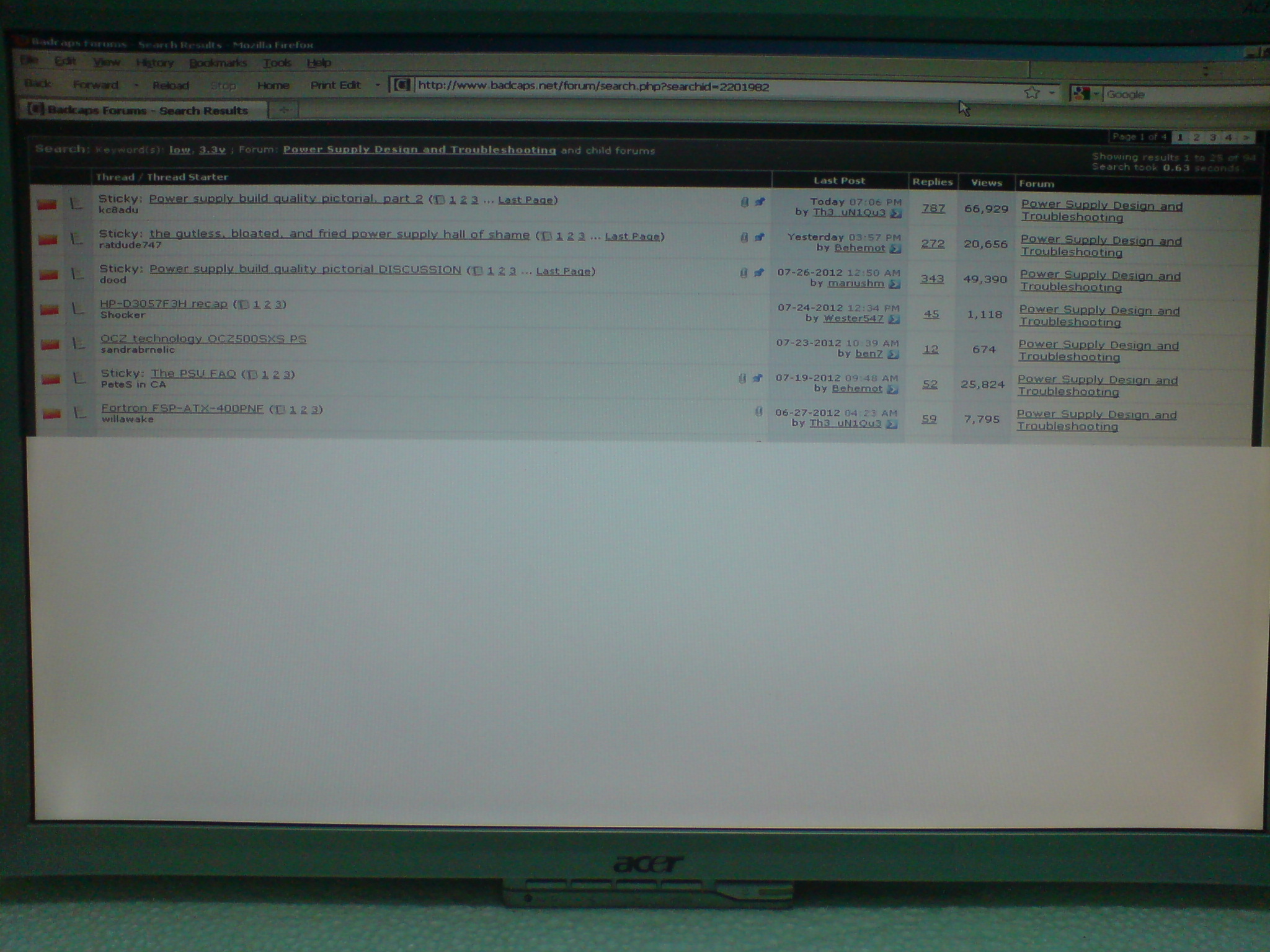

Acer AL2216W half screen blank
  • trendcos
    • Jul 2012
    • 4
    • malaysia
    Does anyone know how to fix this problem? Thanks
  • Rtech
    • Jul 2010
    • 1095
    Re: Acer AL2216W half screen blank

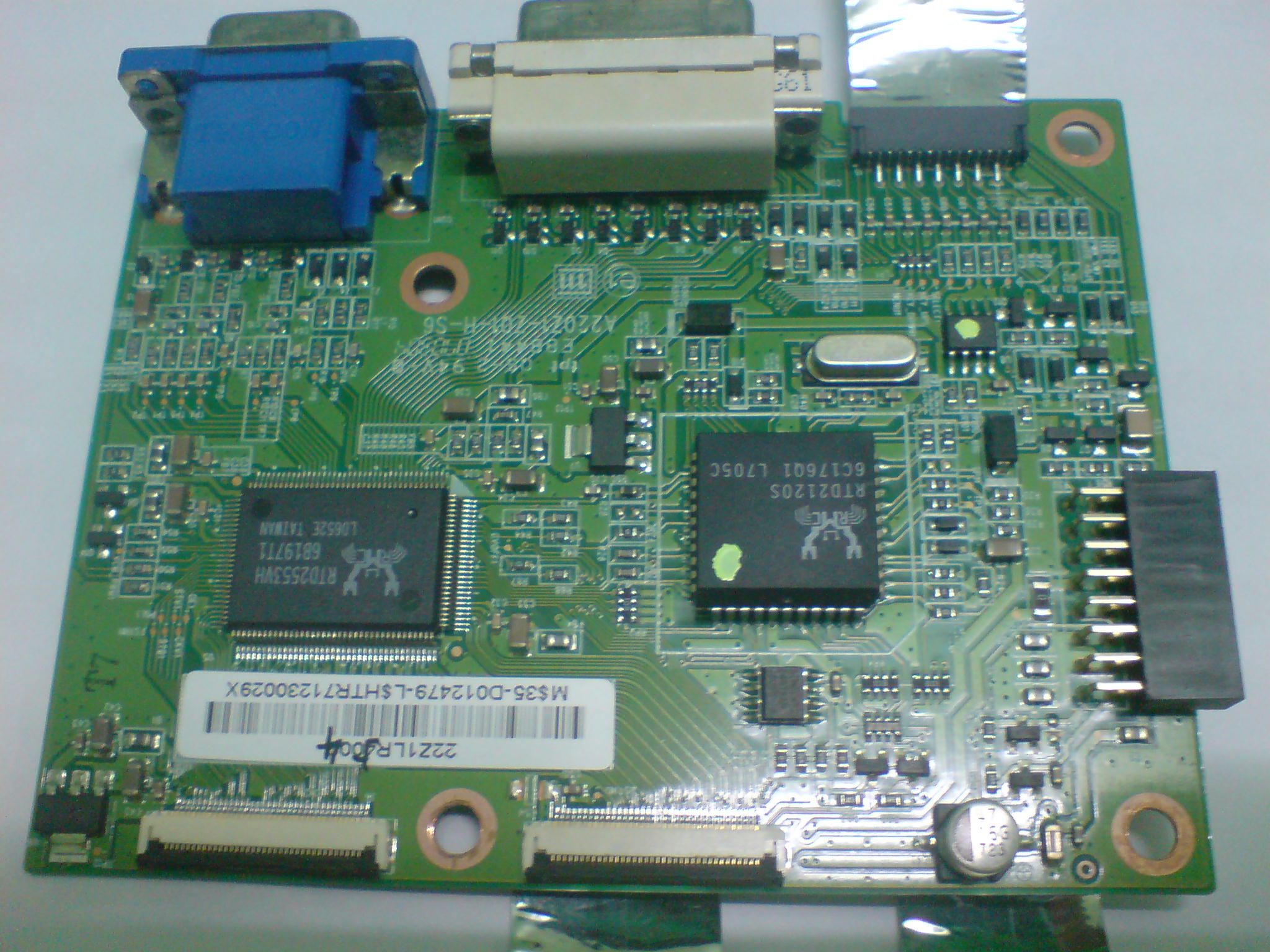

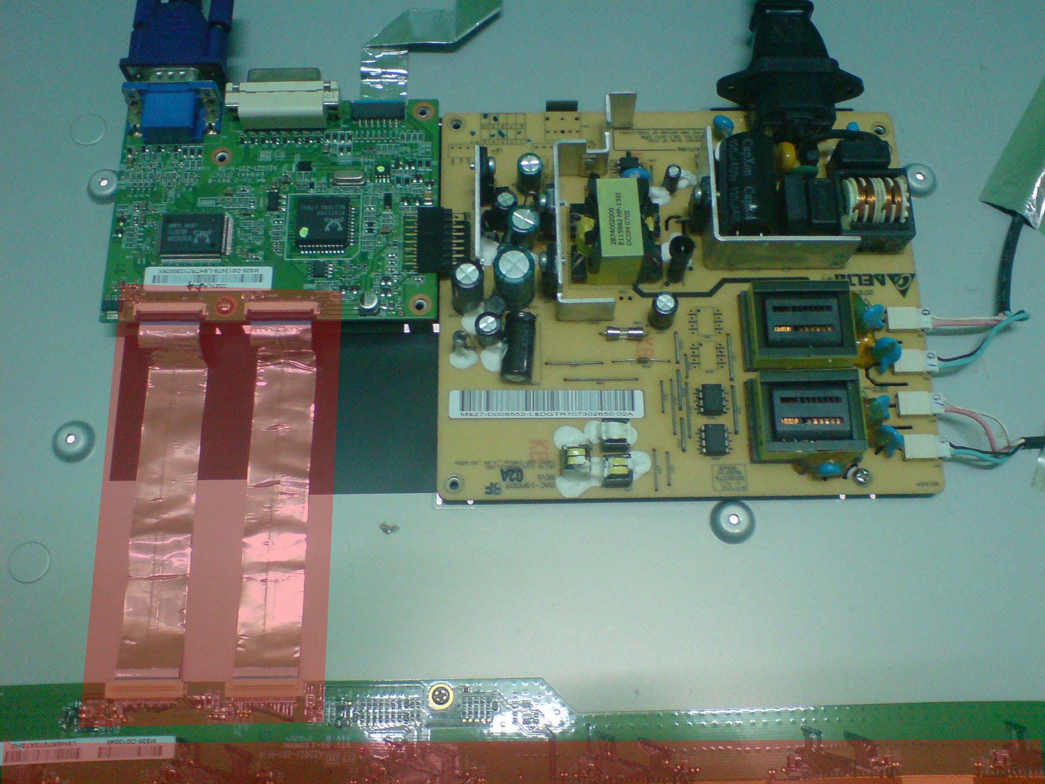

    Probably a replacement Screen panel,looks like one or more of the flexible connectors between the Screen and the T-Con Board have failed.

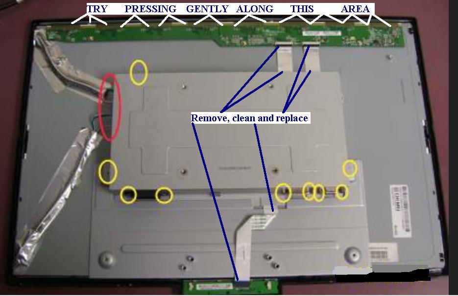

      Open it up and post apicture of the back of the panel and connectors.
      Try pressing gently on the panel connectors.
            Just in case you did not fully understand I attach a picture showing which connectors to clean and reseat and also where I wanted you to try pressure.
            If there is no change then panel replacement is all that is left.
              I tried it still the same, the panel is broken, thanks you for your help!!!
