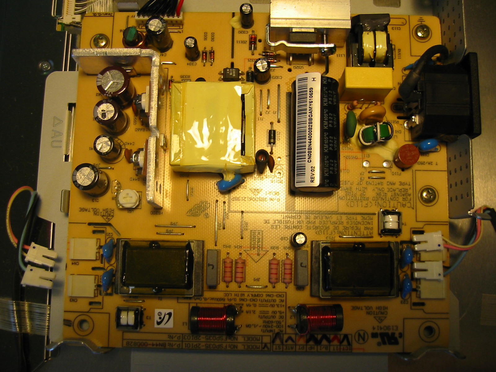

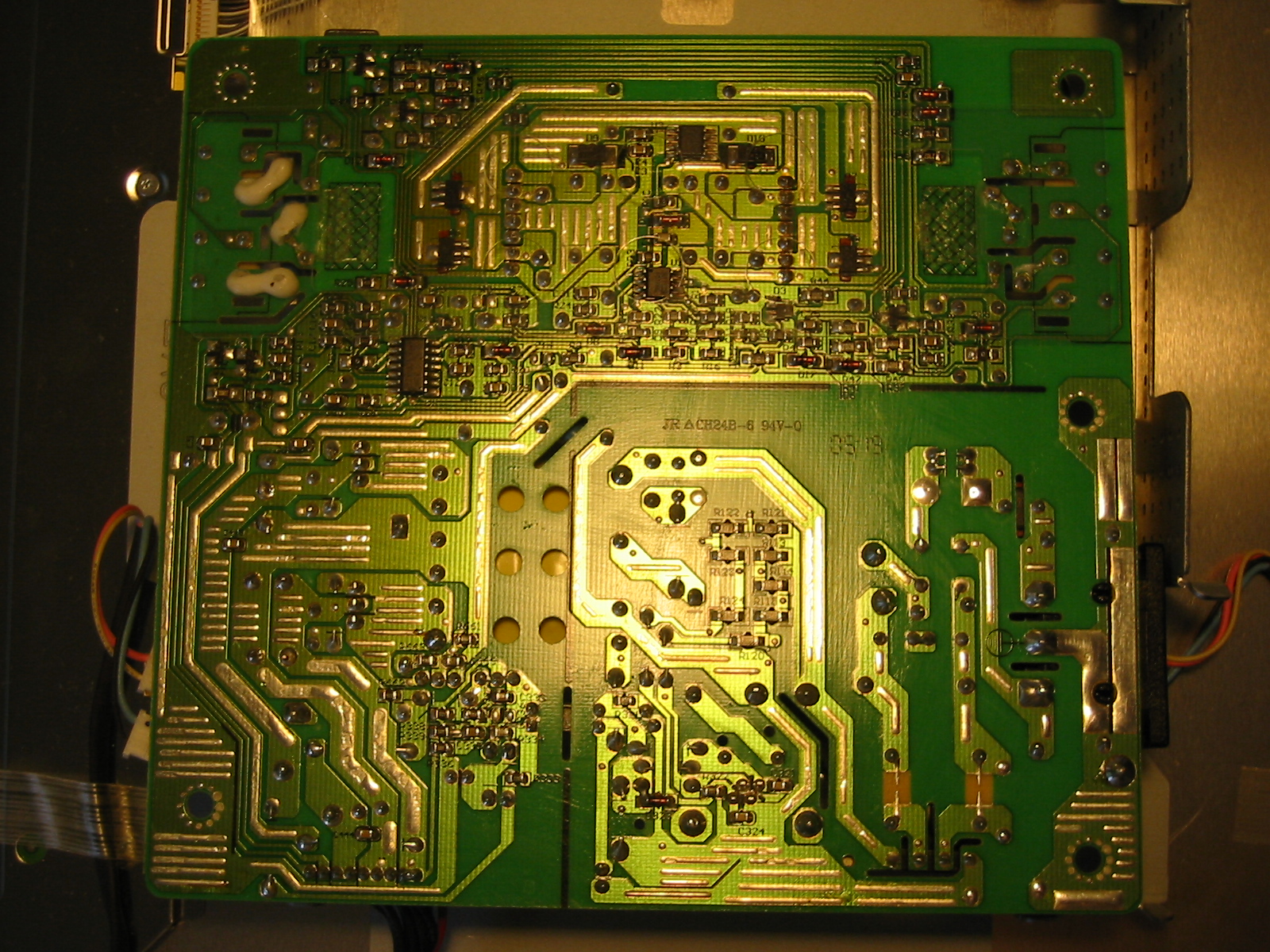

    Samsung 710N constant flicker
    Need expert advice once again.
    Been staring at this 710N whose backlight flickers about 10 times per second. Pretty annoying. It seems like setting brightness to 100 sets the duty cycle to 90% or so and at about brightness 20 the monitor just shuts off. It's like the inverter is getting a low PWM signal somewhere, can't figure out where.
    - Tested with different backlight panel -> same issue
    - installed new(ish) caps on the 15V and 5V bus
    - 15V and 5V bus look good. 15V dips to 13V-14V when the CCFLs come on
    - transformers check out - ~950ohm on the secondary
    - inverter fet and transistor check out good
    The only slightly strange thing I could find is the input bus is at 162 where it is normally 169VAC. It can't be that, though?
    The only other thought I have is if it's those square capacitors by the transformers (names escape me right now). I'm too lazy to pull them out to test on my DVM's "CAP" setting... someone tell me if I should?
    ADJ_BL from the logic board is ~0.535VDC. Not sure what it should be.
    I can't find schematics for this inveter board. It is FSP035-2PI01. Other ideas?

    Re: Samsung 710N constant flicker
    Pictures are not sharp enough for trouble shooting.
    As you have tested most components I would change the tuning caps you refer to - i dont think you can test them properly with a dvm.
    When you tested the voltages including the Big Cap were the steady or do any vary in time with the flicker? Check any voltage regulators?
                    I am thinking about the same tuning caps (C19, 20) for this Royer Oscillator setup.
                    The pot is for adjusting the oscillator (U1.2) frequency that is use for PWM (variable pulse widths is done through the Adj INPUT (Variable DC) and process by the quad op-amp lm324) which drive the U2 (not much info about U2), output of U2 drive the MOSFET U3 which sinks the Emitter current of Q4~7 (Inverter Royer Oscillator circuits), the more U3 conduct, the more power applied to Q4~7, hence more output to drive the lamp.
                    If you short D9/D10 Anode to ground, then you will have max lamps brightness.
                    Most other circuits use the MOSFET for sourcing the current for the Collectors of the Inverter Oscillator.

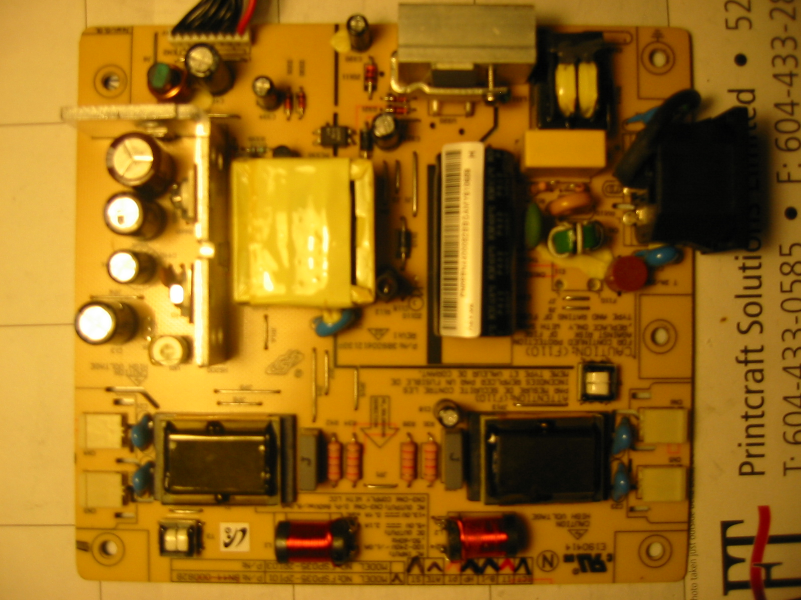

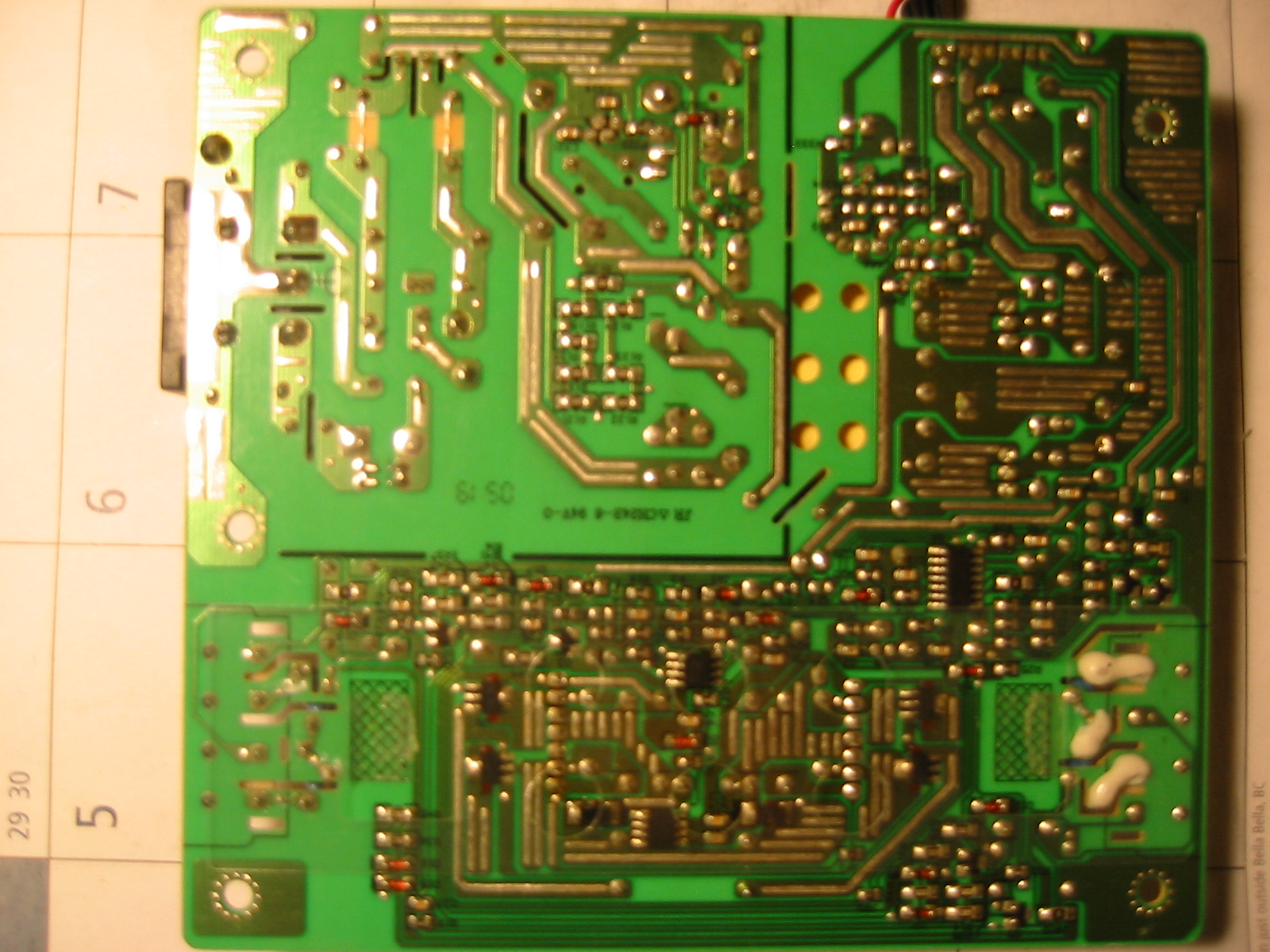

                              Update:
                              Still poking away at this once in a while. I got another 710N but it had the same issue though the flicker is at a slower rate. Swapped the power boards and the problem sticks with the power boards not the signal. I suspect the BIT3102A output but will have to borrow a scope to figure this out.
