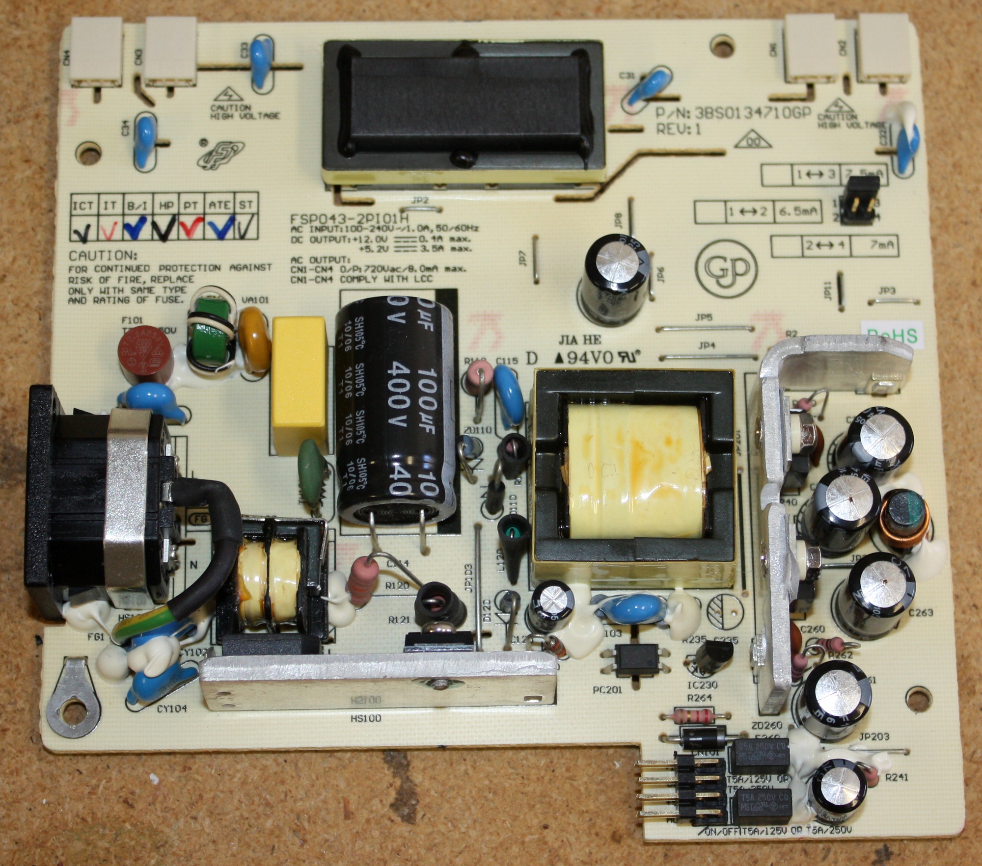

    I recently picked up 4 broken monitors on craigslist, one of which was a Hanns-G HQ191DP. It's a 19" monitor with DVI and VGA inputs, audio input with built-in speakers, and CCFL backlights.
    To open the monitor start by removing the stand and all the screws on the back. The next step is to pry the two pieces apart. This proved to be more difficult that most monitors. For some reason the bottom of the monitor was really difficult, there were times when I felt like I was going to break the plastic. Once you get the monitor apart you can access the metal cage on the back with the circuit boards. Remove the wires and some screws to remove the cage. Important - to remove the power/inverter board from the cage you MUST also remove the video board from the cage at the same time. Instead of a wire bundle connecting the two boards, they are connected by a hard link between the boards. If you try and remove one board without the other you will break this link.

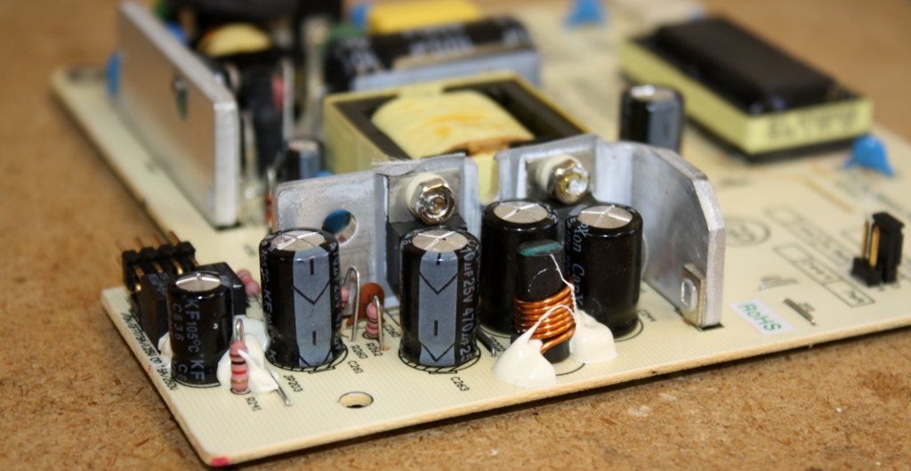

    With the circuit boards removed it was easy to spot the problem - bad caps. I didn't bother to check the ESR of the caps, I just ordered replacements for all the caps. I replaced them all with Panasonic FM series (or FC series when FM was unavailable). After soldering in the replacements ther monitor works perfectly.
    By far the worst part of working on this monitor was getting the two plastic case pieces to come apart. Everything else was straight forward. This is a good looking monitor and it will make a nice addition to my desk.

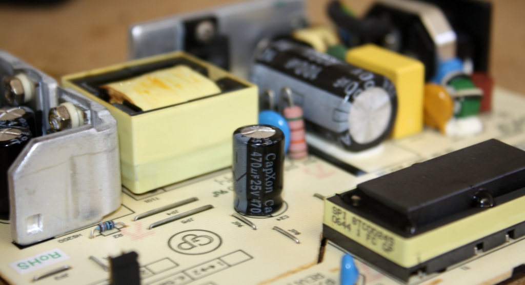

    More bad CapXons! Any idea how old the monitor is?

      The sticker on the back says January 2007 - so about 5 years old. That seems to be about the norm, most TVs and monitors I work on are about 5 years old. Sadly, if you get more than 5 years out of a new monitor or TV then I think you're doing good. Gone are the days of TVs lasting 20 years.

        My guess is mid 2006 based on the date codes of the Capxon caps. Big one says 10/06 and another smaller one says C636 (2006, week 36). So about 6 years of usage?

          5 year lifetime, assuming 8 hours/day that's 14,600 hours.
          So maybe the caps aren't failing due to poor manufacturing, but because they are genuinely the cheapest crap you can buy, and they won't last 14,600 hours at reasonable temperatures and ripple currents...
