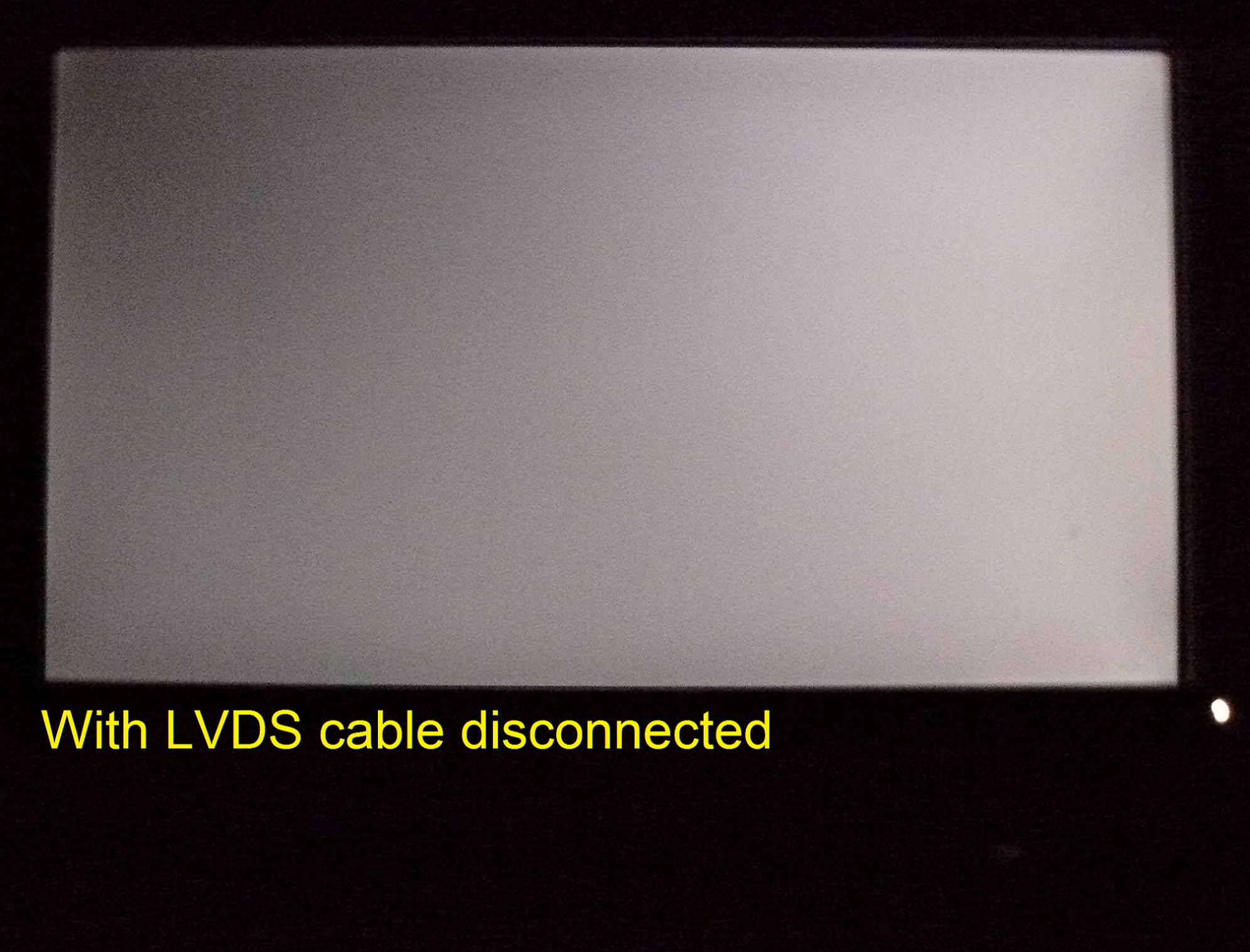

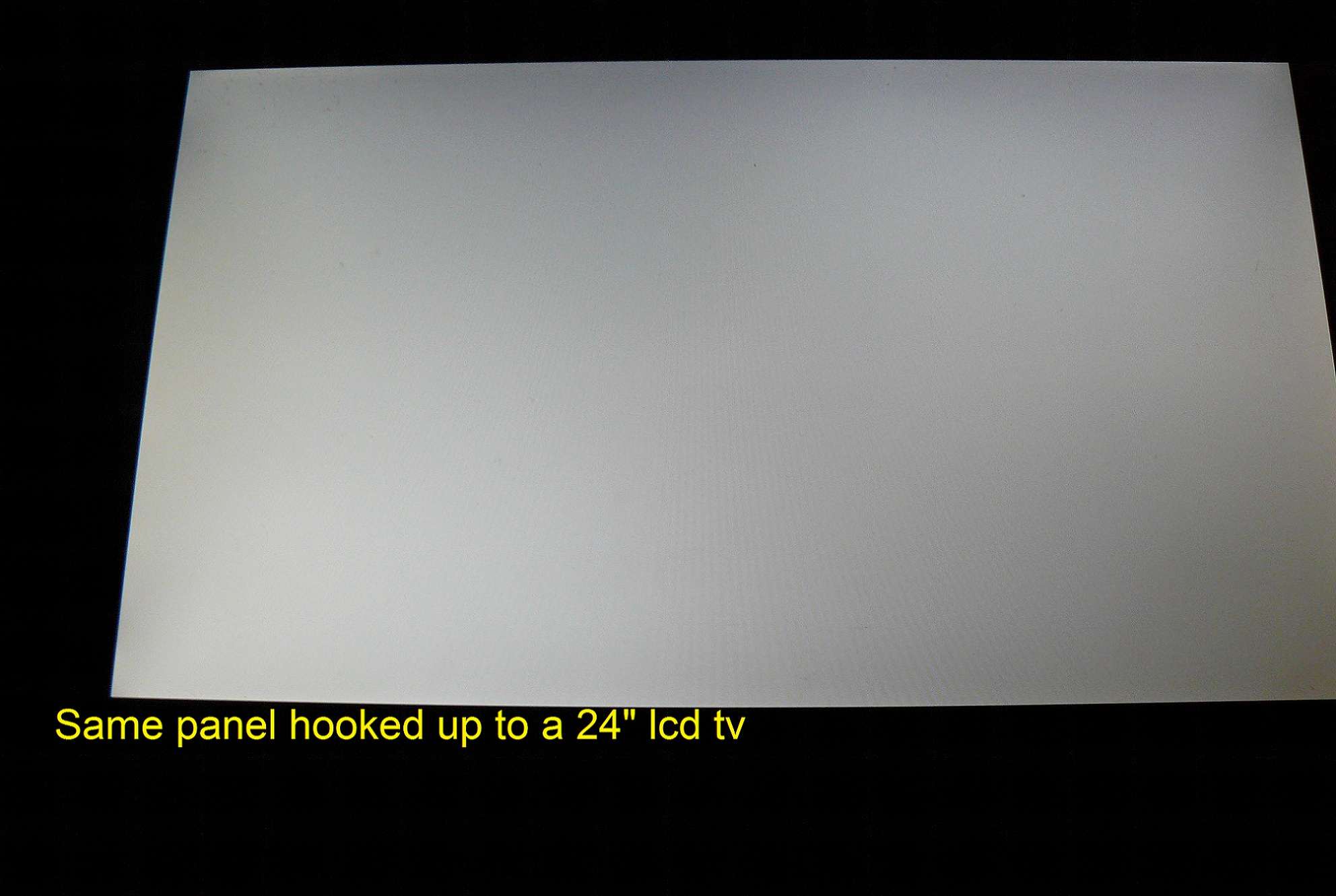

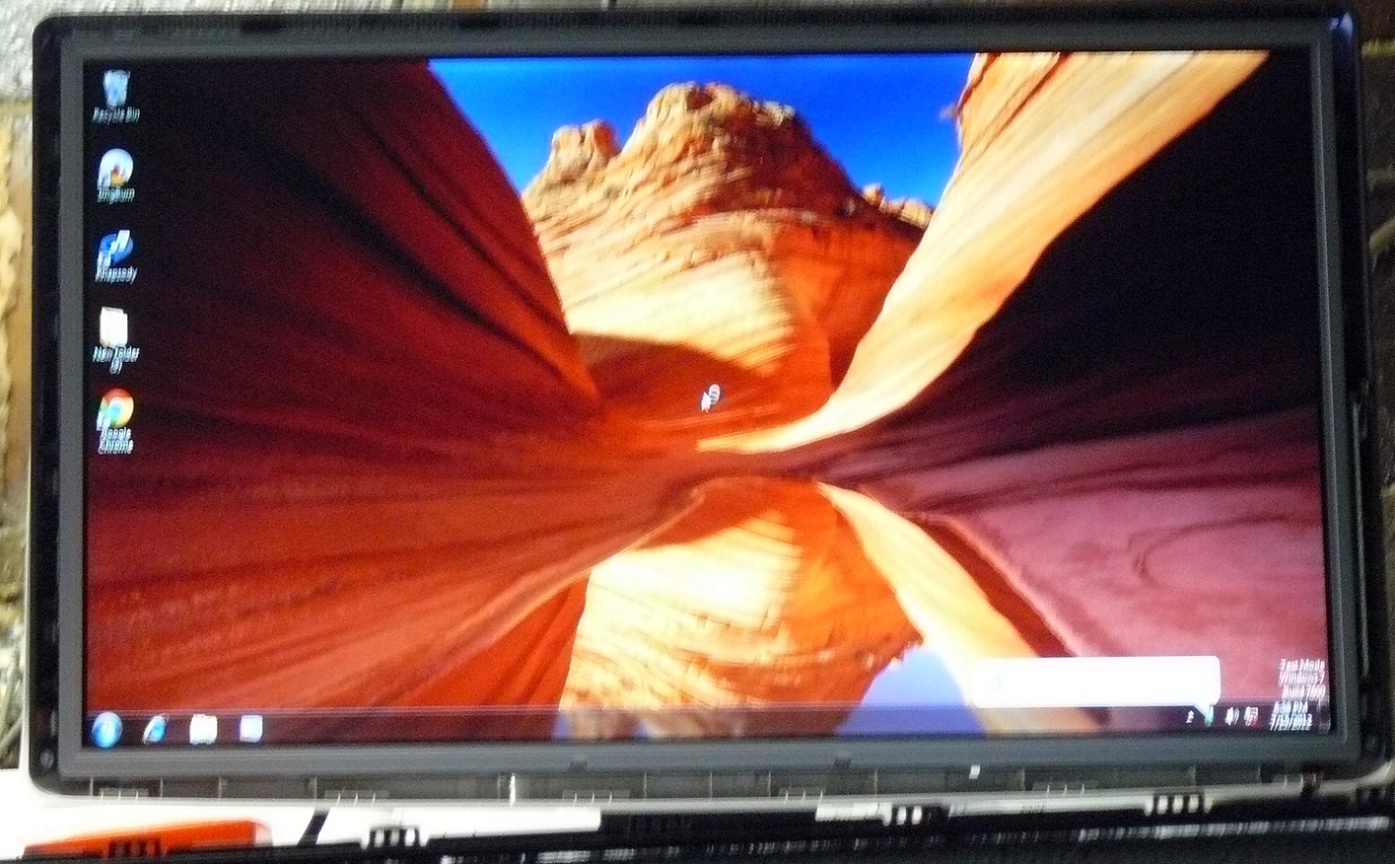

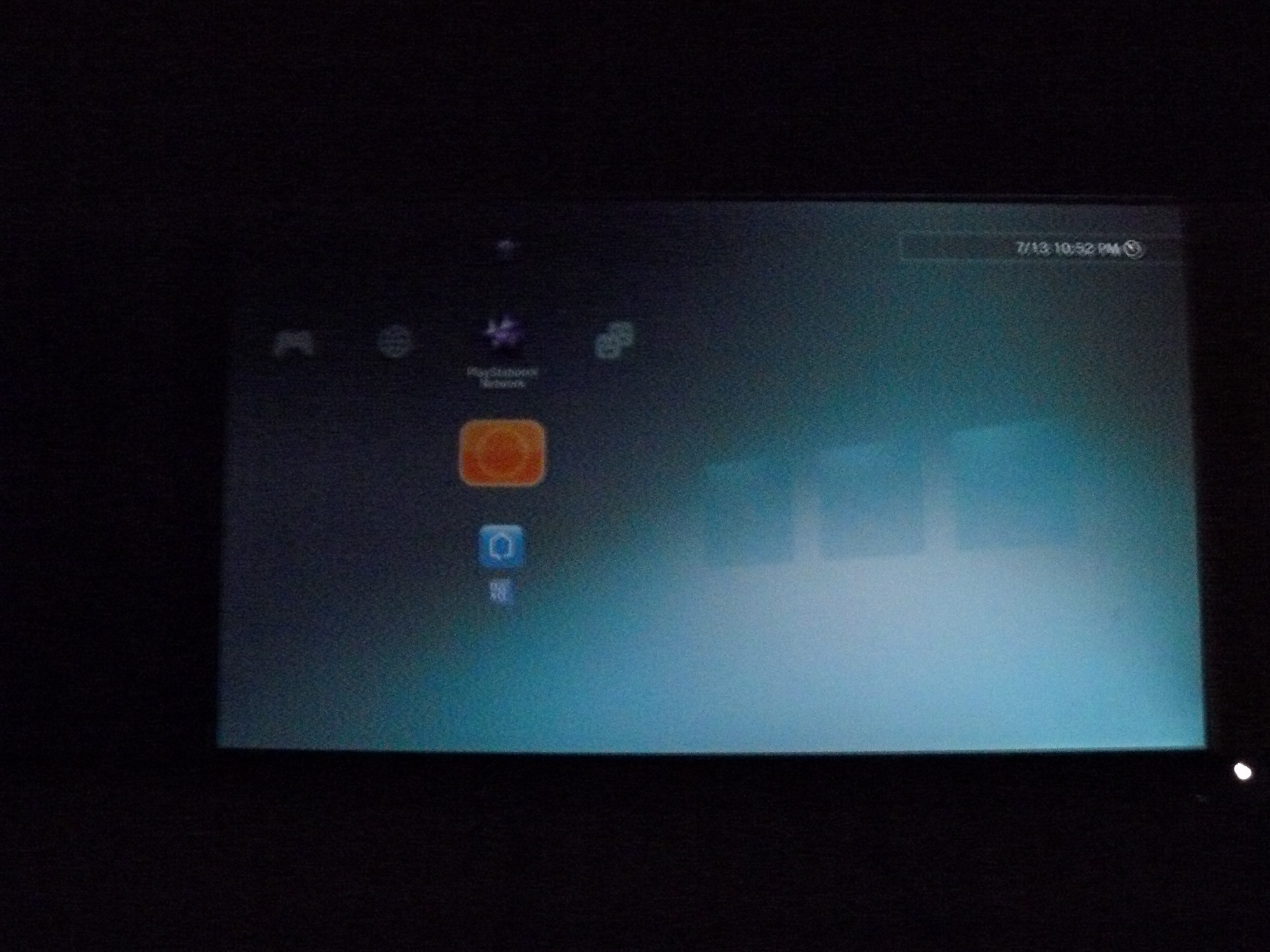

    I finally went and picked this monitor up. As you can see the bulbs fully function but the display is very dim. It uses 2 bulbs, 1 at the top and bottom. I plugged in a set of spare bulbs pulled from a 19" tv with a broken screen that was the same diameter as whats in this monitor. I pulled the panel and hooked it up to a 24" lcd tv and it appears brighter but you be the judge. Brightness control makes no difference. I tested the caps and they are all well within spec. Could the panel itself be driving the power supply down causing the dim display with a source and a somewhat normal glow with the lvds cable disconnected. I took the photos in the basement with the lights out so the pictures may look a little grainy but you'll get the idea.

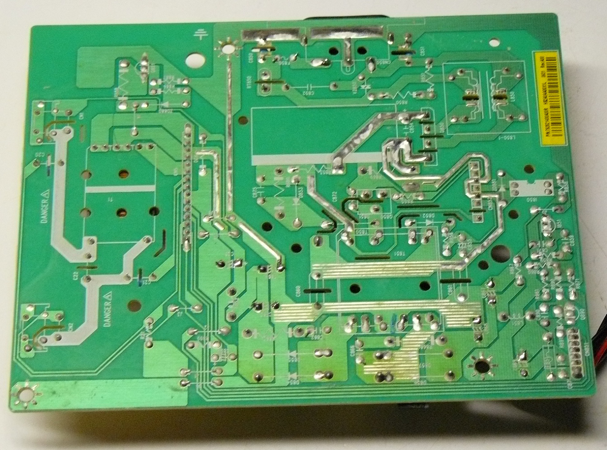

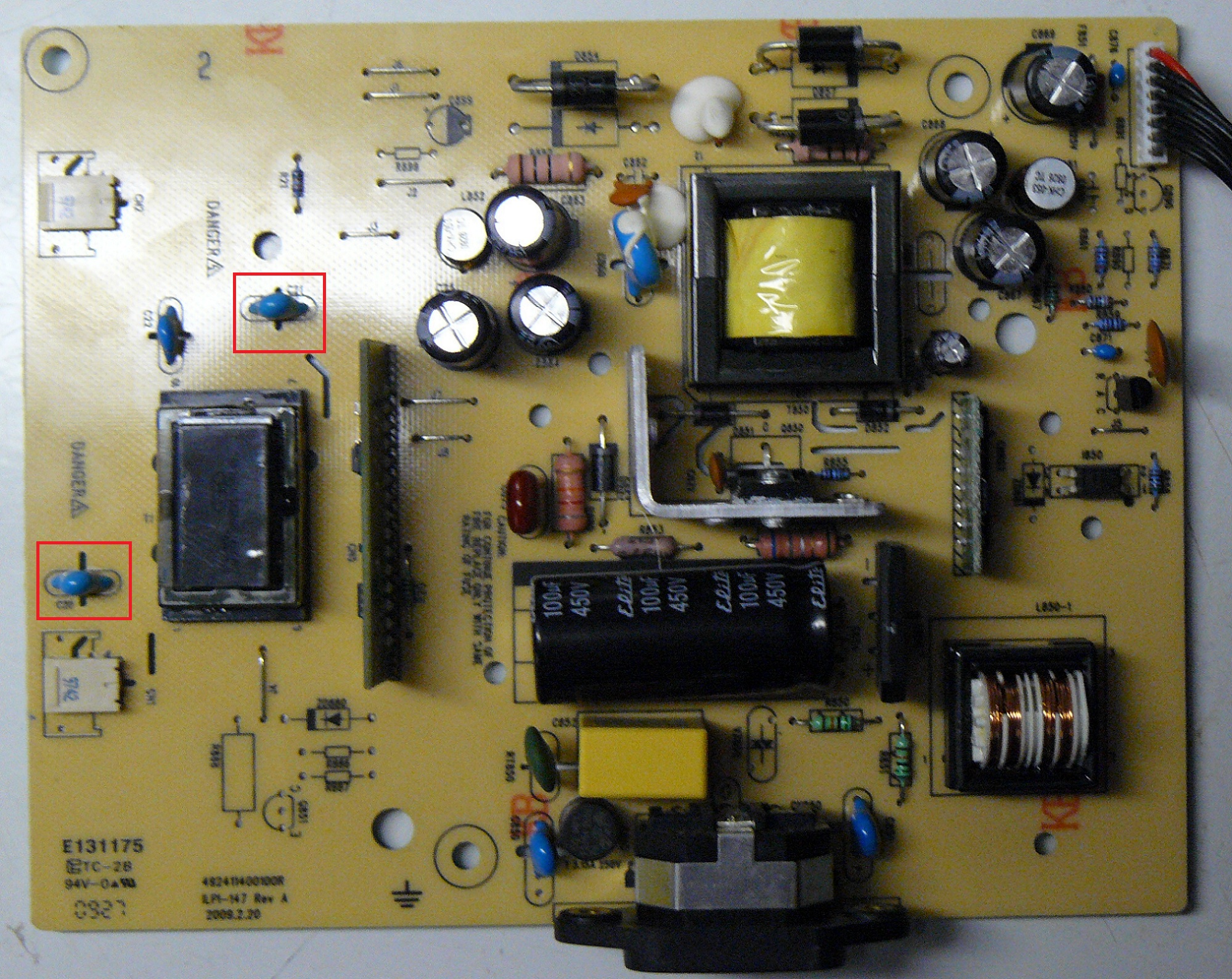

    Forgot the pictures of the power supply. What is the purpose of the blue caps by the inverter transformer? If i ohm them out, one reads 13 Mohm but the other doesn't give me a reading at all (OL)
      Re: Dell ST2010 with a dim display
      They are Ballast caps for the lamps, usually rated at 3000V or higher, it should show completely open circuit, if your meter can read the resistance, that is not good since the meter will put out less than 5V at the probes, so when these caps are exposed to about 2000V when the lamps start up, they can break down. There should be something like xxJ 3KV or 6KV printed on them.
      Not sure about the display problem, still trying to figure out your statement "I pulled the panel and hooked it up to a 24" lcd tv and it appears brighter" Do you mean, you use this Dell panel in the 24" LCD TV chassis?
        Yes, that is exactly what i did.
        So if my meter shouldn't read resistance of the ballast caps would the one that read 13 Mohm be considered bad?
          I would replace that cap, might as well do all 4.
          When you take one panel from one monitor/TV and install it in another monitor, the picture may not look right when use it in another chassis since they have calibrated that screen (White balance, color, gamma, etc. and store that info in the flash in the T-CON) with that chassis, and all the signal lines mat not be the same even the plug does fit.

            I'm going to see if i have a cap with the same rating on some of my junk power supplies. When i hooked the dell panel to the other chasis i didn't hook up the lvds cable. All i wanted to see was the bulbs on.

              Oh, I see, so the pictures are from the original Dell screen and chassis.

                  Pictures 1 and 2 are the original panel and chasis. Picture 2 is with the lvds cable disconnected from the tcon.
                  Picture 3 is the dell panel hooked up to a viewsonic power supply with the lvds disconnected from the tcon

                      How do you decode the ballast caps? What i have now is:
                      C
                      3D
                      3KV
                      I looked through my power board that were pulled from monitors with defective screens and the closet i found was:
                      5D
                      3KV
                      I checked all the ballast caps on all my boards and i'm getting OL on all of them.
                        3d 3KV = 3 pF 3000Volts, they are have to be the same value as original or it may burn up the transformer or shorten the lamp life if the value is bigger than the original since it will draw more current, smaller value than original may cause the lamp not to fire up and stay lit.
                        If they all show OL with the highest Ohm range setting, then they more likely to be OK, when they are going bad, the body will turn light brown from the heat due to resistance leakage.

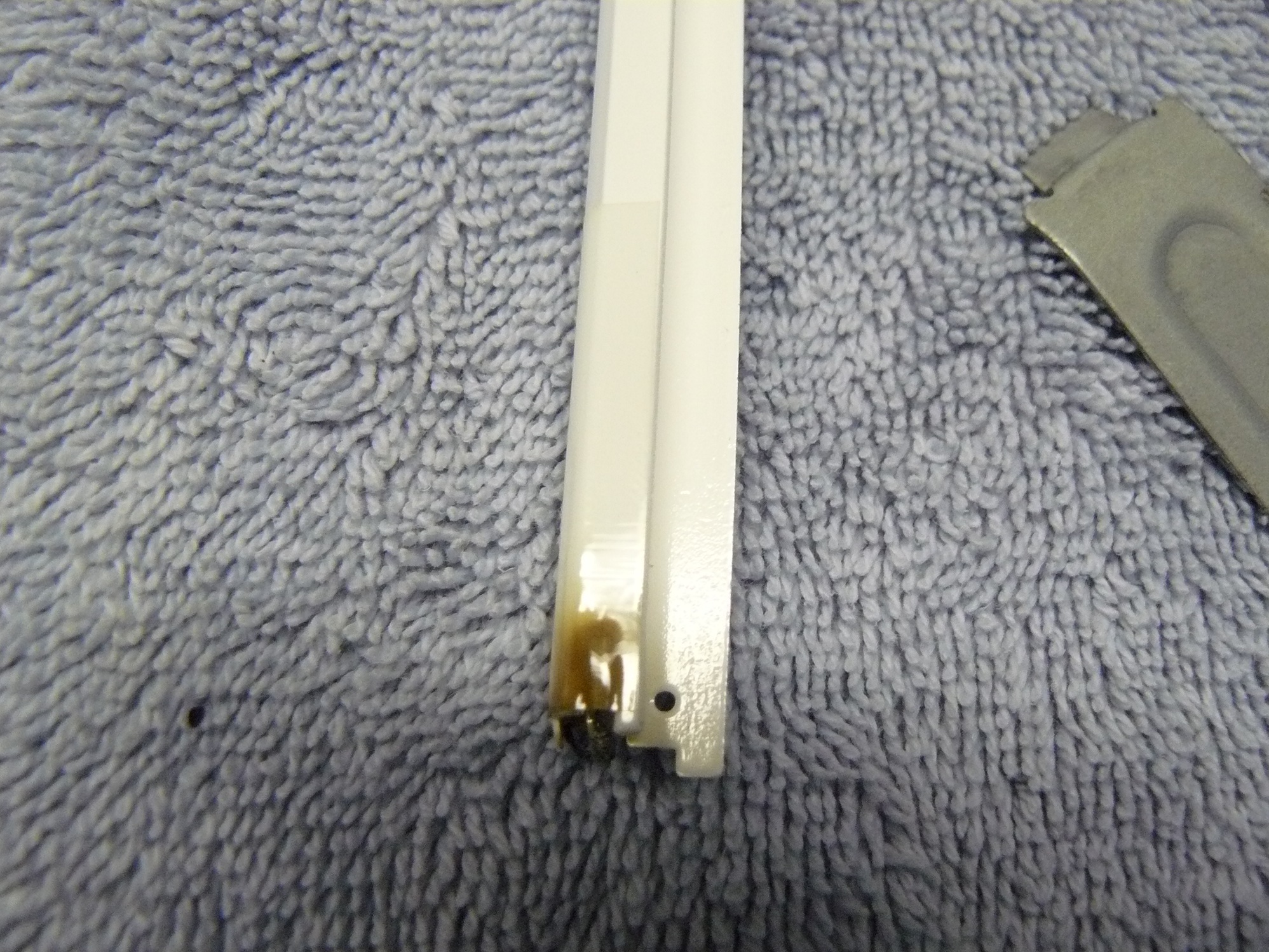

                                  I found a replacement ballast cap and swapped it out but it didn't fix anything. So i opened up the screen and what do i see but some cooked ccfl wiring. I resoldered the cooked wire and hooked it up to another monitor i had to see what the bulb looked like. When the bulbed first turned on it was dim for almost 10 seconds then it went to full brightness. So i rechecked my soldering and i broke the stupid bulb .
                                  I had a 19" widescreen spare bulb so i put it in. I'm gonna give the monitor to my mother-in-law and she's not picky. Surprisingly the monitor doesn't really show dark corners. So i don't know if the bulb was going bad but my guess is the wiring was the culprit.
                                    Sometime I do use shorter lamps, and as you see, you can hardly tell that the lamps are shorter than the original, great job by the way, you do some time have to dig deep to inspect the lamp assemblies.
