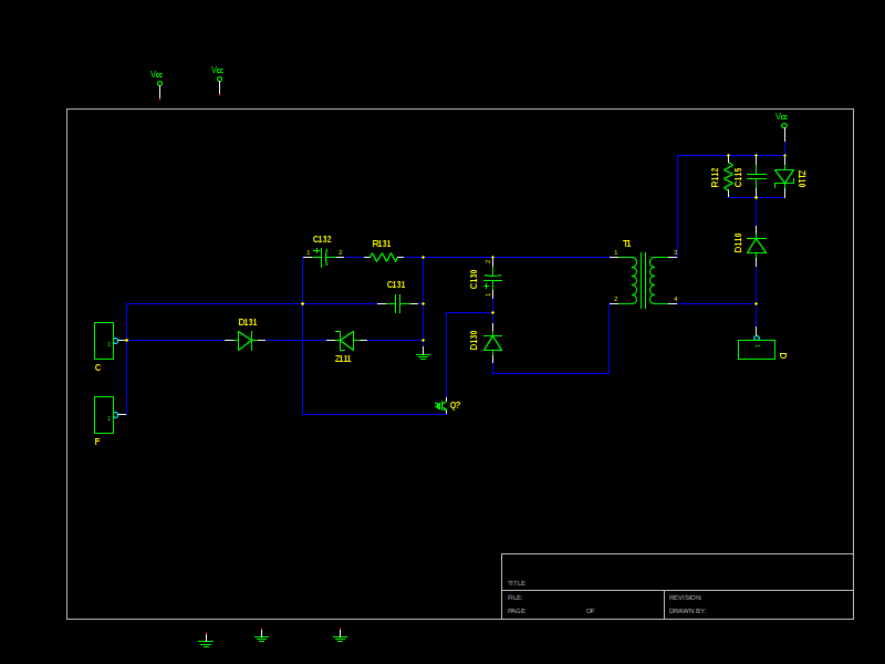

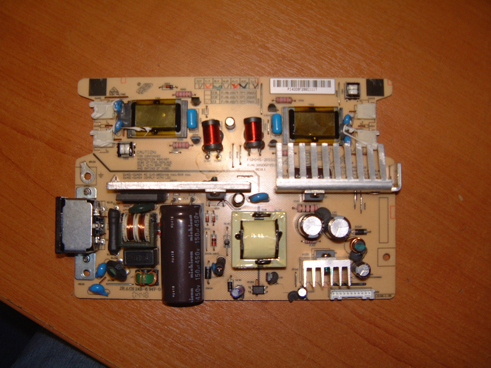

                              this is an attempt to show you how the board is organized. Capacitors C132 and C130 seem to be OK (I've replaced them also ). The capacitor C131 is SMD can't read anything on it and the resistor R131 in series with C132 is also SMD and reads 6R8 and multimeter read it 7K without the capacitor on board . All diodes and Zeners seem to work OK and C115 is a small blue tantalium I gues anyway it reads 102K 1KV 48 ! . I still can't figure out how the circuit starts !

                                See page4, 5, 6 of the spec sheet: Notes: Please check that value of that resistor that is connected between the Line (L) sense and the B+.
