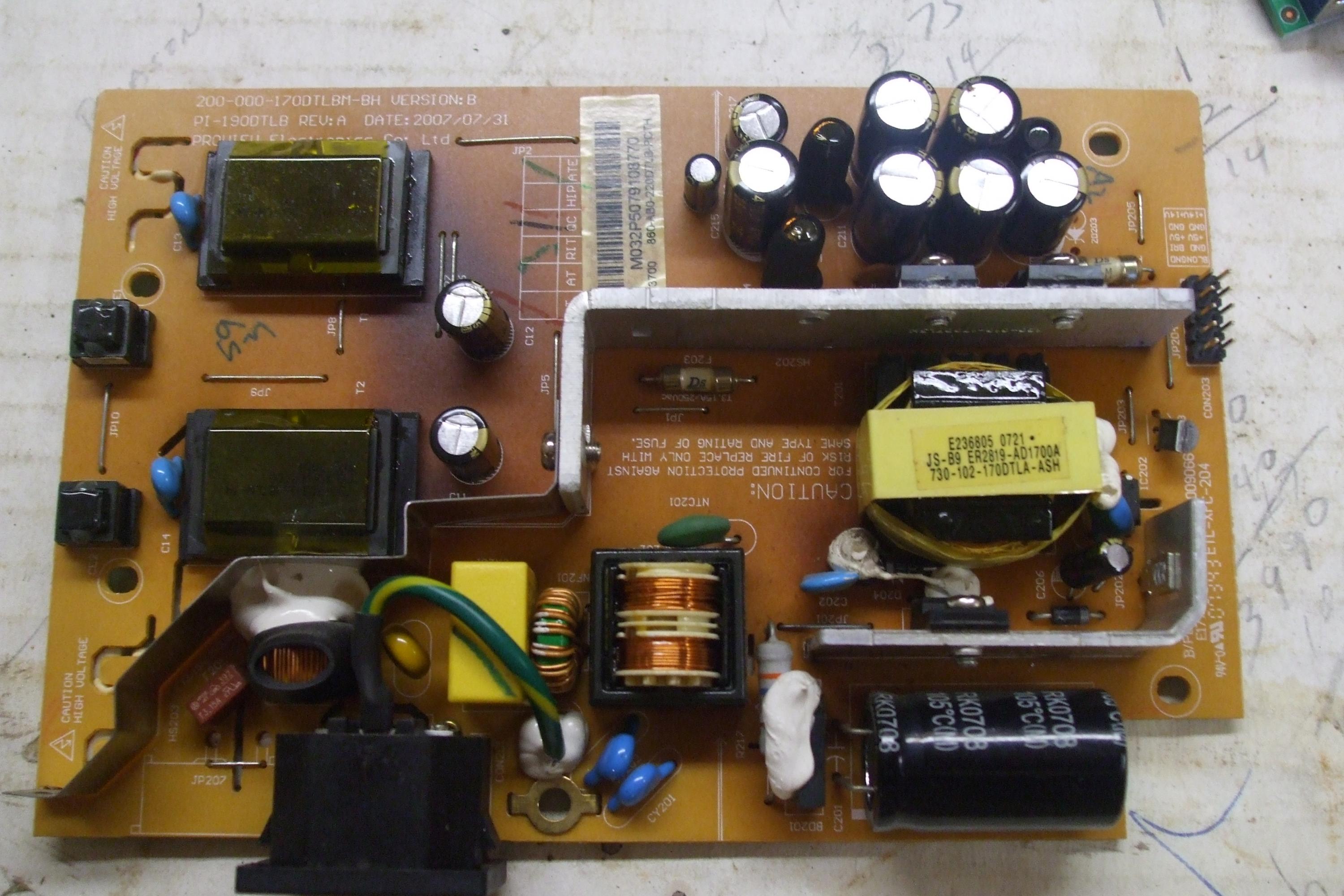

                        Measured mosfets Q5 & Q6, part # K3615 7F. With meter set on 20k, pin 1 to 2 = starts at zero and just keeps climbing, pin 1 to 3 = 5.64, pin 2 to 3 = 2.66. Both parts test the same.
                        • jetadm123
                          • 2169
                          #32
                          Re: Proview PL926Wbi, no power
                          Suggest you reconnect the main board back to the power supply and measure the voltage at the BL ON pin (at the 8-pin connector). You should see around 3V. Measure the BL ON voltage when you're pressing the on/off button on the front panel of the monitor.

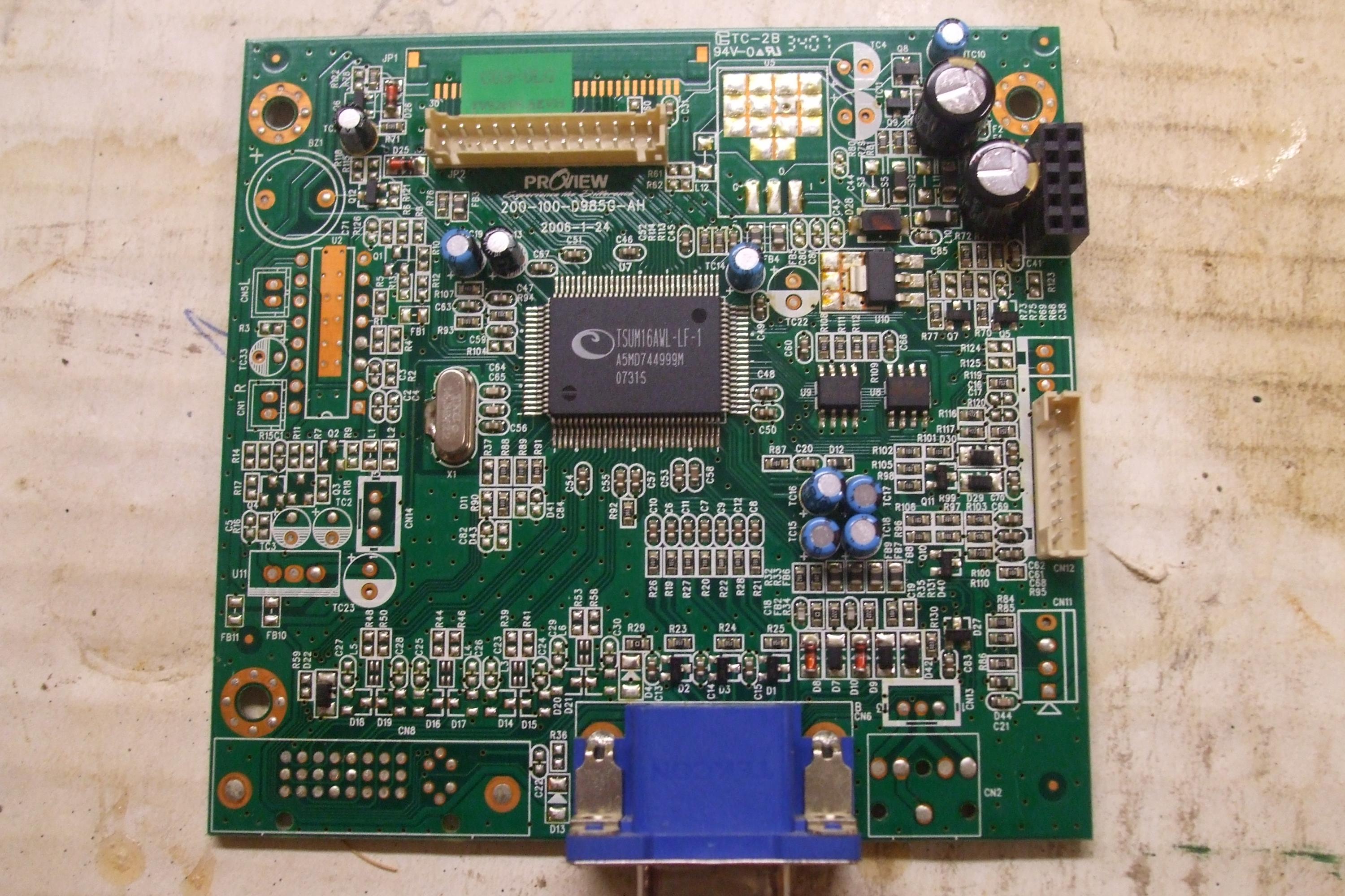

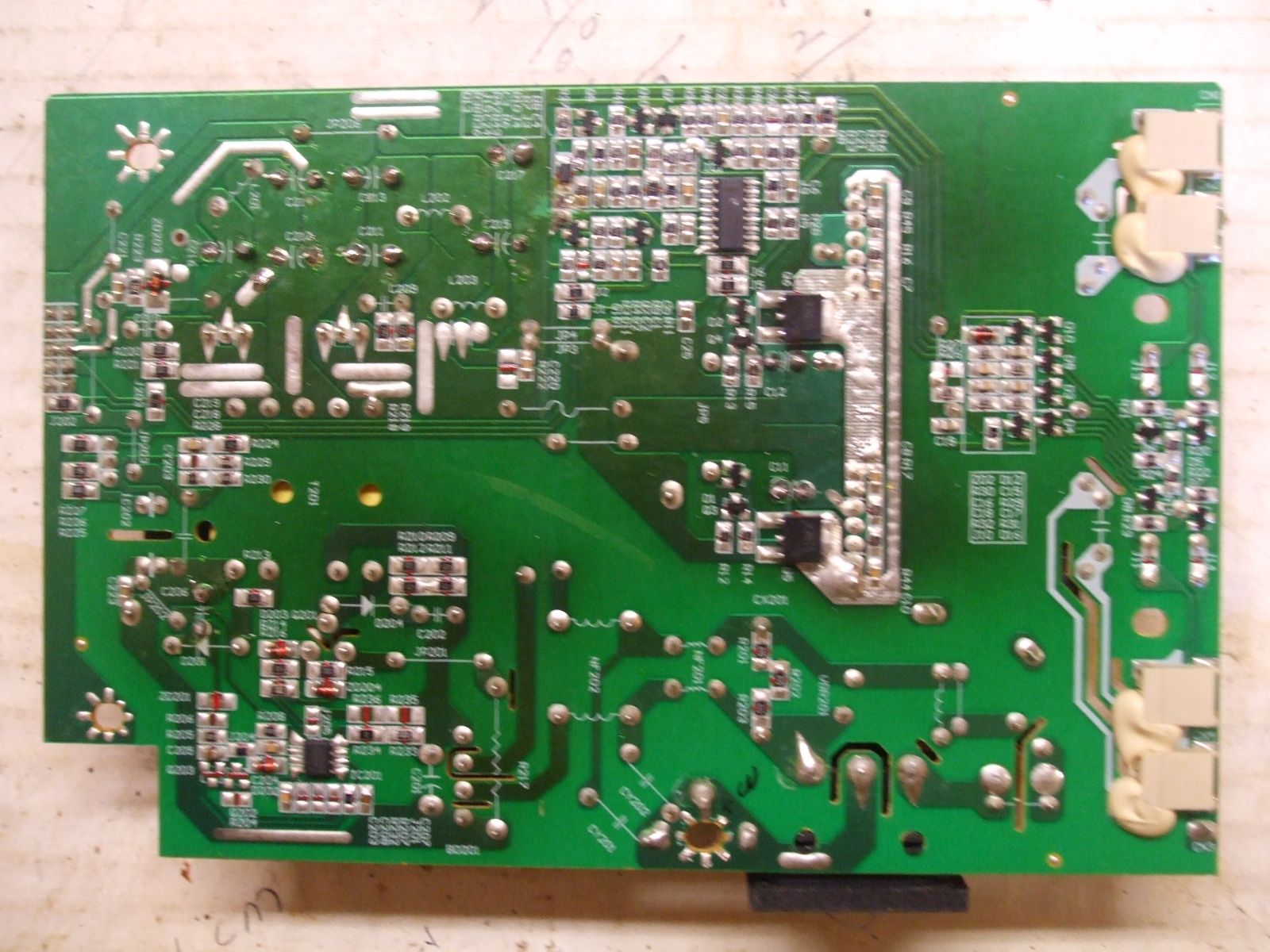

                                          #40
                                          Originally posted by jetadm123
                                          Perhaps a photo of your mainboard would be helpful.
                                          Here are pictures of main board. I didn't see how crappy my solder job was on those two caps until now. I'll clean that up. What to check next?
