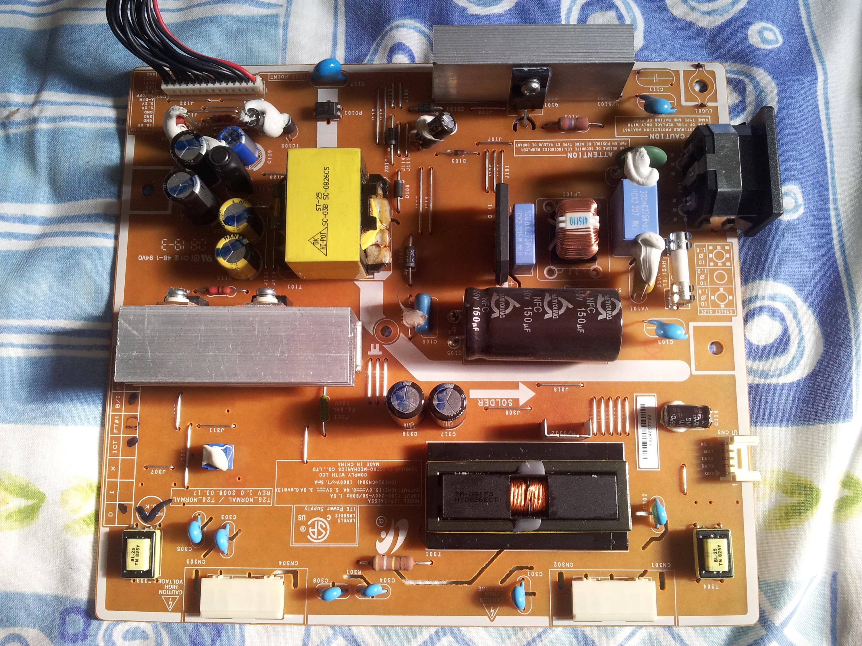

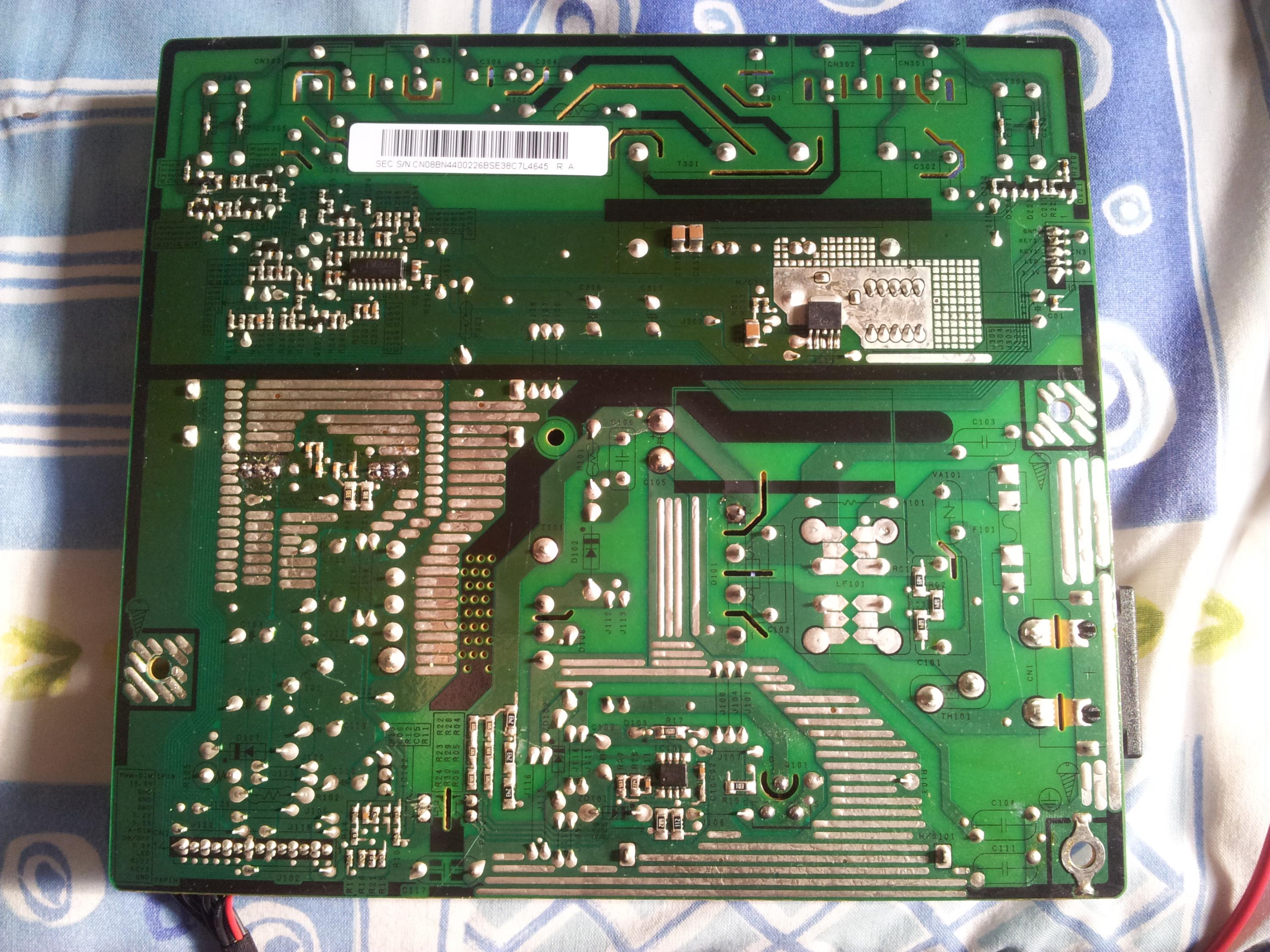

    Hi guys,
    Hope you guys are in good health..
    Its been a while since I posted for assistance. Well, currently I am having a bit of problem of locating the faulty component/s of my on-going repair. I hope that someone can lead me the way here.
    Monitor Model
    Samsung T240. Power board images as attached.
    Symptom/Problem
    -No power. No Power LED turning on.
    Plugged & measured Voltages
    - across Big cap = 330V (330V)
    No Secondary voltage whatsover

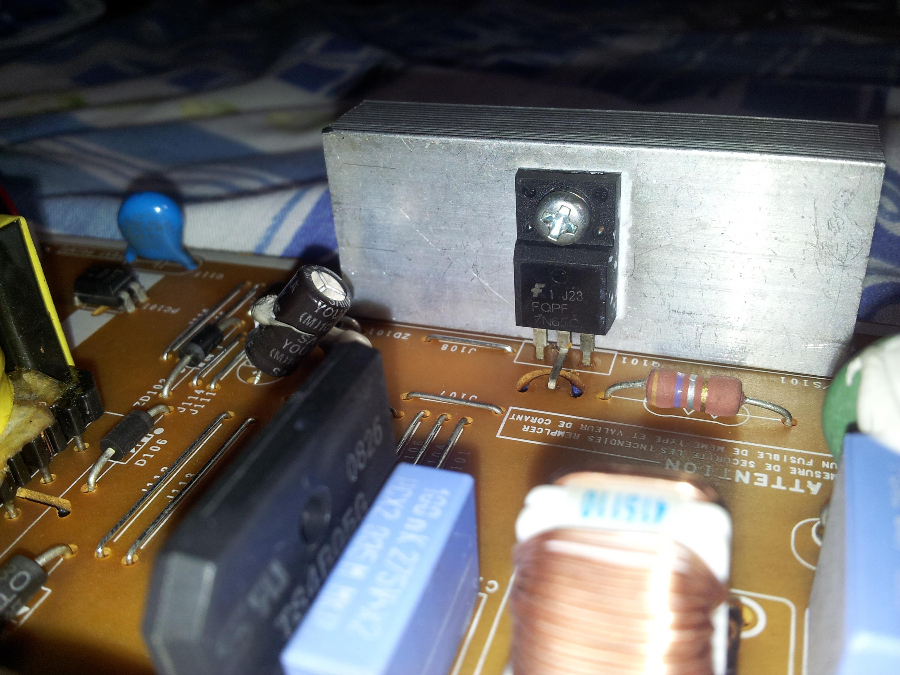

    Tracing downstream found that reading of Q101 (FQFP7N65C) are
    : D to -ve of Big Cap = 330V
    : S to -ve of Big Cap = 0V
    : G to -ve of Big Cap = 0V
    : G to S = 0V
    : Did not measure D to S as stated in the datasheet it is 650V !!!!. I could not afford to destroy my multimeter again.
    Unplugged & measured resistances
    - across R103 (beside Q101 colored orange-purple-silver-Gold) is 0 ohms (shorted). However, I am doubtful whether this is correct.
    Description/what's been done.. or not
    - Have not replaced all caps.. yet..

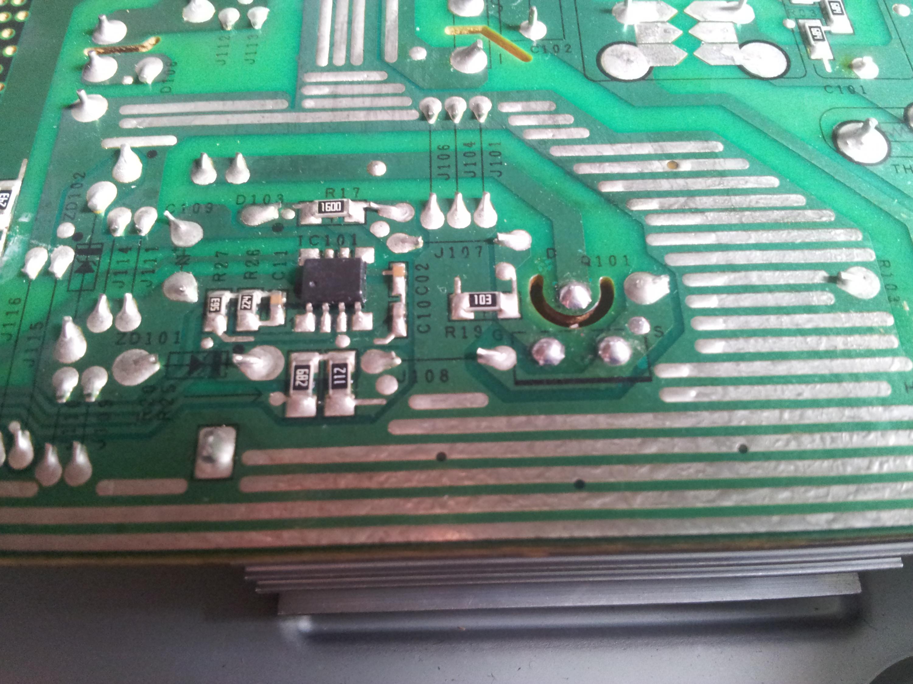

    I have trouble also reading the markings on IC101. There are 3 line on it. I could only vaguely see AN7(orV)3X(unreadable). Therefore I could not distinguish the datasheet for it..
    So am I on the right path to focus on whether the 2 components, Q101 (FQFP7N65C) & R103 (beside Q101 colored orange-purple-silver-Gold) are the caused of the fault on this Power board?. Or I am missing something else to check on?..
    Hope the experts here can guide me along.. Let me know if more readings should be taken.

    R103 being only 0.37ohms,can seem to look as though it is shorted, because of its very low value, But resistors go open circuit and not the other way.I would also take the Mosfet out of circuit and test it..the following may help if needed:-

        If the mosfet checks good, then measure the value of Vcc on IC101 (4th photo).

                    IIRC, there are a few revisions of your power board. IC101 might be a FAN7602 PWM controller. Also, try the following:
                    1) with monitor unplugged and your meter set to resistance, measure across pins 4 an 6 (Vcc and ground) to if it's shorted.
                    2) if yes, then either IC101 is bad or one of the components connect to pin 6 is shorted to ground.
                    3) from your photos, there appear to be two zener diodes. One of them is probably connected to pin 6 of IC101. Check it for a short.

                      1&2) if I remember correctly I did the resistance check but could not see any shorting on either pins to the Gnd.
                      3) aaah.. ok.. I will check it for shorts (in-circuit) when I get home from work.
                      Also, I have looked up FAN7602PWM controller datasheet. Pin 8 (Vstr) is mentioned to be 600V but I am having 244V only on that same pin.. So I am not sure is it the correct controller or mine is just bad.. hmm.. I was thinking of removing the IC101 & pass it to someone here who has a microscope so that the marking on it can be ascertained. But the cons will be that I will probably destroy it & will be in trouble if the marking could not be figured out.
                      What do you guys think?

                            For Vstr, the max voltage fed to it can be up to 600V. The 600V is not what you should expect to see. If I looked at the same datasheet for the FAN7602 as you, then on Fig 25 you will see that Vstr (pin 8) is connected to your 330V through a resistor. There will be a voltage drop across that resistor, resulting in a lower voltage at pin 8.
                            Since you changed the startup cap and if you don't see any shorts on components connected to Vcc on IC101, then I would suspect IC101 is bad.
                            Also, have you checked Q101 for shorts yet?

                                    Ok guys, here are the diode readings taken in circuit with power unplugged:
                                    Diode Reading 1 - Reading 2
                                    ZD101 1097 - 626
                                    ZD102 (flash a number then no reading) - 626
                                    D103 159 - 159 (could be due to R17 in between it)
                                    D106 (flash a number then no reading) - 571
                                    D102 (no reading) - 532
                                    D107 (diode near R105) (rising number then no reading) - 705
                                    I also did it on Q101
                                    D-S (no reading) – 575
                                    D-G (flash a number then no reading) - (flash a number then no reading)
                                    S-G (flash a number then no reading) - 887
                                    Voltage across the start-up cap is the same when the main board is unplugged. If my understanding is correct, I could not see any shorting on the above diodes.
                                    Jet, you are right. On my board there is also 3 SMD resistors (243) in series from the 330V to pin 8 of IC101. That could explain the drop in voltage.
                                    Yes, retired. This is one of the better boards to work with. I had encountered some boards which will have the copper traces lifted when I desoldered the components. The boards I hate the most are those with no indicator on the connector of the secondary voltages pins to check on.
                                    So any final thoughts, before I conclude that I should remove the IC101 from the board?
                                    p/s : Retired, really appreciate you asking the other OP (Snev) on the IC101 marking. Would have done the same if you have not already done so.. thank you sir..

                                        D103 is suspect. I would remove it and retest to verify R17 is not affecting it.
                                        BTW, the units above are in millivolts when the multimeter is in diode test function.
                                        It doesn't look like Q101 is shorted, but that doesn't mean it is working properly.
