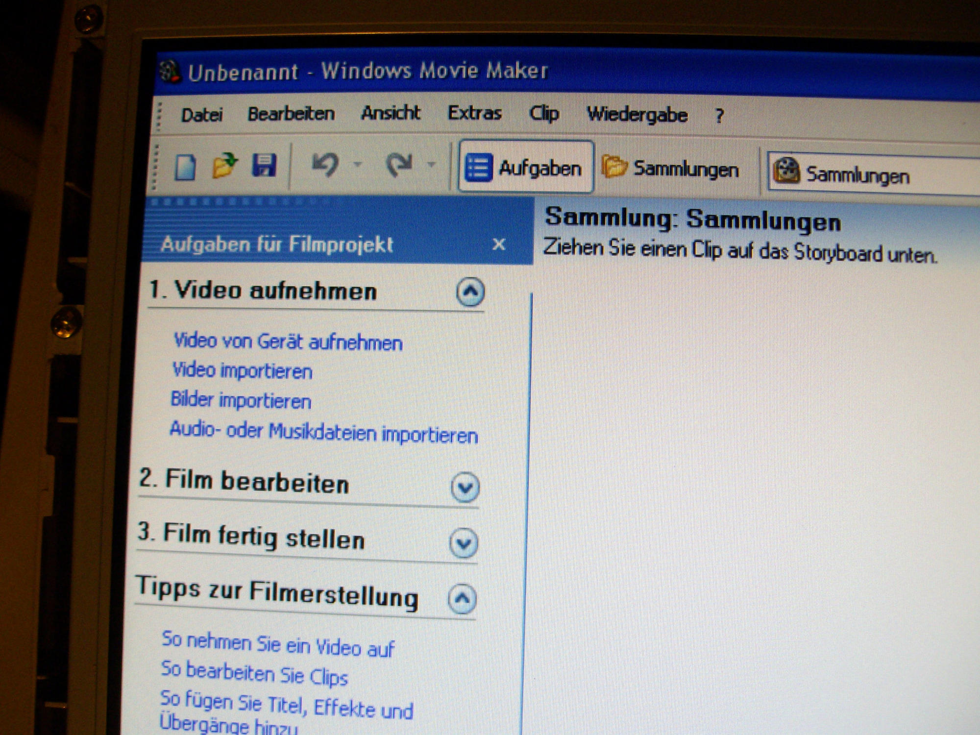

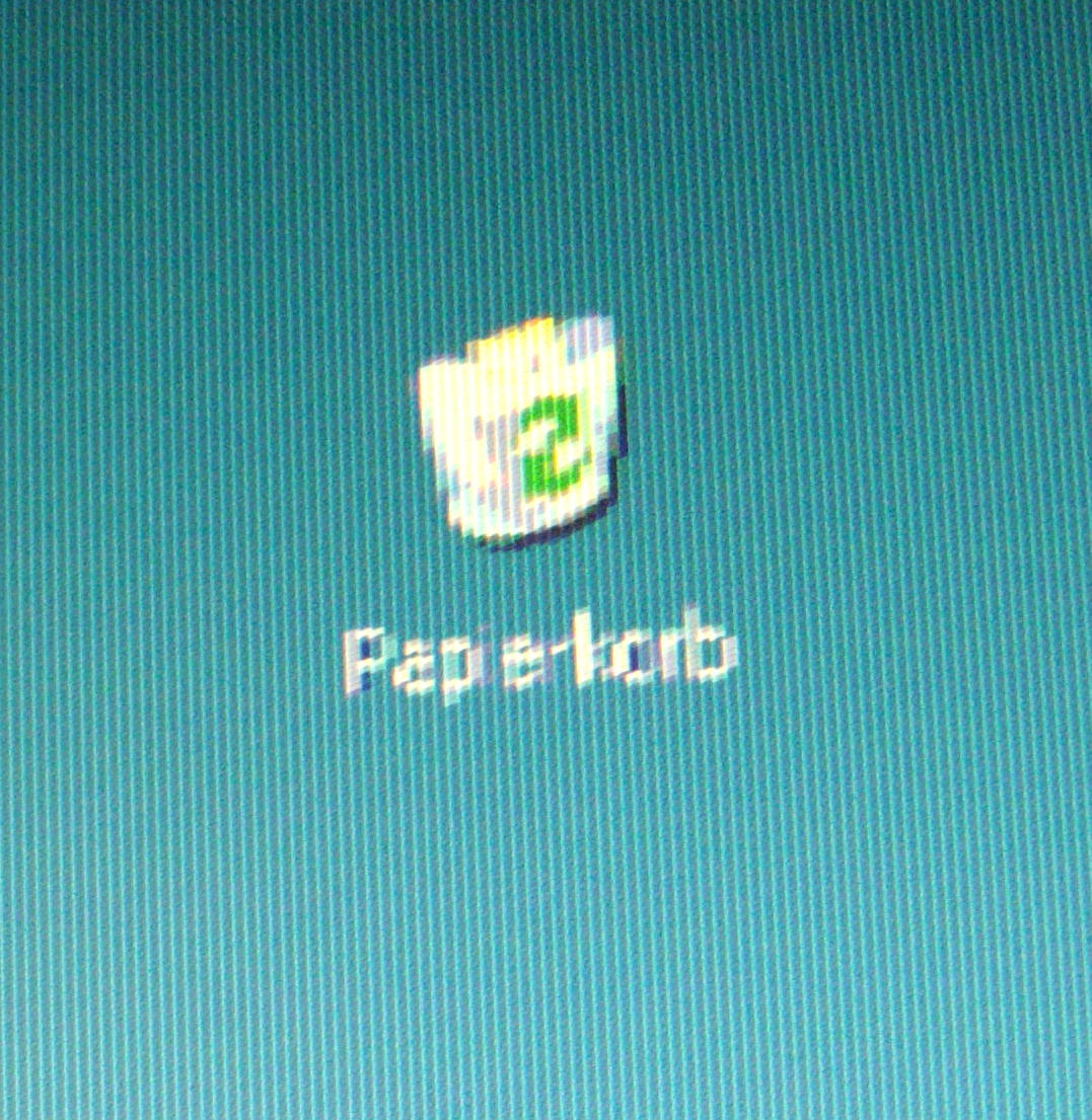

    Hallo,
    after connecting a Xerox 700P to the computer, I got a very poor screen-picture. That seems similar to 8-bit resolution, but is for sure something else. Is that symptom known by someone? I put 2 pics into the attachment.
    Cheers

      Re: "poor Screen" on a Xerox 700P
      Hi jetadm123,
      yes of course I did. That was one of my first thoughts. But the resolution during this two pics were made was 1280x1024 with 32-bit colours. That is definitely not the errors cause.
          Hallo retiredcaps,
          thank you for your "tough-tip". Actually the item 2 was the bug-killer. I repluged everything on the mainboard and also put the MCU out of the socket for to polish the contacts. After back plugging I got full colors! Great!
