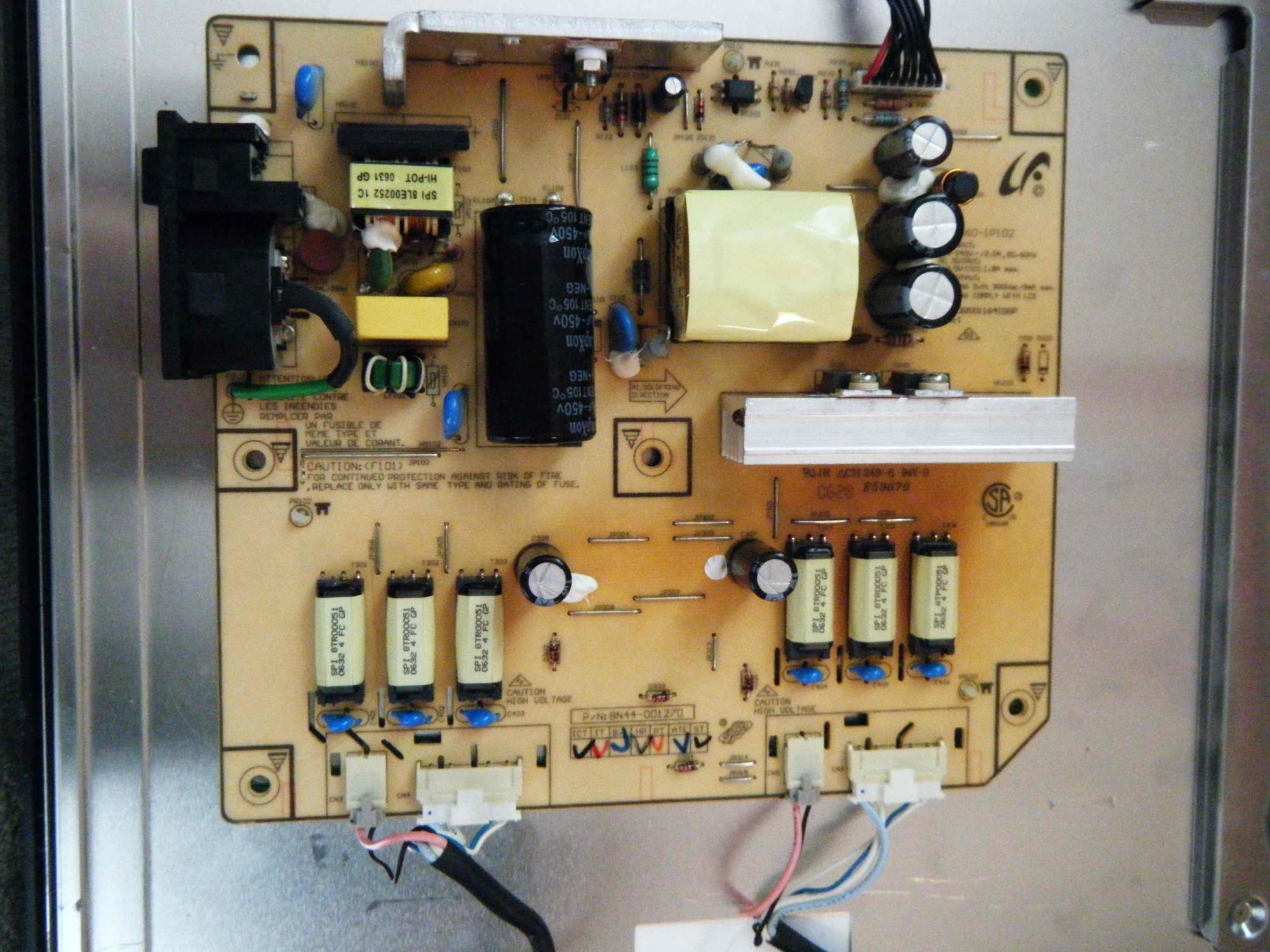

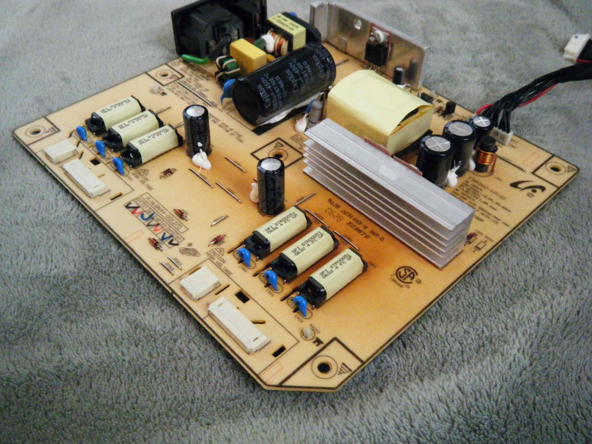

          Just seen the pic the inverter caps look a bit bulged (Are They) and they are capxon?
          Not sure that that would affect the colour though.
            Yes they are CapXon, with them the monitor is blue/green at first, then it slowly changes color to red over a few secs.
            I have replaced them with good rubys and Nichicons but now I am having this red picture problem :/

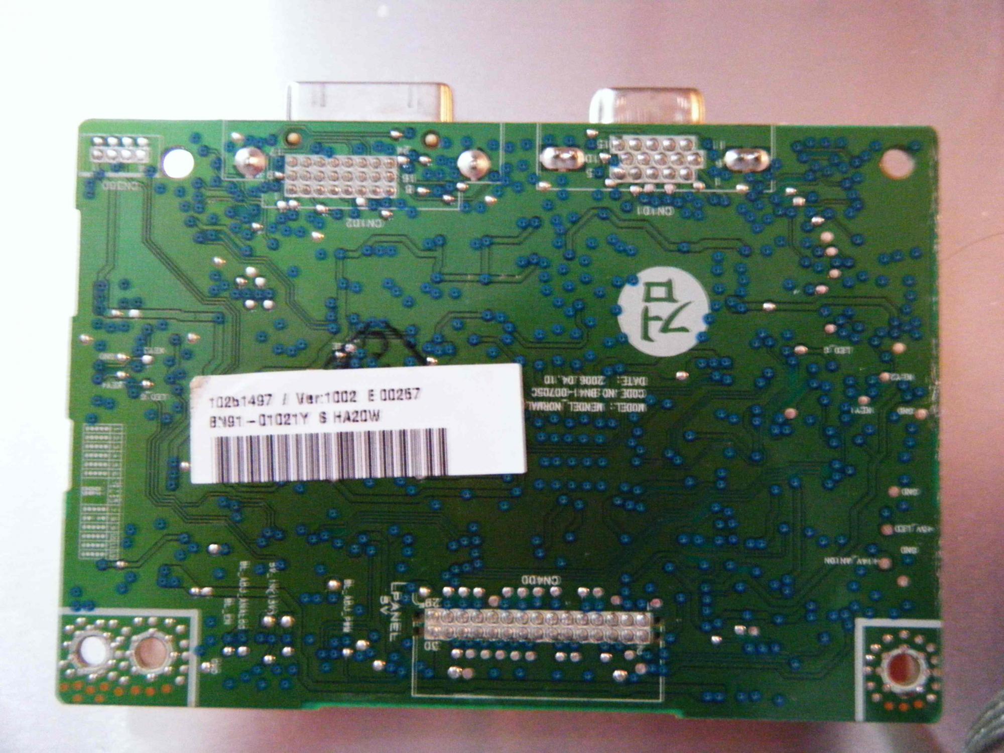

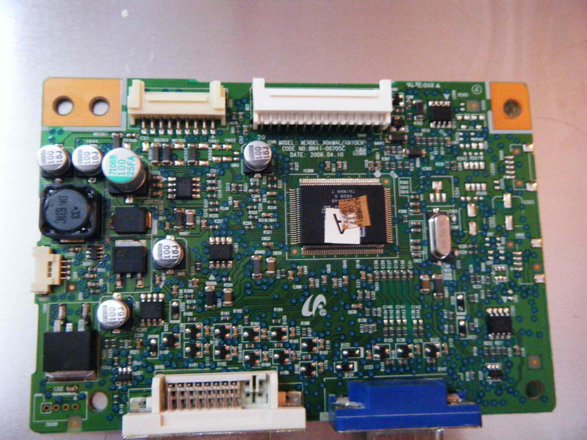

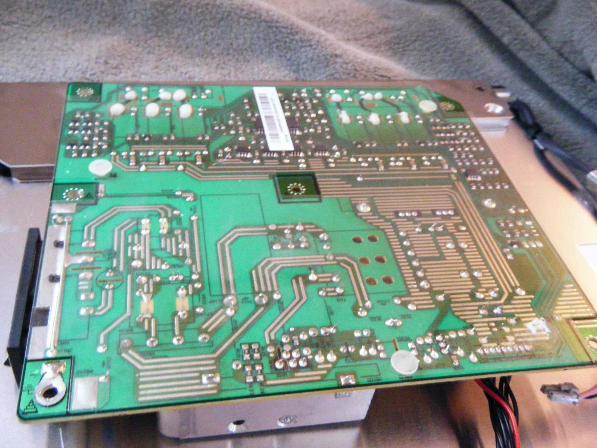

                  Can you do picture front and back of the other boards.
                  • ben7
                    Capaholic
                    • Jan 2011
                    • 4059
                    Re: Samsung Syncmaster 204BW
                    1. PSU front
                    2. PSU back
                    3. Mobo front
                    4. Mobo back
                    I was having trouble getting good pics with the light in my room, so I might have to take some more later, if you want xD
                    Edit: I had trouble getting good focus on the T-con board

                      Originally posted by ben7
                      Ok, 13v reads good, 3.3v reads good, and ?1.5v? reads 1.6v; all measured on the logic board. :/ As far as I can see, all fuses on the board read good also.
                      Did you read the 3.3v and 1.6V output directly off the voltage regulators on the logic board? The 3.3V sounds good. The 1.6V regulator might be labeled something like 1117-18, which indicates a 1.8V output. If yes, then the 1.8V regulator looks a little off spec and would possibly indicate a bad regulator or bad output cap.
                        Aha, it is 1117
                        I looked up the data sheet, and it came up with an adjustable LDO, but I might have found the wrong one.
                        Muh-soggy-knee
                        • jetadm123
                          • 2169
                          If there's a '18' stamped on the regulator, then it's fixed output. This regulator is made by many companies. You can use the datasheet below as a reference:
                            If it is adjustable then take the reading between pin 1 and pin 2, it must be 1.25V if it is OK.
                            • ben7
                              Capaholic
                              • Jan 2011
                              • 4059
                              Back, it does have 18 stamped on it, and its outputting 1.6V not 1.8V. Do you think the regulator could be bad, or could something be loading down the output?
                              Muh-soggy-knee
                                That is 11% off, yes the really heavy load may cause the problem or just bad regulator. I would try a new one.
