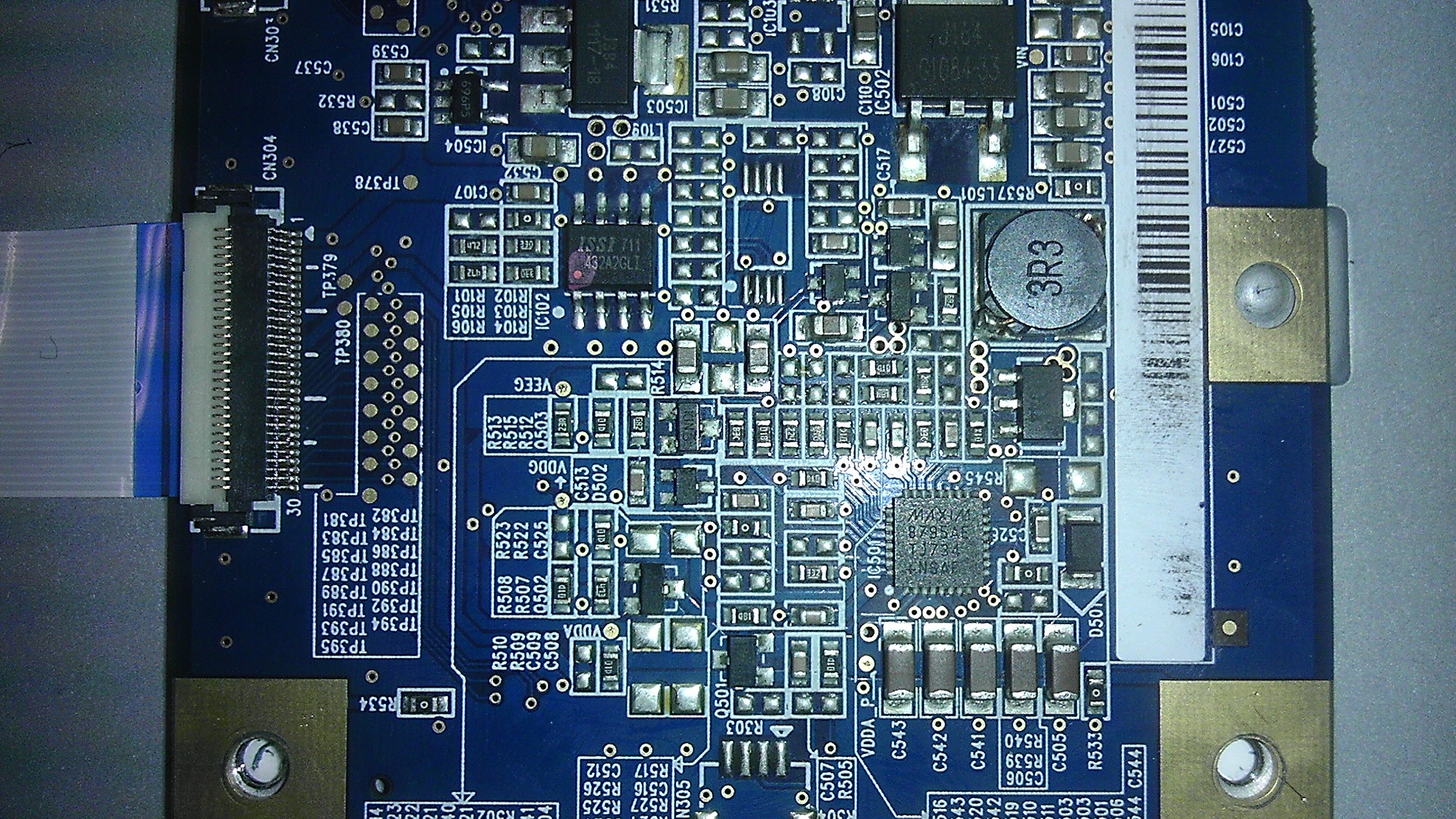

                  • danikd
                    • Oct 2011
                    • 6
                    Re: Samsung Synchmaster 2693HM WHITE SCREEN [Part 2]
                    Hello, newbie here
                    Pls, need advice from you, more more experienced users...
                    Same type of LCD, slightly different t-con.
                    LCD start with white/light gray screen and still in this state ...
                    Power board seems to be OK, inverter too.
                    Readings from T-Con are :
                    VDDA_P - 59,3k/13,02V
                    VDDA - 5k/13,02V
                    VDDG - 100,4k/26,8V
                    VEEG - 41,9k/-7,1V
                    VCCD - 8,7k/1,79V
                    VDDO - 1k/3,33V
                    I check SMD caps around Maxim 8795AE, multimeter tips on both end of cap, measured resistance and continuity - seems to be OK.
                    Photo of part of T-con attached, sorry its from cell phone, no chance to get better.
                    Any idea?
                    Sorry for my english and
                    Thx for help and your time
                    Nice day!
                    Daniel
                    • danikd
                      • Oct 2011
                      • 6
                      i changed MAX IC and still the same Any Idea? Thx for info ... Daniel
                        Woops sorry I missed your first post. Those voltages and resistances seem okay, so the problem on the T-con likely isn't power-related.
                        I see there are 4 other ICs on this board besides the main chip and the MAX IC.
                        Namely, two 2902 (quad op-amps), a 2904 (dual op-amp), and another chip, IC102 (can't read part number). I doubt anything could be wrong with these, but you can try changing them anyways. The 2902s and 2904 should be fairly cheap as they are just common op-amps. The last IC, I don't know.

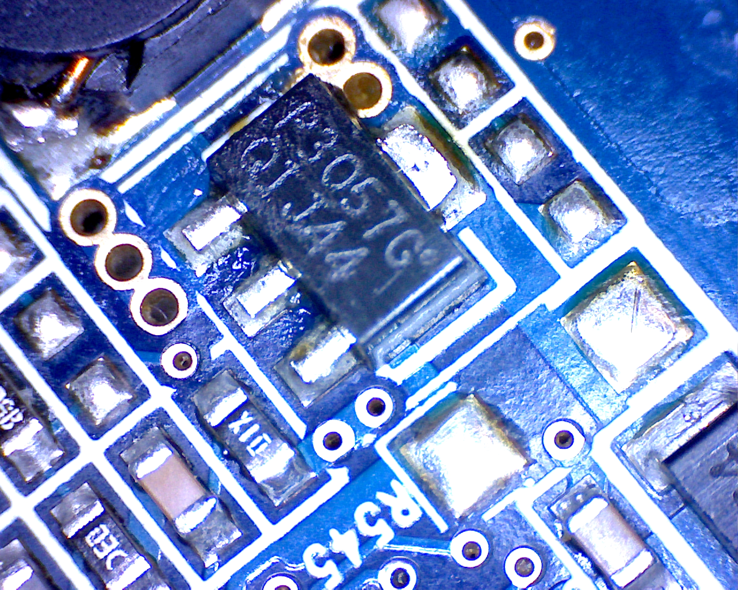

                        • danikd
                          • Oct 2011
                          • 6
                          Hello momaka,
                          Thx for reply. Tomorrow i will check it. Yesterday I only check IC around MAX for short ( if ground is shorted with another pin ) and the IC near coil - P3057G seem to be shorted - pin1 (gate) and pin2 (drain) are shorted.
                          And that is not good, I am right?
                          See attached photo.
                          IC is P3057G it seems to be P3057LCG - SOT-89 from NIKO-SEM
                          Datasheet attached.
                          But I cant find it on ebay, only on alliexpress and its about 1 month to arrive.
                          I I want to repair this LCD for my sons room for Christmas
                          Do you know some common replacemnet for this?
                          Thx for info and apologize for my unexpreinced questions...
                          Daniel
                          PS : IC on the left side isnt burned, its only flux residue from desoldering MAX IC. ( Tomorrow I will check it again ).
                            master hoarder
                            • May 2008
                            • 12175
                            • Bulgaria
                            See attached photo.
                            That may be normal, actually.
                            Years ago, I fixed an HP w19b LCD that also had a white screen issue. It had a transistor for the main boosted rail that appeared shorted same way as yours (Gate to Drain). Turns out, it wasn't. Just the way the T-con boost circuit was designed.
                            This is the thread if you're interested (particularly posts #1 and beginning of #2):
                            https://www.badcaps.net/forum/showthread.php?t=12210
                            But if you want, it probably wouldn't hurt to remove the transistor and check it anyways (unless you think you'll destroy it by doing so).

                              Momaka, you are right, i desolder the IC and its PCB design, IC is not shorted ... I try to replace amps ... Daniel
