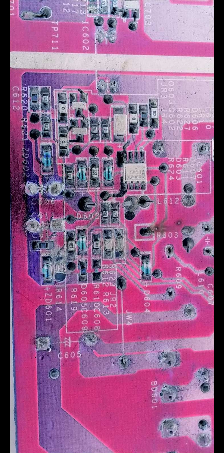

      Guys.. a little help would be appreciated. I have burnt power board of Dell 2007WFPB. This Board has burnt SMD resistors, the Board number is 4H.L2J02.A04. I have attached image of the board. if anyone could get me a clear picture of the board from bottom, kindly attach it with your reply, I am in a real need of the smd resistor codes on the bottom of the power board. The image for Reference has been attached with this post
        Here is a diagram that should fit

          #124
          Re: Dell 2007FPB teardown
          but its for Dell 2407 not 2007 plus I'm New in this Field . If you could really help with the area in the red Square. That area is burnt ( Resistors and A zener diode) if i could get the codes, i could replace them all. If you or anyone could arrange a Picture containing that area so that i could get smd resistor codes, I would be really really Grateful
          The image of the burnt Part of PCB has been attached with this Post as well

            #125
            So you write what serial numbers of resistors and zener diodes burned on the board, for example: R623, R613 .... and so on and I will write you the smd code of these resistors according to the scheme

              #126
              Me thinks the upper two which you selected are for the two components on the left side. For those two in the right side also the right two numbers apply. That would be JR2 and R613 I guess.

                #127
                It is hard to see from the photo what else has burned out, but if these resistors burned out, then most likely Q601, IC601 and something else burned out

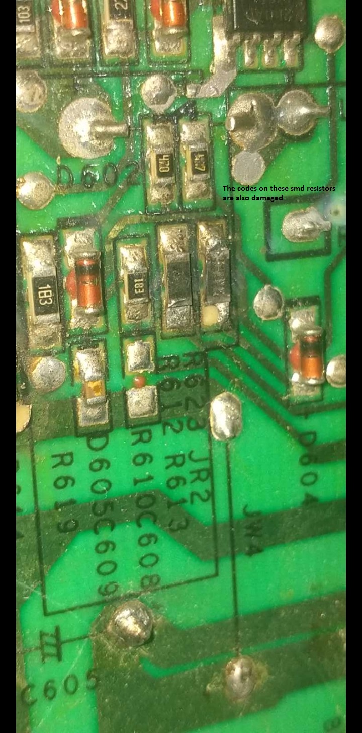

                  #128
                  I am so sorry for the image, I only shared it for Reference, Just to point out the Faulty resistors and zener diodes. I will upload full focused Image and images from different angles so that you get a clear image of the problem I have with the board. I will upload Complete set of Images of the board and the damaged part of the board with enough focus that you can clearly see the Resistor codes aswell as the Damaged Portion.

                    #129
                    Today I took the Images from Closer look of the board. The Codes are pretty Clean. There was also some kind of Fume like colour on the Solder tips of the Components attached from the Top of the board and a high watt resistor Burnt/damaged. All the Images are shared. I would also be grateful if you people could find the root of this damaged, because what i did was only using multimeter and checking voltages across ground and points on the board (With board connected to AC Mains) and suddenly
                    The Images with name circuit-index will give you a proper view of the circuitry of the board ( I tried to take the negative so that all black becomes white . Thought the codes would be easier to read) .

                      #130
                      You are Right that Burnt Resistor that I shared was linked with Q601 (Its a Transistor with Code 2SK3548, I'm not sure but im guessing it is used to create sine wave Electrical Signals), By the way the DC from the Transformer was above 1000V thats what my Multimeter was showing ( its max Limit is DC 1000V)
