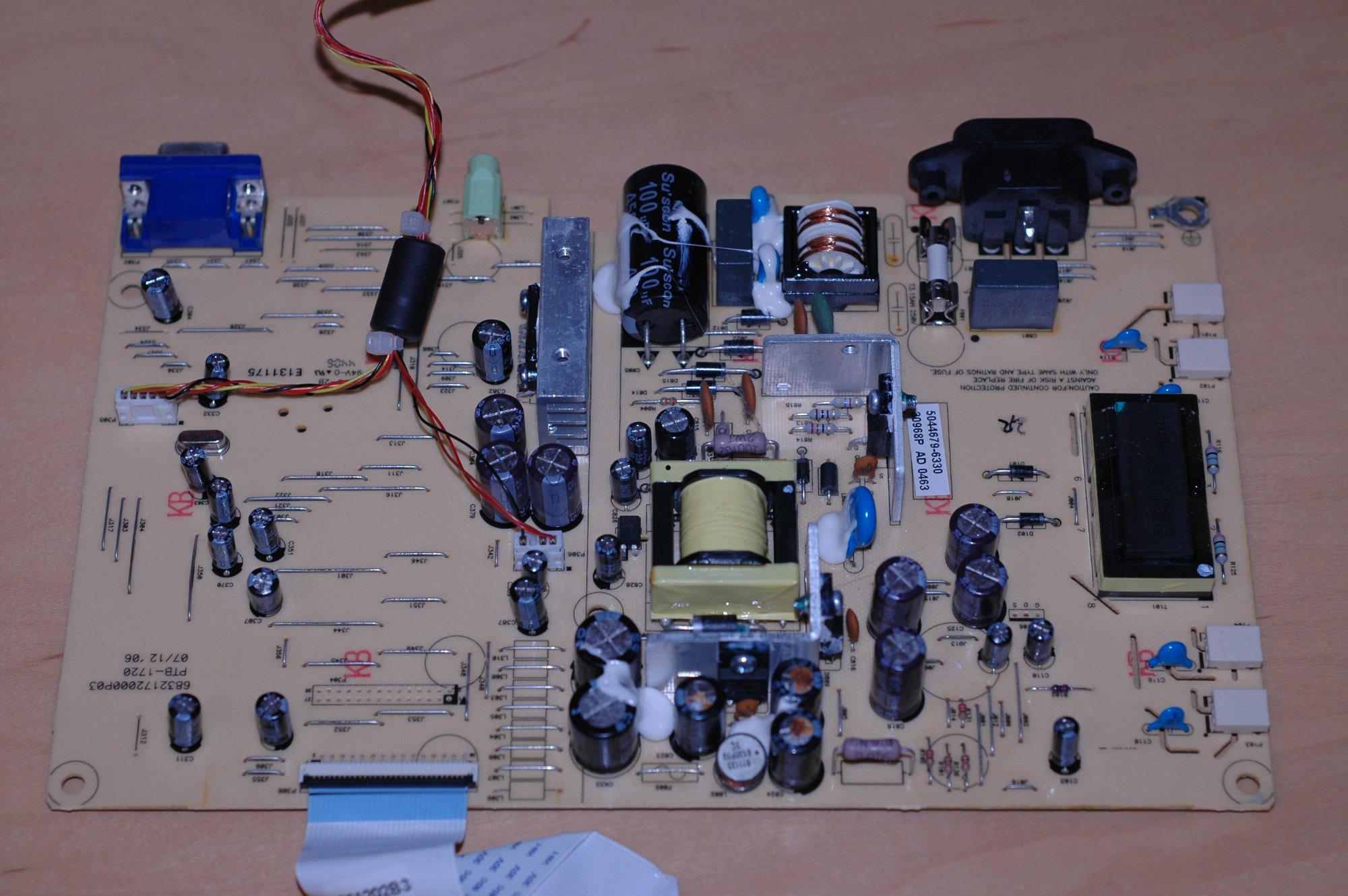

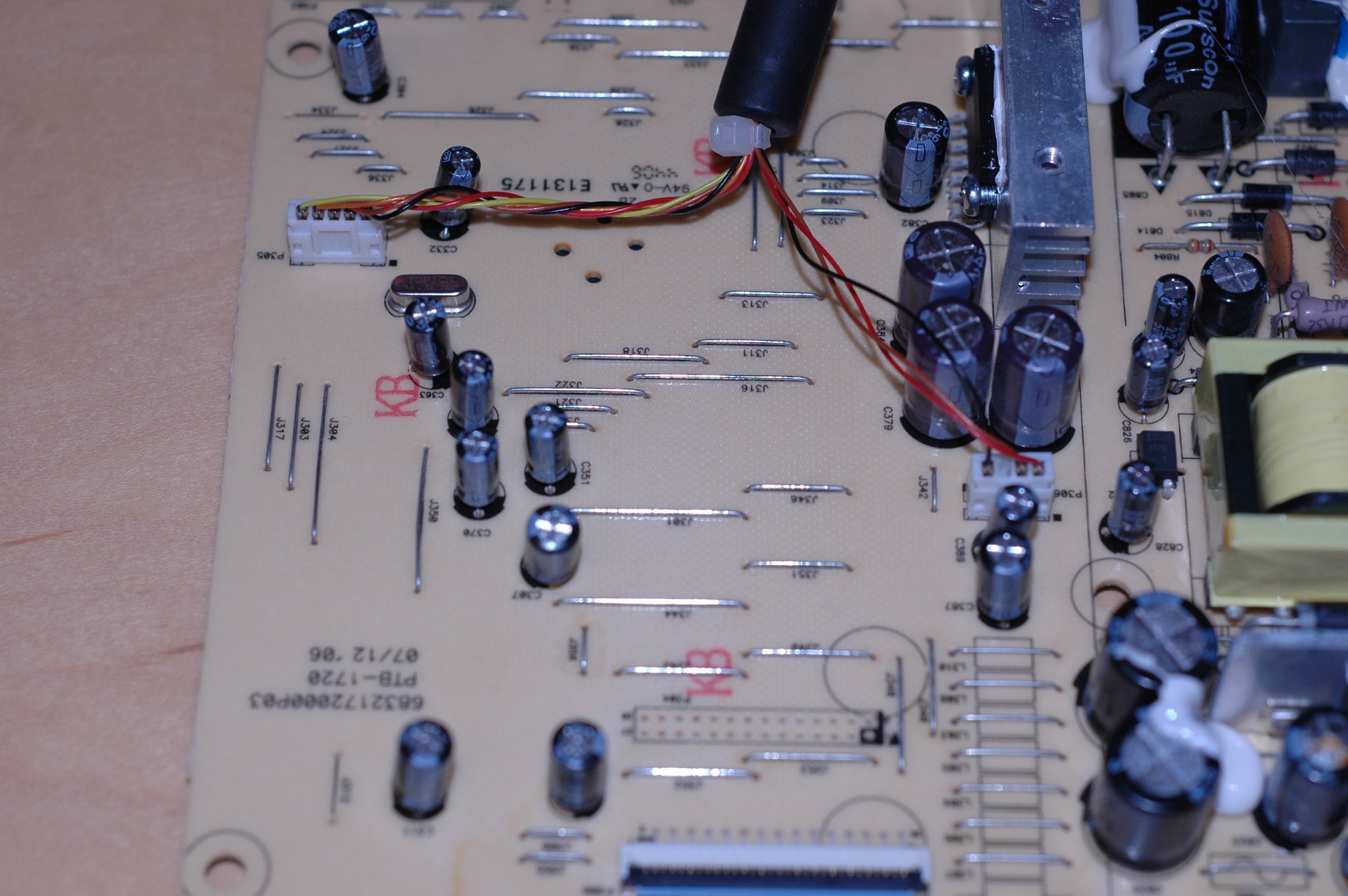

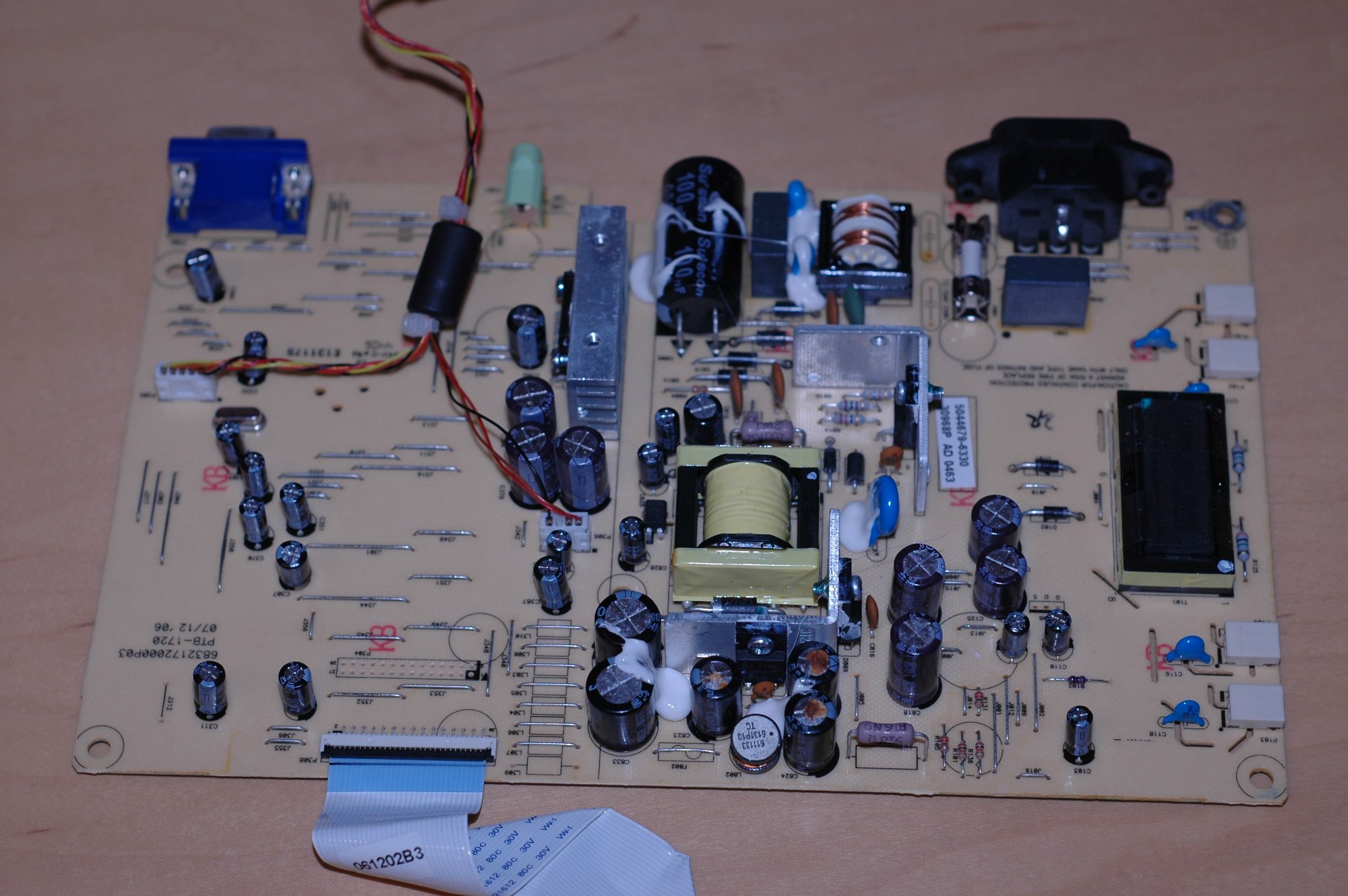

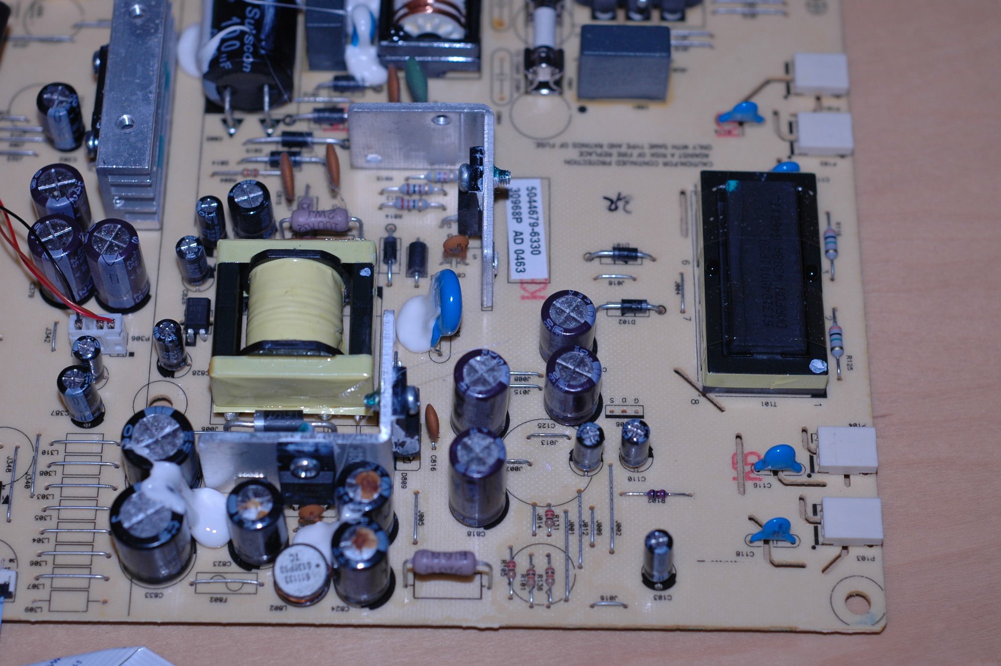

    Hello, I have a Hp vs17e 17" LCD Monitor That Will not Turn On. I Pulled it apart and immediately found three caps that were oozing. I assumed that they were on the 5v Rail being 10v caps, plugged board in out of the case, and Pulled out my multimeter, turned out correct they measured 5.1v, however I got a surprise when I hit the power button the 5v rail drops to 0.75v. Anyway, I am almost sure that those caps are the only problem on the board, as I was able to get the power light to flicker dimly with only the board connected.
    On to the Questions,
    What Caps should I replace on the board? It's only a 17" monitor so I don't want to put too much money into it.
    I think most of the caps in the list on this post are the same https://www.badcaps.net/forum/showthread.php?p=92533
    As for the 3 Caps that are Leaking and two other that might be raised slightly what do you suggest for replacements?
    2 Su'scon 1000uf 25v UK Series 105C Caps 13mm Round, Probably could go 15mm
    3 CapXon 1000uf 10v KF Series 105C Caps 10mm Round I don't think it can go any bigger.
    These Must be under 19mm High Might be able to fit a 20mm but it will be close to metal, Current Caps are both 16mm
    Thanks!

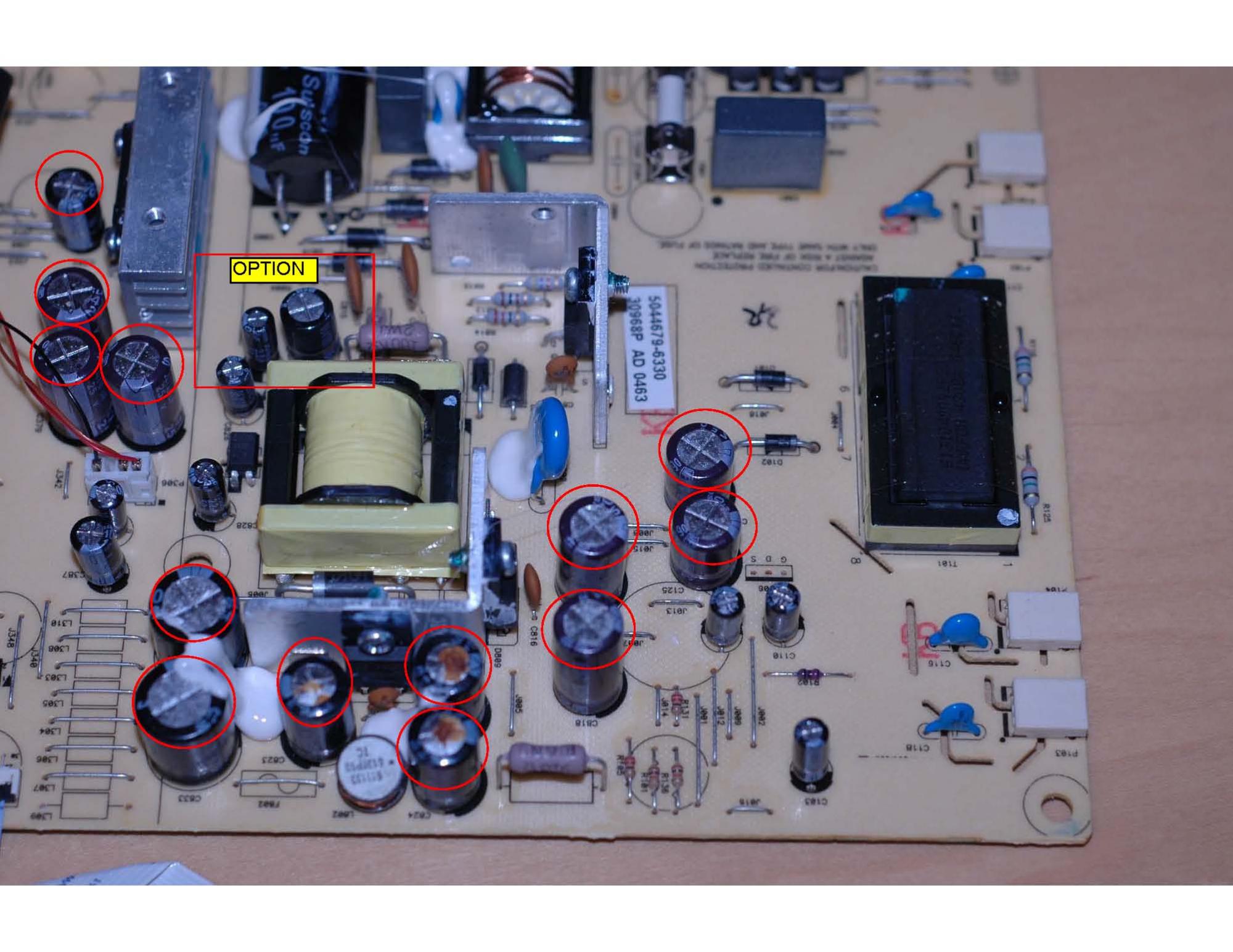

                      The Nichicon is good, I myself use PANASONIC FM series, I would also replace all the caps in the secondary side all at the same time.
                      Here is the service manual.
                        Re: Hp vs17e 17" LCD Monitor, No Power, Will not Turn On
                        How do I tell which ones are on the secondary side?
                          See my suggestion.
                            See my suggestion.
                            Perfect! "You Da Man" A clear simple photo that I can follow!
