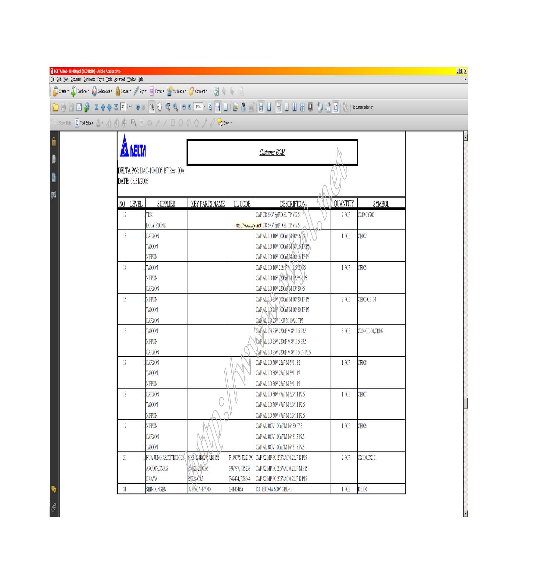

    I gather from this data sheet the capacitors are as follows (I'm not sure what the abbreviations all mean other than V, capacitance, and temperature):
    • C204,CE109,CE101
      AL LD 25V 220uF M 8*11.5 P3.5 105°C
    • CE103,CE104
      AL LD 25V 1mF M 12.5*20 P5 105°C
    • CE105
      AL LD 10V 2.2mF M 13*20 (?) P5 105°C
    • CE107
      AL LD 50V 47uF M 6.3*11 P2.5 105°C
    • CE108
      AL LD 50V 22uF M 5*11 P2 105°C

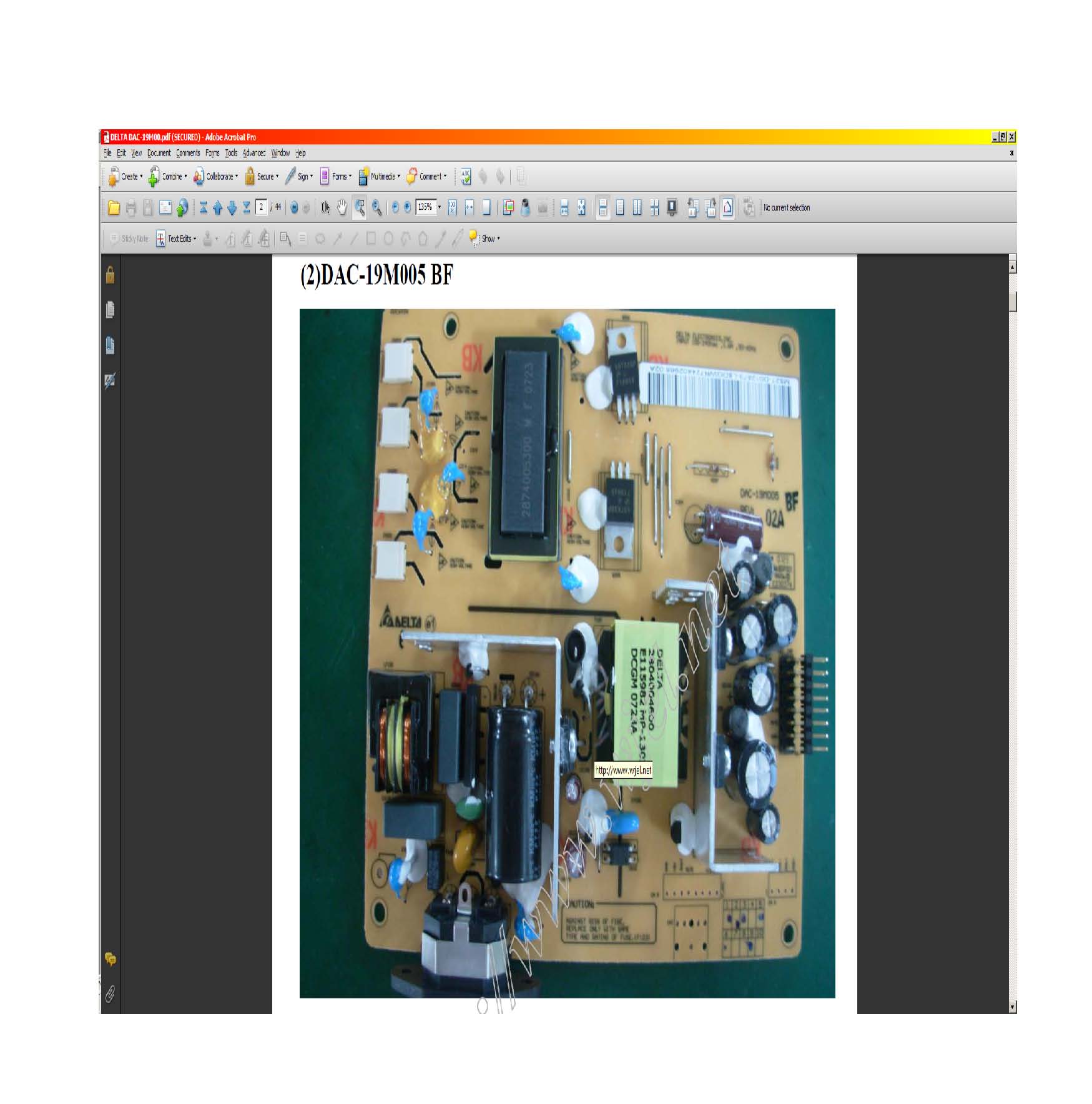

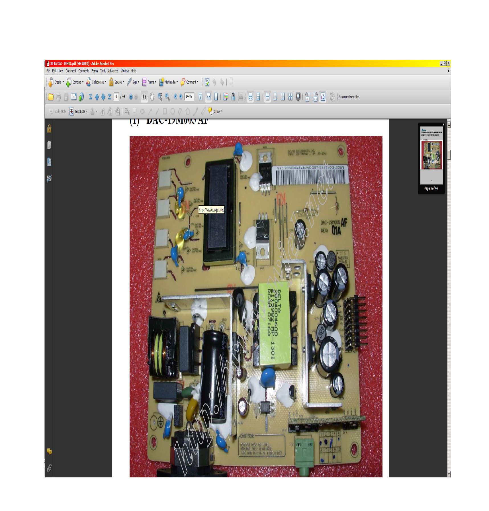

            Hmm... are you working with a different board/revision? I know from searching for information on my problem, I encountered a couple different boards/revisions for this monitor.
            Here are the values I can physically determine:
            • C204 - 220uF 25V
            • CE101 - 220uF 25V
            • CE103 - 1000uF 25V
            • CE104 - 1000uF 25V
            • CE105 - 2200uF 10V
            • CE109 - 220uF 25V
            • CE107 - 47uF 50V
            Looking at the print on the board, I think mine is: DAC-19M005 BF, rev: 01A

              I have one open and its an 00A the other 2 are sealed up as I haven't got the bits needed to sort them out out. I think the point is use the diagram as a guide and if you get stuck verifying any of the caps that you take off then take a picture of them and we can tell you what they are on here.
              Fixed so far : 1 Home cinema system, 16 LCD Monitors, 4 LCD TV's
              How to resize your pictures guide click HERE
              Retiredcaps Ideal post example click HERE
                Re: al1916w two seconds to black
                See caps listing to see if it matches yours. This site keeps giving me error when I try to upload the PDF of this service manual for this DELTA board, it is only 2.5Mb size.

                  Caps match exactly despite the "AF" board model (mine is BF) The only thing differing seems to be the audio connector missing from my board AFAICT. With some additional light illumination I was able to confirm CE102 = 1000uF, 10V as well. CE108 will have to wait until I can remove it as it is wedged up close to the divider(?).
                    They just stuff the same blank board differently for their requirement and revision update.

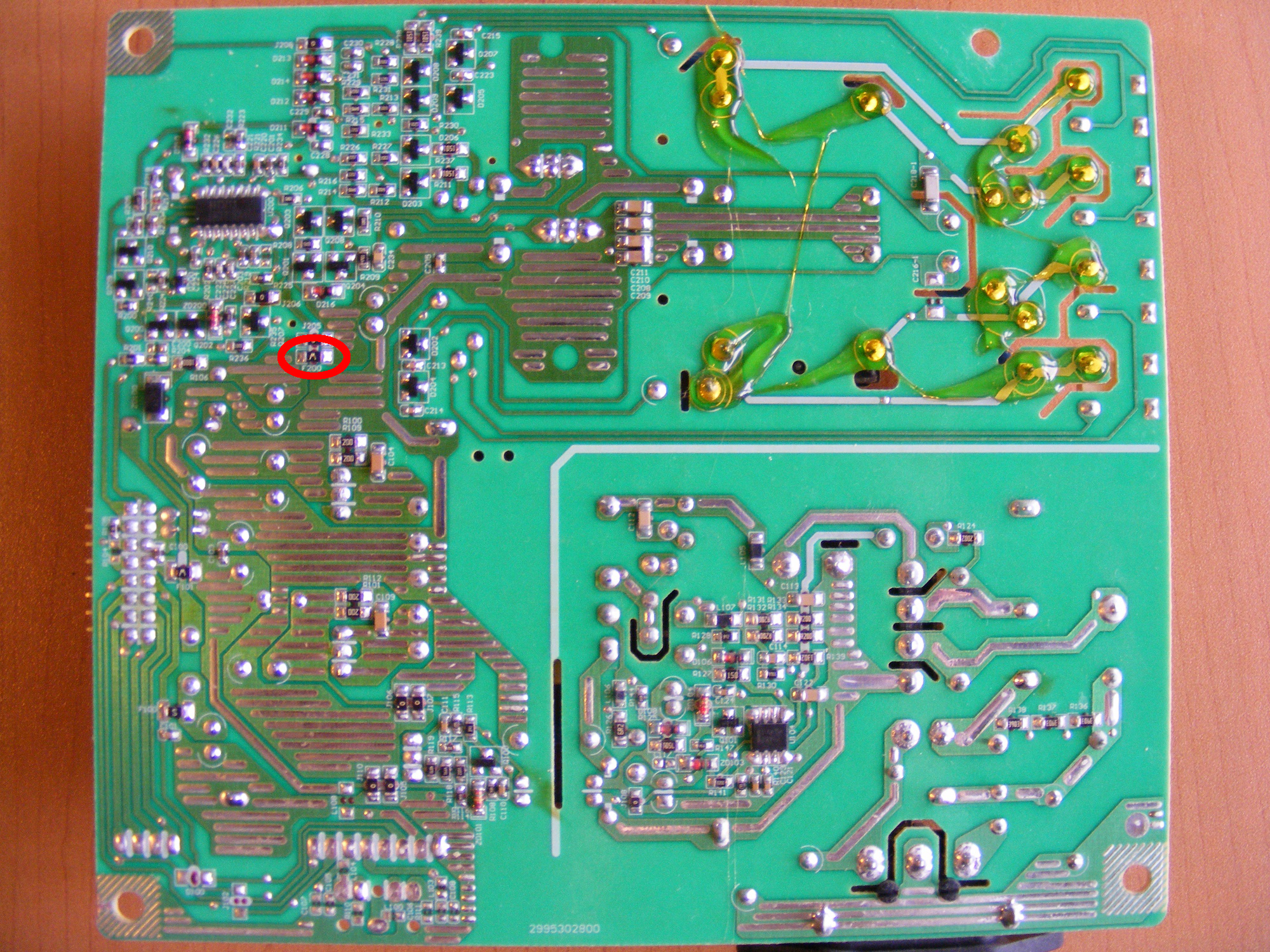

                                      I have a position problem of the D102, D103 diode, on the DAC-19M0005 BF, REV 01A ACER board TFT.
                                      The reference of diode is SBT100, the other SBT150, I´m afraid that I not sure your right position, so I´ve tried to seek a picture or diagram to see the correct site, any information would become be welcome.
                                      Best Regards.erece of diode was SBT100, SBT150, I´m afraid that not sure your rigth position, so I tried a picture or diagram to see the correct site.
                                      Best Regards.
                                        @blascq: Not sure these pictures will help, there are at least 6 version of the AL1916.
                                        http://s807.photobucket.com/albums/yy352/budm/ACER/
                                        Can you post the pictyres of your board?
                                        By the way, there should be dash after the SBT100-???, SBT150-???
