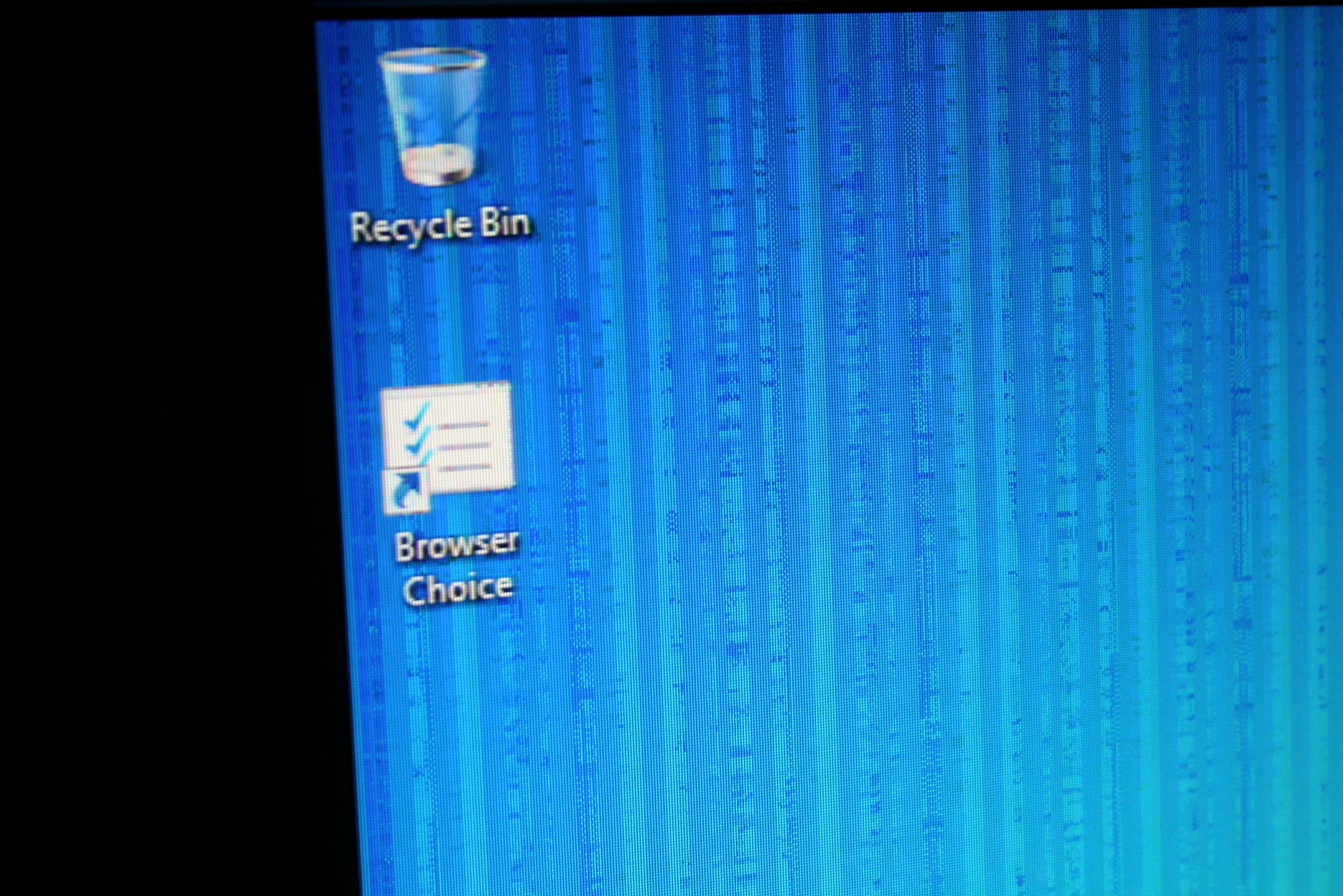

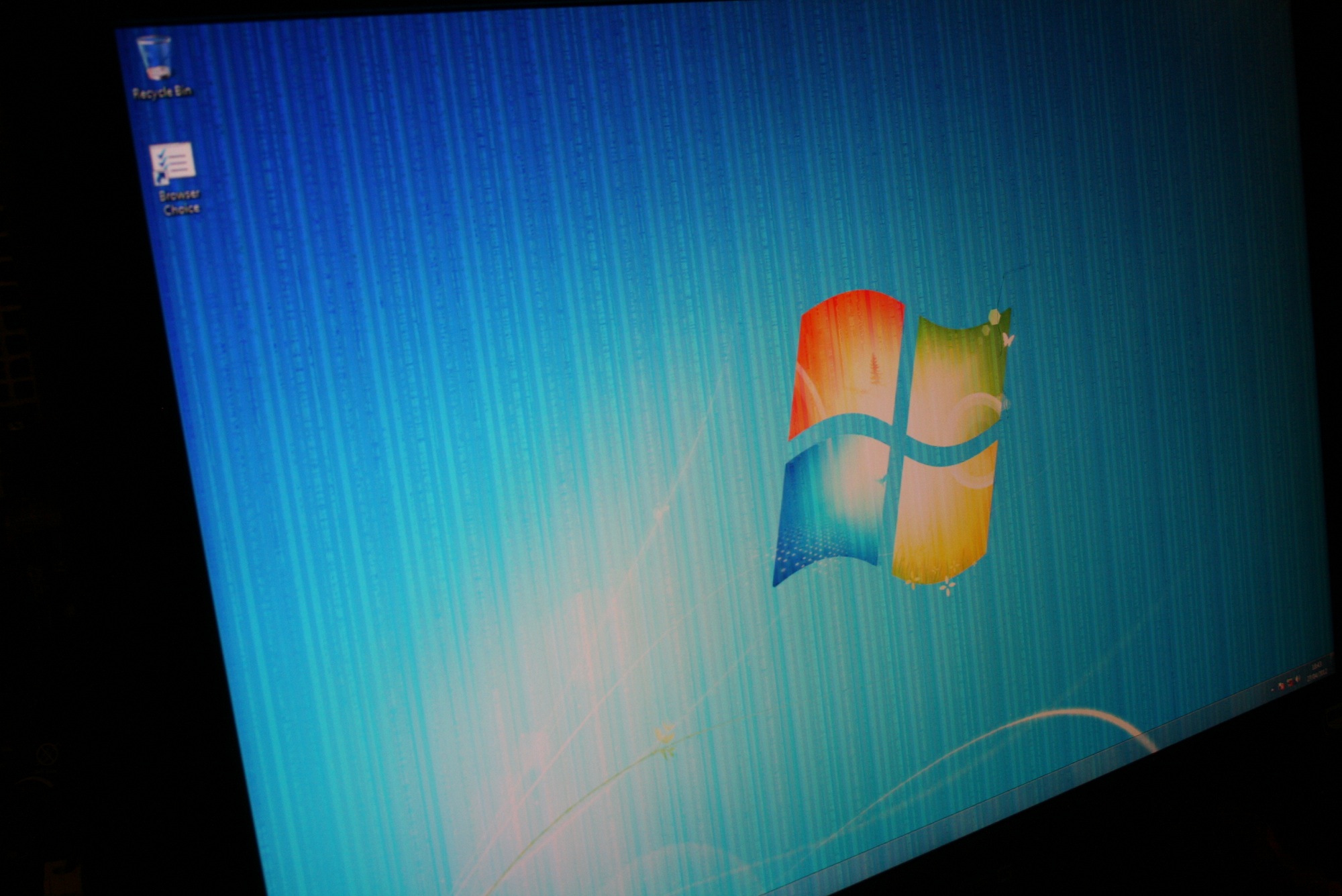

    Got this monitor today.
    At first it was just coming on with a white screen. I took it apart and it looked like only half of the LVDS cable was actually plugged into the T-Con board so I cleaned it then re attached it. Put it all back together and it worked.
    I tried it again later on and it went back to randomly giving a white screen and sometimes the screen came on but it would have noise on the screen which would go away if you turned the monitor on and off again.
    I have tested the voltage regulators on the logic board and on the T-con board and they seem fine and they are the same when the monitor is at fault and when its working.
    Anyone have any ideas?

    Several. I have been helping people with this monitor since day 1 almost. See
    https://www.badcaps.net/forum/showthread.php?t=11329
    After you read (get a cup of tea) everything and there are a few other threads on this monitor, you will find that I have come to conclusion that it runs temperature hot and warrants a complete recap of every board.

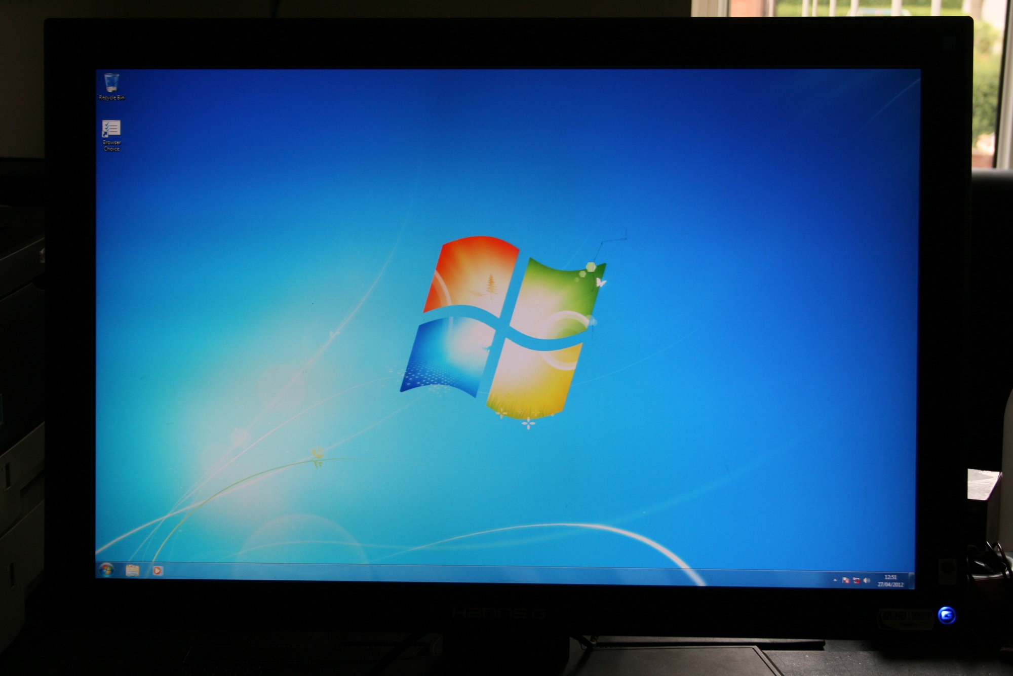

        Changed all of the caps on the main board and it looks like it there are now no lines on the screen. It is still going white every now and again so I am going to re cap the power board and see how we get on.
