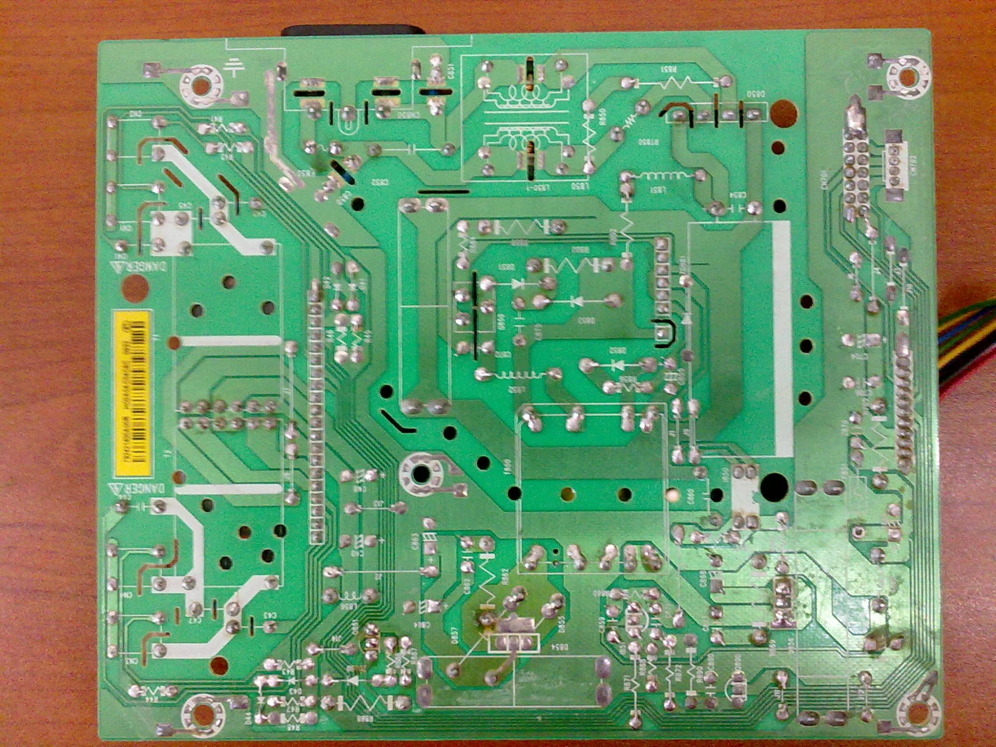

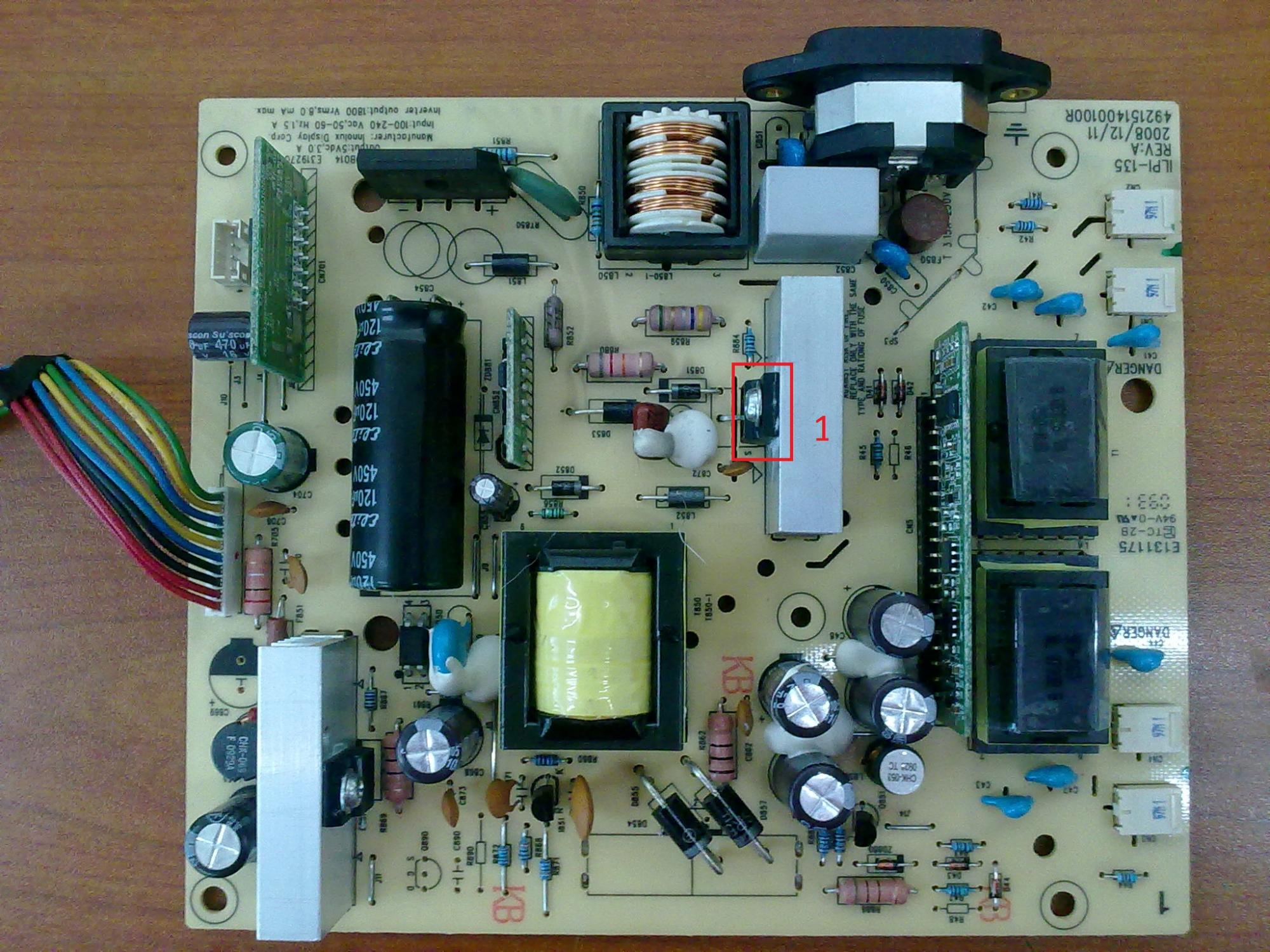

    I have I unit hp 2009f lcd and suddently no power, i diagnose the power board and all capacitor are ok, fuse also ok, and i have no idea where to diagnose next.
    hope you all can help me

    1) Does the power LED light come on at all?
    2) Post clear focused top down view pictures of all your boards following my sig file below EXACTLY?
    3) Here is an example of the picture composition that we want.
    https://www.badcaps.net/forum/showpo...94&postcount=1

      Re: HP LCD 2009F No Power
      1) The LED light off - No power activity
      2) No 1 on the picture is like transistor - A2764A1 927050 cannot find the datasheet
          Any DC on that large 450VDC cap? There should be at least 300VDC on that cap.
            On large 450DC cap shows 329.5 volt
                1) My guess is that the small capacitor to the left (as per your upside down picture) of D852 is the startup capacitor.
                a) What is the uF and V of that cap?
                b) What is the DC voltage across the cap?
                2) My guess is that the SMPS IC sits on that little vertical board just north of the startup cap. It might be a 8 pin IC.
                a) If so, what is the part number of that IC?
                  1.
                  a) caps 10uf 50v
                  b) no voltage
                  2.
                  a) 8 pin IC LD7575PS
                    Refer to page 2 of the datasheet at
                    http://pdf1.alldatasheet.com/datashe.../LD7575PS.html
                    1) Pin 8 is HV. Pin 4 is GND. Pin 6 is VCC.
                    2) What is the DC voltage at pin 8 using pin 4 as GND?
                    3) What is the DC voltage at pin 6 using pin 4 as GND?
                    4) What is the resistance of R852?
                    a) What markings are on that component?

                                I replace the ic LD7575PS but still no power, and also replace 2764A1 also no power
                                  Can you Trace
                                  this Area. of D587.
                                  Possible Shorted...
