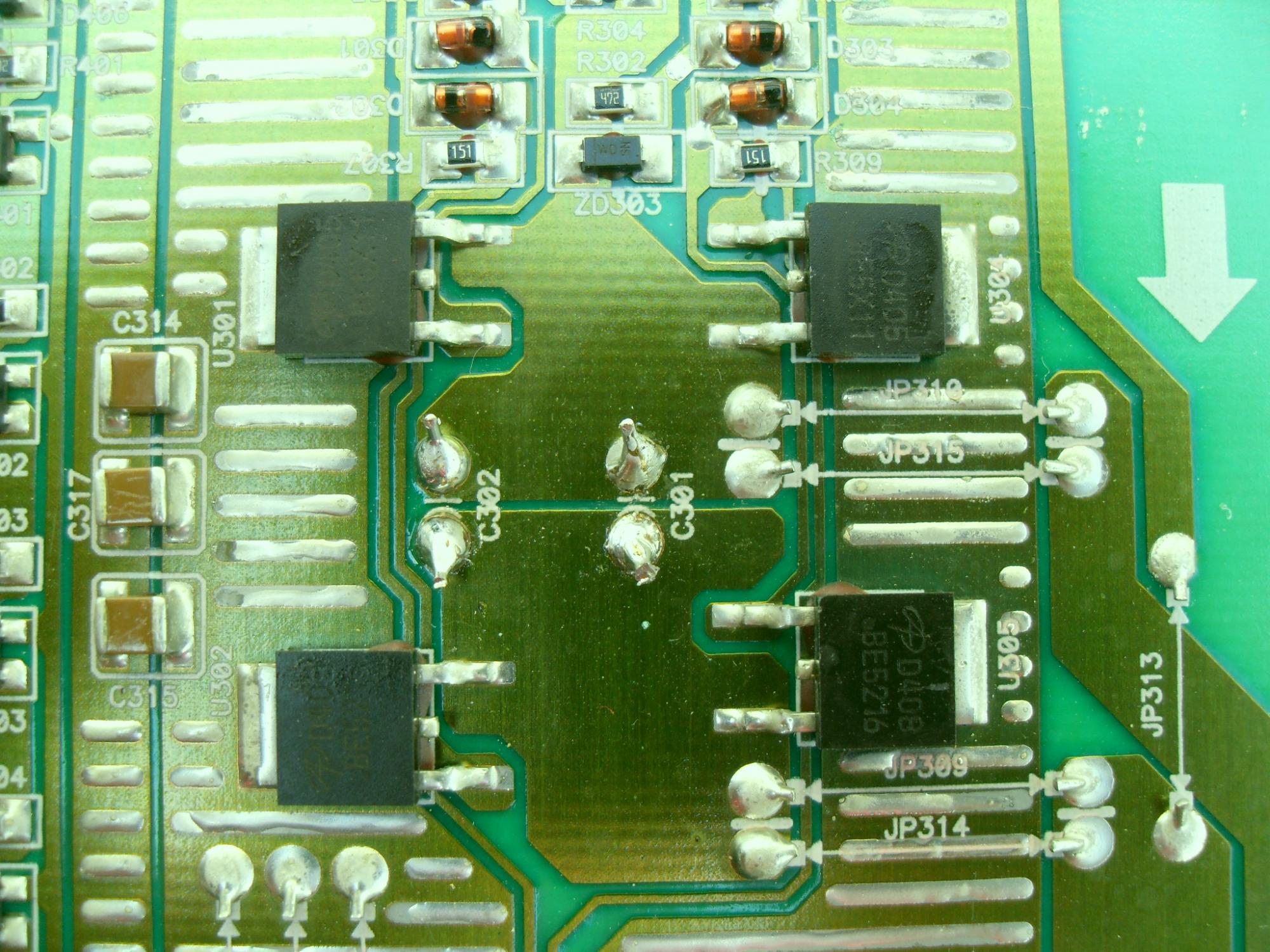

      On the backside are 4 mosfets. I can only make out one part number which is U304. The other 3 look like U304.
      Testing a mosfet procedure at
      https://www.badcaps.net/forum/showpo...4&postcount=19
      Here is a better cose up shot
        Re: Gateway FPD2185W not showing display
        http://s807.photobucket.com/albums/y...t=DSCF1563.jpg
        The picture and the notes show the P/N and designators of the 4 MOSFET's.

                                  Checking a 3 pin mosfet is done like this.
                                  Number the "bottom" pins 1, 2, and 3. Ignore the top fat tab.
                                  Measure the resistance between pins 1-2, 1-3, and 2-3.
                                  PS. The fat tab and the opposite pin (middle pin) are electricaly connected so it show 1 ohm.
