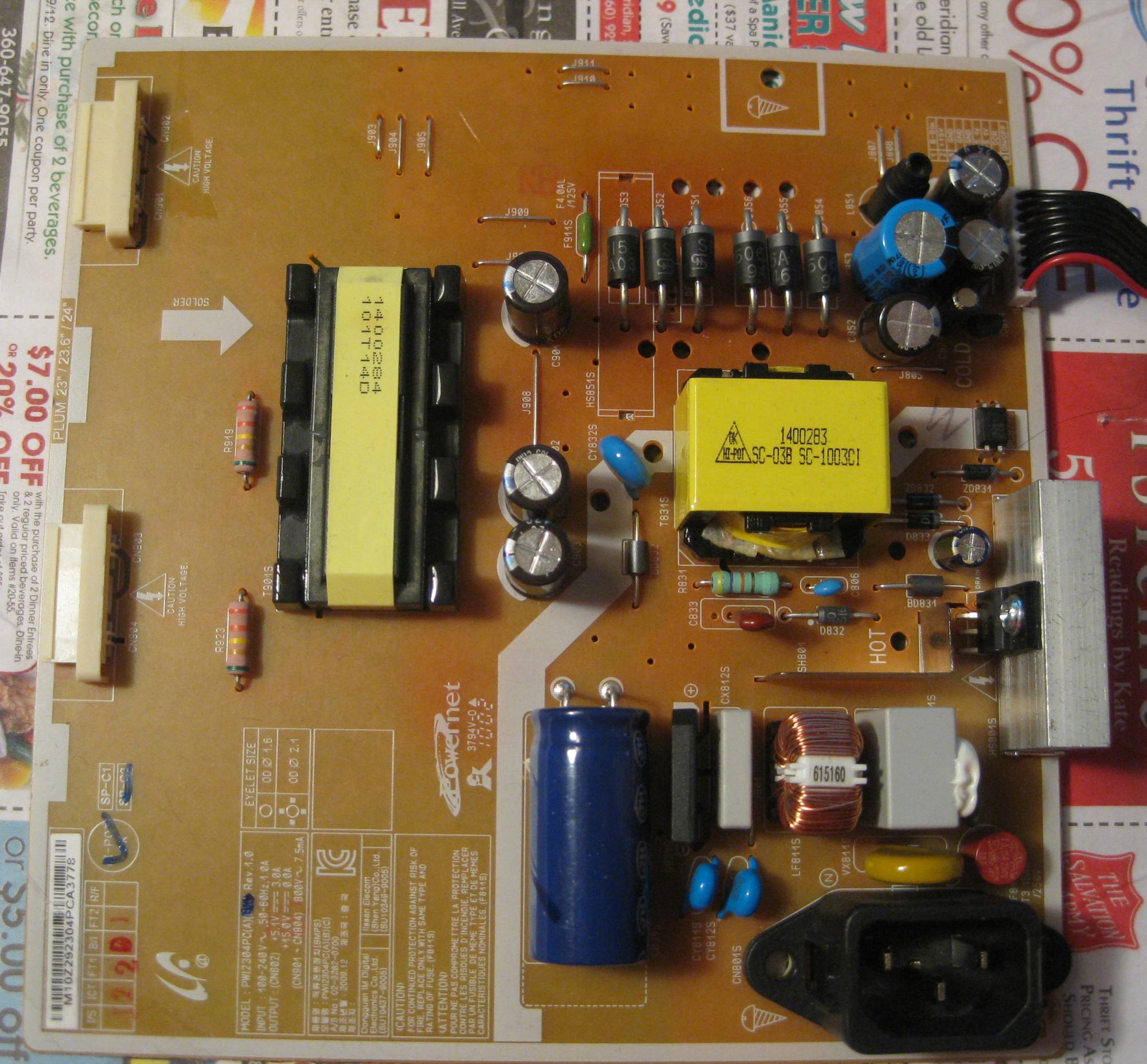

    Hi guys,
    I'm experiencing the 2 secs til black (dim, rather, screen still visible with flashlight) with my Samsung B2330.
    I believe I have identified the cause: the inverter transformer reads 1050 ohms on one pair, and 915 ohms on the other. Similar to https://www.badcaps.net/forum/showthread.php?t=12121.
    I already replaced the capacitors just in case, and found no issues with any diodes or transistors, using a multimeter to test.
    My main question is: how do I go about finding the correct inverter-transformer replacement? I see talk of datasheets and part numbers, but my searches have thus far been futile.
    My power/inverter board model is PW12304PC(A).

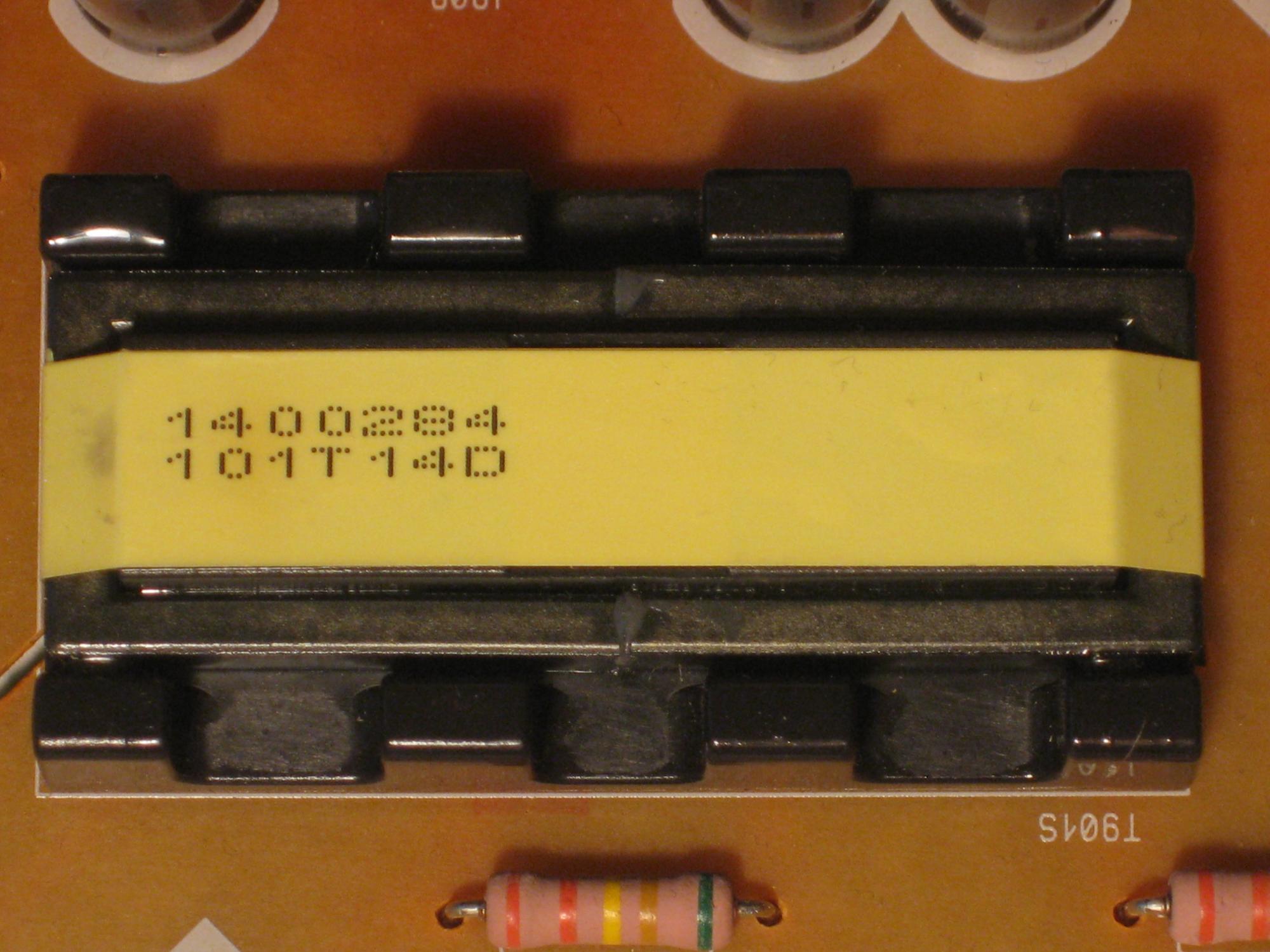

    The inverter-transformer has two numbers written on it:
    1400284 and below it, 101T140, and is identified on the board by T901S.
    Thanks so much for your time and consideration.

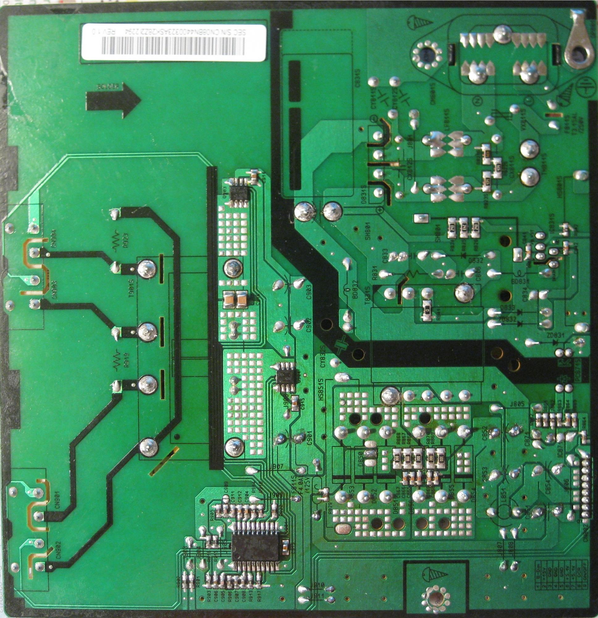

    Re: Samsung B2330 "2 secs to black"
    Can you post a picture of the transformer? Also, go ahead and post an overview picture of the entire board (front and back). Please use manage attachments (below the text area when you post using Advanced). Please do not post pictures inline.

      Here's pics of the bottom, top, and inverter transformer. Any word on how to go about searching for the correct replacement part?

        Or if I knew what the correct ohms was supposed to be I could pick up one from here:
        http://www.lcdparts.net/AGNTransform...FQV_hwodiBqFqQ
        as long as its within 5% yes?
        • jetadm123
          • 2169
          Perhaps you can email lcdparts.net and give them your monitor model number and part number off the transformer and they can suggest a replacement.
          • retiredcaps
            • Apr 2010
            • 9271
            It should be 3% of less. We have documented cases here where > 3, but < 5% are failed transformers.

              Hey thanks guys. I emailed lcdparts.net and they said they dont have the part and it isn't available to them. Do you know how I could find out what the inverter is supposed to be so I can order a similar part within 3%?
                If you have had no luck finding this I think you need to remove it and test again
                show a pic of the bottom of the transformer and circle which pins you test and
                what readings you get, Also test the primarys, it will help in the search for a suitable replacement if the original is not available.
