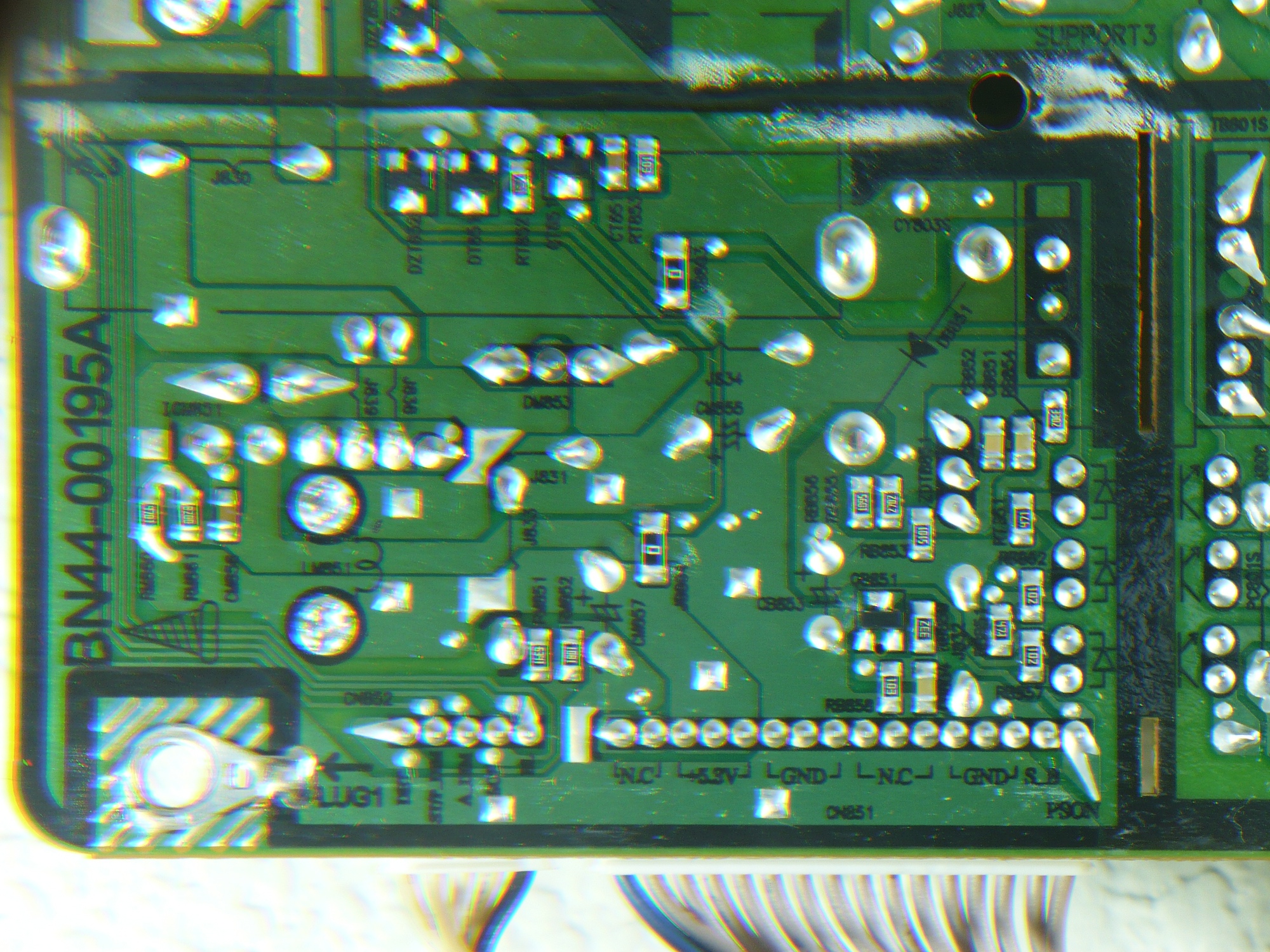

    Admittedly, I barely know what I'm doing here but I tried my best to understand the threads.
    It seems the results were bad MOSFETs, bad inverter, and maybe the long blue high voltage capacitor(?).
    This board seems to be a bit of an "unsolved mystery" compared to the earlier board (BN44-00173A) with the common 3 bad resistors.
    In this thread: https://www.badcaps.net/forum/showth...t=15796&page=3
    @epicelite sent one of these boards to @PlainBill, (https://www.badcaps.net/forum/showpo...2&postcount=60)
    who confirmed it was somewhat functioning,
    then it was sent to @Toasty (https://www.badcaps.net/forum/showpo...6&postcount=63)
    who said the inverter FETs were dead and apparently solved it with a new inverter (https://www.badcaps.net/forum/showpo...0&postcount=65)
    The capacitors are all fine from what I can tell, though I only have a cheap $20 multimeter from Frys and just did the apparently-unreliable "set to High Ohms" test.
    Resistors and Fuses all seem fine too.
    MOSFETs might be shorted, they are less than 30 Ohms. I don't know if I tested them correctly though. The results were very similar to a mentioned thread (https://www.badcaps.net/forum/showth...t=15843&page=4), something like 0.05 Ohms across the ones on the heatsink.
    The Video board is getting 3.75V(IIRC) and 5.25V where it is supposed to, but nothing on 5.0V rails.
    The Inverter is getting a short spike of >12V on the 24V rails which immediately dwindles down to 0.01. Those capacitors are fine, and MOSFETs(?) seem fine too. (With my limited testing ability)
    Is there a way to determine if the problem is local to the power board or inverter? I will probably try to just replace one of those unless the problem is fairly obvious. (or most likely just toss the monitor, as much as I hate to.)
    Could I use the earlier power board unit with the common bad 3 resistors? (BN44-00173A) https://www.badcaps.net/forum/showthread.php?t=9343
    Are these units interchangeable?
    The larger cap on the right (first pic) had a black marker dot on it. I marked one of the smaller caps on the left with black marker myself, but it turned out to be "probably OK" upon testing, same results as the others.
    I suppose it could be the glue?
    Any rough ideas of what to do to test if the PSU itself is functioning correctly?

    Hi You keep adding bits as I am reading. The Pictures missing are the bottoms of the boards.
    I suggest your read this:https://www.badcaps.net/forum/showthread.php?t=10419
    by retiredcaps. It includes lots of tests and you can see if you tested the mosfets correctly.
    Yes it could be the Glue - did you read the post where it had gone conductive - suggest
    as a first step you carefully remove as much as you can- looking for black marks where it may have gone conductive. When removed re check the 24v.
    Can you look at C812? with a magnifying glass the end looks a bit odd and it is leaning towards a heat sink.

                      Back of the PSU board photo please. Using picture 1 as a reference, I need to see the lower right corner under the transformer to the 2 connectors.
                      veritas odium parit
                      • robertp
                        • Feb 2012
                        • 25
                        Re: Yet Another Samsung 245BW - Power Board BN44-00195A - No display, solid blue ligh
                        Here are alternates just in case something isn't readable, hope I got the right section.

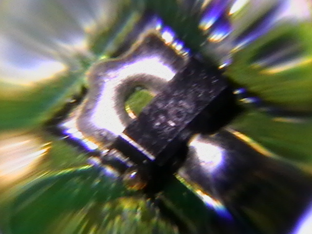

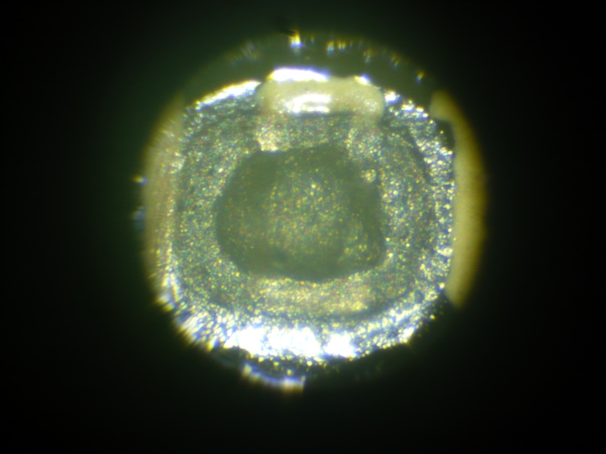

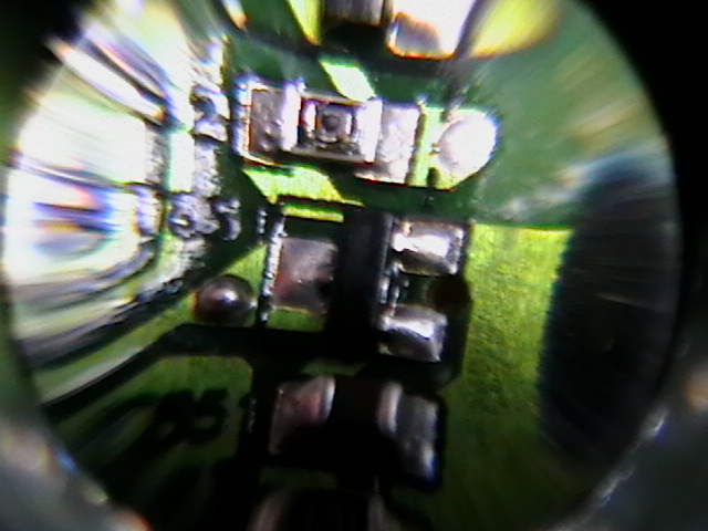

                                Ok. Resolder the jumper? How did you un-do it?
                                Your pictures have a strange prismatic color split to them that makes them look jittery.
                                Check RT852 for a burn mark in the center. It looks like it is, but the picture isn't sharp enough and that is a -really- tiny resistor. Get the magnifying glass out for that inspection. Or, just measure it. It should be ~100Ω or less.
                                BTW: Where are you located? Update your profile if you would please.
                                Toast
                                veritas odium parit
                                • robertp
                                  • Feb 2012
                                  • 25
                                  The jumper is underneath the heatsinks the MOSFETs are screwed to, and there is another component blocking the screw... I pushed it up through the bottom but I'll probably connect it back across the bottom rather than unsolder a bunch of other stuff to get to the screw.
                                  My multimeter only goes down to 200 Ohms and all those tiny resistors all flash ~50-150ish and then shows "1 .", RT852 has the same result as the others.
                                  The prismatic split is from taking the pictures through a lighted magnifying glass, it's the best light source I had available. I'll take some direct pictures.
                                  I'm in the SF Bay Area.

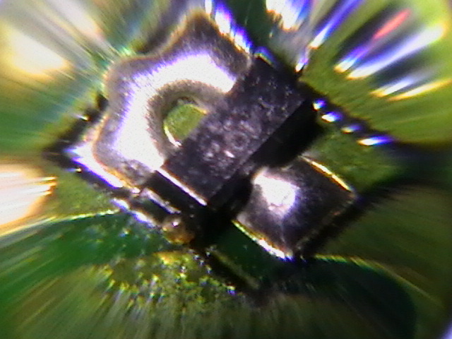

                                  Added some pictures of RT852 through a loupe, I'm not sure if it's solder or not. Amazing you saw that!
                                  Edit: Looked through a microscope, pretty sure it's a burned pit.
                                  Now the question is, how do I replace that- and what do I replace it with?

                                    Yup. That resistor is toast.
                                    Amazing? No, I've seen it before. I have one of these monitors that was a subject of a previous thread that I bought off a member here. PlainBill has seen this PSU too and had it on his bench for a bit.
                                    It is a 100Ω resistor. Marking is 101.
                                    My suspects here are the Zener diode, DZT851, located just up and and right from J830. I can't see it clearly, but it might be marked WS. The other is QT851, right next to the burned resistor. That's a 1P, NPN type.
                                    Gotta find the part numbers and get back to you. Shame you're not closer. I'd have you mail me the board as I have all the parts.
                                    Here.
                                    Somewhere....
                                    Toast
                                    veritas odium parit
                                    • robertp
                                      • Feb 2012
                                      • 25
                                      DZT851 has a bubble of magic yellow goop hanging off the side, QT851 looks physically OK to me. Any way to test these?
