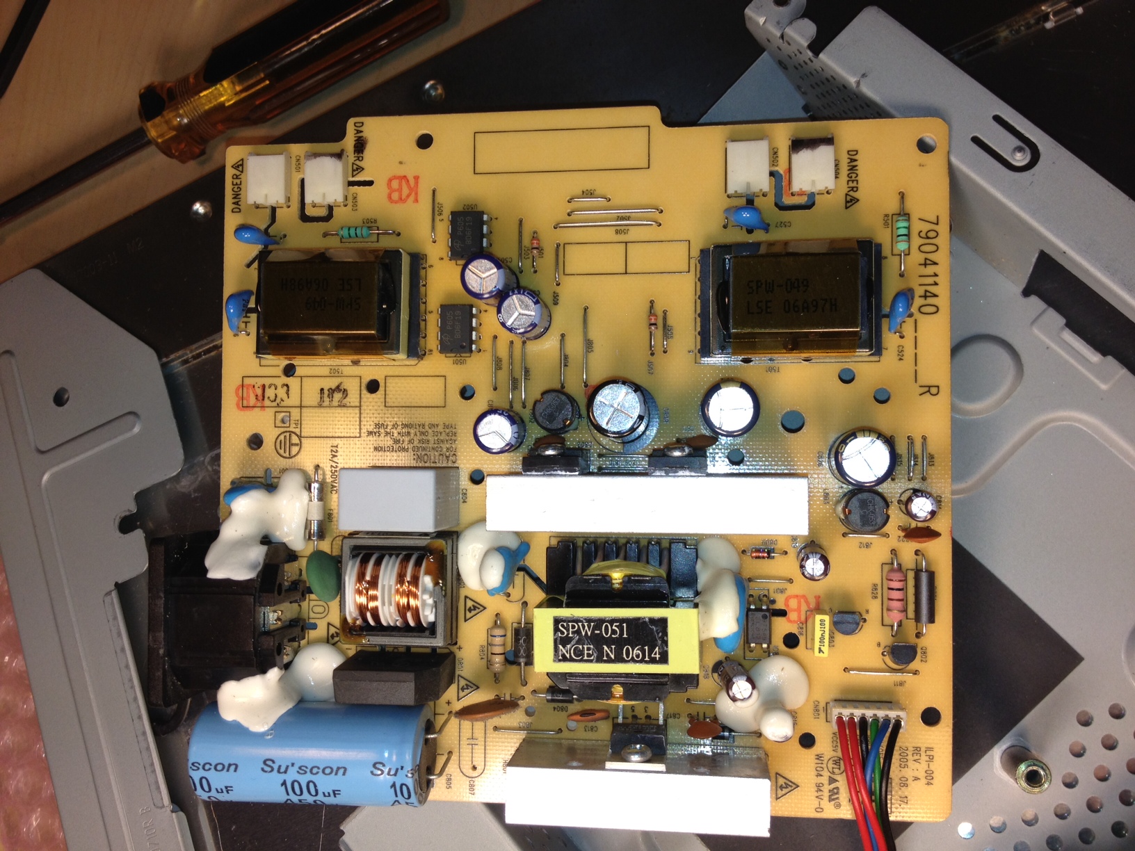

    I have a Viewsonic VA702 that would not turn on. I opened up and removed the power supply board and found someone else already replaced the 1000uf 25V cap (location C808), but there were 2 1000uf 10v and 3 220uf 25v caps that were buldging.
    I replaced the 2 1000uf 10v and the 3 220uf 25v caps and tested - now the monitor turned on properly. But once the monitor goes to sleep, it won't display an image again unless I unplug the monitor for a few minutes then it works again.
    If it goes to sleep, once I wake it up the LED turns green, looks like it thinks it's on, but the display is blank (BTW: the backlight is on, but display is a black/blank). If I unplug the monitor and wait a few minutes, it works again until it goes to sleep.
    Any ideas on this one?

        1) Post clear focused top down view pictures of your power and main board following the instructions in my sig file below exactly.
        2) Do you have a multimeter and are you familiar with measuring DC voltages?

          Re: Viewsonic VA702 LCD Monitor Sleep/Wake Problem
          Thanks for your help. The pics are attached.

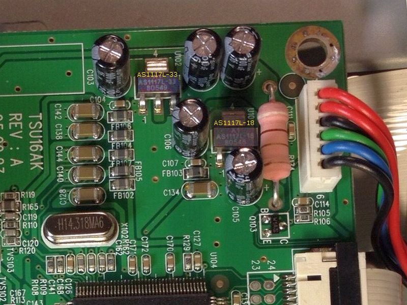

            1) Those are excellent pictures. It makes a huge difference when I can read the pcb designations.
            2) Okay, I just wrote this today and bookmarked it. These are generic instructions, but I'm sure you can figure it out. Use a ground screw on the logic board for your black probe.
            Check U101 and U102 on the main/logic as per
            https://www.badcaps.net/forum/showpo...13&postcount=3
            I didn't circle it because I can see it so clearly.
            3) Measure U101 and U102 when it is working and when it is not working.
            4) Do the same for the multipin color connector on the power board. Use a ground screw on the power board for your black probe. When reporting these voltages, please list what the legend says since it is obscured in the photo.
            5) Obviously, we are looking for any differences in DC voltage when it is working and not working.
              U101 = AS1117L-18 (1.8V)
              U102 = AS1117L-33 (3.3V)
                Heres what I measured:
                U101 working
                .3mv 2.407V 3.3445V
                U101 not working (after sleep)
                .3mv 3.473V 4.52V
                U102 Working and Not Working (same readings for the most part)
                .3mv 3.3V 5.20V
                Mulicolor connector on power board (cable connects to logic board)
                (NOTE: I measured on the power board side, but couldn't access the ground screw hole on the power board, so I used the ground screw hole on the logic board)
                Again, these readings were the same Working and Not Working
                1 VCC5V 5.2V
                2 VCC5v 5.2V
                3 Ground 7.7mv
                4 Brightness 3.29V
                5 on/off 5.10V
                6 ground 8.2mv
                Obviously the changes are noticed on the U101 chip. What do you think is causing this?
                  U101 working
                  .3mv 2.407V 3.3445V
                  .3mv 3.473V 4.52V
                  U101 even when it is working is bad. The part number has a suffix -18 means the output voltage on pin 2 should be 1.8V DC +/- 1%. At 2.407V it is way too high.
                  Replacements are plentiful at your favourite distributor or local store. Any brand will do as long as the physical package fits. You may even find one on a junk board?
                  PS. Hmm, you report 4 digits. What kind of 4000 count multimeter do you have?
                    I looked online for AS1117L-18 and not having any luck. Read some other threads and found a few failures on this monitor and on what looks like an Acer equivilent monitor. Someone mentioned that digikey part number 497-6868-1-ND or LD1117S18CTR is the correct replacement. Is that true?
                    You mentioned these are plentiful - I have all kinds of motherboards, video cards, etc laying round - is there a cross reference that would tell me if I already have one by another part number? Or should I just order from digikey and wait for the part to arrive?
                    Thanks again for your help - really appreciate your time on this.
                      The xx1117-nn family of regulators are 'jelly bean' parts - available from a number of manufacturers, functionally identical. Each manufacturer usus it's own two letter prefix, often part of the company name, or the company's numbering scheme. So yes, an AS1117L-18 is identical to a LD1117S18CTR. The important part is the 1117, 18 (the output voltage), and of course, the package.
                            Just wanted to update this thread so others would know the fix if they're facing the same problem. The U101 regulator AS1117L-18 replacement fixed the sleep problem. Now wakes up properly. Thanks for all the help on this one!
