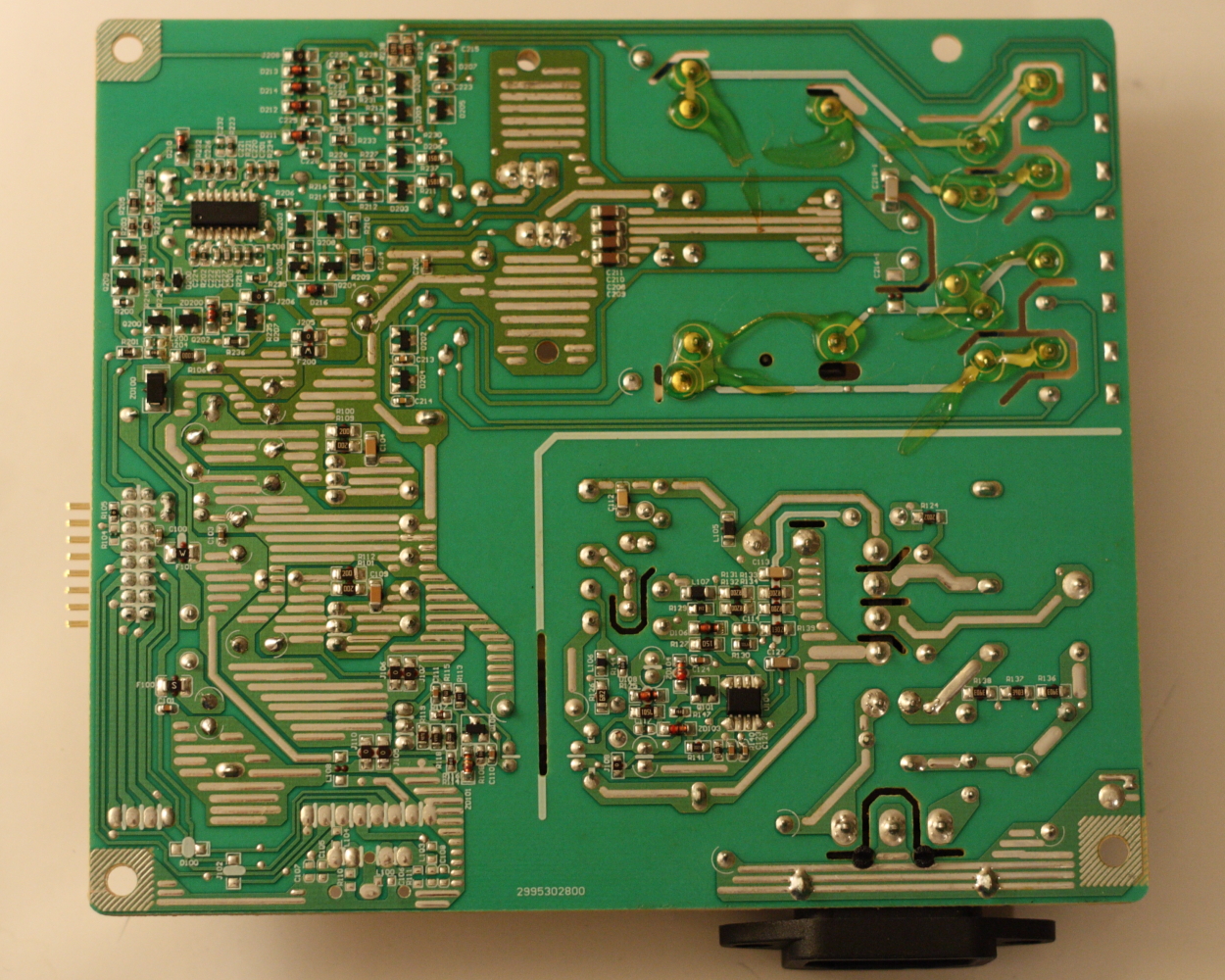

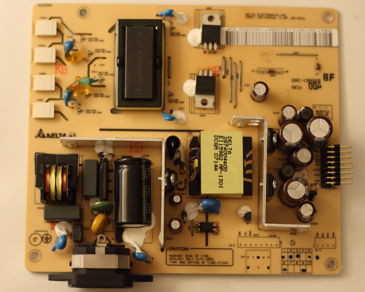

    I have a Westinghouse 19" widescreen monitor that I have recapped with United Chemi Con KZE series capacitors, and it is still only partially working. When I first opened it about half of the filter caps were bulged.
    After putting the board back into the monitor and powering it up, I noticed the LCD was displaying the image, but there was no backlight. After that I used another board to power the backlights, and the monitor functioned perfectly (the display board was still being powered via the original board). All four CCFL's were tested individually, and they all lit.
    I have recapped about 20 monitors, with a nearly perfect record. Help me keep it that way. Below are pictures of the front and back of the board.
    The seven brown capacitors on the right are the ones I replaced. I did not replace the two small caps directly above the caution statement about the fuse (starter caps? - they are 50V and 47uF/22uF). There is a hum coming from the Delta transformer.

    2) Check F200 on the back of the pcb. A good fuse should measure less than 1.0 ohms.

        3) If the fuse is good, check those two mosfets on the front of the board. See if they are shorted or not.

            OK, all the fuses (250V and the small surface mount ones on the back) have continuity.
            I checked the leads on the two MOSFETs, and one of them had 0.6 Ohm across two of the leads. All the other permutations were discontinuous (all the MOSFET testing with my multimeter was performed with the board completely unplugged, but the MOSFETs still attached to the board).
            I assume this means I will need to replace the MOSFETs to get it working again, correct?

              I don't recommend checking fuses with the continuity feature. Multimeters vary with respect to what they consider "continuous". Some cheap multimeters beep "continuous" for any resistance measurement under 1800 ohms. No fuse is good when the reading is that high.
              Desolder the mosfet and retest out of circuit to verify. If it is still shorted, replace both. Replacements may be at digikey.com or ebay.com.
              With a shorted mosfet, you will not get any backlight.
              PS. Also resolder/reflow the inverter transformer pins.

                My MM reads x.xxx ohms in the continuity setting. They were all < 0.010 ohms.
                I will order Part # IPS135N03LGIN-ND from digikey per the thread about 40T03GP. Thanks again for your help.
