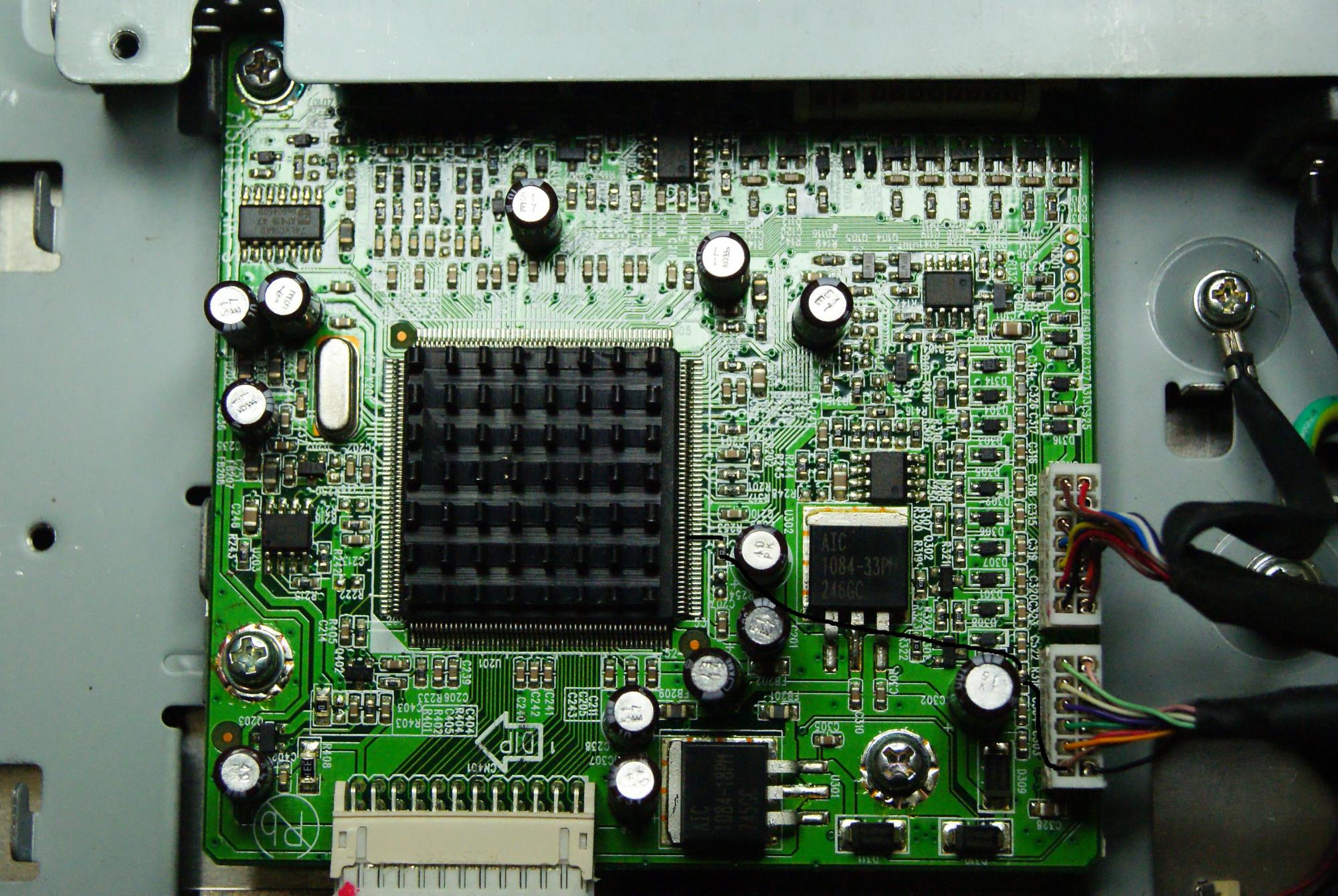

          Re: Sony SDM-HS75P
          I guess it is time to give up..
          I follow the trace of the PS ON pin and it goes to a 4.7K resistor then to a 0Ohm resistor and then to graphic chip..It doesn't output any voltage at all..I don't think I can do anything else.
          I have also check the inverter chip mentioned before,its working fine.

            Re: Sony SDM-HS75P
            Before giving up,
            1) Check to make sure the on/off button is getting 3.3V and that voltage changes when you press the on/off switch.
            2) If yes, then trace the on/off button to the main board and see if that voltage appears.
            3) Another idea that might cause some damage? Hookup an old computer with an old graphics card to the lcd. Hardwire the PS_ON so it on. If you get a display and the only thing wrong is the PS_ON, you have a working lcd, but you can't turn it on/off via the power button.
            If none of the ideas work, then it is time to give up since getting a new graphics chip is virtually impossible. You would have to replace the entire main/logic board.
            PS. Good job of tracing the circuit path for PS_ON. Many people would have probably failed at this task and obviously we can't do it for you.

              Re: Sony SDM-HS75P
              It was harder than you imagine..I had to desolder BOTH of the connectorsto follow the path that kept changing sides of the PCB..
              I will try the tricks you suggested tomorrow..

                    #29
                    Re: Sony SDM-HS75P
                    Well I've try all of your suggestions but didn't work for different reasons.
                    1. Power button has 3.3 v but the moment I press it it dissapears..I mean not only I don't get 3.3v on the other pin of the button, I also "loose" it from the pin I previously had it.
                    2. For the reason above, I cant trace 3.3v on VGA board.
                    3.I have hardwired PS_ON,but when I plug the VGA board backlit shuts down.If I remove connectroe from VGA its working again..

                      #30
                      Re: Sony SDM-HS75P
                      1. is normal - that line goes to an input pin on the processor. When you push the button the line is pulled to ground.
                      3. That is because the processor is controlling the backlight, and turning it off.

                              #34
                              Re: Sony SDM-HS75P
                              If you connect the monitor lit to a also lit pc this recognize the mon.?
                              I saw the "service manual", it's almost void unfortunately, try to:
                              1. from power off push togheter volume down and poweron, this is to access service menu, if nothing
                              happens i report you what s.m. says, it might appear a bigger menu with also this
                              entry:
                              2. INITIAL EEPROM: Initialize the EDID DATA at DDC2B EEPROM is saved system memory.
                              i don't know how usually you will use the menu, but if you don't see anything on screen
                              imagine to see it, maybe if you push "menu down" (or volume down) and press ok you activate
                              the menu 2 so try it and report if changes, if not maybe the service menu appears at the bottom of the normal menu, so repeat the point 1. then press "menu down" for 7 times then "ok" then "menu down" then "OK", report if it changes..

                                    #37
                                    Re: Sony SDM-HS75P
                                    If you can start from cold and can get the osd menu can you do a factory reset?

                                          #40
                                          Re: Sony SDM-HS75P
                                          Did you try this:
                                          CONECT TO A WORKING PC/LAPTOP
                                          Turn the monitor off
                                          * Hold down the Menu button and the plus button
                                          * While holding the other two down, press the power button. Wait for the DVI connector graphic to disappear
                                          * Release all buttons
                                          * Press the minus button. The Service Menu should appear
                                          * Scroll down to Burnin Mode using the minus button
                                          * Press the Menu button to activate that setting
                                          * Press the minus button to set it to Off (it should be blue when selected)
                                          * Press the plus button to highlight Exit Menu
                                          OR THIS
                                          Got monitor out of burn in mode by unplugging the power to monitor then while holding down the power button on monitor plugged in the power cord to the monitor all while it was connected to a running computer. Was able to turn the monitor off with the power button. When I pressed the power again the burn in mode was gone and the monitor was displaying what was on the laptop computer.
