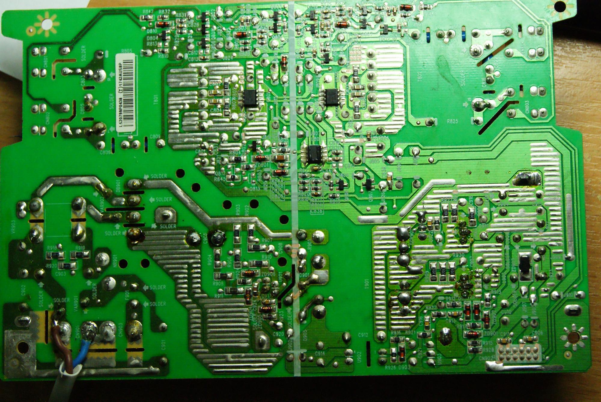

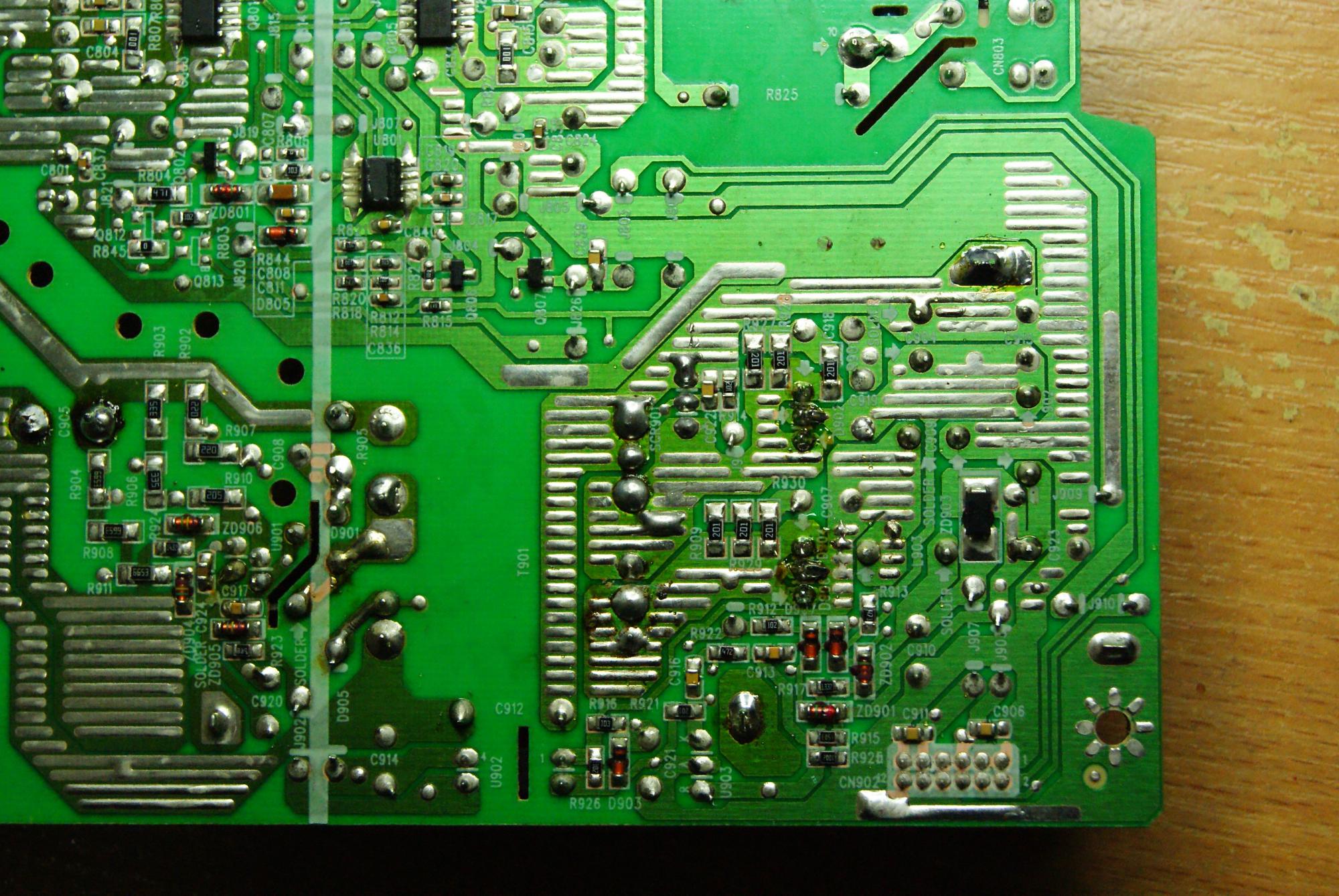

            Re: Sony SDM-HS75P
            Hi- Looks like someone has had a go at this board? I have marked soldering areas in yellow which might need re -visiting.The Big cap especially looks poor.
            The component at U802( Marked in red) looks to be melted? is that just my eyesight?
            The area marked in violet looks like a solder bridge but appears cracked?
            If it is meant to bridge it needs redoing. If its not it needs undoing.
            Id have thought the 1.5 volts should be 3.3 but cant find much out about this board.
            it is a 715G1447-1-GP
            The Big Cap is a UCC are the others the same manufacturer?.
            The vga board may be a different manufacturer what are the caps on that. You should post a picture - may help others in future and explain the 1.5v.

              Hello,thank you for your answer.
              Component U802 looks melted,but it isn't.It is just flux on it.Same goes for primary cap..It has lot of flux on solder(not from me), I try to redo soldering points on it.
              Exactly the same goes for the two diodes you marked with yellow.I have desolder them for measuring and didn't clean paste at all.
              All in all it doesn't look like someone has messed with it before..

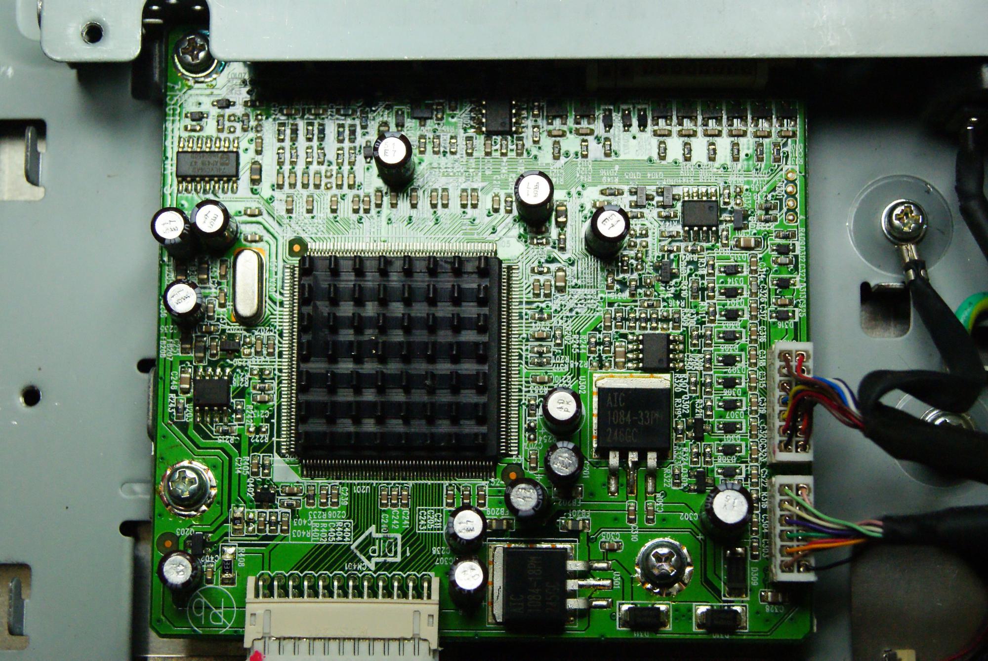

                Here are the VGA board pictures..Regulators looks and measures just fine, 3.3Volts and 1.8Volts as they should.Measure voltages at the connector that goes to button board and see there are 12 and 5 volts present.
                Any ideas?
                P.S I didn't want to use flash so photos are uneven lighted.Everythink on boards are optically OK.

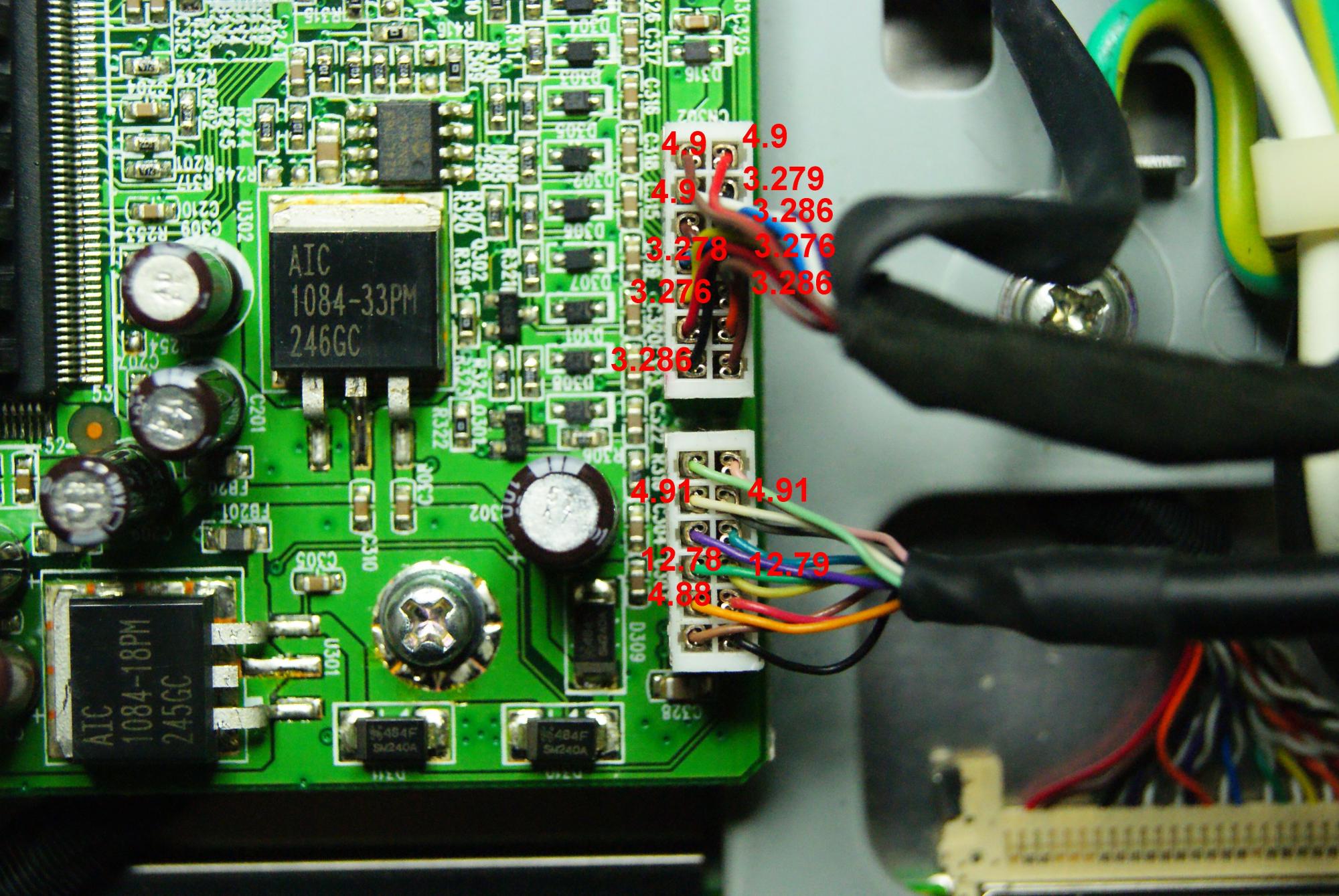

                  Can you indicate on the logic board which pin is 1.5V DC?
                  Can you also mark up the logic board picture to show the DC voltages from the power board on the different color connectors?
                  --- begin sig file ---
                  --- end sig file ---
                    Re: Sony SDM-HS75P
                    There you are..
                    I was wrong about the 1.5V voltage..There isn't any.
                      Re: Sony SDM-HS75P
                      Okay, without a schematic or some legend, I can't tell which of the pins that read 0.0V is the PS_ON pin.
                      Some will read 0.0V because it is ground. You can do a quick resistance check with respect to ground to see which read less than 1.0 ohms. Those that do are likely to be ground. Those that are left might be PS_ON.
                      What I'm about to suggest might damage your monitor so you have to decide for yourself.
                      Disconnect the main board from the power board.
                      For those pins that are left at 0.0VDC try hooking up 2 AA cells in series to get 3.0V DC. Apply 3.0V DC to the unknown pins and see if the backlight comes on. If it does, then you have found PS_ON.
                      From there, it is a matter of tracing PS_ON on the logic board to see why there is no 3.? V DC.

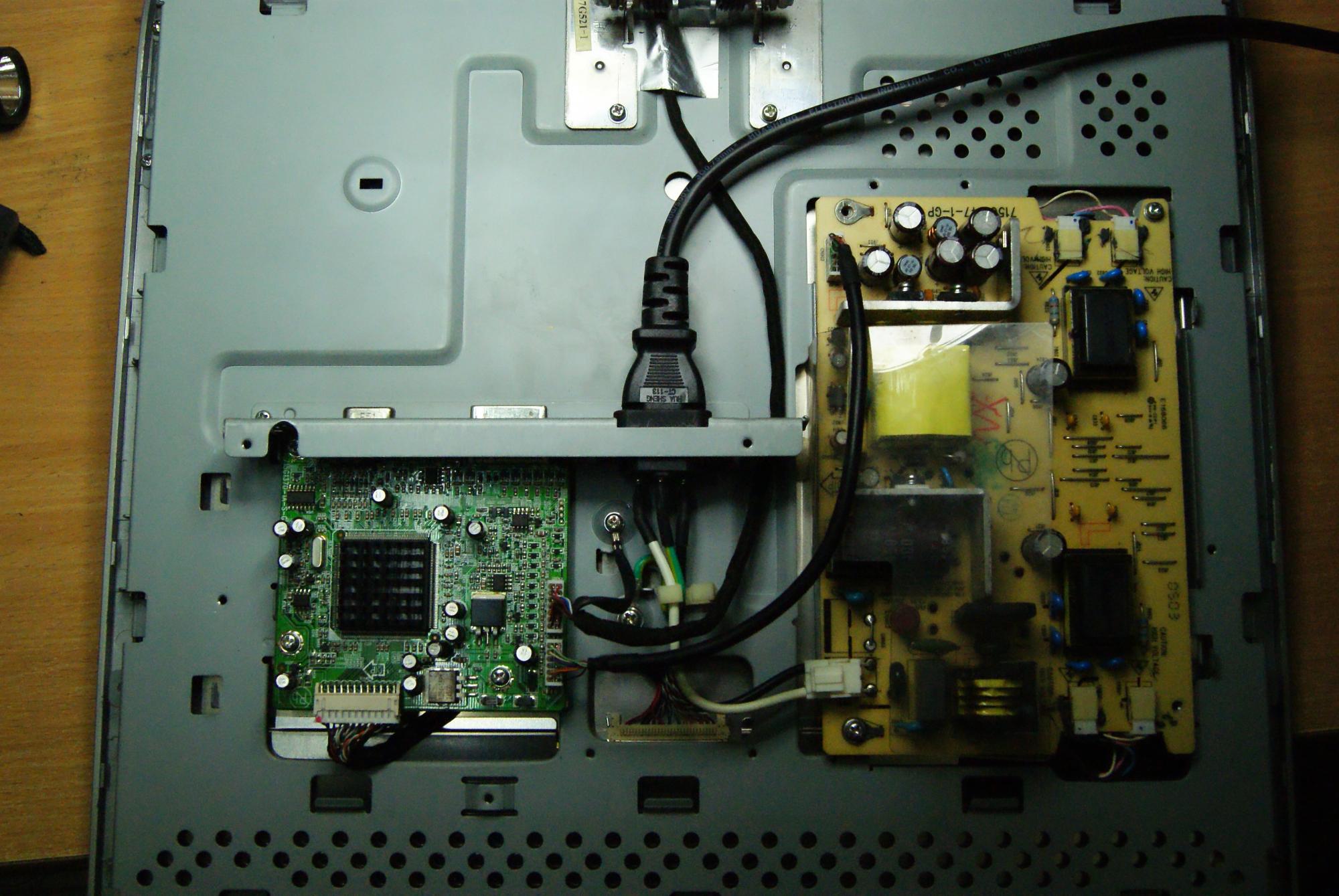

                          I can't see the top of the picture, but I assumed (maybe incorrectly) that cable went to the front keyboard.
                          The lower connector is the only one to the power board so PS_ON has to be here.
                          The other way to force the backlight on is to tie a resistor between 5V standby and PS_ON as tom66 and PlainBill have mentioned a few times here.
                            Yes,that's right.You can see it in the pictures I have posted earlier(post #8 )..

                              Well resistor trick worked just fine..
                              PS_ON pin is the brown one( at the bottom left of the connector )
                              I removed the connector from VGA board and place the resistor between this pin and the white one that has 4.88volts.The thing is that the backlight lit ,but brown pin had too high voltage about 4.6Volts( maybe was drawing less current that expected? )
                              With a little try and era found that it needed 33K resistor to drop voltage at 3.2volts.Now the backlight is lighting..
                              What does that mean?
