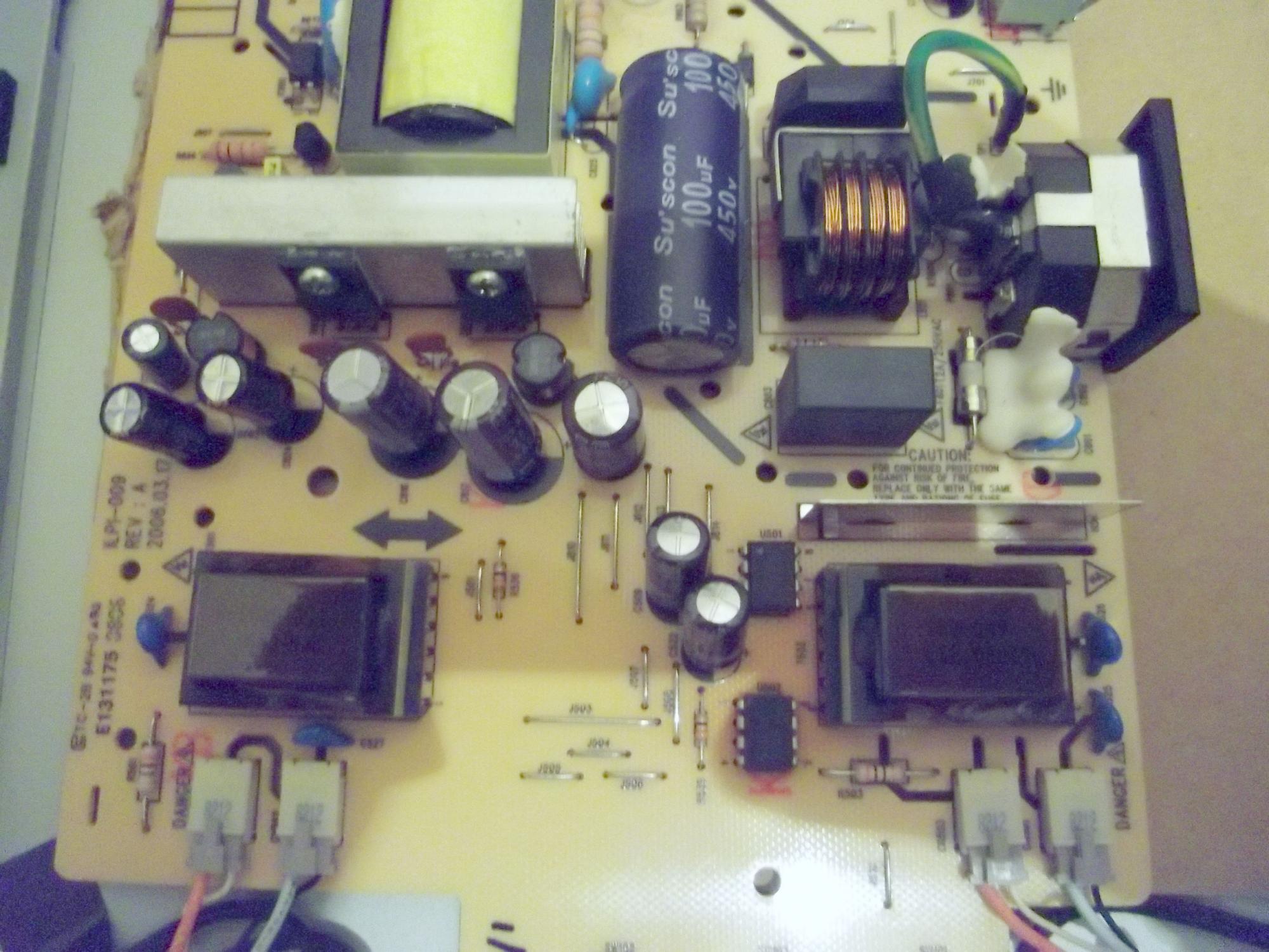

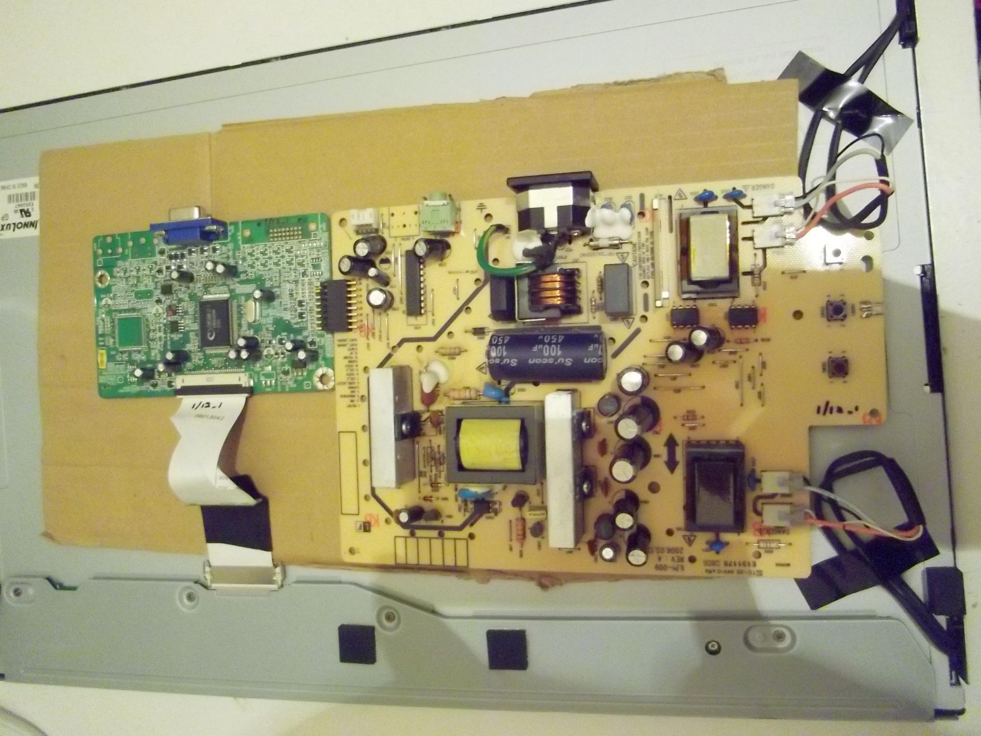

    An EMPREX TFT screen came to me for repair, so I'm hoping this info will help somebody, it was a straight forward fix, but may help somebody with several models of the same design.
    The screen was doing the usual thing, of switching on for a few seconds, then off again. The display never lit up at all, though the power light came on green for the 2 seconds, then back to yellow for Stand-By mode
    On most of the screens I get to fix, I start by replacing the screens flat data cable with a known testing one I have. But on this screen, that didn't help, so I examined the circuit instead.

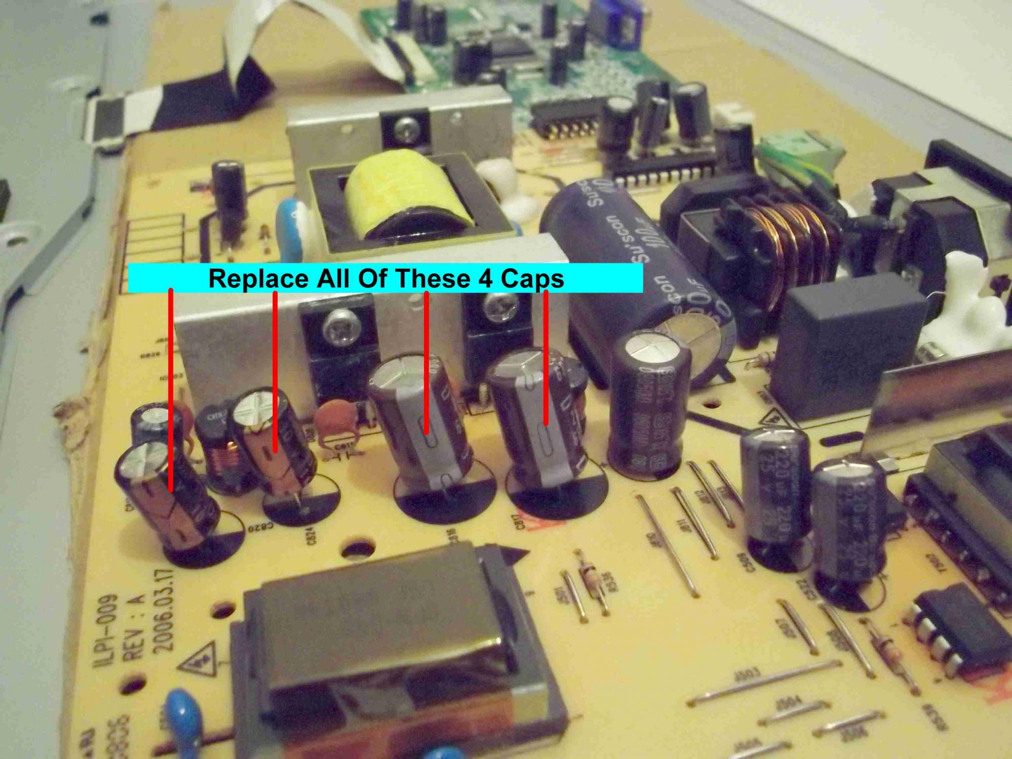

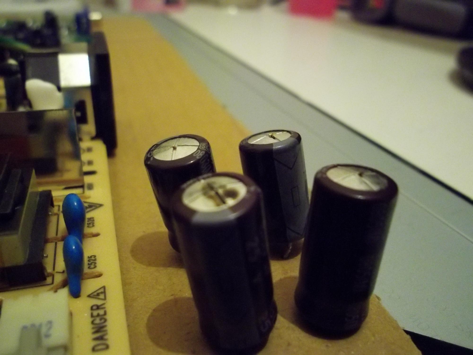

    A group of 4 caps grabbed my attention. I've shown them in a photo attached here, I hope it makes it clear. Another photo shows the 4 caps once removed. There's very little sign on a problem, except one shows a leak at the top vent. Even close up, none actually show a break in the vent as its that slight, but all 4 are bulging just a little.
    I replaced all 4 as they only cost about 80p each, and it's completely fixed the display. Here is the details on the replaced components:

    In the photos i've included, it shows both the power board and logic board of the screen I fixed, there are many variations though generally it's just things being shuffled around the boards. Other photos are a close-up of the caps that I replaced, a photo of the 4 old ones I removed (showing slight bulging and a leak on one).

    Um... I see several other obviously bulging capacitors.
    Did you replace those as well?
      Those to the right of the photo are still on there way to me by post from a different supplier, hopefully they will appear tomorrow.
      I've replaced the others in sequence of the larger caps (still faulty), then the 2 smaller ones (fixed, yippee), and was a bit eager to let others know.
      Looks like that side of the board has a whole load of dodgy components?
      Thanks for noting that though Shovenose, I should have mentioned it in my original message. I shouldn't type at 3am
