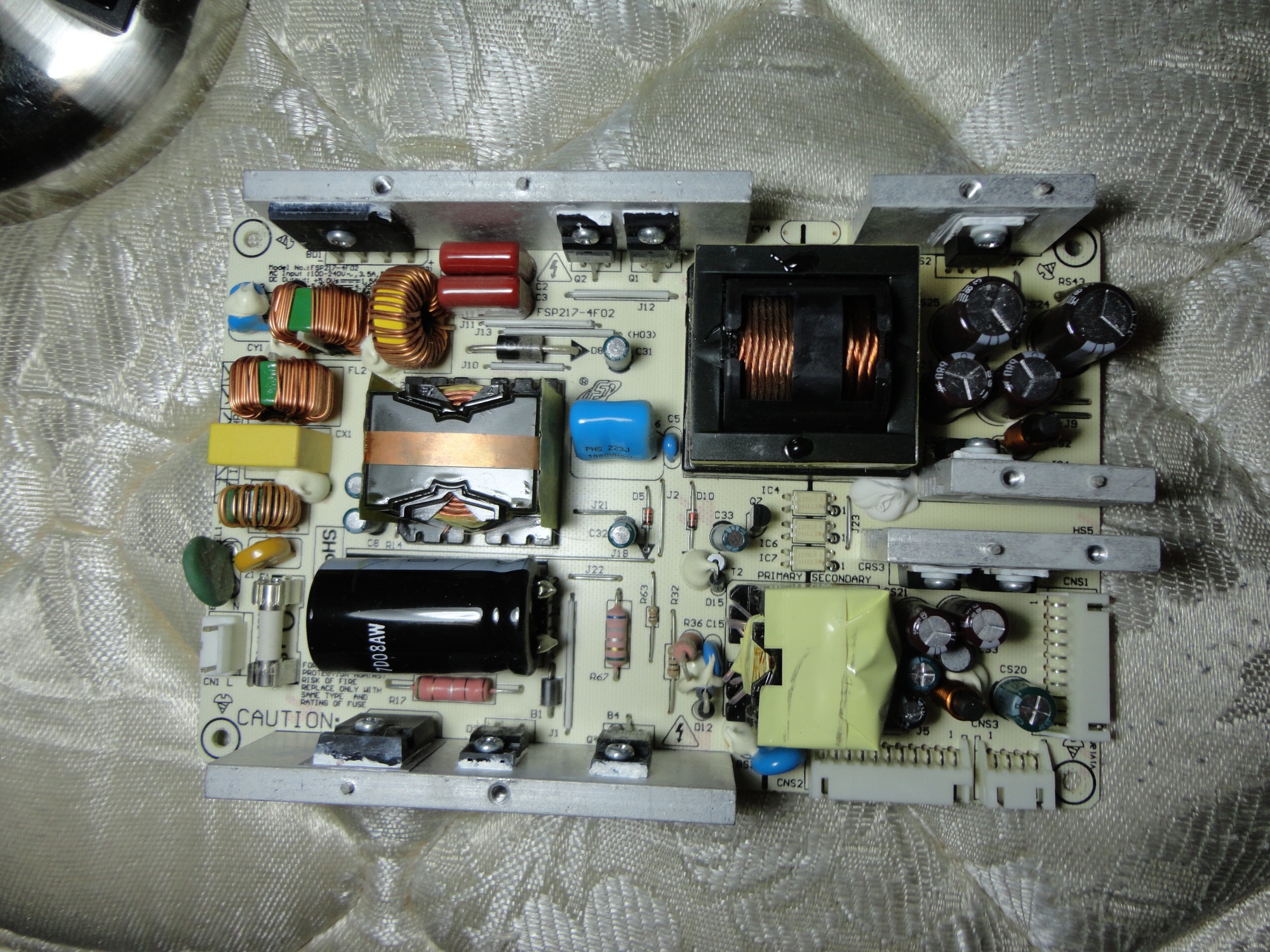

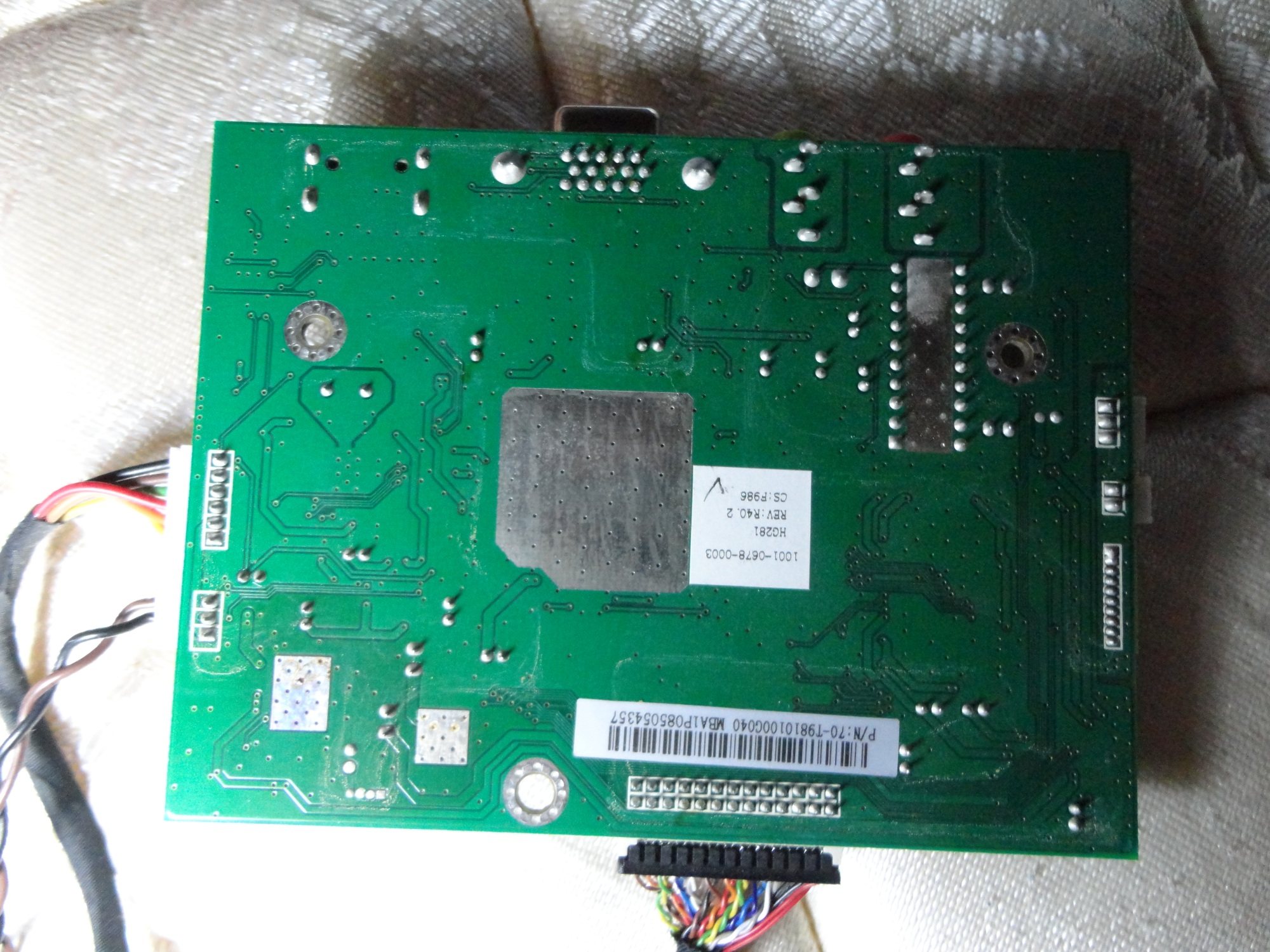

        Regardless, attached are pictures of the logic and power boards (i think) top and bottom. The only small visible imperfection is titled "untitled" and is a bit of white stuff (C34).
        Whats next? Do i grab a multimeter?
        Thanks again :3

          Re: Hanns-G HG281D Problem (badcap maybe)
          Originally posted by r1ckjam35
          I may end up playing with an old mobo before i try to solder on the functioning board, but at this point, i think i may be performing the repair on my own.
          Practicing is a good idea. However, motherboards are likely 4 layers or more which means more copper planes to suck the heat away from iron tip.
          The power board on your lcd is likely to be 1 layer making it much easier to solder.
          No multimeter can measure ESR (equivalent series resistance). Your description in post #1 highly suggest that the caps have high ESR. As the caps warm up, their ESR drops and this allows the lcd to work properly. Caps with high ESR will not necessarily bloat. Once the cap cools, the ESR rises and the lcd doesn't work again until warmed up.
          By my count, you have 15 caps on the power board (including the big one). I suggest a complete recap of the power board.

              These are the capacitors currently on the power board (apologies for formatting, ill attach the xls when this gets unreadable):
              Currently
              Voltage (v) Capacitance (uF) Quantity Brand
              450 180 1 Rubycon
              10 220 1 Rubycon
              50 10 4 Tiacom
              35 33 1 Tiacom
              35 1000 2 KY
              25 680 2 KY
              25 220 1 Tiacom
              16 100 1 Tiacom
              10 1000 2 KZH
              Total 15
              Do any of these look unreasonable? I did my best to double check. The two brands KY and KZH are preceded by the logo associated with the Chemi-con brands here:

                            I totally forgot to ask for pictures of the inverter board. There are caps on there as well. Let's see who makes them and it is possible they have high ESR as well.
