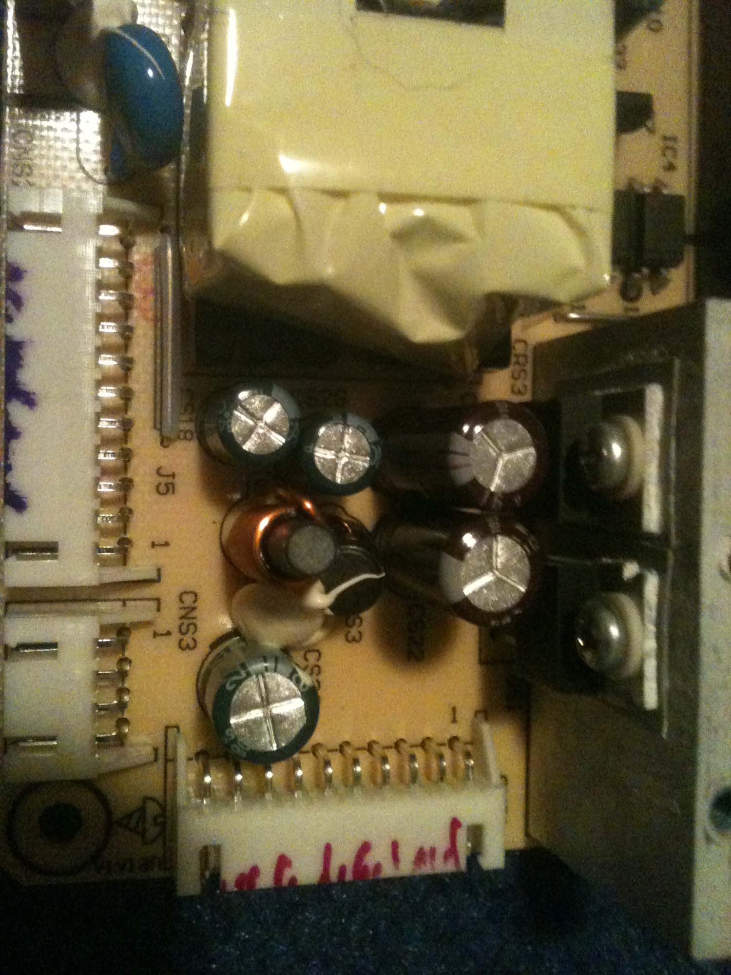

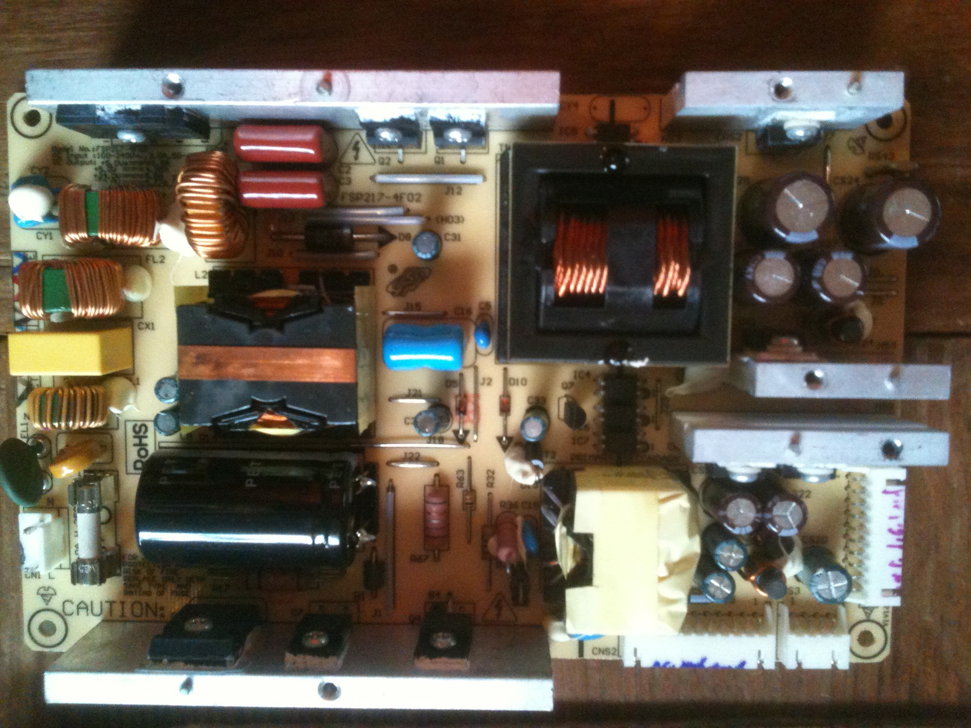

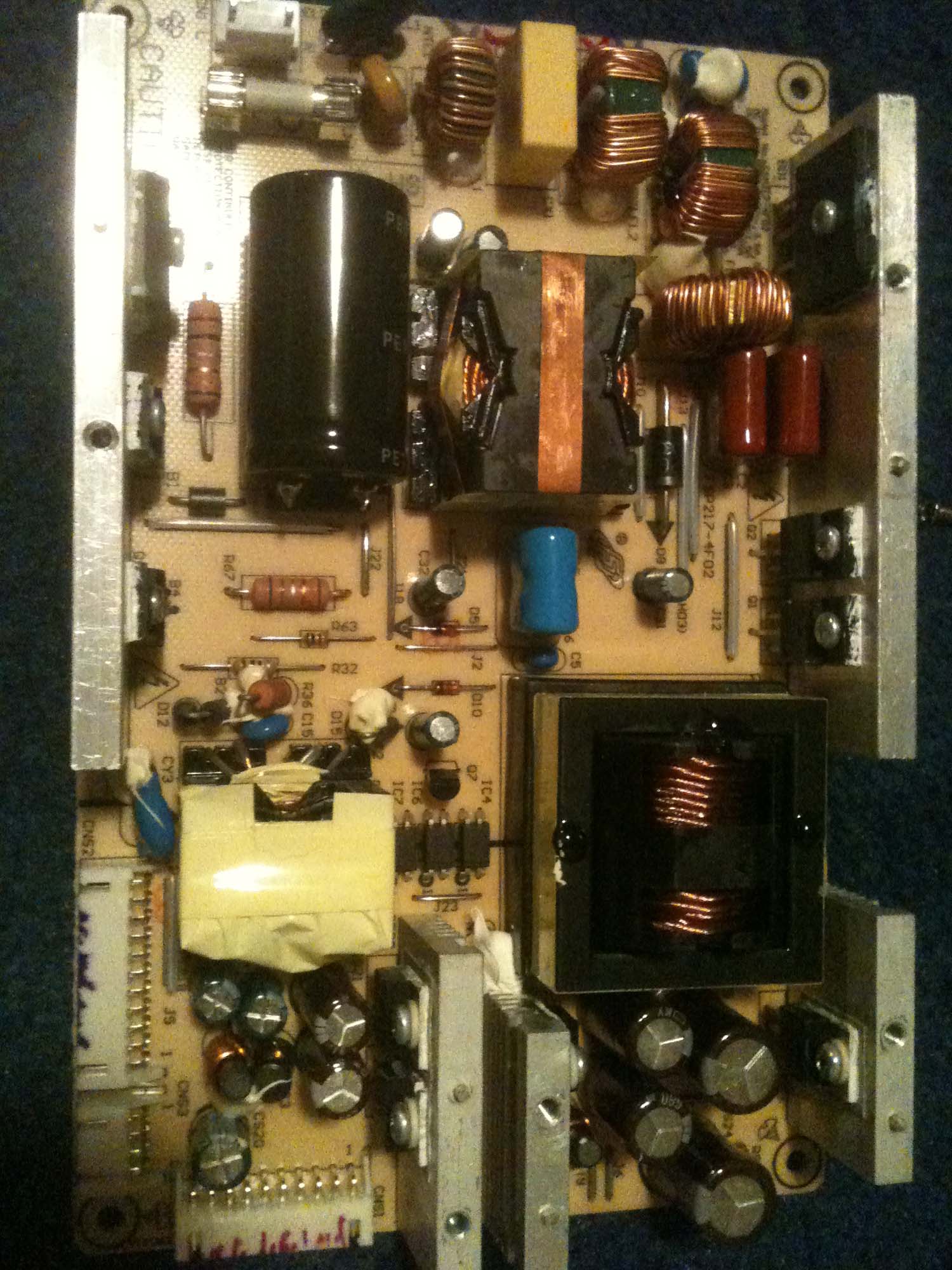

      Re: I-Inc IF281D Display Problem
      Here is the inverter board picture. If you need more let me know. again thanks for your help.
      • jetadm123
        • 2169
        What you're showing is the power supply. The inverter is the board that generates the high voltage for the backlighting. In your third photo, it appears to be the board at the very top with all the transformers on it.

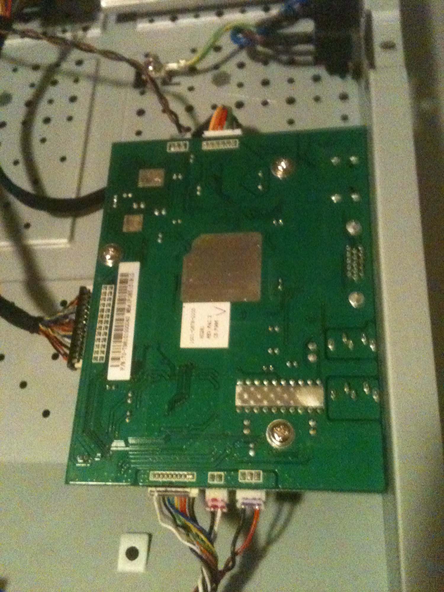

          i removed the inverter board from the monitor but it has some plastic cover over which is very difficult to remove.
                  Well, it appears that the printing on the power board indicates the output voltages are 5v and 24v. Correct? The 24v should feed the inverter and the 5v supplies the video board. I suggest piecing everything back together and measuring for these voltages at the wiring harnesses connected to each board.
                  • AloofOne
                    • Jan 2012
                    • 26
                    Says on the board. model# FSP217-4F02, DC Output +5.0V -1.5A, +5.0V - 4.35A,+24.0V - 5.5A, +12.0V - 4.77A.
                    i've also taken some readings on the board prior to your post i hope they help.

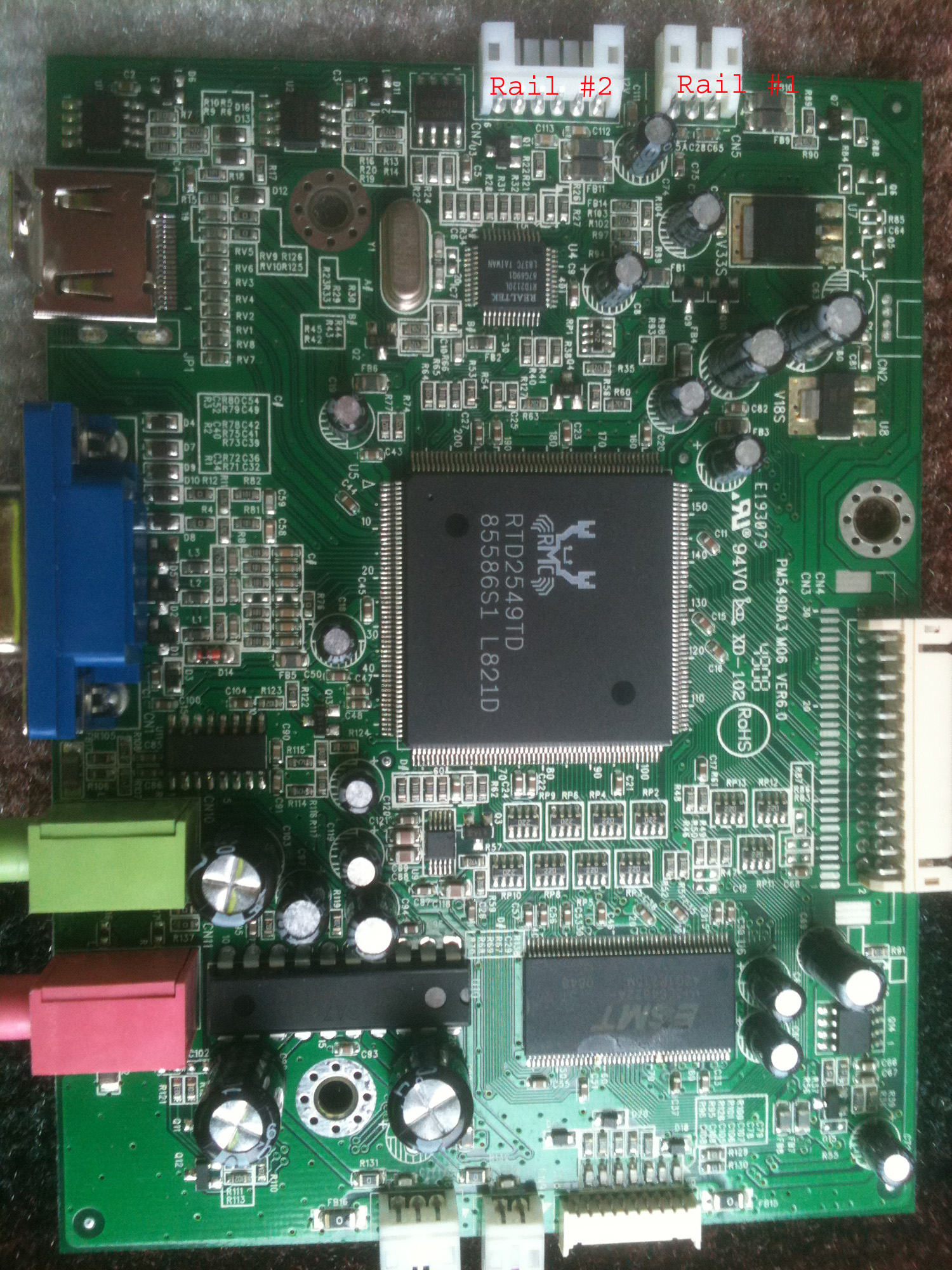

                        Okay i'm back with more information.
                        I took some readings from video board with the power plugged in and connected the power board.
                        Rail 1 = 5.09
                        Rail 2 =
                        Yellow = -21.7
                        Orange = -21.7
                        Red = 5.07
                        Green = -21.7
                        Brown = -21.7
                        here is a photo of the area i took readings from
                          Originally posted by AloofOne
                          Rail 2 =
                          Yellow = -21.7
                          Orange = -21.7
                          Red = 5.07
                          Green = -21.7
                          Brown = -21.7
                          If you are getting negative voltages, you are probably using the wrong ground point. Use a screw (like the one by CN4/CN3) on the main board and remeasure.
                              i used the black wire from the set as ground. i'll try using a screw. As far as the reading i just copied what i saw from the DMM which has autorange on. do you need me to list which is a resistance test or diode test? i'm not a pro at using this meter. =)

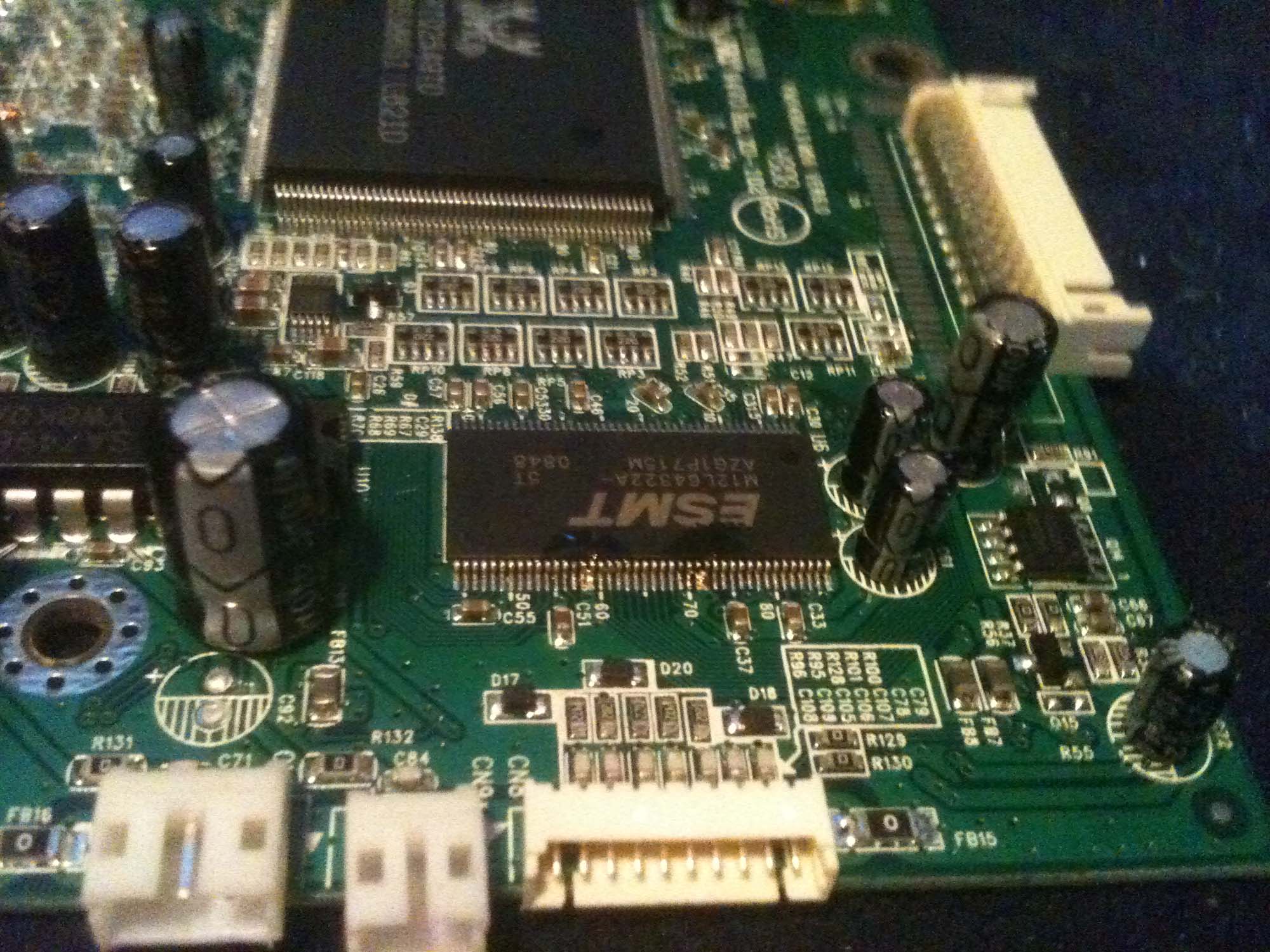

                                      ok here are the results
                                      smaller chip =
                                      2.2Vdc
                                      1.805vdc
                                      3.304vdc
                                      Larger Chip=
                                      2.3vdc
                                      3.304vdc
                                      5.14vdc
                                      I take another photo of the video board so its easier to see.
                                      • jetadm123
                                        • 2169
                                        The voltages look good. With a computer connected to the monitor, shine a bright light at an angle against the monitor screen to see if you can see an image.
