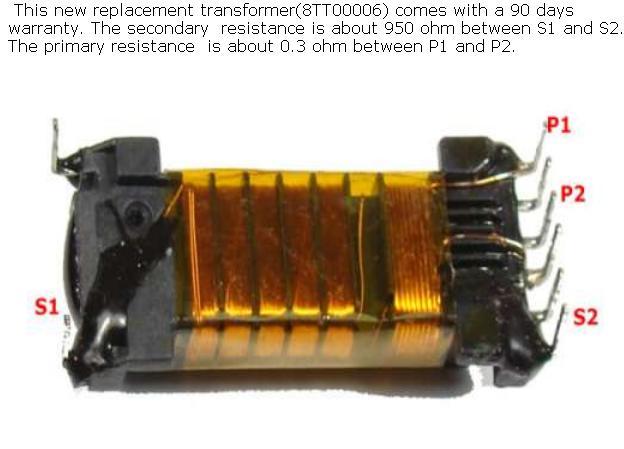

    there is a very strange behaviour with this monitor.
    the test:
    disconnected the upper CCFLs and tried 2 ones from a 22" WS (just for a try). worked!
    fitted 2 used 17" CCFLs (from an old hannsG). didnt work. still 2sec to black issue. (only 1 ccfl lit)
    fitted 2 new 17" ones. one didnt lit again, and went to black after 2 secs.
    connected only one CCFL at one connector, the left one, worked for 2 secs. the other one didnt lit at all. very strange, when connected the 22ws ones, one although doesnt lit, it works, doesnt go black.
    this monitor has two separate transformers for one section , so it has 4 transformers. maybe the one that doesnt light at all is faulty?

    That sounds logical. I suggest checking the secondaries of the inverter transformers.

      i might be blind or worse, but the secondaries show infinite ohms :S. the multimeter works well, measured another monitor inverter, showed 950ohms. checked the 4 inverters on this samsung, none of them showed any sign of life.. is this possible? the CCFLs Do light.

          after further investigation i realized that i had to measure the HT pin of the inverter in respect to the ground. 3 of them showed 904ohms and the faulty one, 0 ohms.
          its an SPI 8TT00006. 10 inverters would cost 35$ from a reputable ebay seller from china. worth it?

            There are four factors to consider.
            1. What is the monitor worth? In the USA that monitor would sell for about $35-$45 in working condition.
            2. Some companies sell inverter transformers for $15 - $25 each plus shipping. By any standard $3.50 each is a bargain.
            3. Can you sell the extra transformers?
            4. Are the transformers available in smaller quantities?

              Hi I cant see that you have posted picures of the boards but I believe some
              people have had success in re soldering the pins on the "faulty" inverter transformers so you could try that. Also before you place an order It may be worth removing the old one from the board and retesting it just to make sure its not lacquer on the pins.
              This transformer is used in a few other monitors. If like yours there are 4
              on the boards and you could get a faulty board cheap somewhere it would be unlikely that all 4 transformers will be faulty.

                thank you all. ill try resoldering the pins first thing, than will see.
                this is sold in qt of 10 for 35$, 4 pieces for 22$ and 1 inverter for 10$. as i have read there is a series of samsung lcds (193s, 172v etc) which have this one so i think 10 inverters is a deal. all i care is the shipping time. 1 month! it will be shipped from china for free but i have to wait a lot.
