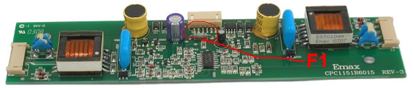

                              Re: Viewsonic VA720 - 2 secs to black
                              OK I found this big blue thing marked F1 and I measured it. It shows -0.00 on the 2k resistance setting.
                              I've circled and indicated F1 in the attached image
                              Anythnig else I should test?

                                #35
                                For fuses, you generally want the lowest Ohm setting on your manual ranging multimeter (200 Ohm) so you get more digit resolution. Having said that the fuse is good.
                                I can't tell from the pictures, but it looks like the ccfl cables are not the 2 wire scenario. If that is correct, you may have a hard time finding a compatible lcd screen that fit those connectors.
                                I picked up two 17 inch monitors and both have 2 seconds to black. I haven't had time yet to test them, but both have 3 wire connectors so at least I can stretch out the ccfl cables for testing purposes.
                                If you don't have the 3 wire compatible lcd, you will have to take apart the lcd panel and check for bad wiring and/or bad ccfl as I discussed in the earlier posts.
                                If you find bad wiring, you may be able to resolder the ends and make it work. If it is a bad ccfl, the cost of replacing it is questionable at best for an 8 year old 17 inch monitor, but that is for you to decide how to spend your money.
