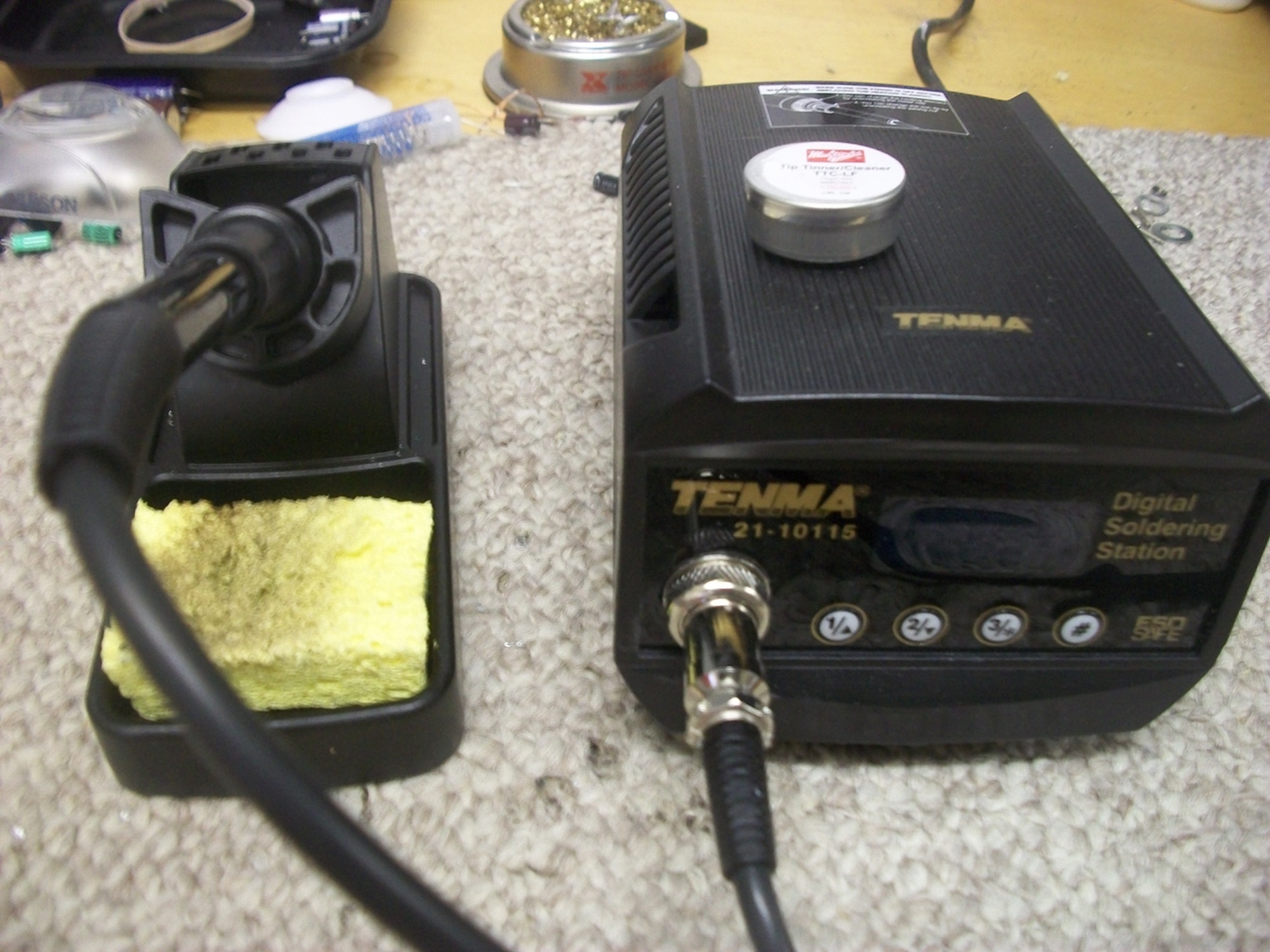

              Any chance of a picture and what type of tip and what tempr is your iron at.

                Yes, I will have to post it tomorrow. The tip is a chisel a little smaller than the pads. The temp. is 700 deg. Have not had this trouble before. Usually if it happens it is when I am adding solder. If it happens I can usually suck up the solder and put new down and that takes care of the problem, but like I said it did not help this time.

                • mariushm
                  • May 2011
                  • 3799
                  Re: Solder Joints
                  700 degrees? That's 370c ... kind of A LOT. But usually people with temperature controlled stations set them to 300-350c as the tip generally has lower temperature than the rest and when touching what you want to solder it cools down a bit.
                  The 63/37 is a bit different than the regular 60/40 or the solder free kind, in the sense that it's euctetic, it turns liquid within a very small range of temperature (usually exactly 183C). It also turns solid much faster.
                  In comparison the 60/40 stays liquid at around 188c/370f and the lead free kinds at ~ 217c.. See http://en.wikipedia.org/wiki/Solder#Lead_solder
                  Maybe you're just lifting the gun when the solder is already turning solid, therefore disturbing it?

                      If you're using a good multicore rosin flux like Kester and not some no name Chinese crap flux shouldn't be the issue and it should be right where you need it.
                      I keep the temperature of my iron at 350C that's 662F.
                      Do you routinely clean your tip with a brass shaving cleaner, wet sponge, or a tip tinner? Oxidation on the tip from burning flux will erode the iron plating and cause heat transfer issues.

                        Pictures of Iron. Could not get clear picture of tip. It is a small chisel tip. Sorry picture must have been too big I will try to resize it and repost.

                            I will reduce my temp to 660 -670 and try that. The solder is good. I am using a both a sponge and the brass shavings. The tips that go with this station are pre-tinned tips. However they still oxidize some. I wonder if this board used lead free and I am adding leaded back and that could be the problem. Although it is still only on some pins and not on all that I am having this trouble. I tried cleaning the pad with solder wick after using the solder sucker and that seemed to help some.
