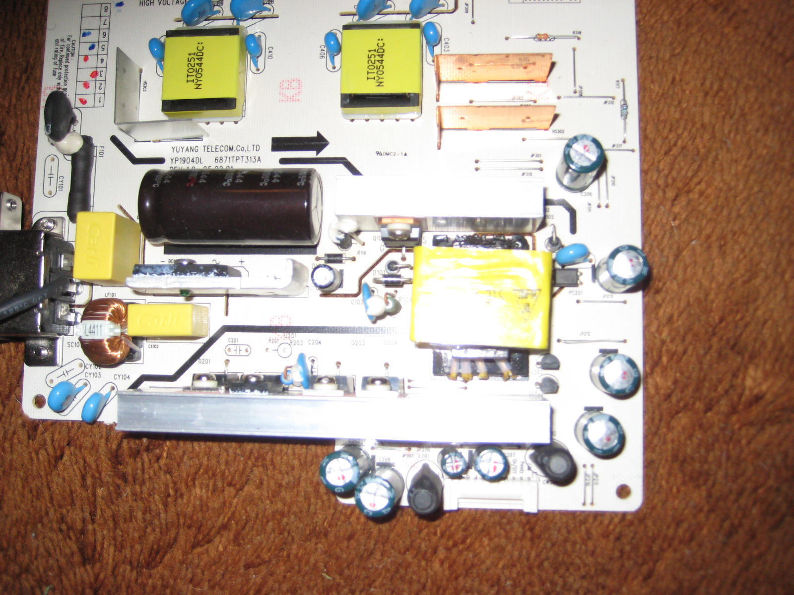

    I have a really nice monitor that I'd like to get working. The Dell takes in line voltage (120V AC). But nothing lights up at all, not even neon lights.
    I took it apart and found three bulging capacitors. The main fuse seems to be ok. I found about 400V across the big capacitor, using an AC multimeter scale.
    Other than that I don't know how to proceed. I don't have an extra CCFL on hand.
    In the first picture below, the three caps are the ones in the foreground, left. They are 1- 820uF, 25V GF(M) (the tall one) and 2- 1000uF, 10V, U9A (the other two).
    Please let me know if there is any other info you need. Any help is appreciated.

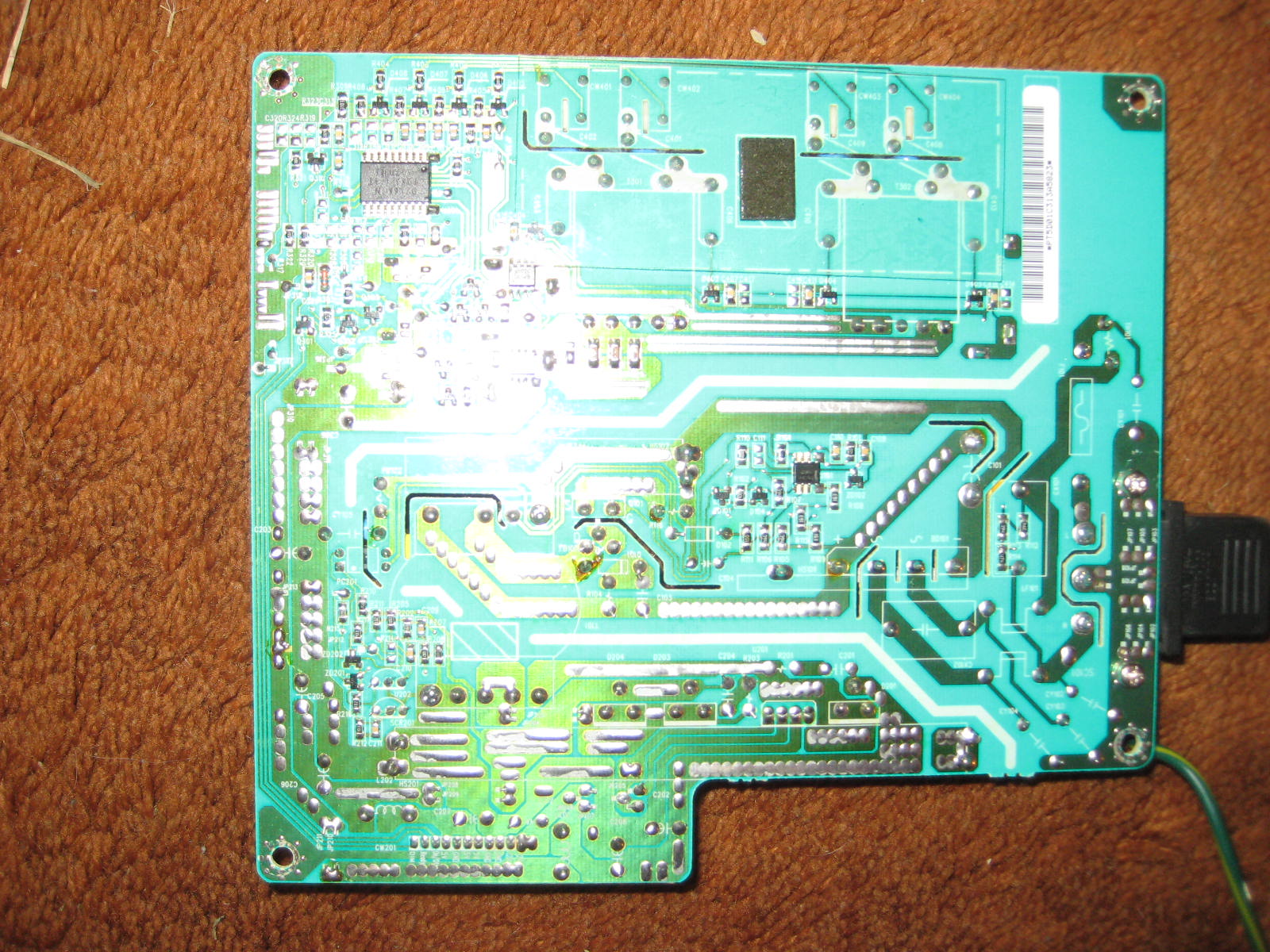

      How about doing this the proper way? Take two pictures one of the power supply from directly overhead, and one of the back side of the power supply. For best results, they should be at least 1000 pixels on a side, but no side should be greater than 2000 pixels. Attach them using 'Manage Attachments' - below the text entry area.

        Replace ALL your electrolytic caps on the power board, and not just the bulging ones. The largest one can be left as is because it rarely, but not never, fails.
        Capacitors die from age, heat, and shoddy build quality. Capacitors DO NOT have to be visibly bloated in order to bad. They can be out of tolerance uF (a 1000uF measures 20uF) and/or have high ESR (ohm). A multimeter will be insufficient to test for ESR. For that you need an ESR tester which costs between $50 and $300.
        PCBONEZ will me if I don't explain that when replacing caps, you want the same or more ripple and the same or less ESR (ohms) as per
        https://www.badcaps.net/forum/showpos...47&postcount=3
        Members here like Panasonic FR, FM, and FC series in that order.
        PS. If you live in the USA and depending if the monitor has PFC or not, DC voltages at the big cap can reach 360 to 370V DC. As Rtech says, you are measuring DC across the big cap.

          Second, the new pics should be attached.

                There are three ways to handle this problem.
                The first is a step by step approach. Replace the three obviously bad capacitors. If the monitor still isn't working, move on with the troubleshooting. This has the advantage of using the minimum number of components while is has the disadvantage of incurring significant shipping charges.
                A second approach is to perform some rudimentary tests before ordering any parts, then order all parts that appear to be required. This takes more time initially, but improves the chances of getting a working monitor on the first try. On the bottom of the card are labels indicating the voltages out of the supply. With power on, carefully measure the voltage on each of these pins, using the pins labeled GND as a reference.
                The pictures leave a lot to be desired. The easiest way to get better pictures is to turn off the flash and take the pictures near a window on a sunny day.
                PlainBill

                  Thanks, that was helpful. I decided to stay in-house here, to order Rubycons, and to try the incremental approach.
                  I just checked those output voltages, and all the Ground, 12V and 5V terminals are registering fine. I'm getting nothing from the On/Off, Ready, and DIM terminals, but I'm not sure I should. I have the power board detached from everything else but the line voltage.
                  Lacking any contradictory indications here, I'm going to order the three bulging caps tomorrow.

                        Thanks, but I don't see a C112. On the back I see the solder points for C110 and C111, but they are under the big cap, and I don't see anything corresponding to them on the face of the board.

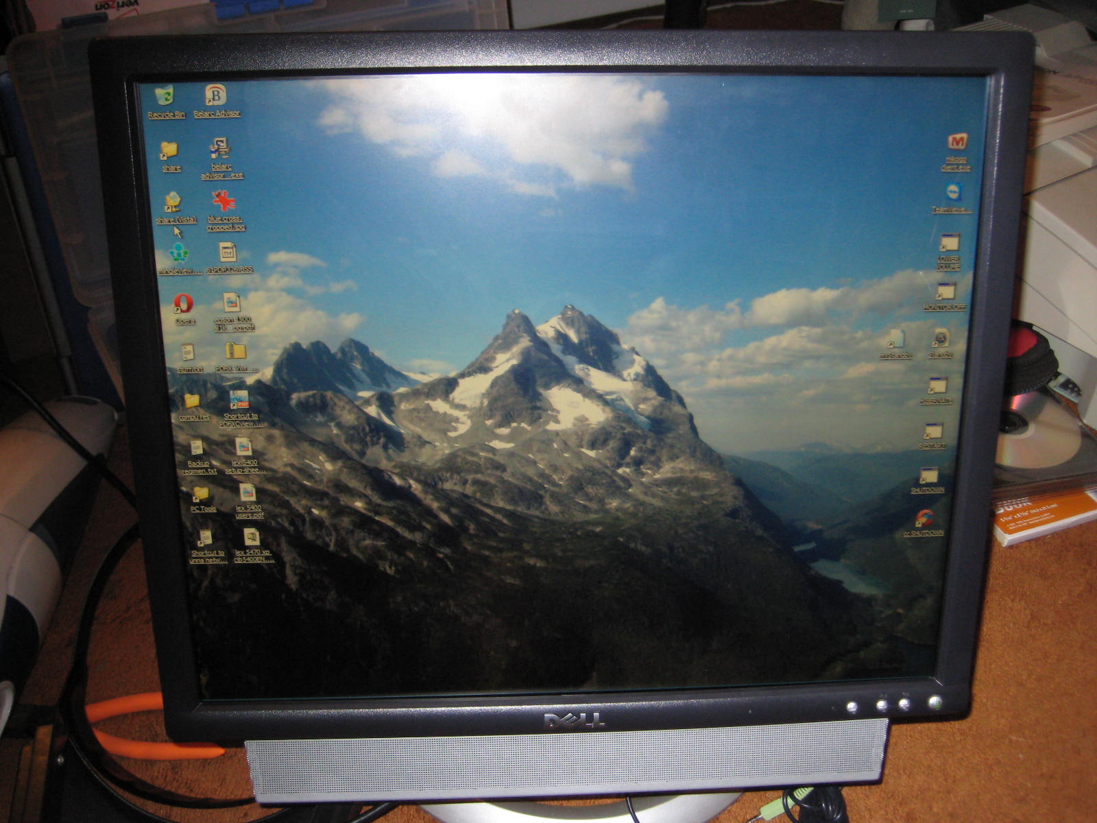

                          Gentlemen,
                          Observe your handiwork. I got the three caps today, and put them in this evening. The hardest thing by far was remembering how this thing went together. Next time I think I will need to put the machine together as I await the parts.
                          But aside from that the job went very easily. Amazingly so, actually. Many thanks for your insightful guidance. We now have another monitor at our disposal.
                          THANK YOU,
                          p.
