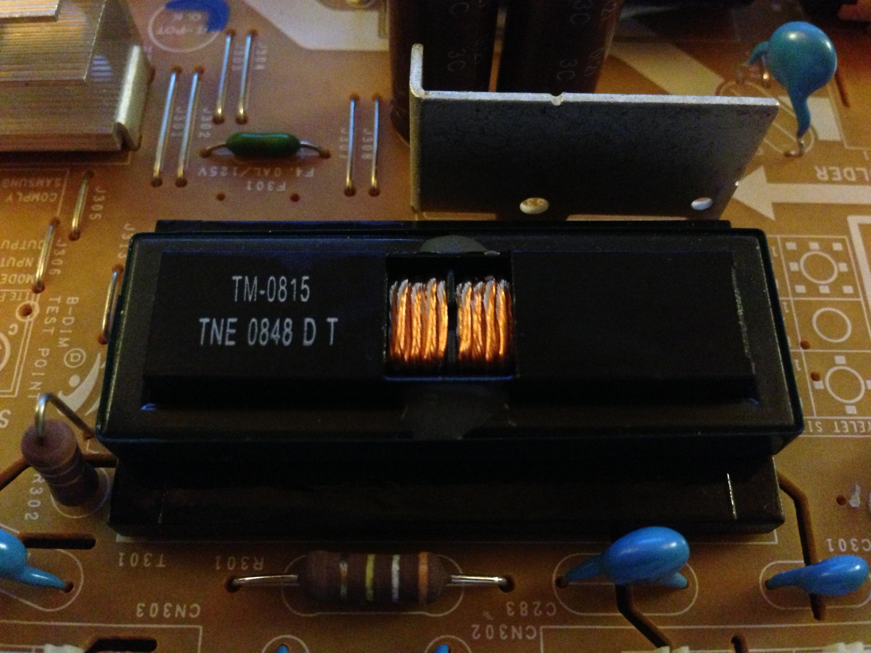

            Hello!
            This is my first post to the forum so I hope I'm following the rules. I have the exact monitor (Samsung 2233SW) with the exact problem (any time there is a signal change, the display flashes for about 2-3 seconds then remains off). I have replaced the 1000uF (x2), 330uF and 820uF (x3) caps with no change. I also found a cheep controller board on Ebay thinking that was the other option (before I found this excellent forum)...installed it...no change.
            Just tonight I followed your advice and measured the resistance as you indicated in the picture linked above. It looks like there is a significant variation between the two measurements (~19%), so I suspect the inverter is bad.
            So, on to my question...I've not replaced an inverter before and I'm hoping you have some suggestions on how to select one for purchase and a few tips for the install. I will try to post a close up pic of the model information. In case I'm not allowed to do so yet (too noob) the text is: (line 1) TM-0815 (line 2) TNE 0848 D T
            First off, are there other tests I should do before I buy a new part? If I end up needing to get a new one, do I need to find the exact match or is there another similar option? It will probably be obvious with a new part but which of the pins do I need to de-solder?
            Thanks in advance!

              Re: Samsung 2233sw Power on then off
              based on your Resistance readings,you need to replace the Transformer.You need the exact one by Part number which you have noted.You need not do any other tests.AS you indicate you can see which pns to unsolder when you get a new one.Ebay is a source for the part sometimes,as is http://www.lcdparts.net/T.aspx
                    Received the transformer yesterday...installed today, and voila'! All FIXED!! I'm using the monitor as I type this. Thank you for all the great advice!! I'll be sure to come back here for my next project!
