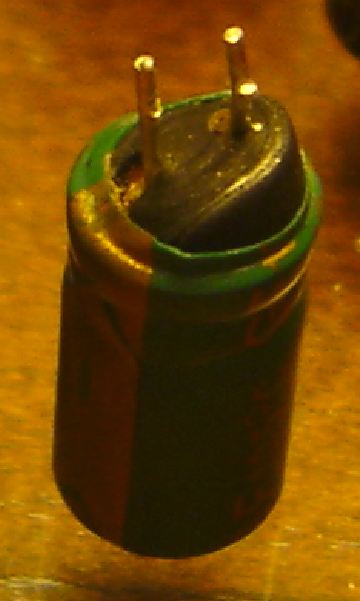

    Greetings. Have been having trouble with my monitor the last couple of weeks. No start on the monitor, the green light flashing on/off every 3-4 seconds and the speakers "click" every light cycle. Initially thought it was the computer or graphic card until one day I turned on both monitors and the main monitor HC194 was not on, the second monitor was on and displaying normal. Changed cable, swapped ports on graphic card no change. It takes 5 minutes and then the monitor looks normal and lasts until I turn it off. Moved the monitor to a second computer, same problem. Don't know if this is normal or not, but with just the power cord connected, the monitor light will also flash, I cannot get the Menu button to produce anything on the screen. Is the data cable supposed to be attached and computer on before you can get to the menu screen?? Appreciate any suggestions on the slow start problem. Tx

    Those are textbook signs of failing caps in the power supply. The best approach is to open the monitor up, take pictures of the power supply, and attach them to your next post using 'Manage Attachments' - below the text entry area.
    As a rough estimate, the parts to do a complete recap of the monitor will cost about $10 delivered if you are in the USA.

      Most of the caps, I can get a value on. The caps inside the heat sink and the big black cap, I cannot. Looks like 56,54,51,52, 8 and 10 have swelled tops

        Looks like the same cheap NKCON brand caps that TDK uses on their inverter boards. Suggest you replace all caps with the exception of the large 450V one, which rarely fails. You can use Panasonic FR, FM or FC series caps available from digikey.com. Like PlainBill says, it should run you around $10, including shipping.

          I agree, the big cap's top looks perfectly flat. Looks like I will have to unsolder the ones I cannot read to get a value on for the order. Upon further investigation, the 4 caps together on the side of the heat sink looks like two of them have taken a "pooh" out the bottom!

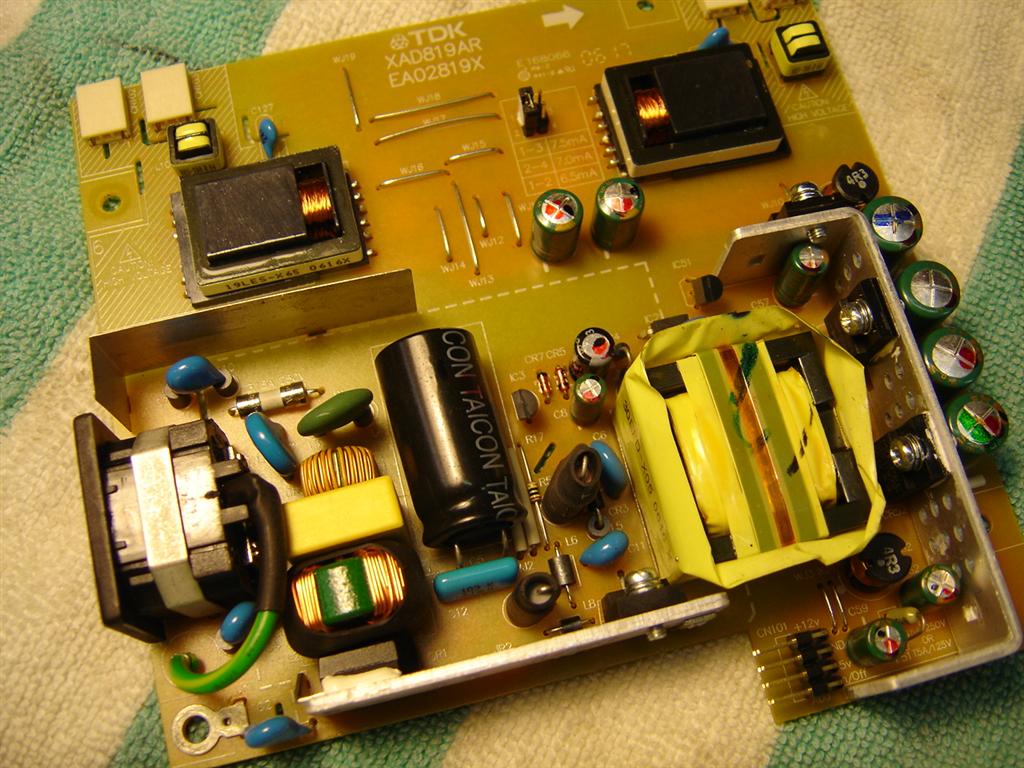

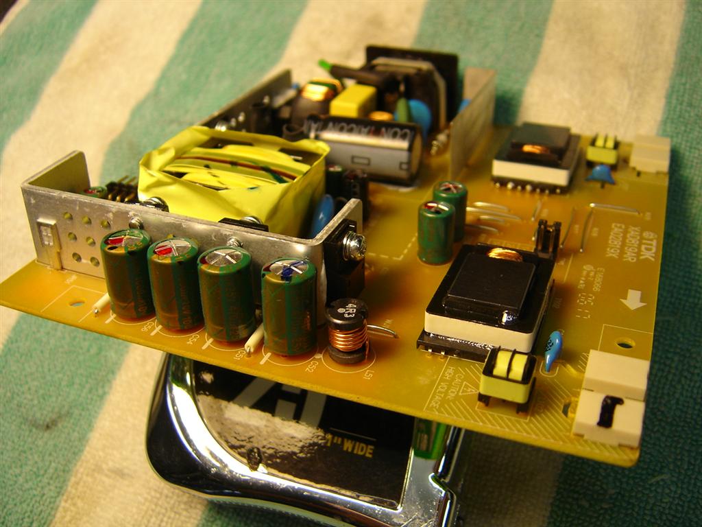

            A couple of things nobody has mentioned yet, some obvious (in hindsight), some subtle.
            There are a total of 10 caps that should be replaced. C8 and C10 can cause problems, and won't show any physical signs when they fail.
            When removing the old caps, make a chart showing what value cap goes in each location.
            If you place the order with Digikey, specify USPS First Class Mail shipping; it will cost about $3.00 to ship an order this size.
            When ordering replacements, make sure they will fit. It is really embarrassing if the monitor works, but you can't get the covers on.

                  Got the caps out. Since I have a choice of the FM or FC Panasonic, is there really a difference. Price seems to be a couple of cents difference?
                  C101/102 = 220uf/35 2ea
                  c51/52 = 470uf/25 2ea
                  C54/C56 = 1000uf/10 2ea
                  C10 = 47uf/50 1 ea
                  C57/C62 = 100uf/25 2ea
                  C8=4.7uf/50 (almost missed the "." between 4&7) 1 ea
                  C59 = 100uf/10 1 ea
                  Panasonic FC Total$ = 5.50 +S/h
                  One of the 100uf/25 in the Thumb
                  Diagram made, polarity's noted. Thanks to all who helped on this.

                      FM has better specifications than FC. Select FC if you can't fine the proper values in FM.

                        Got the caps from DK installed without issue and my monitor fired up instantly. Crystal clear display again. Thanks for all the help

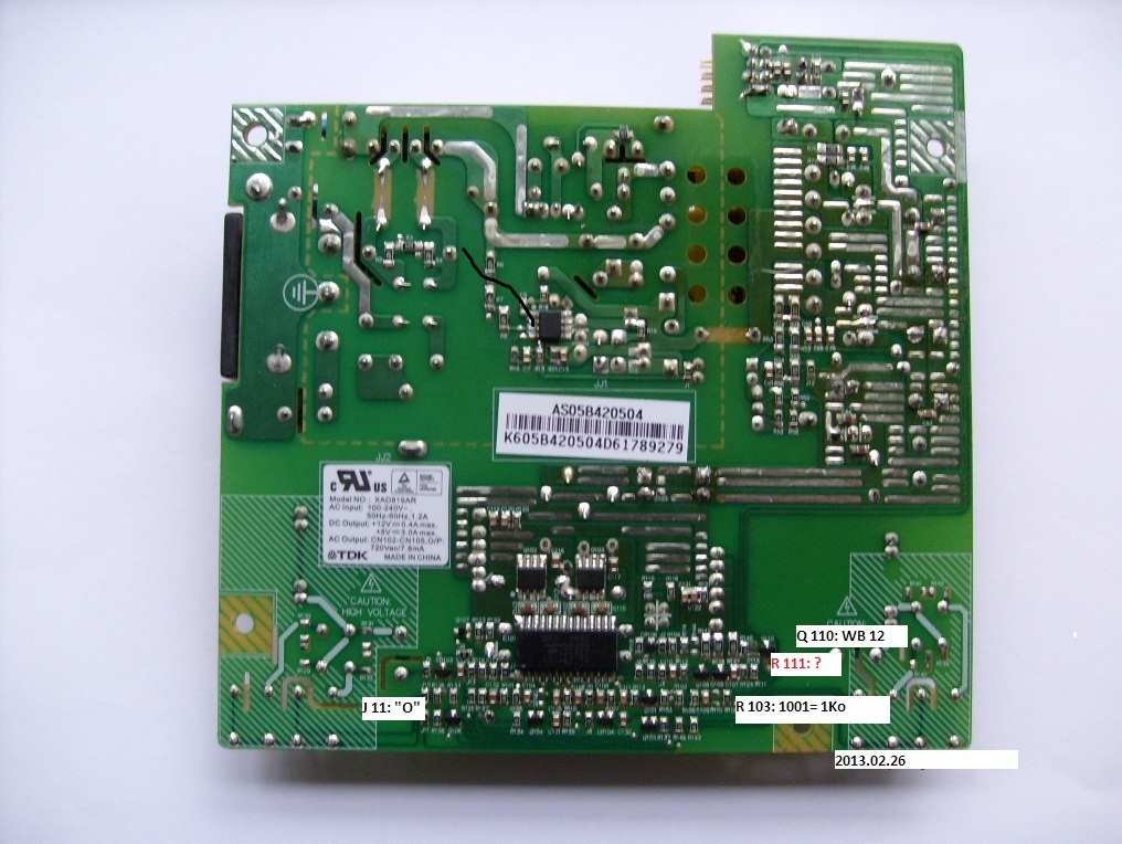

                              Hello!
                              Seeking the above schematic power supply (TDK XAD819R/EA02819X). I converted my monitor with LED-backlit, name: HannsG 198D HN, everything is ok with it, but I can not set the brightness automatically. On the monitor, of course, all functions can be controlled. It is taken out of one WB 12 labeled parts (the description says it's a zener diode), the three pieces of resistance (one of the values ??I remember "1001" that is 1K omhos and the other to know, because it's a jumper to "0 value. Just I am in trouble with the third one, because, although I did picture him before the operation, I do not see the value. I tried to GIMP, but would in no way been read. And they put away, I do not find it anywhere!'ll put a picture that you select the components. If someone Do you have any drawing of the power supply, or a list of parts I would really appreciate it! Sorry if the wrong formula, but I live in Hungary and I do not know English. I'm using Google translator.
