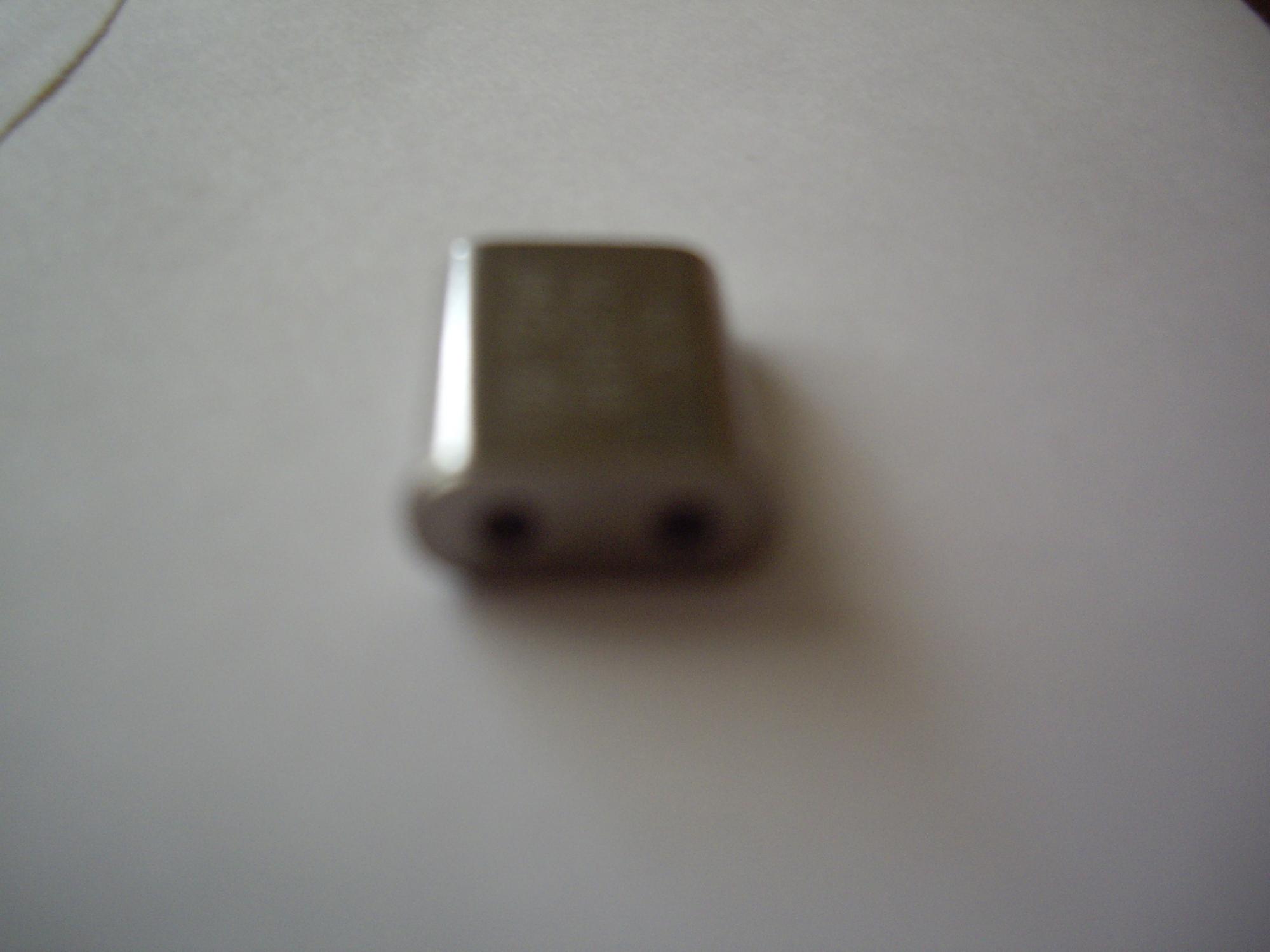

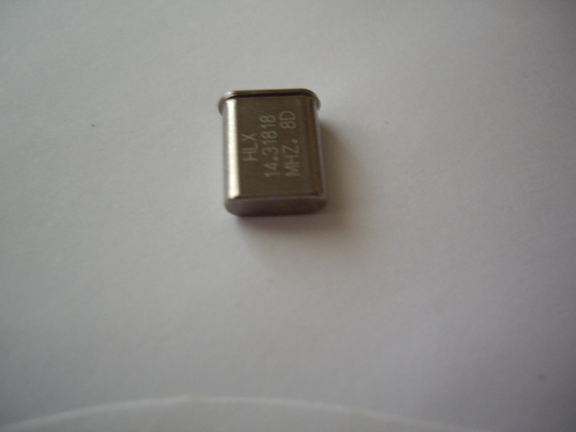

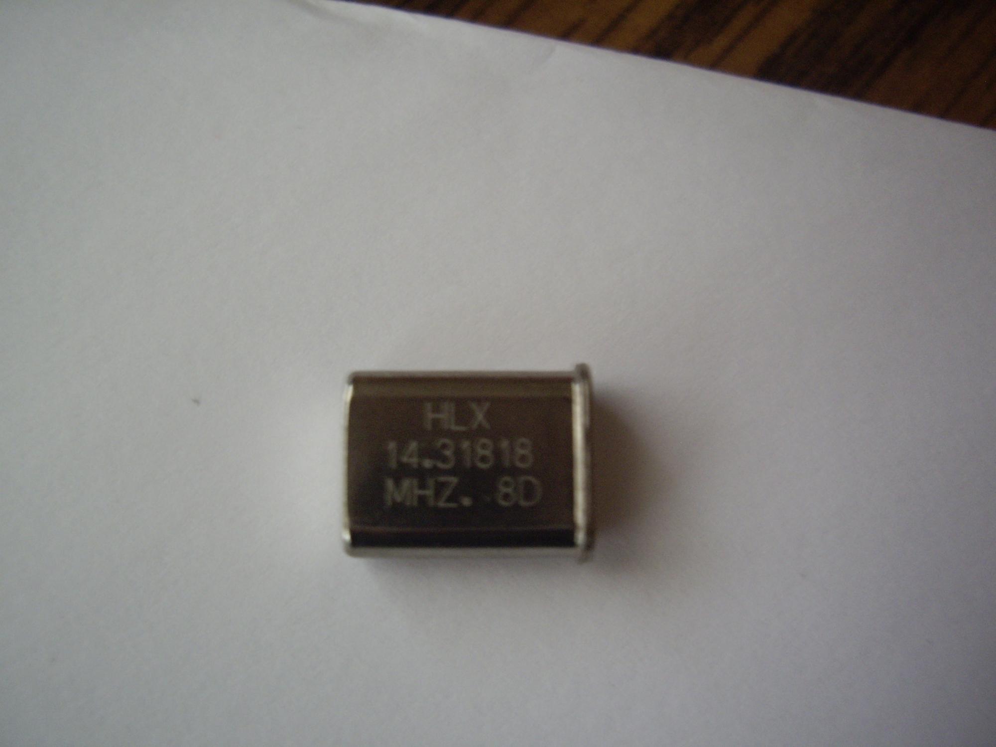

    Hello All,
    I have a part I need to replace on a LG 22" logic/video board. A friend is looking for it and I couldn't absolutely identify it. Contacted Digi-Key, they gave me two possible candidates.
    http://search.digikey.com/scripts/Dk...ords=CTX088-ND
    http://search.digikey.com/scripts/Dk...ords=CTX877-ND
    Perhaps someone could help me narrow down to one? I'll provide a model number if that helps at all?
    Thanks As Always
    Lcdman
    Re: I'm Looking For A Part
    That is a 14.31818 MHZ CRYSTAL
    The two digi-key ones have the same load capacitance as the one you have.
    as for which one is suited not sure maybe someone here can help.
      Without seeing and examining or a drawing or schematic of the circuit, you'll have to get one of each and see which one works.
      CTX877-ND - Is for parallel resonant circuits, which require a load capacitance (18pF) in the circuit for the crystal.
      CTX088-ND - Is for series circuits which do not need the load capacitance.
        Hello Again,
        Thanks to all so far. The logic/video board is out of a LG W2252TQ. I haven't yet found a schematic for the logic/video pcb. I could try buying both crystals from Digi-Key but would love to just buy one and not both. Does anyone out there have the schematic for just the logic/video board?
