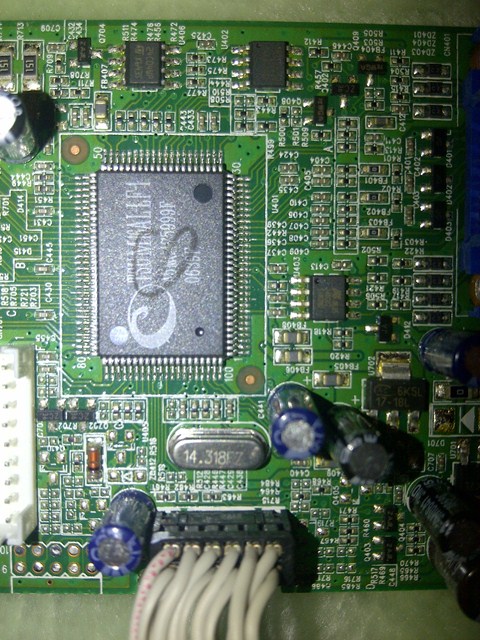

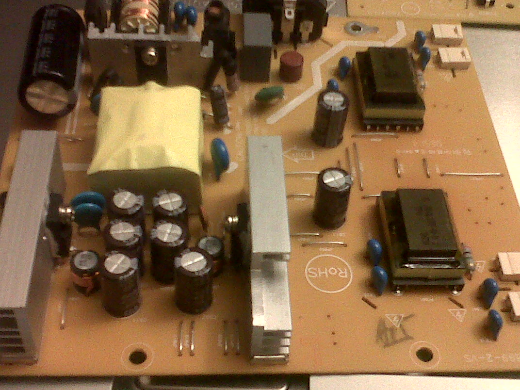

    Hi all new here, hoping to find some help with a monitor I trying to repair. This Monitor came in with power led not lighting at all on the front panel, when I checked the Power supply I can't find any faulty components. I checked the cap's all are good non leaking or swollen ever DCR & ESR are good. I checked transistors and resistors and all seem good. When check voltages I have 12v & 5v. not exactly sure where to go from here.
    Has anyone seen this problem before? Any ideas would be helpful. Thanks

    Since you've provided no photos of your boards, then that's equivalent to asking members to guess at what your problem is. Since you're getting no power light, yet getting 5V and 12V outputs, I'm thinking a failed reset controller. Usually labelled U405 or U406 on the logic board. If you remove this controller, it should power up. Again, due to lack of photos, proceed at your own risk.

        Re: Viewsonic Monitor VS11618/VA1903WB
        Another 'sharper' picture of the Logic board may be very helpful,as that looks to be where the fault lies.

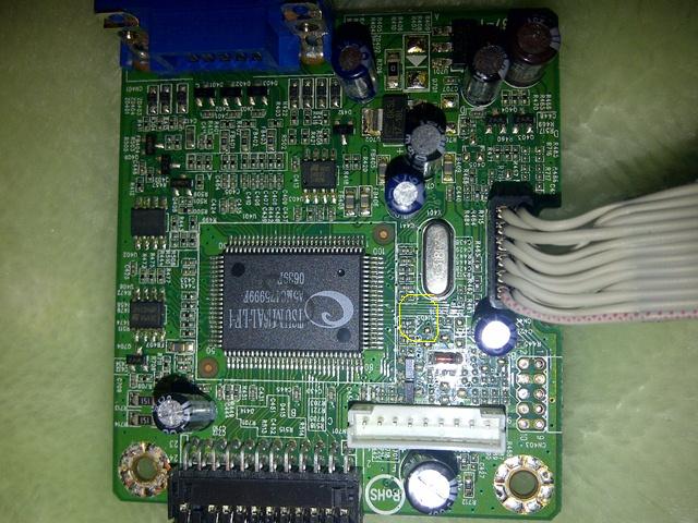

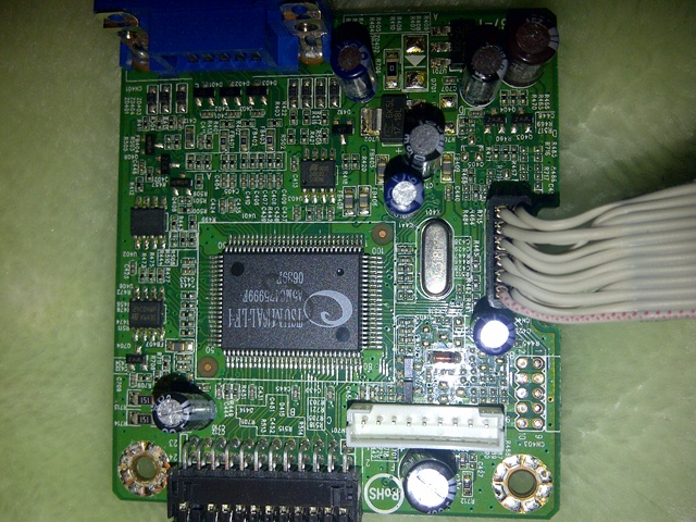

                  • jetadm123
                    • 2169
                    Unfortunately, what you removed is an eeprom. The reset controller is a 3-legged device. The link I provided has a datasheet for it. What was U405?
                    • simplytrini
                      • Jul 2011
                      • 73
                      Can't find a U405, I got pics this time.
                      • jetadm123
                        • 2169

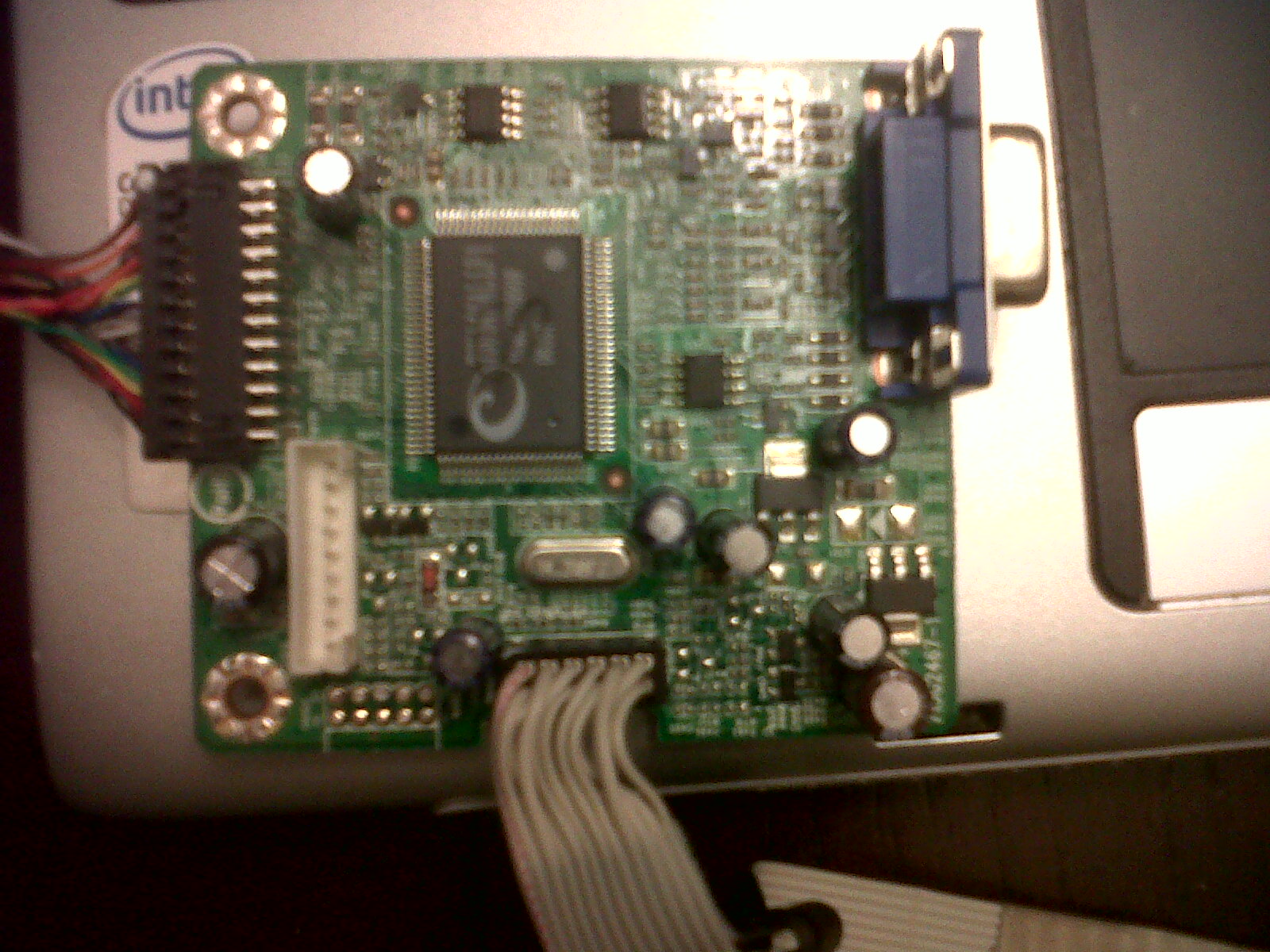

                        I can barely make it out. It looks like U405 was printed on the circuit board, but was not used. Not sure why removing U406 allowed the monitor to work. This possibly could be a eeprom that stores user settings made using the on screen display (OSD) menu. You can verify by changing a setting on the menu, turning the monitor off for a minute and back on to see if the menu setting was saved.
                        • simplytrini
                          • Jul 2011
                          • 73
                          Thanks for all your help. I reinstalled the U406 and everything works now. Not sure if there was a bad solder joint, but it works now. Thanks again
