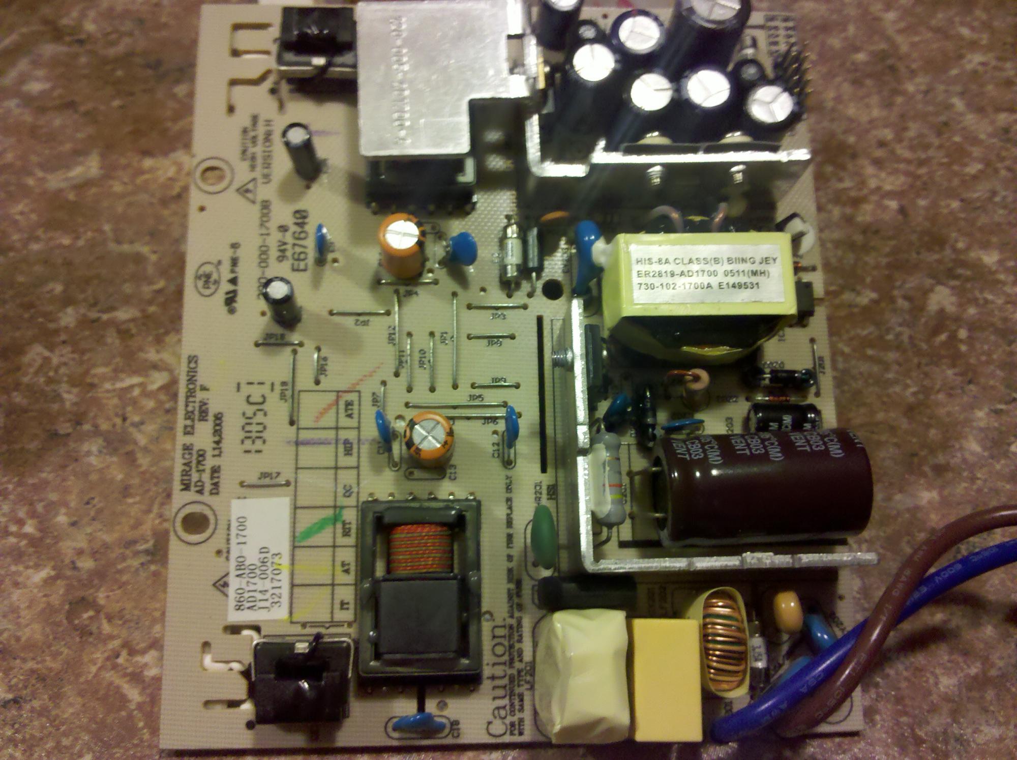

    Hello to all.
    I have a MAG LT782s LCD monitor. I got this free from a friend's shop. This start out as a "some times it works" to a "deader than you know what".
    First thing I did was research. I found this site and found that some people did a cap replacement. So, I did a cap replacement with some caps I had. The power board model is AD-1700 REV: F from Mirage Electronics dated 1,14,2005. There is also another number on the board that is 200-000-1700B VERSION: H.
    Here is what I replaced.
    6 x 470uF 25v with 5 x 470uF 25v and 1 x 470uF 50v (only had 5 25v and the next one up was the 50v)
    2 x 10uF 50v
    2 x 100uF 25v
    When I replaced the six 470uF, the monitor started to work great. It worked for a day then stared the 2 seconds on then black with green LED. I can still see the screen and what is on it if you look at it in the right lighting. So I know the video is all good. I then replaced the 10uF and 100uF caps and it is still doing the 2 seconds on then black. I can post pics if needed, just ask what you need. Someone suggested that it may be bad CCFLs. I would try replacing them, but I don't have any new ones. I did try some old ones from an old cracked LCD, but it did the same thing.
    Any thoughts?

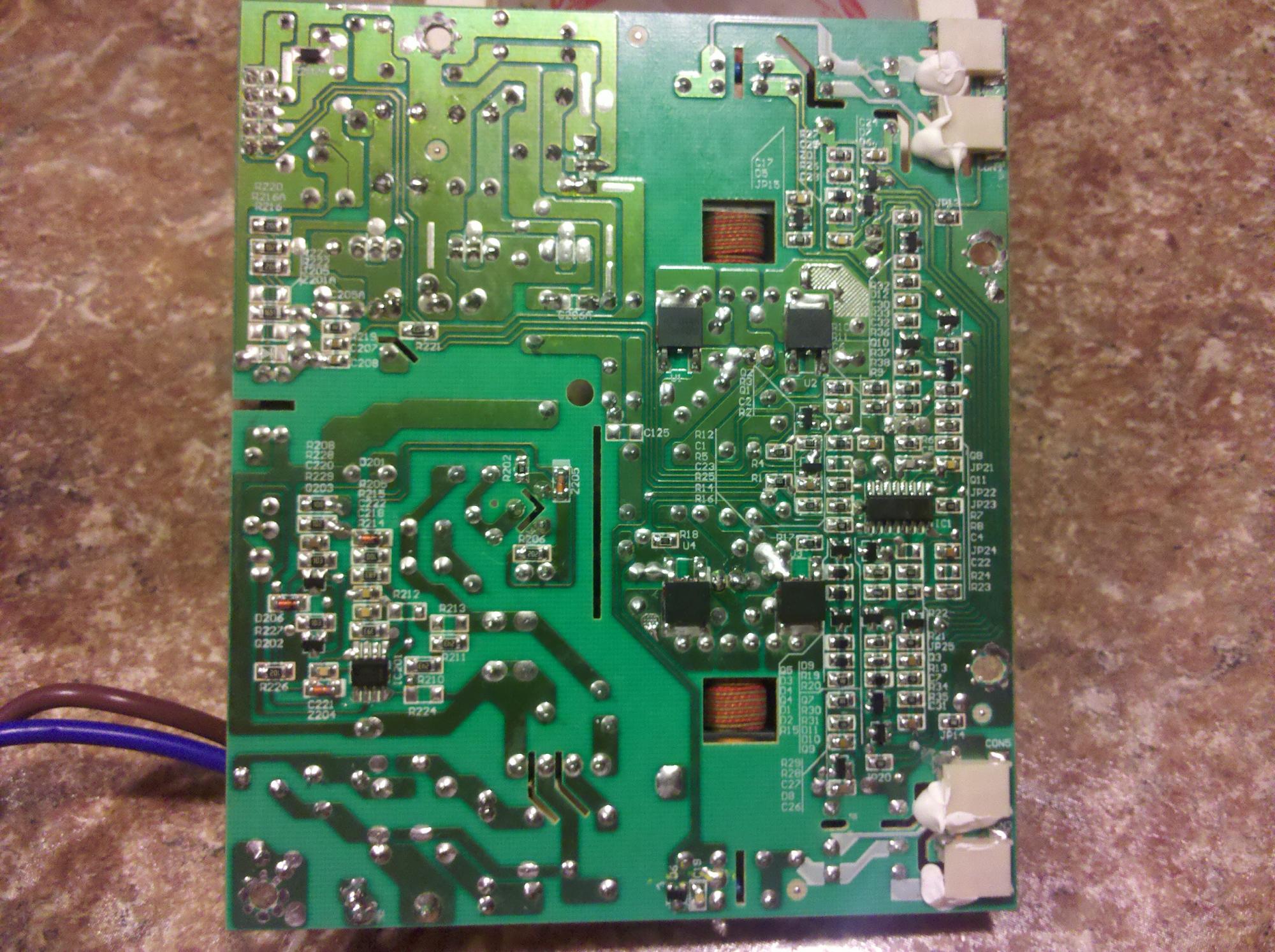

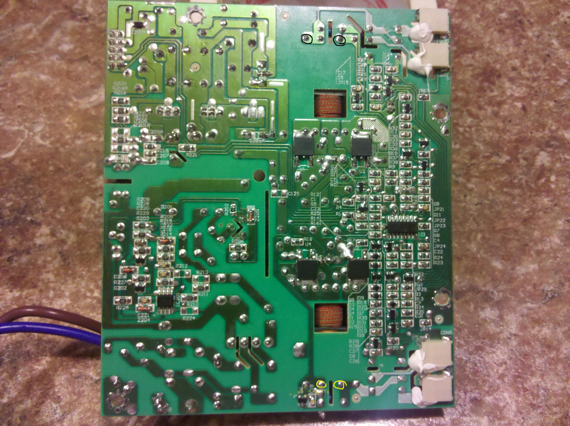

        Can you point to the components to test? I have links to pics of the front and back. There not that great, had to use my cell to take them since I couldn't find the digital camera. As for now, off to bed. I will check back tomorrow. Thanks for the help!!!
        http://img402.*************/img402/9...0709205704.jpg
        http://img843.*************/img843/6...0709210132.jpg

              Re: Need some help with a MAG LT782s LCD
              The pictures are tantalizing - they ALMOST show enough to trace the circuits. Still, they are an improvement over most cell phone pics and a vast improvement over n pictures.
              You mention having a monitor with a cracked screen available. Here's what I'm going to suggest. Position the two monitors so you can hook leads from the CCFLs in the other monitor to the connectors on this power supply / inverter. One at a time, substitute a ccfl from the other monitor for a ccfl in this monitor. As a verification, hook the CCFLs in this monitor to the inverter outputs of the other monitor. While doing this test, CCFLs must be connected to both connectors of the pair (upper or lower) being tested.
              The object is to see if a pattern can be discerned - for example, if any CCFL hooked to a particular output will never light, the conclusion is something is wrong with that output. If the test monitor is stable with all CCFLs, but this monitor shows two seconds to black no matter what CCFLs are used, it's the power supply / inverter on this monitor.
              OK, after doing a bunch of typing, I see you have done at least half the test.

                    Here are some more pics. I found a neighbor with a digital cam and took some new pics. Its only a 6mp but better than my phone.
                    Had to use imageshack due to the resolution being to big.
                    http://img29.*************/img29/953/back2mzf.jpg
                    http://img163.*************/img163/2733/front2v.jpg

                                Dang!!!
                                There are two thing I ould like you to try.
                                The first is safe. Measure the resistance between the two points circled in black. Measure the resistance between the two points circled in yellow. These are the secondaries of the transformers. They should match within 3%.
                                The second gives me the heebie jeebies. Hook up the boards and connect one pair of CCFLs to the output connector. Leave the other pair disconnected. Turn on the monitor. Does the backlight come on? Turn off the monitor, disconnect the first pair of CCFLS, connect the second pair, and turn on the monitor again. Does the backlight come on?
                                If the backlights come on at the same brightness in each case (I understand it will be difficult to judge brightness), repeat the test, but hook up only one CCFL at a time. You are looking for one (or more) CCFL that does not light.

                                    Well, I got some time to try what you said. I tested the points and they both were really close, not enough to matter. I tried testing the CCFLs and they all looked the same brightness. I went a step further and tried every CCFL on every plug, first just one then both. They all did the same thing, power on with green led then 2 seconds the screen goes black with green led. I can change the resolution and the screen with come on again for 2 seconds then goes black with green led. Is this the CCFL driver side of the board going in to a protective mode or something? If so, is there a way to disable it where it is always on?

                                      Yes, this is a case of protection shutting down the inverter. Disabling it is not advisable.
                                      I grew up on a farm. Farm tractors have a power take off (PTO) that allows connecting a drive shaft that powers whatever implement (mower, corn or grain binder, hay rake, etc. The drive shaft is enclosed in a protective housing. In spite of the housing, plant stems will wind up tangled around the drive shaft, and will cause problems. Clearing that is a real pain because first you must remove the protective housing. Some farmers would leave the housing off to save time. The lucky ones who tried that would be assisted by their neighbors while they learned to do the chores one-handed. The unlucky ones wound up in a coffin.
                                      The smart approach is to figure out WHY the protection is shutting down the inverter, and fixing it. A common problem is a CCFL that is near the end of it's life. Substituting a known good CCFL can identify the defective one.
