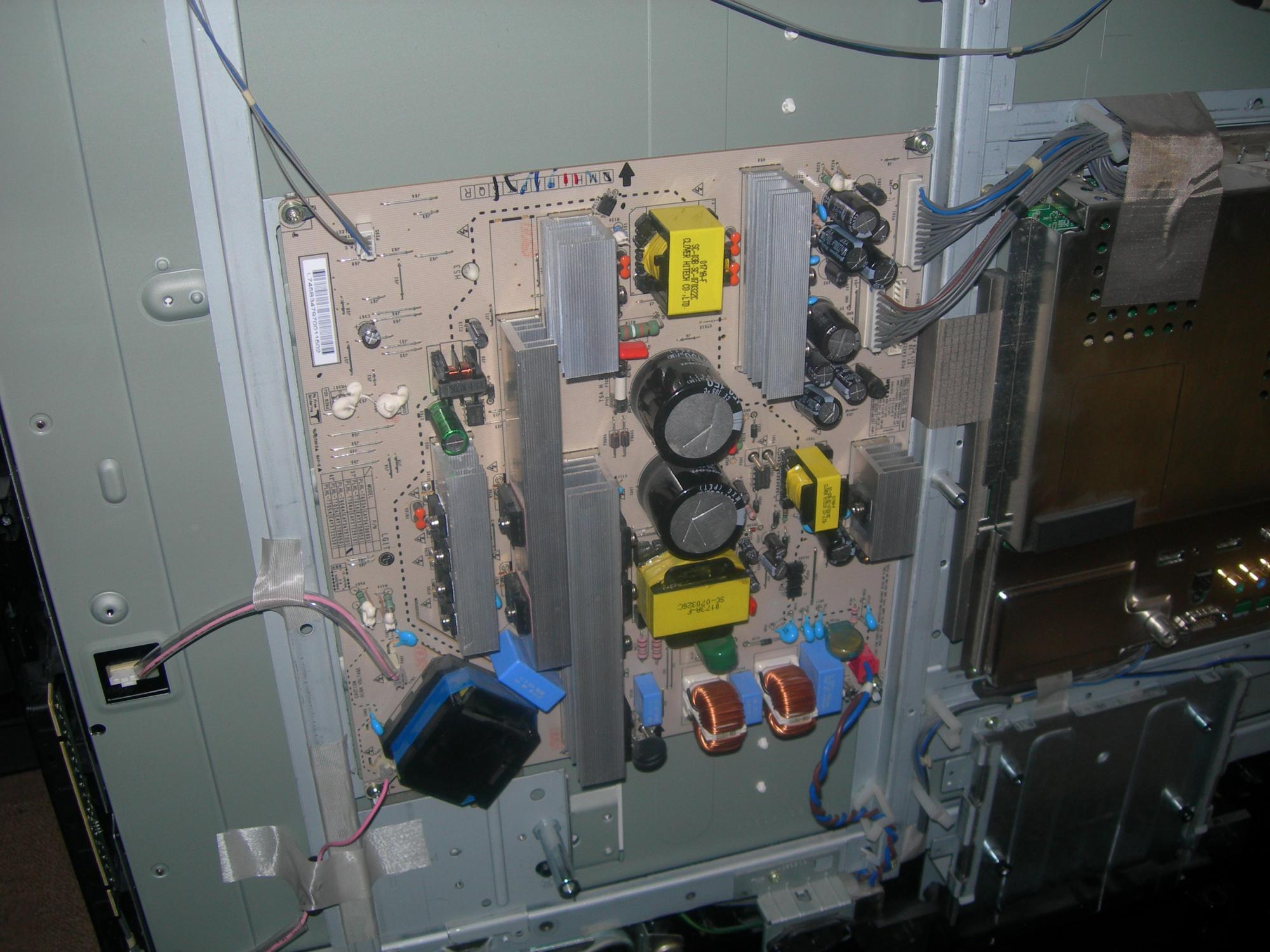

    Picked up a 42" 720p LG 42LC46 from the local dump (household waste center.) Paid £20 for it. Fault description - no power - not even standby power. Four faulty capacitors. Replaced with Rubycon YXF (£5 total), same value, same WV. Works good as new. It's apparently a very common fault with the 42LC46. This saved me almost £400 on upgrading to a new TV from our old CRT. TBH, I can't tell the difference between 720p and 1080p from a 10ft distance.
    I find it ridiculous that this TV only lasted 4 years. Yes, I got it for free - but someone obviously threw it out as they couldn't repair it.
    If anyone else has an LG with no power (not even standby power) check the four 2200u 10V capacitors. They seem to be the culprit. Two for the standby supply and two for the primary supply.

      I also repaired a Samsung 42 " inch LCD TV from the side of the road find
      I found that the cap on the 5 volt power supply rail had pop it top and one other cap had done the same thing
      Replaced the two caps and it works as good as new
