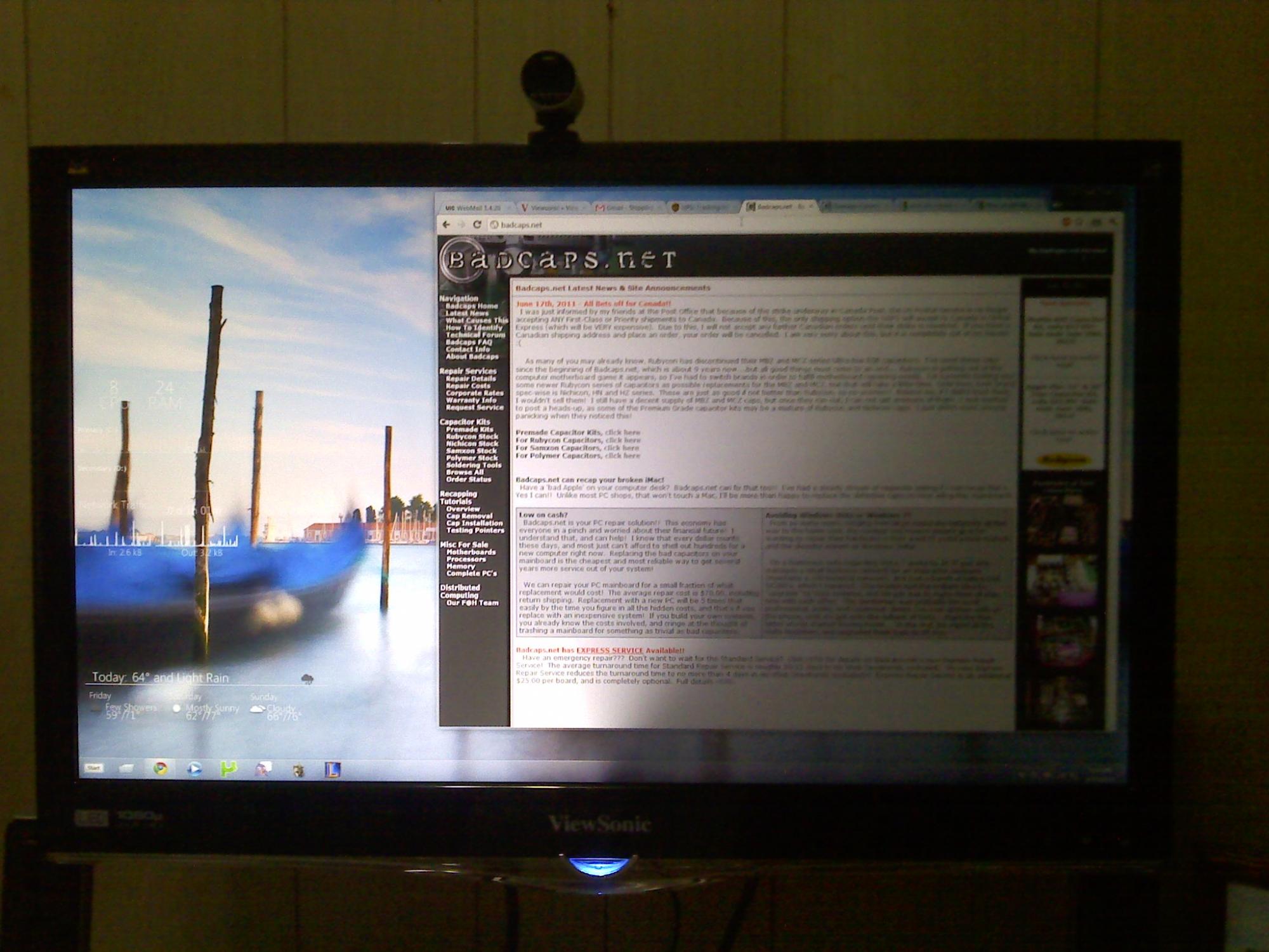

    Hello all, I'm currently attempting to repair an LED-backlit (edge-lit?) screen that appears to have broken LEDS on the right side (right side of screen is dim). If I'm guessing correctly, the panel uses surface-mount type diodes.

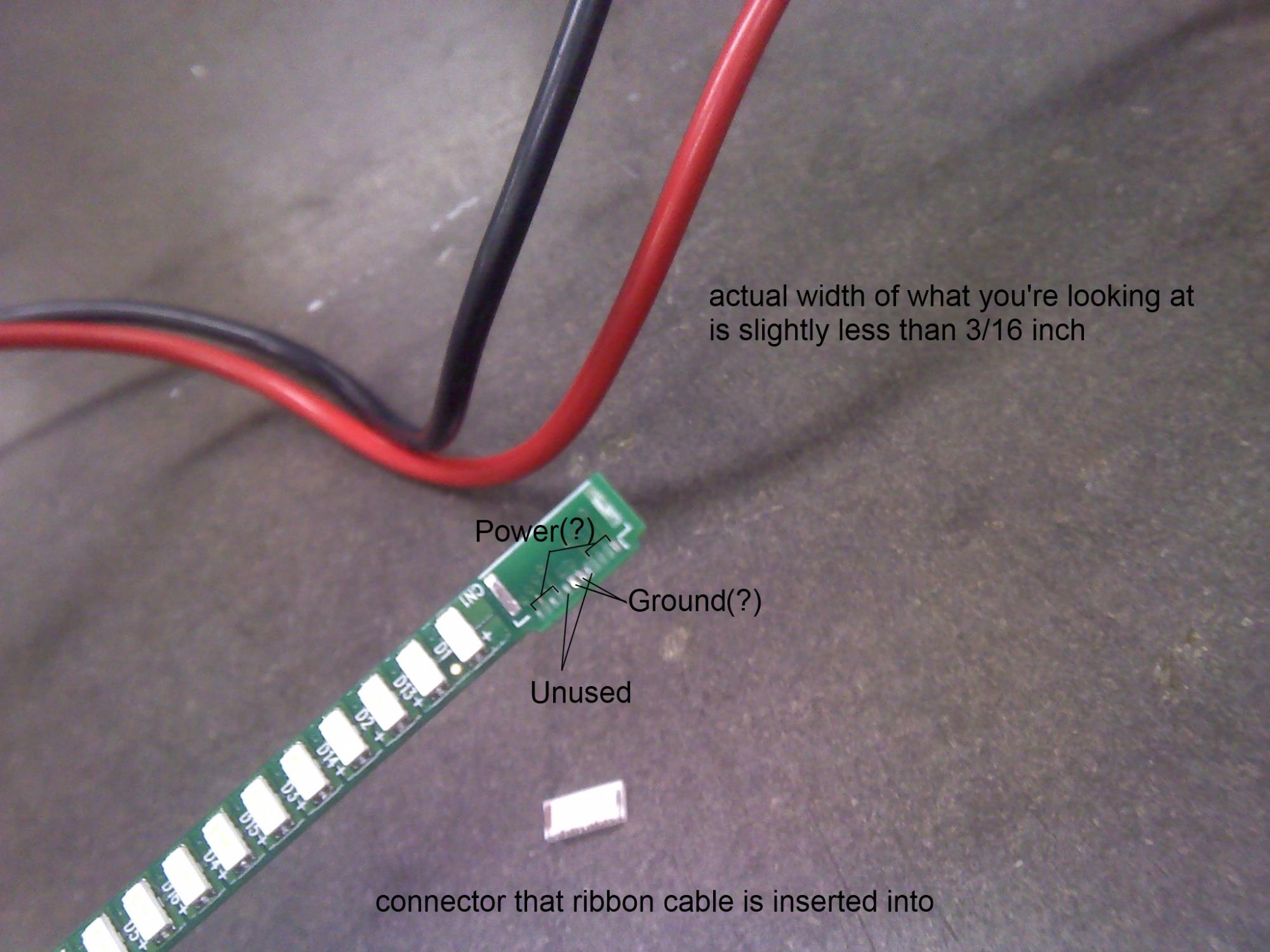

      Well, today was full of surprises. After sweating out the terrifying process of deconstructing the LCD panel, I found that there is actually only one strip of LEDs located at the bottom of the screen. And that one strip has at least 140 diodes or so.
      Before I was able to test the strip, however, I found another problem. It seems that there is bad soldering involved. While attempting to lift a corner of the panel off of the monitor housing, I dropped it and the end of the ribbon cable connecting the LED board with the LED strip detached....along with the "socket" that it's supposed to be inserted into. Although the traces on the LED strip seemed to be in bad shape, I fiddled with the ribbon a bit with the power on (danger is my middle name), touching the two together briefly. Lo and behold, the LEDS on the right side lit up brightly, but then the LEDS on the left side were dimmed.
      Long story short: broken solder/traces could be the real culprit--and given how minuscule the traces and the "socket" component is, fixing the LED strip could involve some more bad soldering... by me.

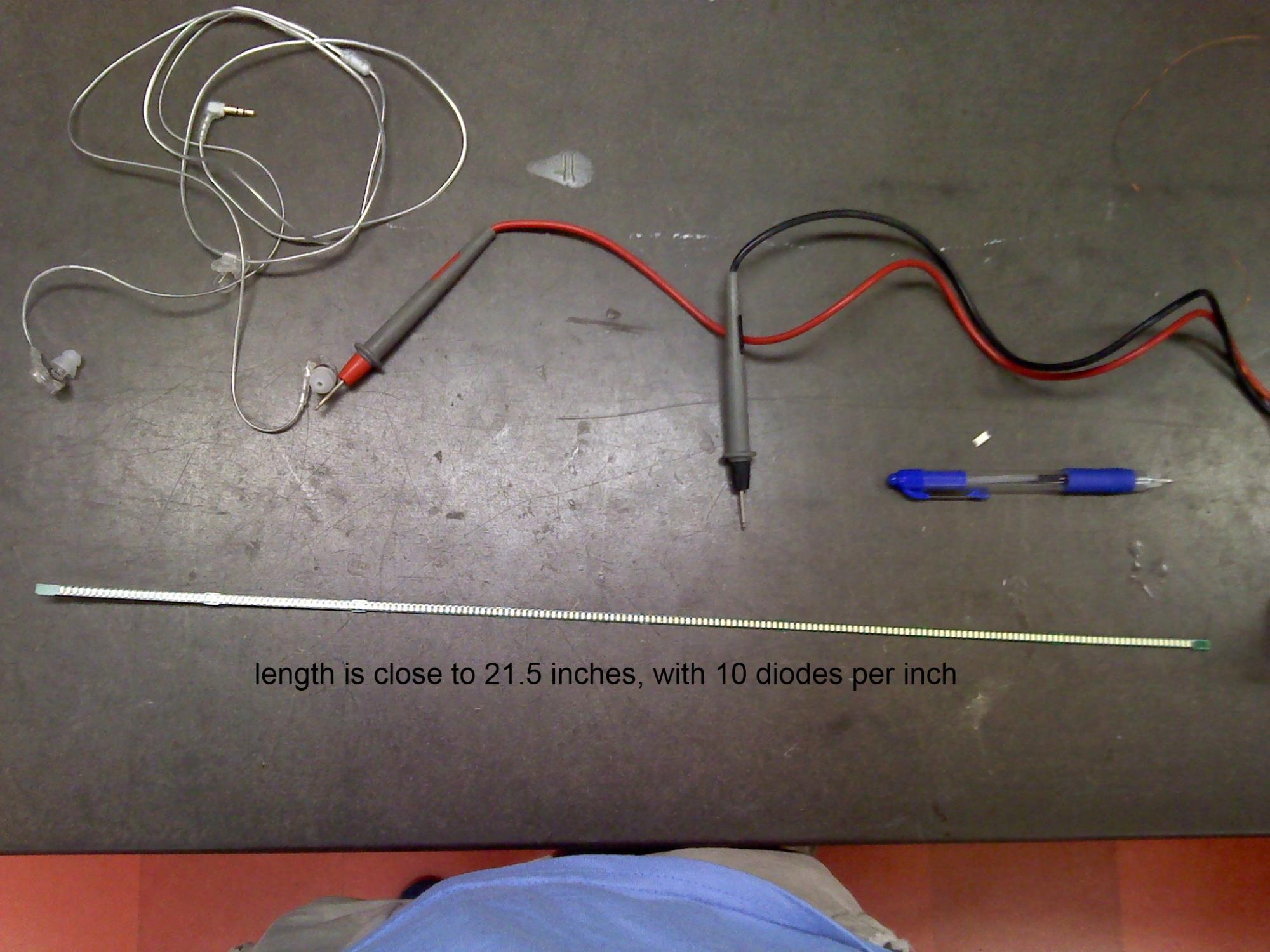

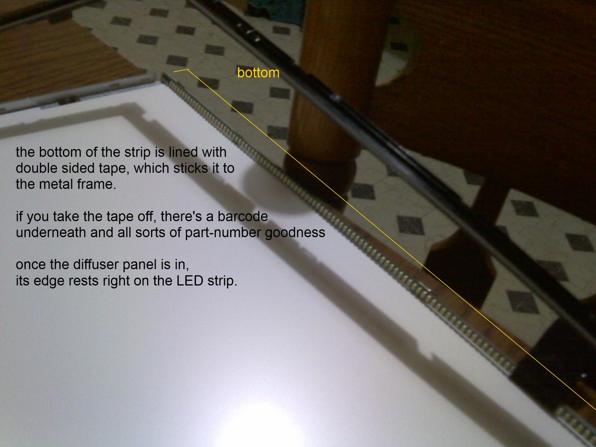

              Alrighty, well I'd edit my first post if I could find the edit button (sorry mods), but this is where I've gotten so far...
              I tested the resistance of each LED, then switched leads to make sure it was open when I did. I finished about 1/4 of them, then got lazy and checked every 10th one or so. They all seem fine.
              So here, we have a close-up of the section of LED strip in question and a normal shot.
              As you can see, the traces/pads are really, really small. If the connection between one of the ground pads and the ribbon cable had been broken somewhere, it would easily explain why only half of the screen had light. But now I've gone and broken all the connections like a boss.
              I agonized over getting that plastic connector back in place and fixing the pads, but ultimately that job requires tools I simply don't have. So, I think I will try a different solution. The plan is:
              1. Use a sharp tool (exacto, or maybe something even smaller?) to expose a bit of the copper at the through-holes.
              2. My student lab has this solder paste that has the consistency of thermal paste, and then becomes a bit like real solder once an iron is applied. By using a needle, I can deposit this paste accurately onto a through-hole without touching the other ones.
              3. Since through-holes go through the PCB (lol.), I can give myself some extra room to work with by doing 5 on one side and 5 on the other, alternating the deposits.
              4. Then, I insert the tip of a section of fine copper wire into the deposit, and secure it to the edge of the PCB with some glue.
              5. Carefully heat each deposit with an iron (I've heard that using dental picks as soldering iron tip is doable)
              Eventually, I should have 10 happy copper wire leads poking off the LED strip. Connecting these leads to the ribbon cable will be trivial, I think. If I could save myself some soldering work by using the liquid from a silver trace pen instead, please let me know. --Or any other advice

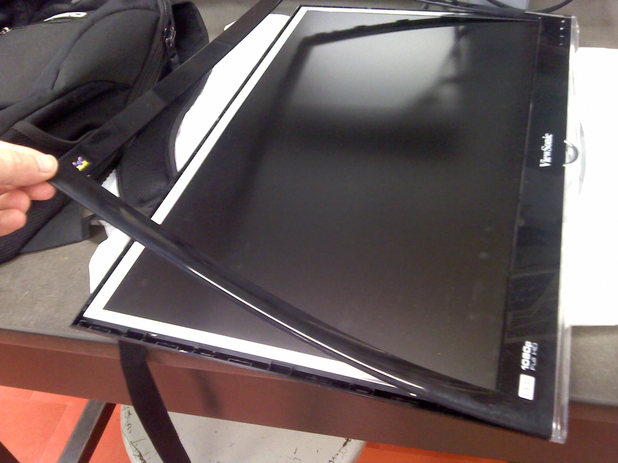

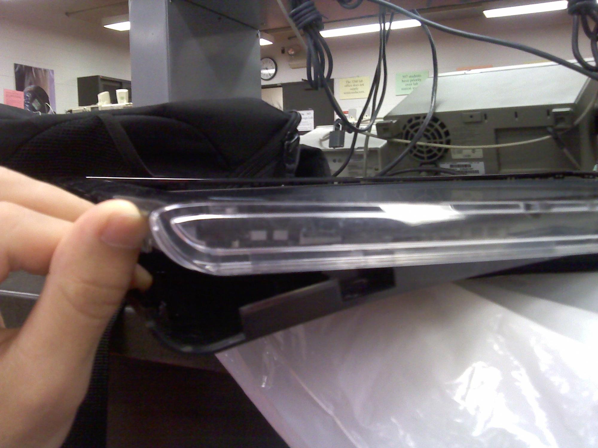

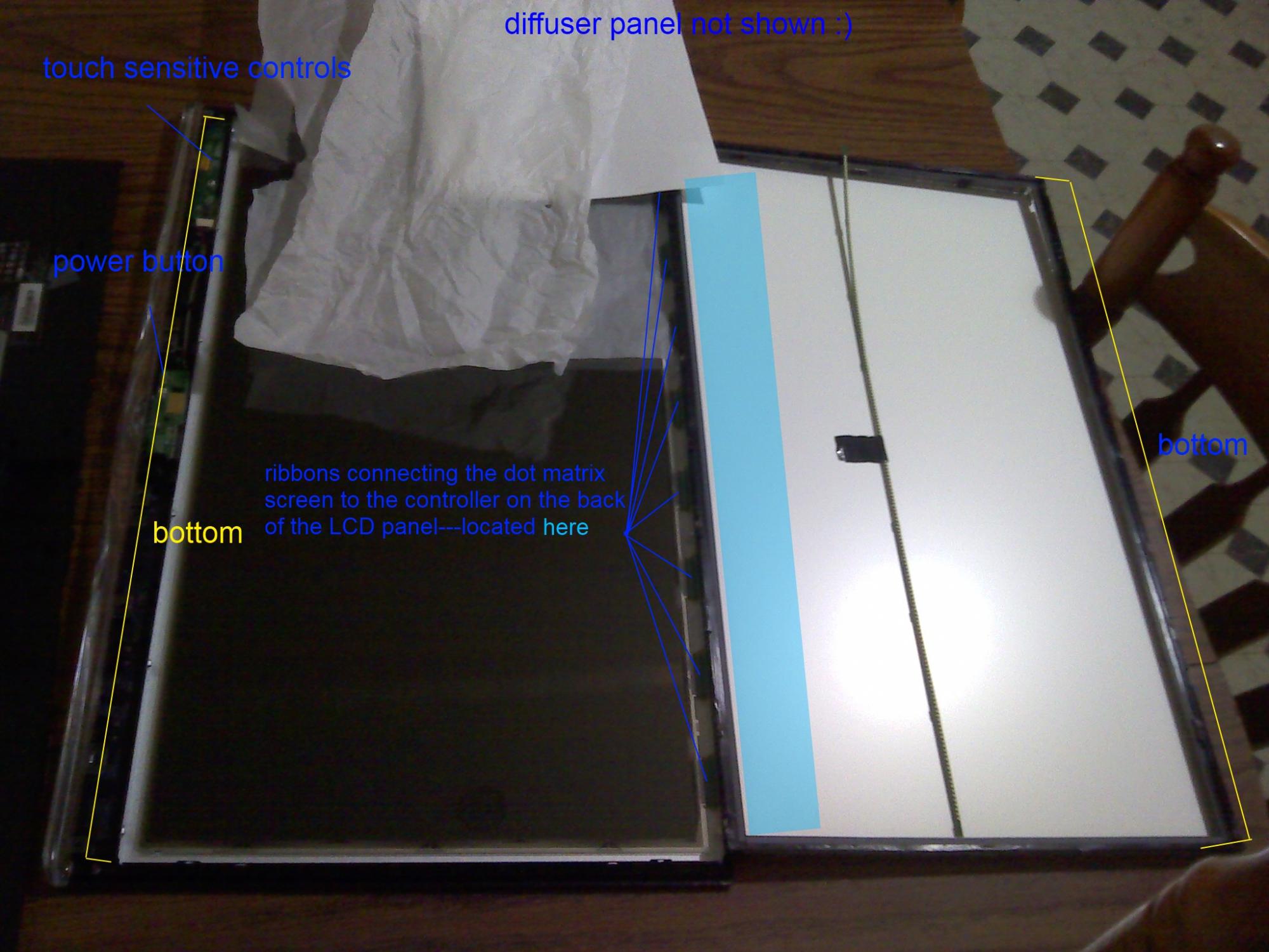

              And here are some pics to make Bill happy:
              Opening the monitor is a little weird. You have to dig your fingertips into the inside edge of the plastic trim, and start lifting carefully. Each hook and clasp should give once it's at the right angle.
              Once the top, right, and left side of the trim are detached, flip the screen over and focus on the back panel at the bottom. It's another hook and clasp deal. The picture doesn't show it, but flipping the screen over is recommended because there are no screws holding motherboard/power section to anything, yet it's attached to the LCD panel and power button (in the clear acrylic thing, which is attached to that front trim). So any lifting of the top trim/LCD panel will probably put stress on the ribbon connection points, or make alarming *thunk* sounds when the motherboard section drops away (happened to me.)
              After disconnecting the ribbon cables connecting the motherboard section to the LCD panel, I took the panel out and got to deconstructing (sorry I don't actually have pictures of that, but it did involve a serrated kitchen knife) Here is the panel unfolded clamshell style, and this is where the LED strip goes.

                First and foremost, thank you for your pictures and explanations. Very informative and I'm sure this will be helpful to many other people who might have problems with their LED-LCD monitors in the future.
                Now onto the questions...
                Eventually, I should have 10 happy copper wire leads poking off the LED strip. Connecting these leads to the ribbon cable will be trivial, I think.)
                Sounds reasonable to me, except for #5 - if you don't have a soldering iron, buy one, even if it's the cheap $2 variety from ebay. Not having the proper tools can sometimes really make a job frustrating and/or take very long to do.

                    If it's just connected as a series string of LEDs you don't need to bother with 10 tiny wires, if I were you I would just replace the ribbon cable with two large wires connected to + and - as appropriate, solder the ends to the right terminals on the boards and add an inline connector for convenient (dis)assembly.
