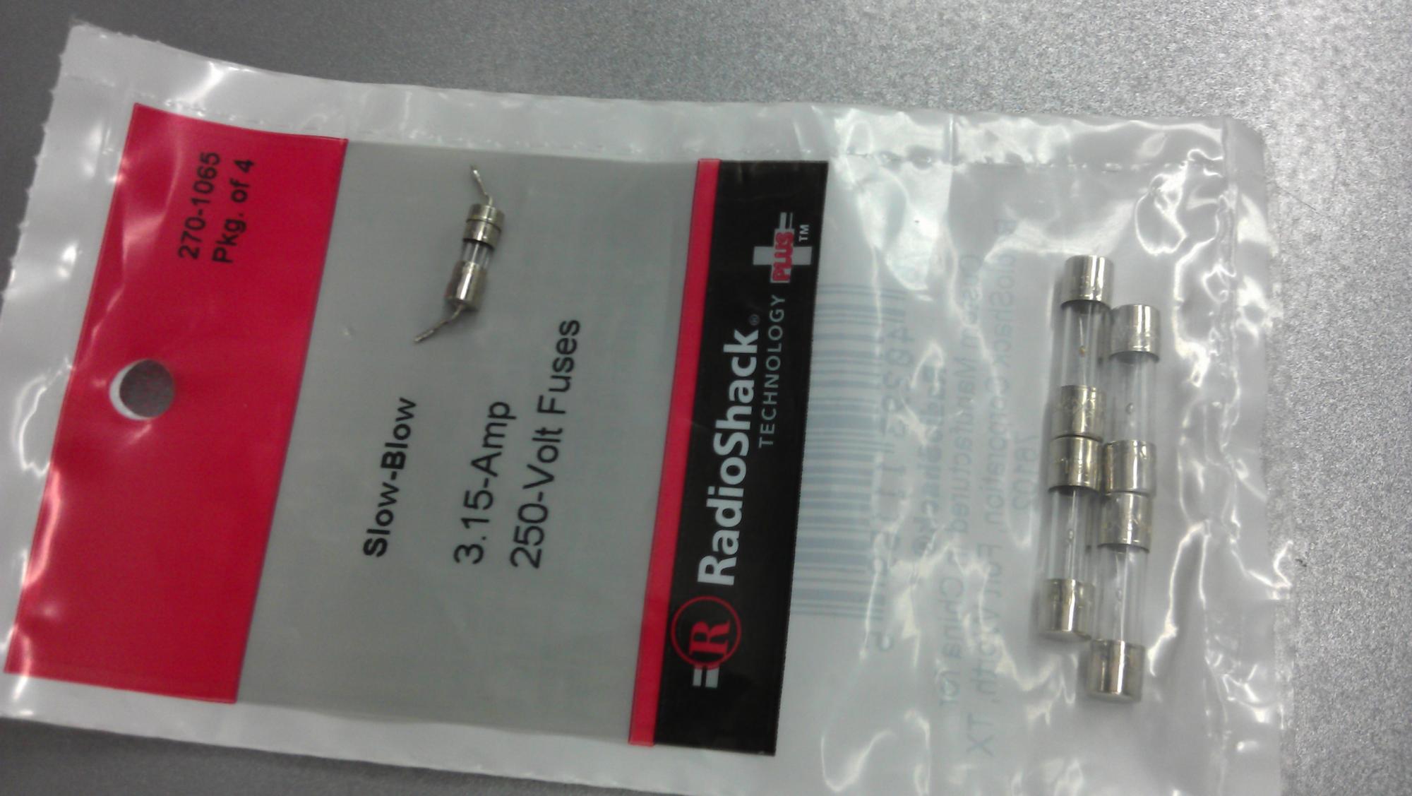

            Glass fuse is PGU manufact. and labeled F3.15A 250V. Radio Shack for replacement? Or should I look somewhere else? Anything special I should be aware of?
              #46
              Re: Troubleshooting Viewsonic vx2235wm
              Radio Shack is coming up short. They have fuses with the amps and voltage. But they don't have a bracket that will work with the board. Recommendations?

                  F3.15A 250v = fast blow, 3.15 amps, 250 volts. I'm sure you can find that at Radio Shack. If you don't have a bracket for it, rip one out of an old something. What you have there on Digikey is a slow blow, which will take some time to open, giving more chance of blown transistors.
                  If you can find a fast blow then you're alright... but unless you have a bigger order to make, just a couple fuses are going to be a waste. Buy from your local shack and get creative about those leads. Hint: You CAN use a soldering iron on a fuse.

                        Managed to find a fast blow fuse with the proper amperage and voltage at Frys. They didn't have a pigtail fuse, so I got a little creative with the soldering iron and some discarded leads from the cap replacement. I've attached a photo of the custom fuse. Installed everything and the monitor fired up like a beauty! Thank you to everyone who contributed to this thread. You were all a great help. And I got a 22" widescreen monitor for $20 in parts. I think I'm hooked!
