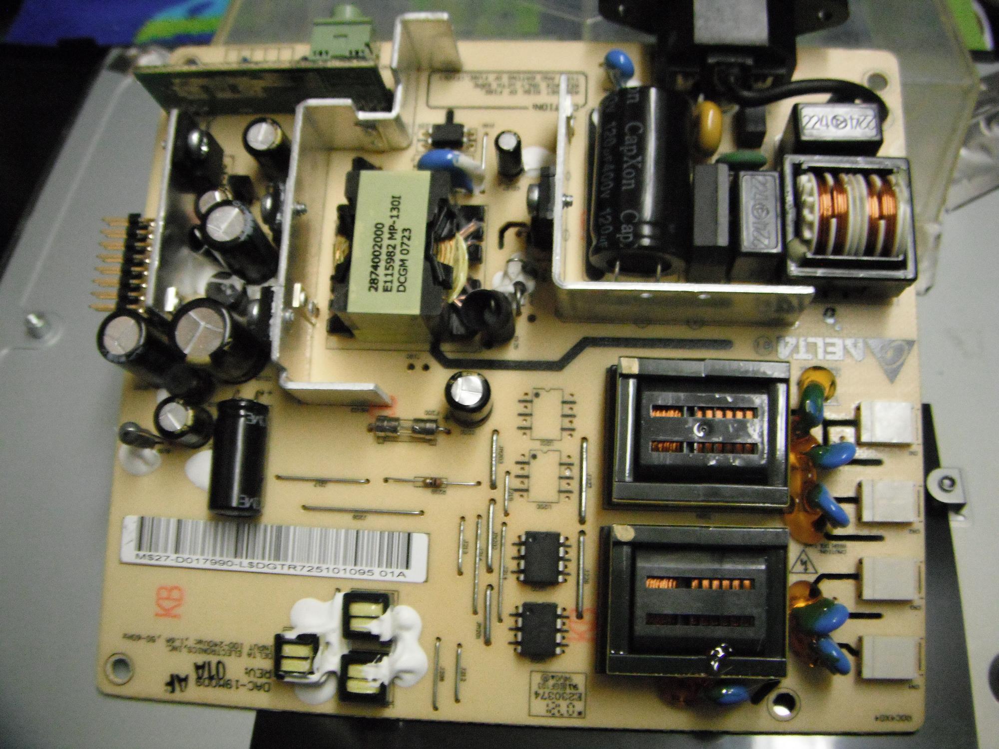

    I'm searching for a fix for a Viewsonic vx2235wm monitor and found this site almost immediately. Over the past weekend, the power at my work went out and my boss' monitor stopped working. I'll give the symptoms that I've noticed and hope to get tips on further troubleshooting or repairs. All my testing was done using the VGA connector, not DVI.
    When you power on the monitor, the blue light flickers for 1-2 seconds and then goes dark. If the monitor is left powered on but NOT connected to the PC video, the message for "No Video Signal" will appear after 10-15 minutes and the power light will come on in the orange power-save mode.
    One time last night I powered the monitor on (same blue light flicker for a couple seconds) and I left the PC Video connected. After about 20-30 minutes the PC video suddenly appeared on the monitor. I used the monitor for several hours with no problems. At one point I powered it off and back on, it came right back up. However, I turned it off for the night and It exhibited the same flickering blue light then dark symptoms in the morning. I haven't had time for further testing yet.
    Any ideas on what the problem is or further tests I should do? If I can get it working, I get to keep the monitor . Thanks.

    Bad caps in the power supply.
    Replace ALL them except for the large filter cap (unless it shows signs of distress) and it'll be fine - but stop using it before you destroy something else.

      Like seanc says above, this sounds like bad caps. As the caps warm up, their ESR (ohms) drops and allows the lcd to come on.

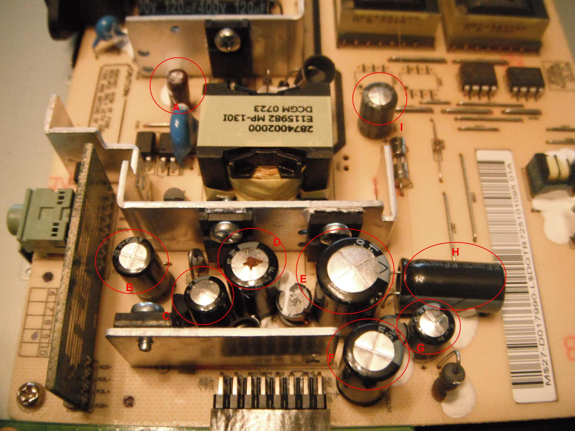

        WEll you guys were right. I managed to get the case open and discovered a leaking cap and several bulging caps (pictured below). They are all CapXon KF series, with the exception of the one I've labeled "A", which appears to be a GL series. Since this is my first time doing a cap replacement, any suggestions on a replacement brand/series for these? Does the series matter? Any help would be appreciated.

          Personally, I prefer Panasonic FM or FC series caps. Other name brands have equally good series. The thread 'Which caps should I buy' in the FAQ will give you information on those.
          If you are in the US, Digi-Key is a good vendor, particularly for a small order like this. A full set of caps will cost about $10.00, including shipping. If you live in another country, another thread in the FAQ might help you - 'Where can I buy Caps?"
          Instructions on selecting caps are in this post. Pay particular attention to dimensions. It's inconvenient if you can't get the cover on because a cap is too high. And do replace all the electrolytic caps (except the 100 uF, 450 volt one). Some of the smaller ones can fail without any external sign.

                  I've been using the Digikey website to build my order, and I've run into a little snag.
                  I need 3x 1000uf 25v caps with max dimensions of 10mm(w) / 20mm(h) but can't find it in the FM or FC series on the Digikey website. Digikey carries Panasonic caps that fit these dimensions in the M, FR, or NHG series. Any problems with going with one of those series for this cap? Recommendations? Thanks again.

                    The Panasonic FR series will work fine.

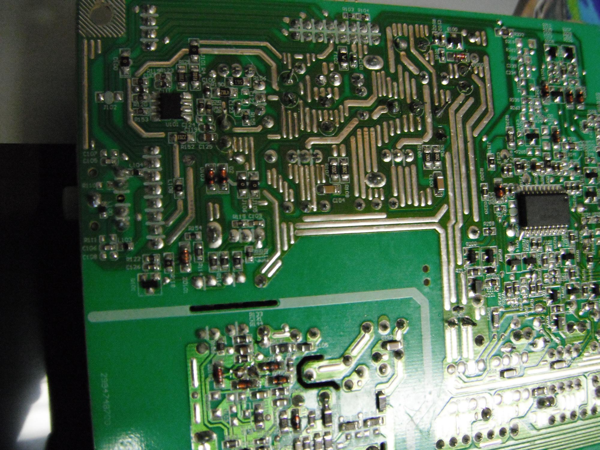

                      Hey guys, still waiting for my replacement caps to come in. But, I was inspecting the back of my circuit board and had a concern. With some of the cap soldering points, it looks like there is only a millimeter, or so, of space to the adjacent circuits on the board. I've never done precision soldering, so I was wondering if there is a good way to protect the adjacent circuits, while soldering the new caps. Any tips would be helpful. Thanks.

                        Looking at the caps you have to replace I don't think it is that bad. Just lean the solder tip away from other components. If you have a solder gun with a huge tip, that might be a problem, but a normal tip should give you plenty of space between components.

                          Kostamojen, in addition to using a fine tip as retiredcaps mentioned, practice your soldering skills on some junk piece of electronics if in doubt.
                          While I've never tried doing it, in theory you could lay down some teflon tape, or any heat resistant material with a little hole that exposes the solder joint, but I suspect it would be more trouble than it's worth. If you have shaky hands, support your wrist with a book or something same height or a little taller than the PCB while soldering.

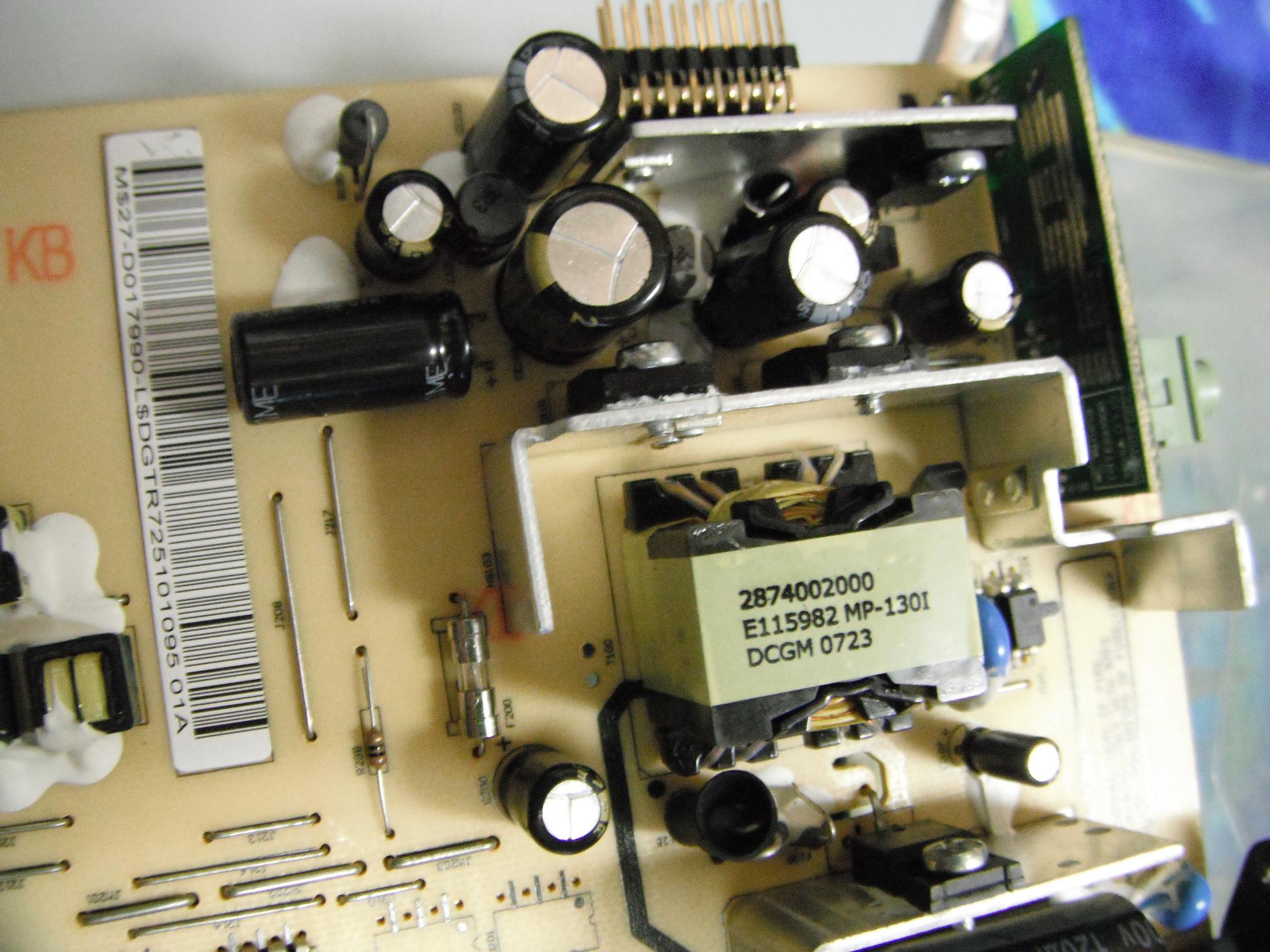

                            Hey guys. Well got my caps in and did the surgery. Think I did a decent job with the soldering, but I'm getting no power-on lights or picture. What should I test next? Thanks.

                              Considering that the monitor at least powered on before but not after the recap, a few things come to mind...
                              First make sure you didn't create a solder bridge over anything. Also check if there are solder blobs shorting something.
                              The second thing that comes to mind - did you plug in all of the connectors properly and securely? Did you check for loose screws and other things that could possible short a nearby circuit.
                              Also, did you place the new caps in the right way, observing the polarity on the board and on the caps?
                              Last but not least, if you have a multimeter, check that the power supply is outputting the proper voltages. They should be labeled on one of the low-voltage connectors.

                                In addition to momaka's comments, it might be helpful if you post some photos of your handiwork. Maybe someone will see something you missed. Post some good focused pics of the top and bottom of your board.

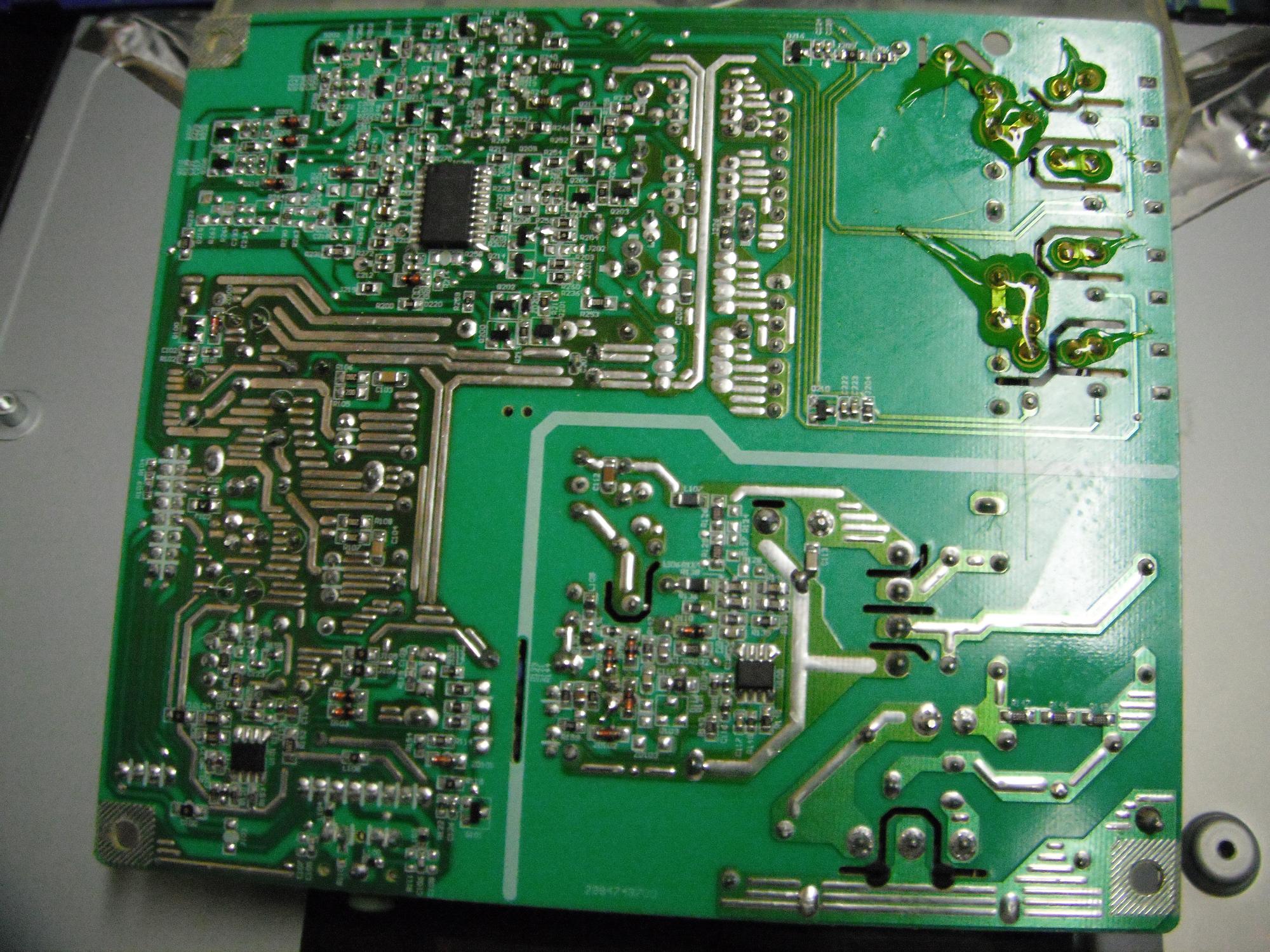

                                    I've uploaded some pictures so you can check my solder work. Let me know if you see anything questionable.

                                      Well actually, before you even test the voltages, first measure resistance between the leads of the caps your soldered and see if you find any short circuits (i.e 3 ohms or less, depending on how good your multimeter is).
                                      If you don't find any shorts then you can test the voltages. But first some safety tips...
                                      See that thick black line on the top of the board where the logo "Delta" is (or alternatively that white line on the bottom of the board)? - that line differentiates between primary and secondary side. On the primary side, high-voltages will be present when the PSU is plugged in so DO NOT touch anything with your hands on that side when the PSU is plugged in. The primary side is the one where that big 400v cap is located.
                                      Also avoid getting your hands near the inverter transformers - that's those near the blue ceramic capacitors and CCFL connectors.
                                      Fortunately, the voltages you will be measuring first are located on the secondary side - i.e. the low voltage side. Whenever measuring voltages on the secondary side, the black probe of your multimeter should always be placed on ground. The screws that tie down the PSU as well as the metal body of the monitor are all ground points you can use. With the red probe, you measure whatever voltage you want to measure.
                                      Now, I would really like to tell you what voltages to measure, but for that I need to know what voltages this PSU outputs. This piece of information can usually be found on the connector that gives power to the video board. In fact, based on the first pic your posted in this thread, you can see that some of the pins on that connector are indeed labeled. Please post what those labels are.
                                      Normally most monitors will have a 5v and a 12v rail (with the 12v rail sometimes given as 13v or 15v, depending on the monitor/PSU). Occasionally, some monitors will have a standby rail too (usually 5v), but I don't think this is the case with this monitor. Therefore, the 5v and/or 12v rail should be present at all times when the monitor is plugged it.

                                        While you're measuring resistances, try measuring the resistance across the main fuse, F101? It's a small square box mounted behind the the main power plug. It should measure under 1 ohm.
