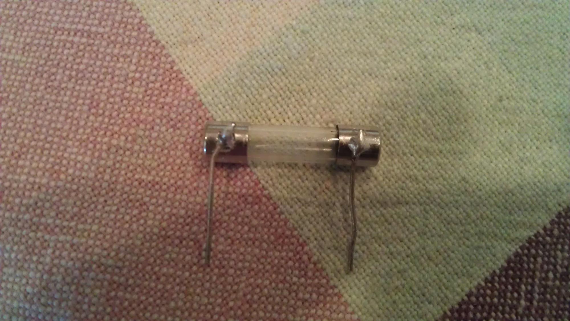

Troubleshooting Viewsonic vx2235wm
  • jetadm123
    replied
    Re: Troubleshooting Viewsonic vx2235wm
    Originally posted by Kostamojen
    Hey guys, the monitor I repaired seems to be showing a new symptom. I'll try to explain as best I can.
    The monitor runs consistantly good while connected via VGA (analog). However, when running on the DVI (digital) connection, the screen occassionally goes black for 2-3 seconds, and then comes back on. Sometimes when it comes back on, there are red pixels across portions of the screen, and the monitor will reset itself again after a few seconds.
    I've only noticed this issue while playing games on the computer, but, it might not be limited to only then. I'd really love to run this monitor off the DVI connection, cause the picture is even better. Any ideas how to resolve this issue?
    Thanks in advance.
    Have you verified that the DVI output of your computer's video card is not the problem? Also, have you checked to make sure it's not the DVI video cable connecting your monitor and computer?
    Leave a comment:
  • Kostamojen
    replied
    Re: Troubleshooting Viewsonic vx2235wm
    Hey guys, the monitor I repaired seems to be showing a new symptom. I'll try to explain as best I can.
    The monitor runs consistantly good while connected via VGA (analog). However, when running on the DVI (digital) connection, the screen occassionally goes black for 2-3 seconds, and then comes back on. Sometimes when it comes back on, there are red pixels across portions of the screen, and the monitor will reset itself again after a few seconds.
    I've only noticed this issue while playing games on the computer, but, it might not be limited to only then. I'd really love to run this monitor off the DVI connection, cause the picture is even better. Any ideas how to resolve this issue?
    Thanks in advance.
    Leave a comment:
  • Th3_uN1Qu3
    replied
    Re: Troubleshooting Viewsonic vx2235wm
    Of course they do. It comes between Iluie (July) 3rd and Iluie (July) 5th.
    PlainBill
    It's Iulie. Nope, we ain't got 4th of July here, only New Year. We did "import" Halloween tho.
    Leave a comment:
  • PlainBill
    replied
    Re: Troubleshooting Viewsonic vx2235wm
    Originally posted by alexanna
    Kostamojen it's fun isn't it!
    Th3 Un1Qu3, Just a little off topic
    But do you guys have a July 4th over there
    Al.
    Of course they do. It comes between Iluie (July) 3rd and Iluie (July) 5th.
    PlainBill
    Leave a comment:
  • alexanna
    replied
    Re: Troubleshooting Viewsonic vx2235wm
    Kostamojen it's fun isn't it!
    Th3 Un1Qu3, Just a little off topic
    But do you guys have a July 4th over there
    Al.
    Leave a comment:
  • Th3_uN1Qu3
    replied
    Re: Troubleshooting Viewsonic vx2235wm
    Good job. Enjoy your new monitor. And please post your location in your profile, so it's easier for us to suggest a part supplier when you next need it.
    Leave a comment:
  • PlainBill
    replied
    Re: Troubleshooting Viewsonic vx2235wm
    Originally posted by Kostamojen
    Managed to find a fast blow fuse with the proper amperage and voltage at Frys. They didn't have a pigtail fuse, so I got a little creative with the soldering iron and some discarded leads from the cap replacement. I've attached a photo of the custom fuse. Installed everything and the monitor fired up like a beauty! Thank you to everyone who contributed to this thread. You were all a great help. And I got a 22" widescreen monitor for $20 in parts. I think I'm hooked!
    Well done. And your's is a common reaction. Whether it's fixing your own, or one someone else discarded, it's a good feeling.
    PlainBill
    Leave a comment:
  • Kostamojen
    replied
    Re: Troubleshooting Viewsonic vx2235wm
    Managed to find a fast blow fuse with the proper amperage and voltage at Frys. They didn't have a pigtail fuse, so I got a little creative with the soldering iron and some discarded leads from the cap replacement. I've attached a photo of the custom fuse. Installed everything and the monitor fired up like a beauty! Thank you to everyone who contributed to this thread. You were all a great help. And I got a 22" widescreen monitor for $20 in parts. I think I'm hooked!
    Leave a comment:
  • jetadm123
    replied
    Re: Troubleshooting Viewsonic vx2235wm
    3.15 A fuses are used quite often in computer power supplies. If you have an old power supply lying around, perhaps you could "liberate" the fuse from it.
    As for a fuse holder for the fuse you already have, maybe you could use the Radio Shack one below:
    http://www.radioshack.com/product/in...ductId=2062257
    You could try glueing it down with silicon adhesive. Just make sure it's metal tabs don't come in contact with other components.
    Leave a comment:
    replied
    Re: Troubleshooting Viewsonic vx2235wm
    Buy from your local shack and get creative about those leads. Hint: You CAN use a soldering iron on a fuse.
    +1
    Or you can make your own fuse holder out of paper clips. No, I'm not kidding!
    Leave a comment:
  • Th3_uN1Qu3
    replied
    Re: Troubleshooting Viewsonic vx2235wm
    F3.15A 250v = fast blow, 3.15 amps, 250 volts. I'm sure you can find that at Radio Shack. If you don't have a bracket for it, rip one out of an old something. What you have there on Digikey is a slow blow, which will take some time to open, giving more chance of blown transistors.
    If you can find a fast blow then you're alright... but unless you have a bigger order to make, just a couple fuses are going to be a waste. Buy from your local shack and get creative about those leads. Hint: You CAN use a soldering iron on a fuse.
    Leave a comment:
  • Kostamojen
    replied
    Re: Troubleshooting Viewsonic vx2235wm
    Time for a little education on fuses:
    Found a fuse on Digikey that might work. http://search.digikey.com/scripts/Dk...&name=F3298-ND
    Looks like the same amp and voltage rating. Can't tell if its glass or if that even matters. Can anyone tell me if that fuse is viable for this application?
    Thanks again.
    Leave a comment:
  • Kostamojen
    replied
    Re: Troubleshooting Viewsonic vx2235wm
    Radio Shack is coming up short. They have fuses with the amps and voltage. But they don't have a bracket that will work with the board. Recommendations?
    Last edited by Kostamojen; 07-01-2011, 02:57 PM.
    Leave a comment:
  • Kostamojen
    replied
    Re: Troubleshooting Viewsonic vx2235wm
    Glass fuse is PGU manufact. and labeled F3.15A 250V. Radio Shack for replacement? Or should I look somewhere else? Anything special I should be aware of?
    Leave a comment:
  • Th3_uN1Qu3
    replied
    Re: Troubleshooting Viewsonic vx2235wm
    Nothing else for now.
    Leave a comment:
  • Kostamojen
    replied
    Re: Troubleshooting Viewsonic vx2235wm
    ICs look good. No measurements under 20 ohms. Anything else I should do before trying to find a replacement for the glass fuse?
    Leave a comment:
  • PlainBill
    replied
    Re: Troubleshooting Viewsonic vx2235wm
    Originally posted by Kostamojen
    Hey Bill, got those directions on checking the inverter drivers? Much appreciated.
    OK, here we go. These tests will be done with power off.
    The inverter drivers are two 8 pin ICs next to the inverter transformers. There is space for two more next to them. The two empty spots appear to be U200 and U201. I THINK the drivers are U202 and U203.
    If you look at the drivers you will notice a dimple next to one pin. That is pin 1. The other pins along that side are 2, 3, and 4. Pins 5-8 are on the other side. Pin 5 is opposite pin 4, pin 6 opposite pin 3, etc.
    1. Set your VOM to the X10 range and adjust the zero with the leads shorted.
    2. Put the black lead on pin 1 of the first IC. Measure the resistance to pin 2, pin 3, pin 4, and pin 5. Note any reading that is below 10 ohms.
    3. Put the black lead on pin 2 of the first IC. Measure the resistance to pin 3, pin 4, and pin 5. Note any reading that is below 10 ohms.
    4. Put the black lead on pin 3 of the first IC. Measure the resistance to pin 4, and pin 5. Note any reading that is below 10 ohm
    5. Put the black lead on pin 4 of the first IC. Measure the resistance to pin 5. Note any reading that is below 10 ohm
    Now repeat these steps for the other IC.
    PlainBill
    Leave a comment:
  • Kostamojen
    replied
    Re: Troubleshooting Viewsonic vx2235wm
    It's a pigtail fuse, I'm guessing somewhere in the 2A - 4A range. You may be able to read teh current rating on the end caps. Some monitors us a picofuse in this application, others use a surface mount fuse. A fuse and fuseholder from Radio Shack would even work.
    Before replacing the fuses, check the inverter drivers to make sure they aren't shorted. If nobody jumps in with directions, I'll do it tomorrow. I can't keep my eyes open.
    PlainBill
    Hey Bill, got those directions on checking the inverter drivers? Much appreciated.
    Leave a comment:
  • PlainBill
    replied
    Re: Troubleshooting Viewsonic vx2235wm
    Originally posted by Kostamojen
    PlainBill, your help has been invaluable! Thanks so much! But, I'm still looking for a solution to this fuse. Do you have to de-solder to remove the old one? and any suggestions for finding a replacement?
    It's a pigtail fuse, I'm guessing somewhere in the 2A - 4A range. You may be able to read teh current rating on the end caps. Some monitors us a picofuse in this application, others use a surface mount fuse. A fuse and fuseholder from Radio Shack would even work.
    Before replacing the fuses, check the inverter drivers to make sure they aren't shorted. If nobody jumps in with directions, I'll do it tomorrow. I can't keep my eyes open.
    PlainBill
    Leave a comment:
  • Kostamojen
    replied
    Re: Troubleshooting Viewsonic vx2235wm
    Th3_uN1Qu3, alexanna, Kostamojen, you guys ROCK!!! I go out running a few errands, got a fender dented in a parking lot, and came back home to find the problem has (mostly) been solved.
    Kostamojen, good work!!
    PlainBill
    PlainBill, your help has been invaluable! Thanks so much! But, I'm still looking for a solution to this fuse. Do you have to de-solder to remove the old one? and any suggestions for finding a replacement?
    Leave a comment:
    by momaka
    03-15-2023, 10:17 PM
  • wattage
    AOC AG493UCX 49-inch monitor - Firmware request
    by wattage
    Hello Badcaps Community,
    I purchased a preowned AOC monitor that is not working and out of warranty. It was sold as not working. I am looking for guidance on self-repair. In particular, I am after the firmware for the monitor. At the end, I have included monitor model information and links to pics and vids of the issue.
    The problem is that it will not display a picture on any of its inputs. And the on-screen menu does not appear. The power button works properly. It powers on with the remote as well. But the on-screen menu does not appear, even when not connected to any...
    07-13-2025, 04:41 PM
  • Rick_1234
    LG 23MP55HQ LED Monitor turns off after a few seconds or flickers.
    by Rick_1234
    Good evening, gentlemen.
    I have a problem with my monitor. It turns off after a few seconds or flickers. Shining a flashlight on the screen doesn't show any image, so I guess it's not the "2 seconds to dark" I read in the forum.
    To turn it back on, I have to press the power button twice. Then after a few seconds it turns off again or flickers. See video.
    https://drive.google.com/file/d/1L6S...ew?usp=sharing
    Things I tried
    - Bought a new AC adapter thinking that was the problem but the problem...
    06-22-2024, 04:44 PM
    Wise Wing F199 19'' LCD monitor - recapped
    by momaka
    Looking through my repair pictures and notes, it's been a long time since I posted anything in the LCD monitors section. So here goes that.
    I'm dedicating this thread to one of the very first LCD monitors I repaired (if not the first one), which was more than 10 years ago now. The monitor is a Wise Wing, model F199. It's a 19” CFL-backlit LCD. I got it for free off of Craigslist in 2009 from a guy, who said he bought it for cheap from Wallmart and the monitor worked only for a little less than 2 years before quitting.
    When I saw the Craigslist post, I wasn't...
    08-24-2020, 10:58 AM
  • sew333
    Pc shutdown, monitor flickered with no signal after 10 seconds
    by sew333
    My pc:
    10850K stock 4800mhz stock Kraken X73 good temps
    2x16 GB DDR4 GSKILL 3000mhz XMP
    Seasonic Tx-850 Ultra Titanium
    Gigabyte Rtx 3090 Gaming OC
    Aorus Z490 Pro Gaming
    1 TB SSD
    4 weeks ago i launched Metro Exodus Enhanced and during cinematic advertisement part ( 30 fps ), pc just shutdown.
    Also monitor flickered with NO SIGNAL 10 seconds after shutdown. So only monitor and pc was affected.
    Next i pressed only power button, rebooted again and its fine again. Happened once and i cant reproduce.
    Power...
    02-22-2022, 10:27 AM
