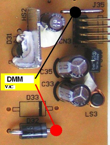

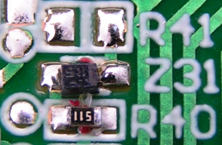

      Originally posted by Rtech View Post
      Youa re correct.Although the 'Banded' end is negative,,the diode is rectifying the Voltage coming in through the +ve end, so you are right.Lets also add something else.You will notice that after the Voltage goes through the fuse IF and WHEN it is refitted,it goes onto the pins and then up under a resistor RJ32,turns right,and goes to other components.You will notice one of these, which I have marked on the attached...it is marked Z31 but just looks like a Black blob, no matter how I magnify it,,is there a component there, or does it look as though one has burnt out ???????//

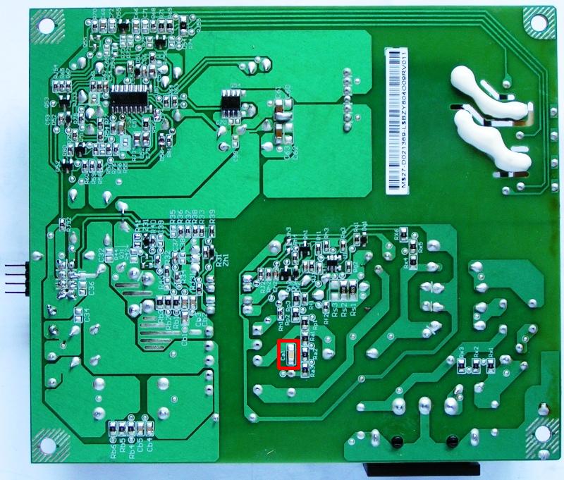

      Sheeeessshhhhh! Do I need a magnifier or what? Had a looksie at component Z31 in close up, and depending on which angle the light hits it, it is possible that it has cracked solder on one side?
      See what you think.
      Blast and damn it I have to go out, Family calling - back onto this asap - prob, tomorrow.
      Cheers for now.
      Imalearner
        #43
        Re: Viewsonic VA1616W Non Starter, No Lights, Suggestions Please!
        Cannot tell..Please tomorrow measure the voltage on the Diode as requested,THIS is more important than anything else!!,and if it is 5V, then ensure it is on both side of L53.If it is then replace the fuse.and see if it drops off....if so then we are looking to test U31, and also need to decide what if anything you need to do about Z31.
          G'morning all!
          Picture reposted as I noticed I had labelled the other one incorrectly.
          Measured 3.5V at start, climbing to 8.9V over 90 Seconds?
          Befuddled I sit still, in awe, of everything I know- I don't know
          Imalearner

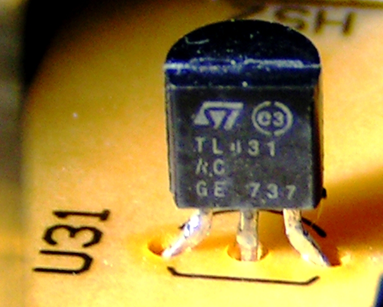

            Why did you label it incorrectly ??the voltage you have advised is DC ?? Yes?? as requested.Presume you checked it through L53 as requested, and have put the fuse back as requested,and the voltage returns to approx 2.5 volts DC ??
            If you have ,then part code of U31,the three pin transistor,will help.Also if all the above happens,then with the unit switched off,and with U31 still connected, label the pins 1,2 and 3,in any order you wish,and with the meter switched to resistance measurement put Black on 1 and measure 1-2,1-3 and 2-3,,,then reverse the leads and do the same again.Any reading 30 ohms or less will indicate a problem.

                Just complete as I asked, the voltage will be higher, there is NO current being drawn is the reason, just do as I asked, as I am spending a lot of time with this, AND missing my Test Match Cricket !!

                      Part code for U31 is in the photograph - best if I leave you to decipher.
                      Test on U31, followed as described, with meter set on lowest setting (200ohms) all contacts displayed 1 on my digital meter. I checked, double checked and checked again many times.
                      So, next........I suppose I should I be replacing the U31?

                                  As you have noted, a likely suspect is the circuitry around U31. This is most likely a TL431 or equivalent. Usually a voltage divider is used to program the voltage. In this case, the most likely culprit is the pull down resistor of the voltage divider.
                                  The pins of the reference are numbered in the attached picture. Pin 1 is the reference input of a TL431, the resistors toward the top of the yellow rectangle are the most likely suspects. A closer picture would be helpful.

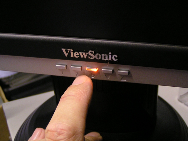

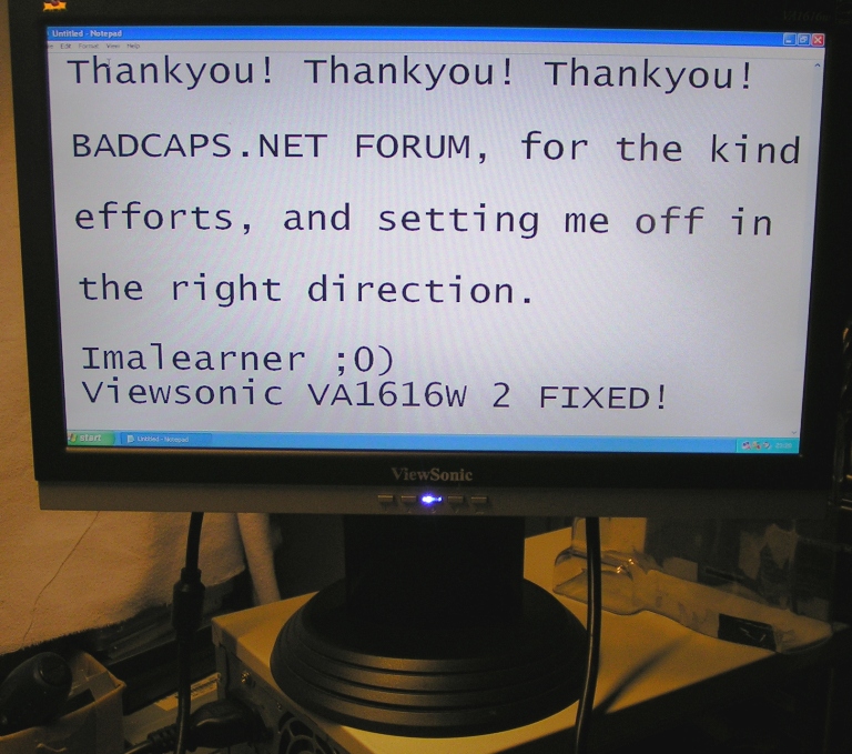

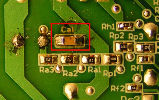

                                    Sorry PlainBill - I have just logged on to tell you guys great news....it's fixed!:Cheers everyone! As I write it's on my 'test' bench, and my fingers are crossed.
                                    After the heady exercise of digesting some of the info in this thread I resigned myself to the fact that the job was becoming beyond my few skills just yet. So I put a call in to an old friend who lives a few miles from me. Told him everything we have tried here. His speciality is Sony playstation and wii, with a few hundred TV's and videos for good measure. Thankyou Raf Sabir in Cardiff.
                                    Anyways, he went through everything checking my handiwork - thankfully it passed, and was as perplexed as us lot here - especially me.
                                    Then he scoped the board.....voila! Ceramic Capacitor Ca1 was cracked. So, off it came and he replaced it with summat off a playstation.
                                    So I thought I must tell you guys, it all helps our education. Thankyou for your help, I'm sure to be back, but I'll read a bit more and practice my soldering too.
                                    Photographs to help anyone else with similar experience.
                                    Cheers all.
                                    Imalearner
