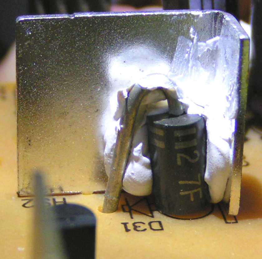

    Thats fine,is that both diodes or just the one,fitted and then removed ??

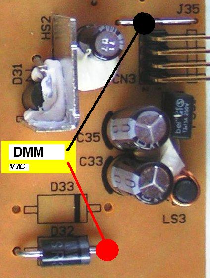

      Both look ok then.Next with the black lead on that link J35, measure the Dc volts on J32,J33 and FS51.

        D31 is reading 404 in circuit (the one with the gum squashed around it) and it is the one that I have not yet removed.
        So, should I remove it, just to be sure, and test again?
          When I get to do this, should I return (or resolder ) D32 ( and D31 if I have to remove that) back to the board. I mean, should I solder one leg back on, and if so which one, or both?
          Also, just curious, the reading that I have got - how do you know what's a 'good' or 'bad' reading on diodes please?

            Diodes in these positions are used to rectify voltage,and simply that means changing an AC voltage to DC.by putting the black lead on the banded end of the diode(which is the negative end), and the red lead on the positive end the diode then allows voltage from the meter to go through the diode but the reading you get is the voltage drop acorss the diode.Reversing the diode must not allow any voltage through,which is why your meter shows a '1'.
            So your diodes look fine, return to their original positios, and measure the voltages as requested in post #22.

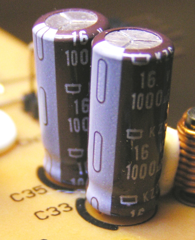

                  "also the two caps near those should be checked and changed to see if they are the cause."
                  Should I be doing the same check on these as in post 4, as in, power the board - black lead to striped side of cap, red to the other - meter set to Volts AC?

                      Following instructions here (I'm flying blind ) with the black lead on that link J35, I have measured the DC volts on
                      J32 = No Reading
                      J33 = No reading
                      FS51 = 14.40V to 16.00V
                      On FS51 the lower reading is only when first powered on, say about 20 seconds, then it peaks at just below or at 16V
                      Hope this helps?
                      Imalearner
                        #31
                        Re: Viewsonic VA1616W Non Starter, No Lights, Suggestions Please!
                        Thats fine, and shows that it looks as though the inverter side of the unit is fine,and the problem is with the 5volt part of the circuit.The first thing you need to do is replace both C33 and C35,also ensure that L33, has a good solder joint,also do you know if D31 ans D32 have the same part numbers on them ????

                          As for the D31, it looks to me like it is different from the D32, as the photograph shows a little information, not obscured by the 'gum' (what's that for?) as 2 7F.

                            Forget 6.3 volts and get 10v,that is not resistance but "DC working voltage" make sure that they are 1000uF(microfarads),when you put them in, ensure they are the correct way around,also resolder that fuse,as the joints do not look good.I was curious ref the diode part codes,but suspect the new caps may well cure the problem

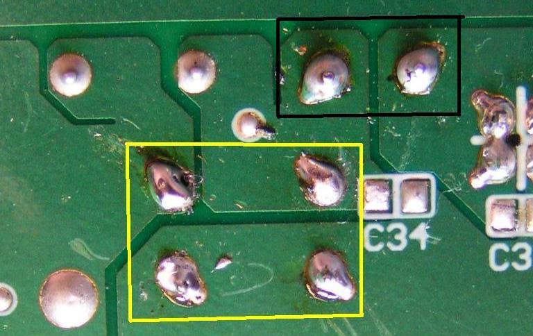

                              Okay, so my local stockist is 6 miles away, and transport is an issue for me right now and although I could order online for possible delivery for Tuesday next week, I might be mistaken but I have done this instead. ( I am also eager to learn and try)
                              I have 'found' two 16V 1000uF capacitors off a known-working pc motherboard. Anyways, I stripped them off and have tried them on this project. They seemed to come off easy enough and went back on okay too.
                              I have resoldered fuse (in black box on photograph)- although it's not pretty - I think all my soldering is sufficient on caps too (yellow box).
                              I checked DC power again on following.
                              J33 = No reading
                              J32 = No reading
                              FS51 = 18.7 Volts initially but decreasing to stable 15.2Volts over say 90 seconds. So that reading appears to have changed from before.
                              No change to any readings from the pins though.
                              Hmmmmmmmmmmmmm? Should I have been more patient and ordered new caps? Or is it my soldering? Doubts fill the mind Is it like this for everyone?

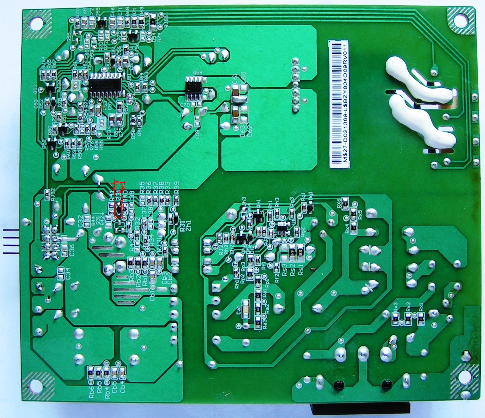

                                NOW, this is getting personal. A photograph of the label on the back of the monitor would be useful. There seem to be several different models of VA1616W.

                                        I have removed fused, (not shown in photograph) but because I am wary of screwing it up, please clarify, should I be putting the red probe on D32 ON the banded end? I thought that this was a 'negative' terminal, as it has the strip on it, or doesn't it matter which end I put it on?
                                        So is my photograph for this test correct, or even relevant, please? I have removed fuse.

                                          Youa re correct.Although the 'Banded' end is negative,,the diode is rectifying the Voltage coming in through the +ve end, so you are right.Lets also add something else.You will notice that after the Voltage goes through the fuse IF and WHEN it is refitted,it goes onto the pins and then up under a resistor RJ32,turns right,and goes to other components.You will notice one of these, which I have marked on the attached...it is marked Z31 but just looks like a Black blob, no matter how I magnify it,,is there a component there, or does it look as though one has burnt out ???????//
