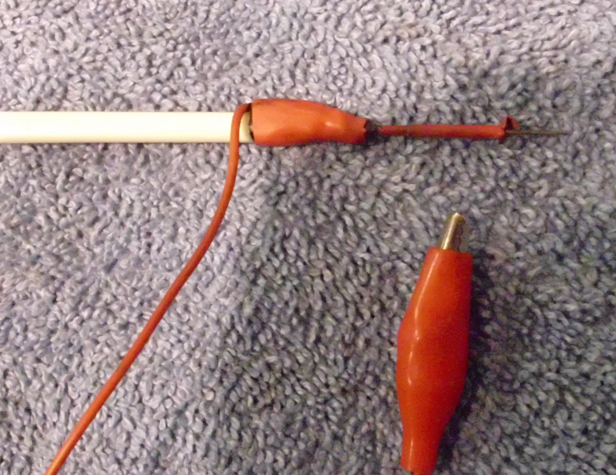

      Good job of troubleshooting so far; excellent job of describing the problem.
      Arcing from high voltage lead of CCFL to the LCD frame. It's probably happening at an end cap, or where the high voltage lead touches the LCD panel. I'd make a 'sniffer' probe using a jumper wire and a plastic handled screwdriver. One end of jumper to the frame of the monitor, the other end to the shaft of the screwdriver. By running the blade of the screwdriver along the wire you may be able to locate the bad spot.
      You could even use a finger tip as a probe. Theoretically the current isn't high enough to stop your heart.

          Here is a tool I made; it’s nothing more than a single chopstick with a sewing needle epoxy to the plastic with a grounding wire soldered to the needle.
          Works great for small pin testing, and you could probably use it as a sniffer

            I think what PlainBill is suggesting is this:
            Take a test lead with a alligator clip at both ends. Clip one end to the shaft of the screwdriver and the other end to the metal frame of the LCD panel. With the CCFL's on, run the tip of the screwdriver along the CCFL wires and endcaps. Once the CCFLs go off, then you've found the source of the short.
