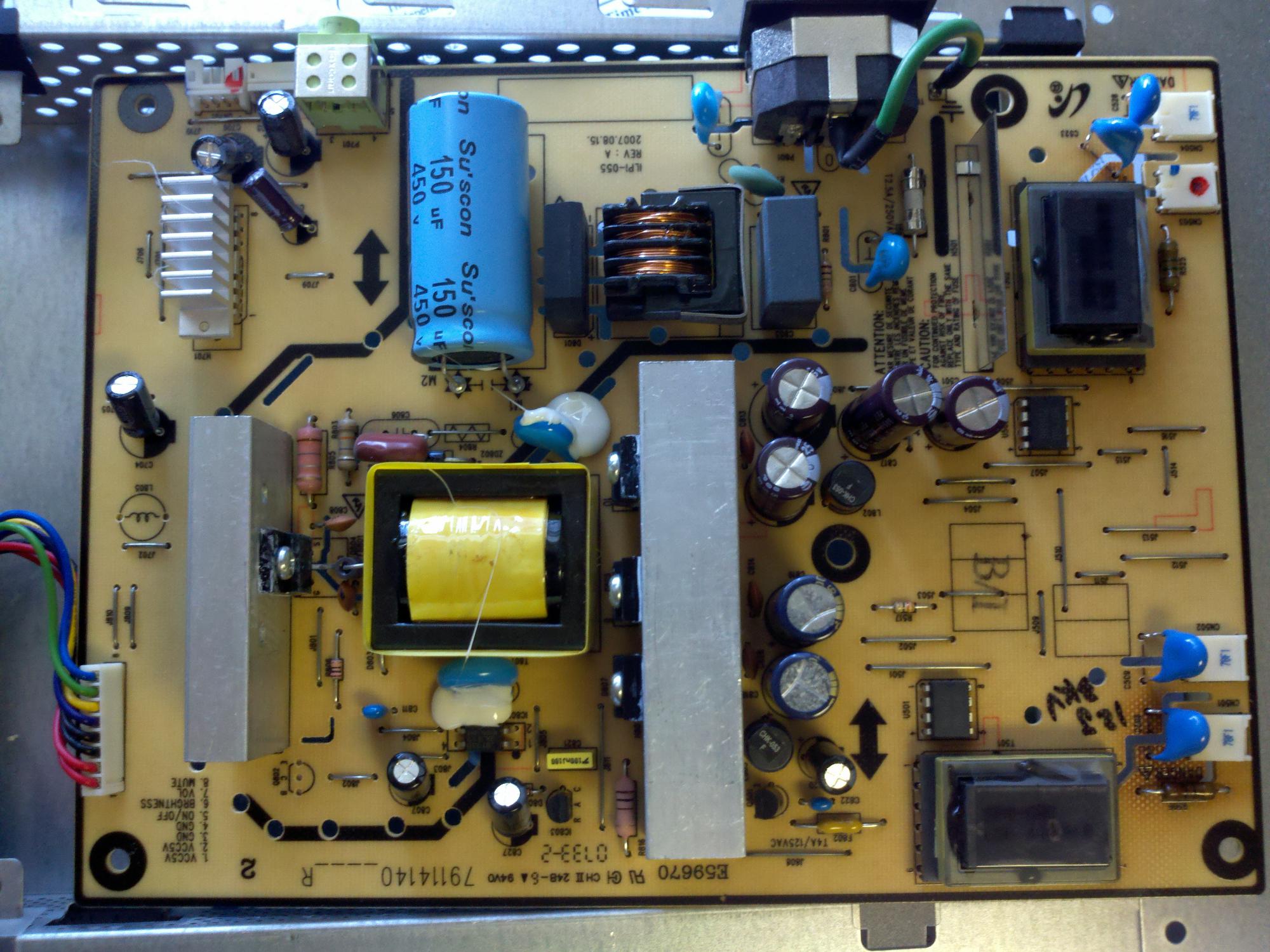

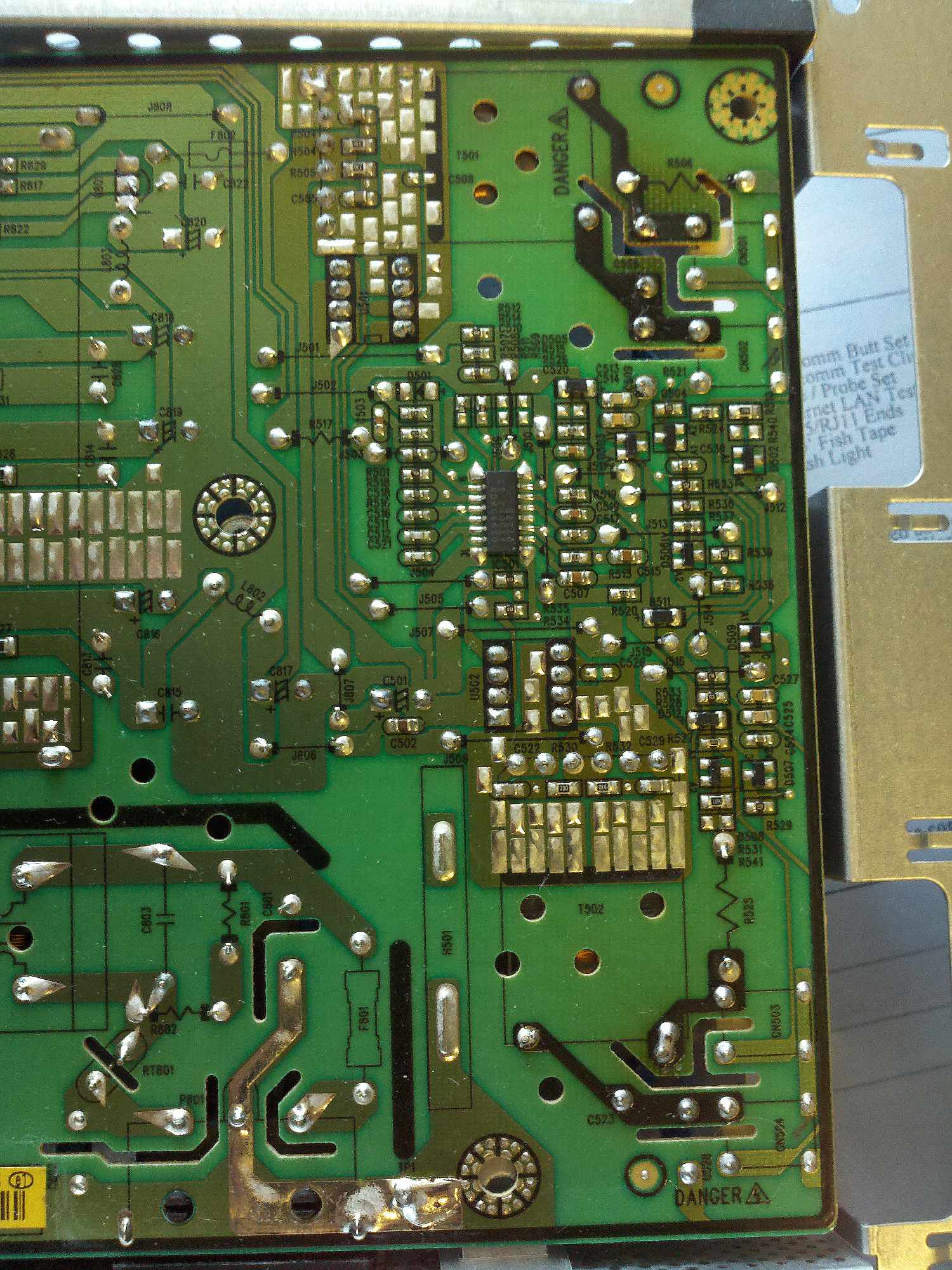

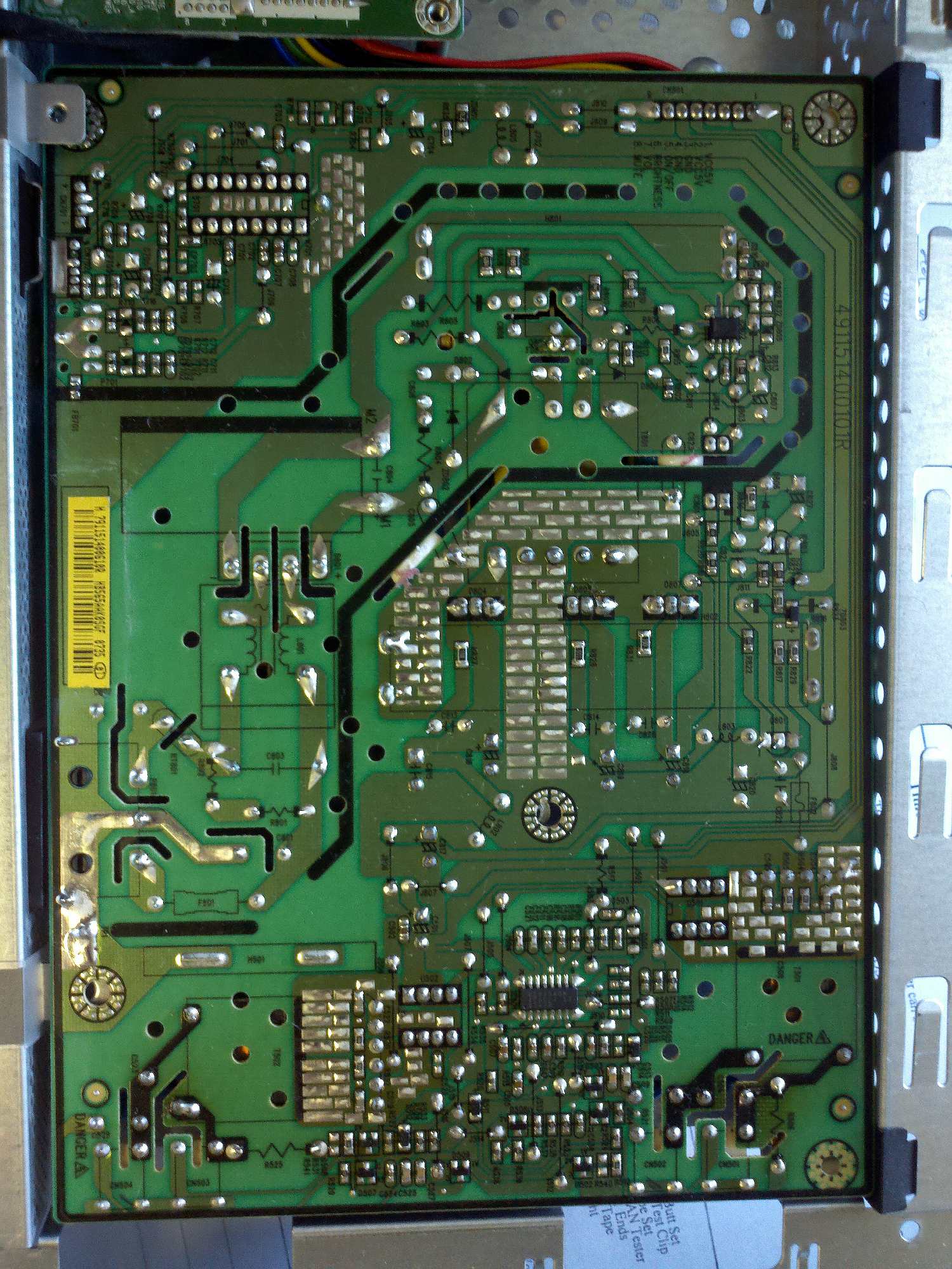

                A really good focused picture of the inverter top and bottom would really help.
                Last edited by alexanna; 06-08-2011, 08:14 AM. Reason: early morning spelling problem

                        I seriously doubt you have 2 bad inverter transformers, I am wondering if you may have a supply voltage problem, or such high resistance some ware in the circuit that the inverter shuts down before its able to overcome it.
                        The fact that you have a scope may be helpful, but I haven't had the opportunity to use one.
                        One thing that really gets my attention is the soldering of the inverter transformers, have you tried removing them completely from the board and cleaning and the re soldering?

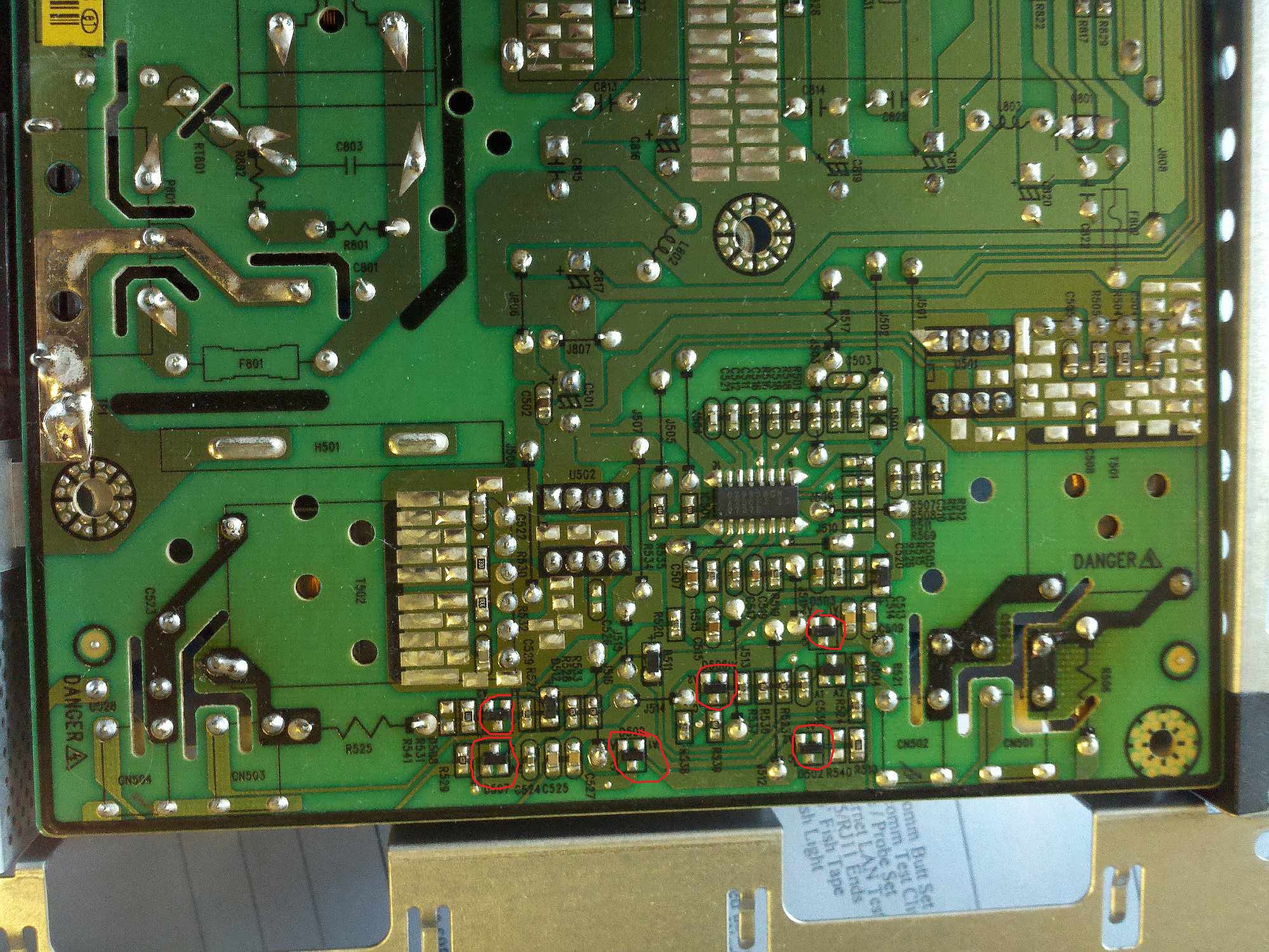

                                  Thinking about your monitor, I have some more questions.
                                  Was the soldering on the inverter transformers OK?
                                  Are two of the CCFL connectors still failing to light CCFLs?
                                  Next question are any of the small diodes I have circled tied to the return side of the CCFL connectors?
                                  If so you may want to check and see if any of them are open. Or check with diode function see if they are working correctly.
                                  Whatever I do, I consider it a success, if in the end I am breathing, seeing, feeling and hearing!

                                      Re: Samsung SyncMaster 2220wm
                                      Soldering redone, no effect.
                                      Yes
                                      yes, but I'm gonna have to take them off the board to test cause circuitry is interfering. None test as open, but I'm getting irregular results.
