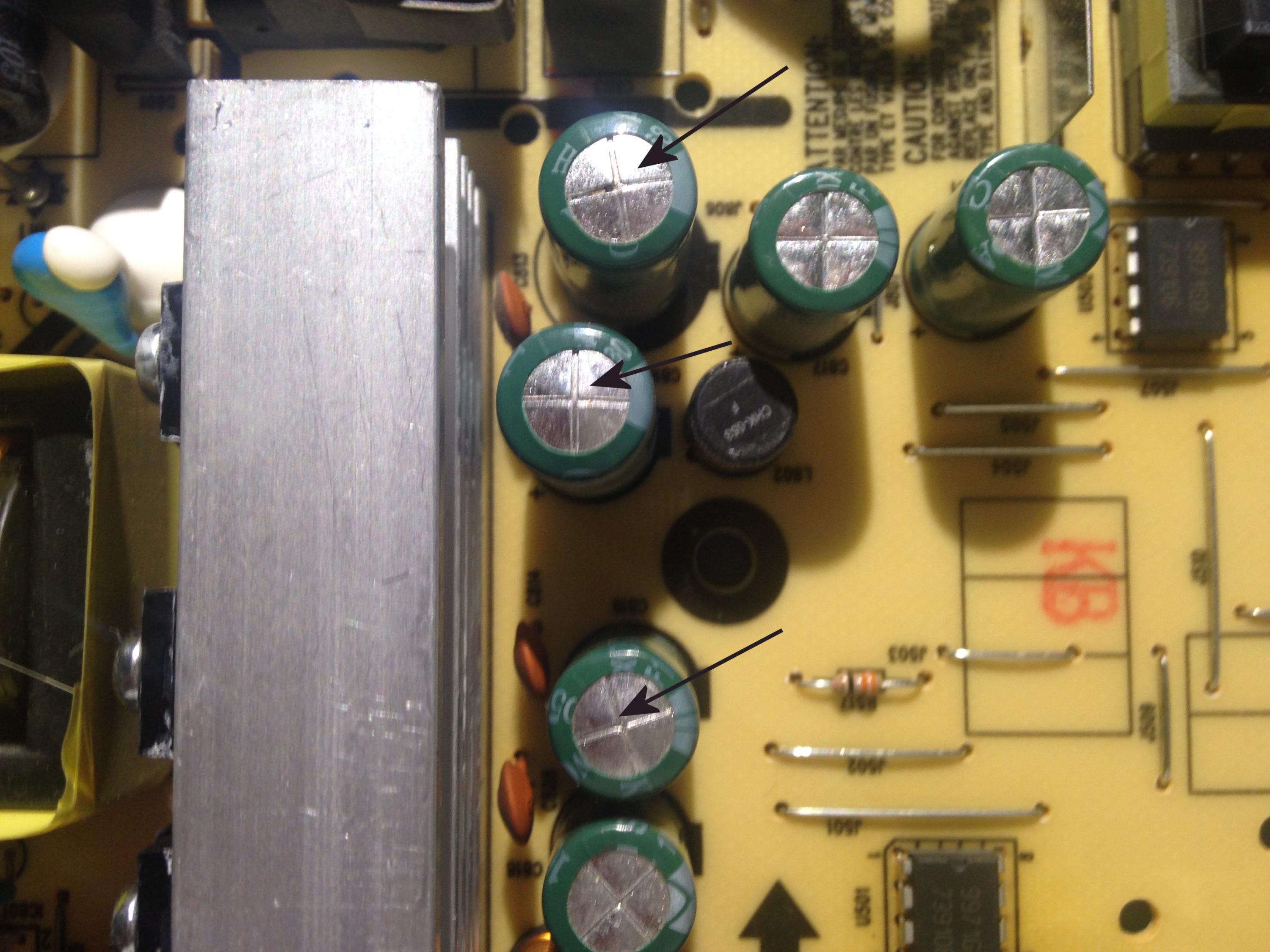

        RE: Samsung 2220mw caps. I pulled this board from and non working monitor. See picture. The three caps I have arrows pointing to have bulged tops. I am assuming they are bad. I can replace them but just wondering if its worth it and if this is the primary problem for no picture.
          Re: Samsung SyncMaster 2220wm
          You will need to define non working.
          Have you read this
          https://www.badcaps.net/forum/showpo...4&postcount=19.
          Whether it is worth it is always personal to the person doing it
          You should also post clear straight on pictures of you boards back and front.
