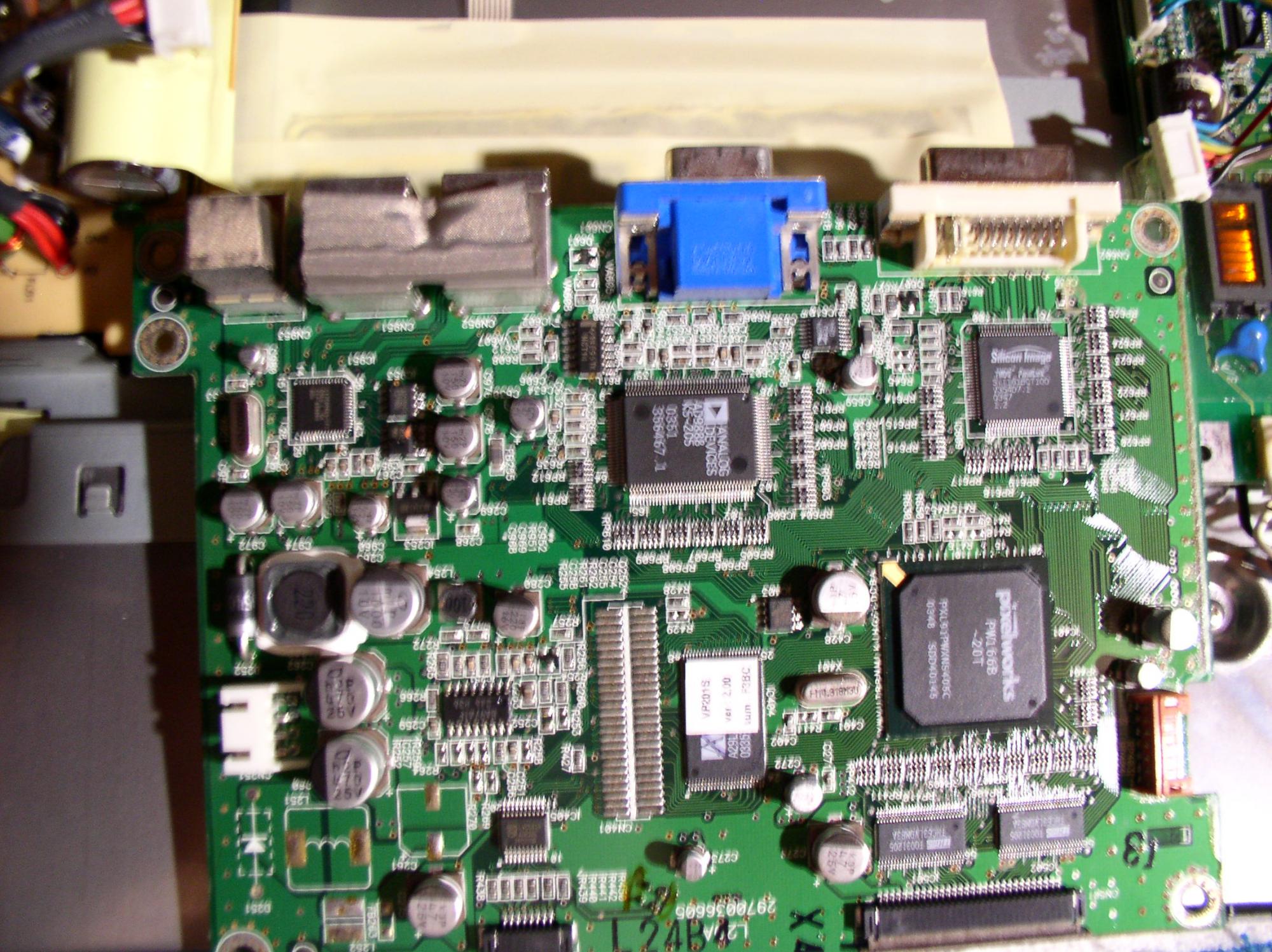

          I been studying it for 1 hour now and i got a headache. Pic attached. I took a hi res pic, but max allowed is 1.91 MB, so I reduce it.
          • retiredcaps
            • Apr 2010
            • 9271
            Re: viewsonic vp201s screen goes bad after 5 minutes
            You can try the opposite and use a hair dryer to warm up a small section of the board at one time.
                If it takes 5 minutes for the lines to appear normally and longer with a cooling fan, then if you heat up the board, the lines should appear in less than 5 minutes if you heat up the correct section of the board.
                That would help narrow down which component or solder joint is questionable.

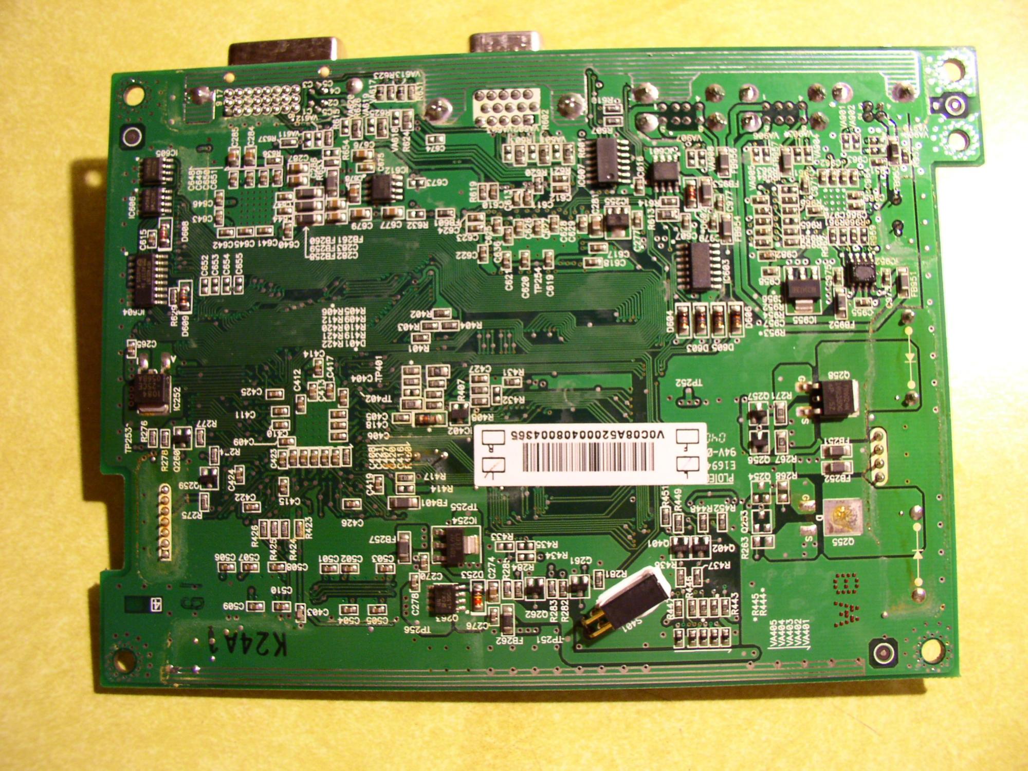

                    you might want to see if yours has one of those damn ics like mine did and remove it for testing purposes. show us a pic of the other side of the mainboard.
                      attached
