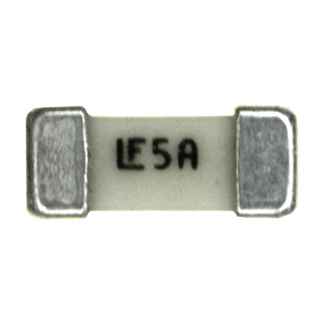

    Anyone have any idea where I can buy the little white smd fuse on the inverter board, link or part number Thanks for any help chris

    Picture please of the fuse area (via Manage Attachment and as large as possible) and not linked to another site.

      thanks for the reply it says Le 5a found a pic on the web as I could not get a good one.

        The fuse below is rated at 5A 32V fast acting. Available at digikey.com. Measure length and width to verify fit. And buy a few, since that fuse probably blew for a reason.

          Mine is 1/4"L 1/8" w 1/8" H this one seems smaller

            You are correct. The one you want is about 6 mm x 2 mm x 2 mm. Look at the Littlefuse Nano2 449, 450, 451, 452, etc series.

                  Thanks for thr reply I check there sight all I seen was the smaller ones. Can I use those by extending the solder?

                    Try this one. It's part of the 451 series PlainBill suggested. Higher voltage is ok.
