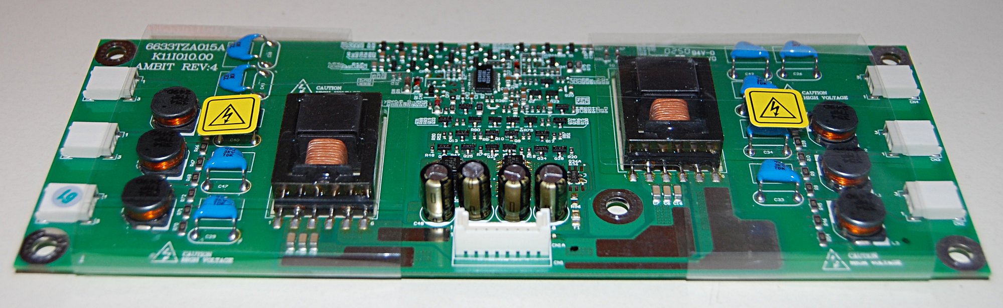

    Seems like there's a few variations of the FPD1830. This one shows a green power LED but nothing else. Power supply caps all look good and tested okay for ESR.

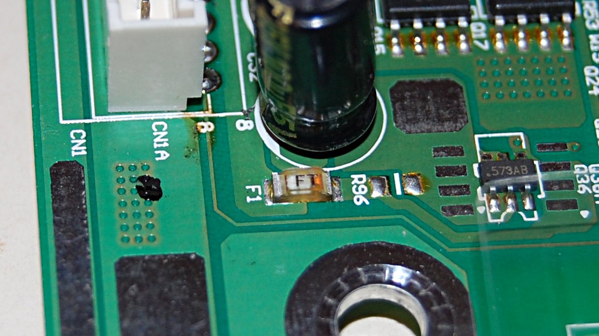

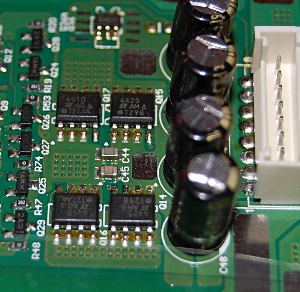

    The inverter is an Ambit K11I010.00. It had four 100 uF, 25V caps with questionable ESR, so they were replaced (Panasonic FM). It also has a blown SMD fuse, 3.5mm x 1.5mm, marked "FT". The MOSFETs all have pins 1-3 and 5-8 shorted together by the PC board. Just running them in parallel pairs for capacity?
    What does the "FT" fuse code decipher to? There are conflicting versions on the web, but obviously it's not a 500mA. Doubtful it would be slow blow, either. Littelfuse has a "T" code for 5A.

    To confirm: a pdf that I found on surface mount fuses shows FT is a 24 volt 5 amp fuse. I'd buy a few to have on hand. Whatever blew this fuse will blow it again.
    By the way, due to the far away pic, I can only assume that F1 (the FT fuse) is on the input of this board. I'd do a resistance check from each side of the fuse to that board's ground. There may be a direct short.

        Yep. Those 4 Sanyo caps were a major problem with that model inverter. Because of their compact size , they dried out, shorted and probably in your case caused the fuse to blow. I believe the "F" in FT stands for Fast blow. The 1206 case style should work fine.

          These are 24VDC, 5A, 1206 package.

            Just repaired the same model Gateway monitor by replacing the four Sanyo 100uf 25v caps on the inverter with two 220uf 25v Rubycon's and the fuse labeled "F1" that is right next to one of the caps.
            Symptoms were; Power would stay on and blank screen.
