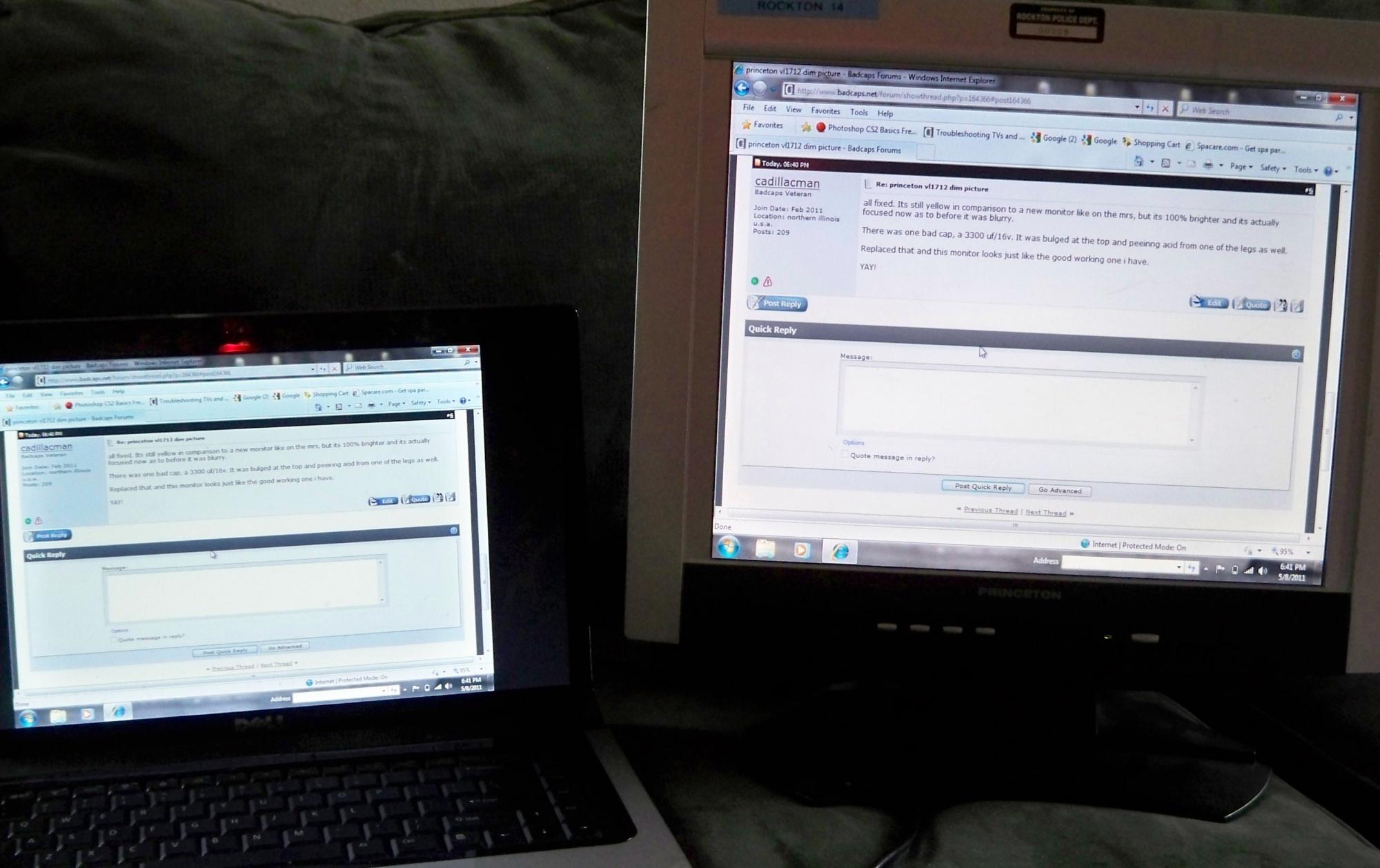

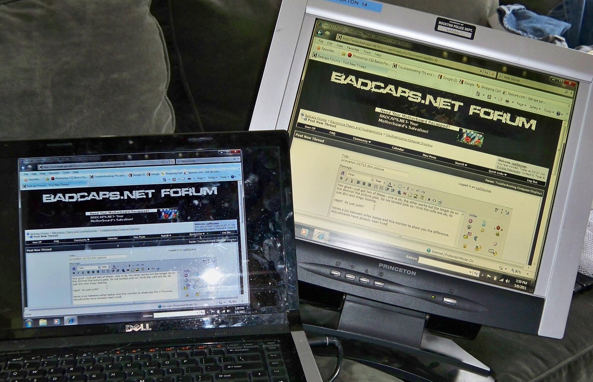

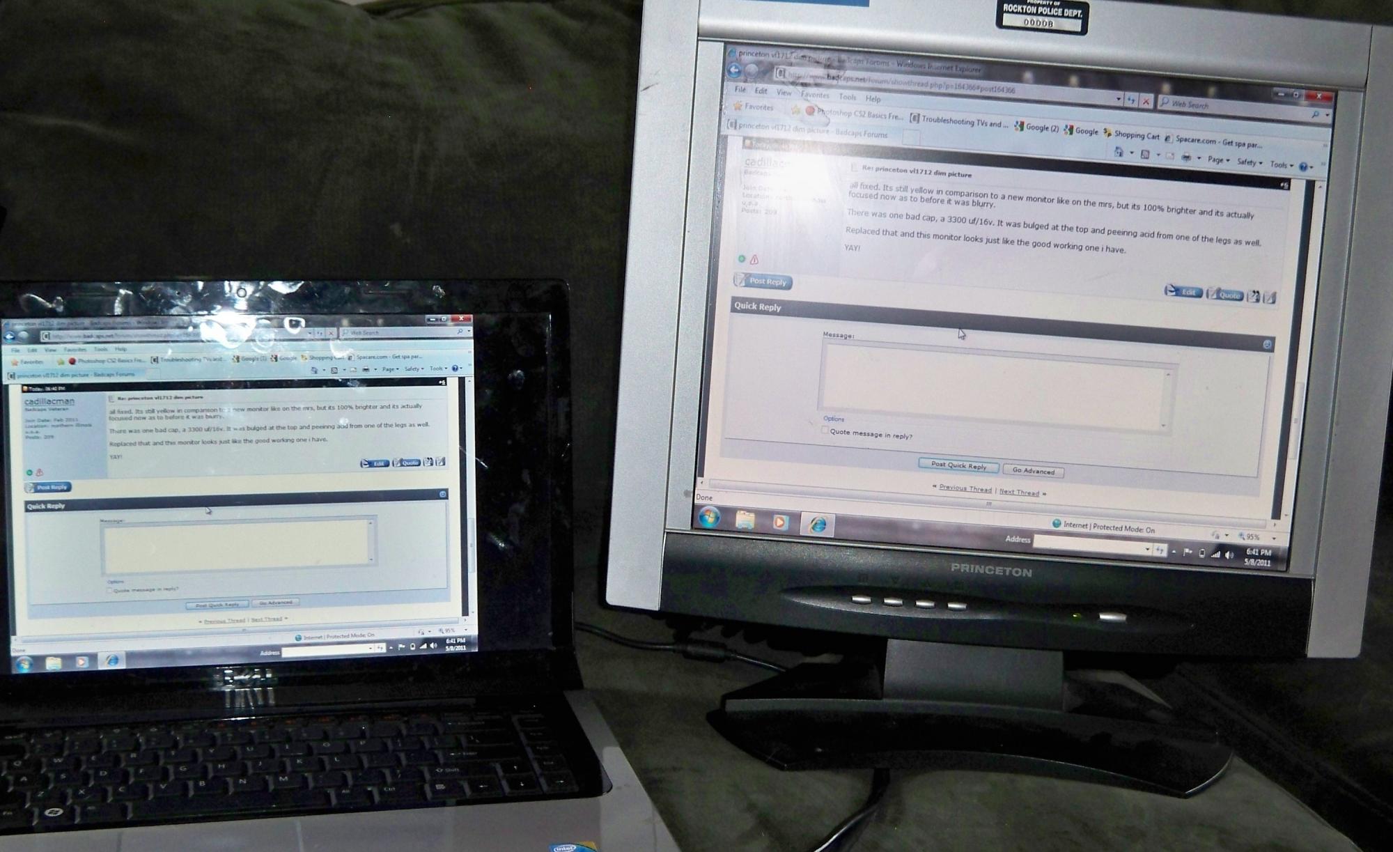

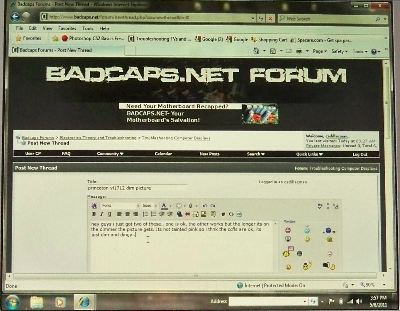

    hey guys i just got two of these.. one is ok, the other works but the longer its on the dimmer the picture gets. Its not tainted pink so i thnk the ccfls are ok, its just dim and dingy looking.
    caps? its just junk? mabye its just krappy like that to begin with?
    heres a pic between wifes laptop and thia monitor to ahow you the difference.
    OSD adjustments have already been tried

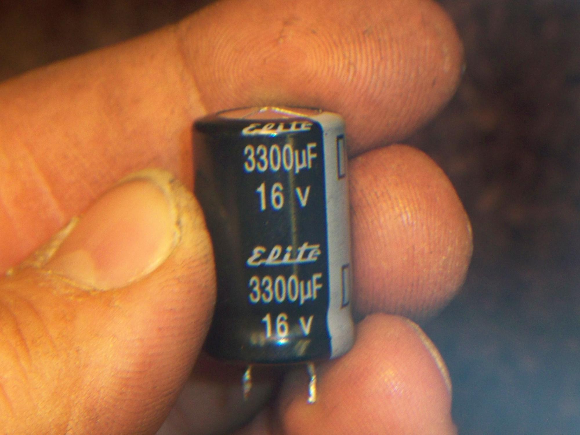

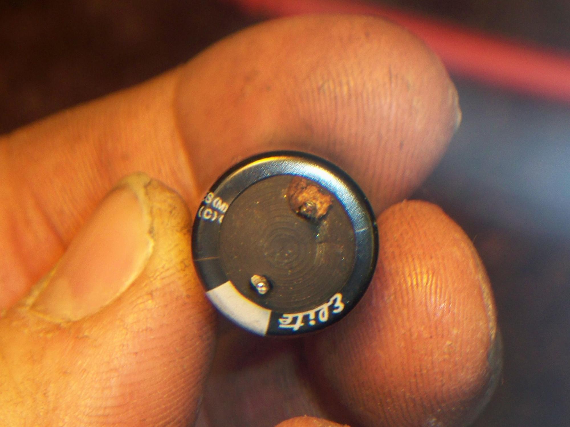

            all fixed. Its still yellow in comparison to a new monitor like on the mrs, but its 100% brighter and its actually focused now as to before it was just a touch blurry.
            There was one bad cap, a 3300 uf/16v. It was bulged at the top and peeing acid from one of the legs as well.
            Replaced that and this monitor looks better then the "working" one i have.

              just wanted to ad that the other monitor i have, same cap bulged but not leaking YET and i stress YET it was close...
