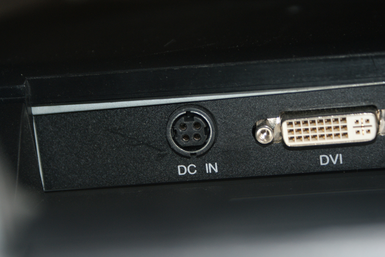

    I received an LCD monitor with out the external power supply called One Monitor
    model PV198SG. The input rating is 12V DC at 4.2 A. It has a 4 pin connector .
    Does anyone have the pinout.
    (see attached picture)

    When I receive a monitor without the four pin external power supply, I will remove the back of the monitor to identify the power and ground pins. And then wire in a compatible voltage and amperage power supply for testing.

      if you have a multimeter, it's even easier.
      put it in diode test mode (beep mode). one probe into the hole where the VGA/DVI cables would screw into (or any other exposed metal part), and with the other, go through the 4 pins.
      should be 2x ground (beeping) and 2x positive (no beeps or just a short one)

        It looks like the 2 pins closest to the DC IN are the ground pins and the 2 pins farthest away are the 12V pins.
