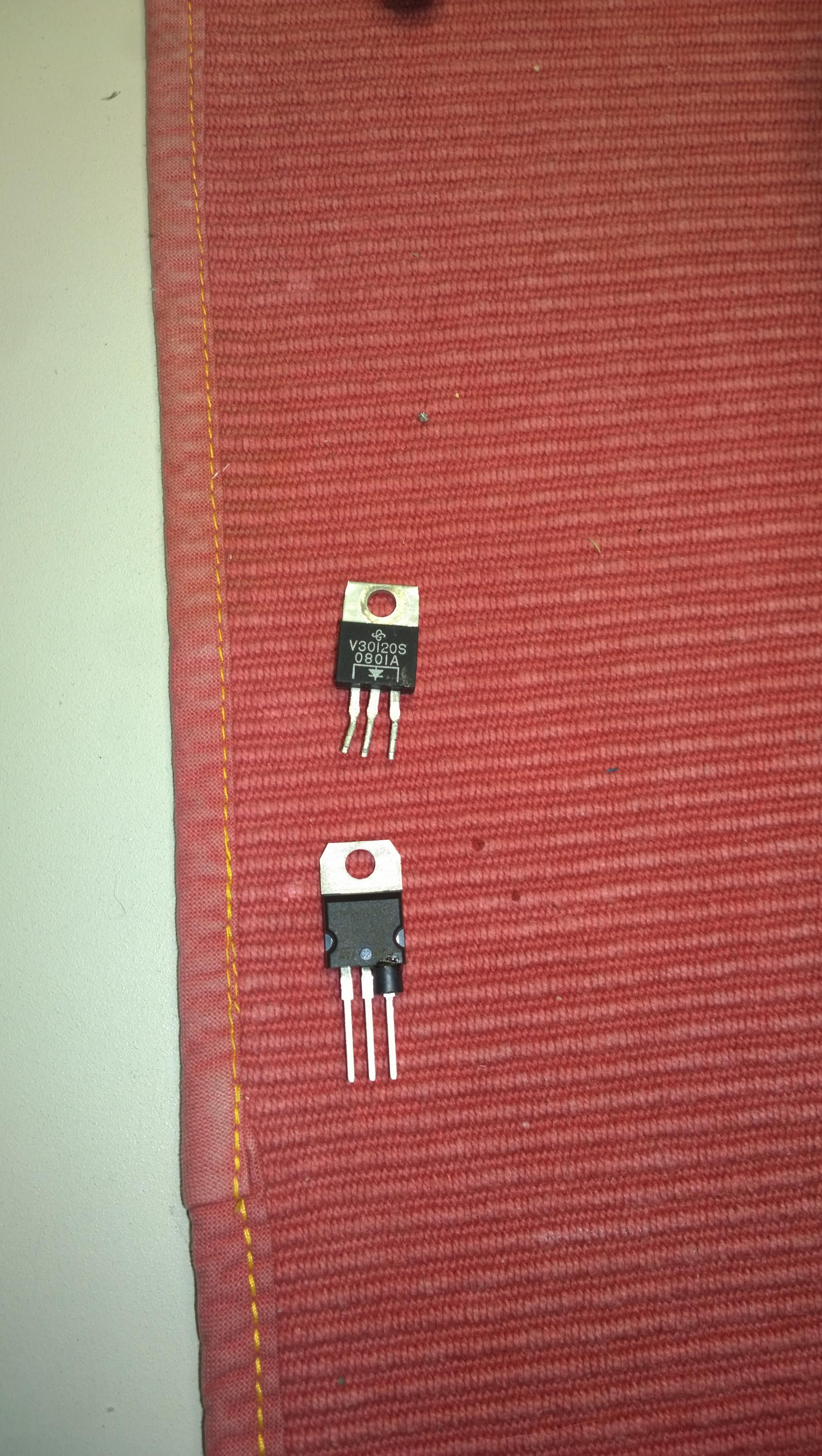

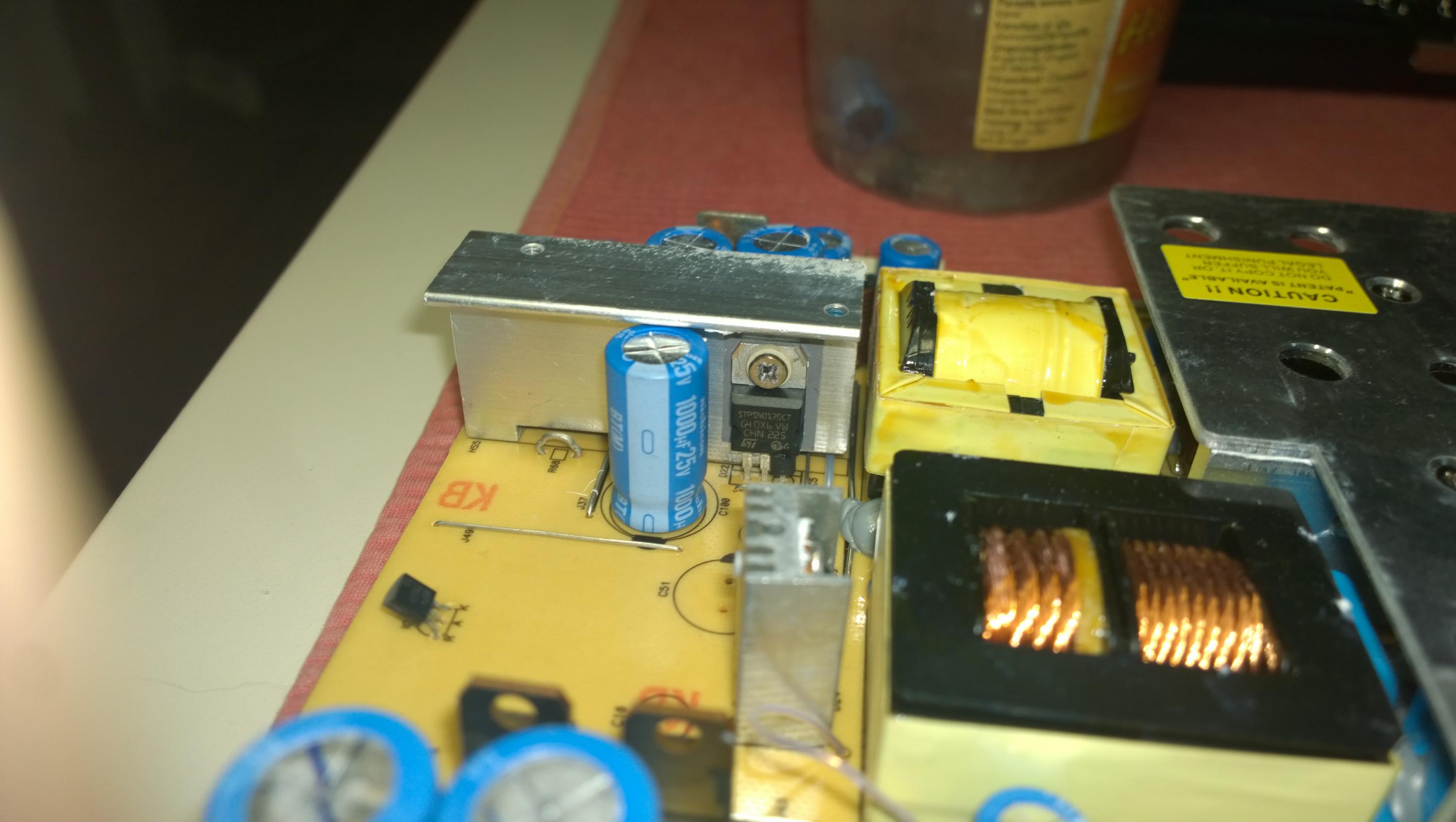

            Hi guys,
            First off thank you so much for contributing to this thread everybody.
            I also happen to have a not powering on 3008 sitting around the house. Recently I was given a another 3008 in working order and started trouble shooting the faulty monitor with the parts of the working monitor.
            No surprise, I was able to get the old monitor working with the power supply from the working monitor I receive.
            As per this thread I bought the correct replacement part for D22 and put everything back together. Unfortunately, the monitor still won't power on also there is no blue light.
            I then took everything apart again and resoldered the 3 diodes which needed to be removed, but without success.
            Compared to the working PSU the broken PSU doesn't even have some kind of a “drizleing electric noise” when inserting the power cord.
            It would be so much appreciated If you could you please have a look at the photos attached and give me some ideas where to continue looking for the fault.
            Thanks so much!

              Do you get any standby voltages with this PSU? Or any voltage across main filter capacitor?

                      Please take more photos showing both sides of the whole board, so I can see where all the parts are and if there may be some visible damage anywhere.

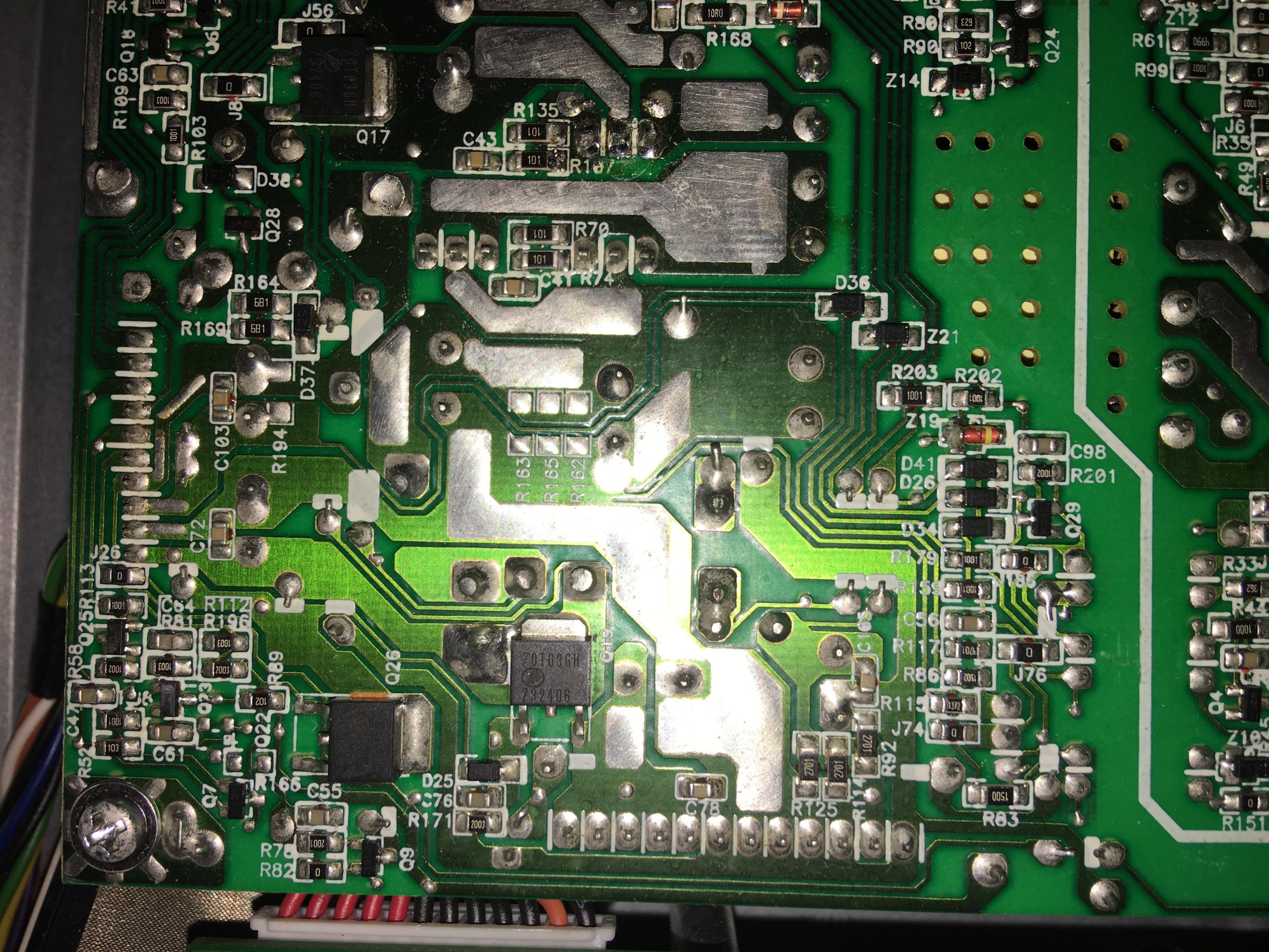

                          Here are photos from two of my board. Here are symptoms 1) The blue LED is on as soon as I plug in the power cord. 2), I cannot turn the blue LED off using power button. 3) the screen is black.
                          Is there any additional test can help pin down the problem?

                                        Can you check the voltages on all pins of the two connectors diagonally opposite the mains input socket on the PSU?
                                        List the connector names\pin numbers and the voltages you measured please.

                                          Hi All,
                                          I have the same symptoms as KK325ic, that is, plug in power and get blue light ON, but nothing else. None of the buttons do anything, the blue light always remains ON. I have read all the great help on this site but not seen any solutions for this particular problem so far. I have the monitor apart and already replaced the D22 (STPS40170CT) but no change to symptoms. The boards all look to be in very good condition to me (I do a lot of electronics repairs). I have measured voltages for the 3 connectors with the T-con and inverter disconnected, as follows: I have used the "Good" PSU voltages from another post on here.
                                          P801 (logic)
                                          Pin | Good | Bad
                                          1 to 5 5.2 5.2
                                          6 to10 | 0 | 0
                                          11 | 18 | 0
                                          12 | 0 | 0
                                          P802 (Logic)
                                          Pin | Good | Bad
                                          1 | 5.22 | 5.22
                                          2 | 0 | 0
                                          3 | 12.58 | 12.8
                                          4 to 6 | 0 | 0
                                          7 | 0 | 3
                                          8 | 12.8| 0.05
                                          9 | 0 |3.29
                                          10 |5.2 | 1.72
                                          P803 (Inverter)
                                          Pin | Good |Bad
                                          1 to 5 | 25 | 0
                                          6 to 11 | 0 | 0
                                          12 | 3.26 | 3.29
                                          13 | 2.55 | 1.72
                                          14 | 0 | 0
                                          So I have 5V but no 12, 18 or 25V. Not sure where to go from here. Any help would be most appreciated. I have an ESR meter which I have used on all the caps I could see and all are A-OK.
